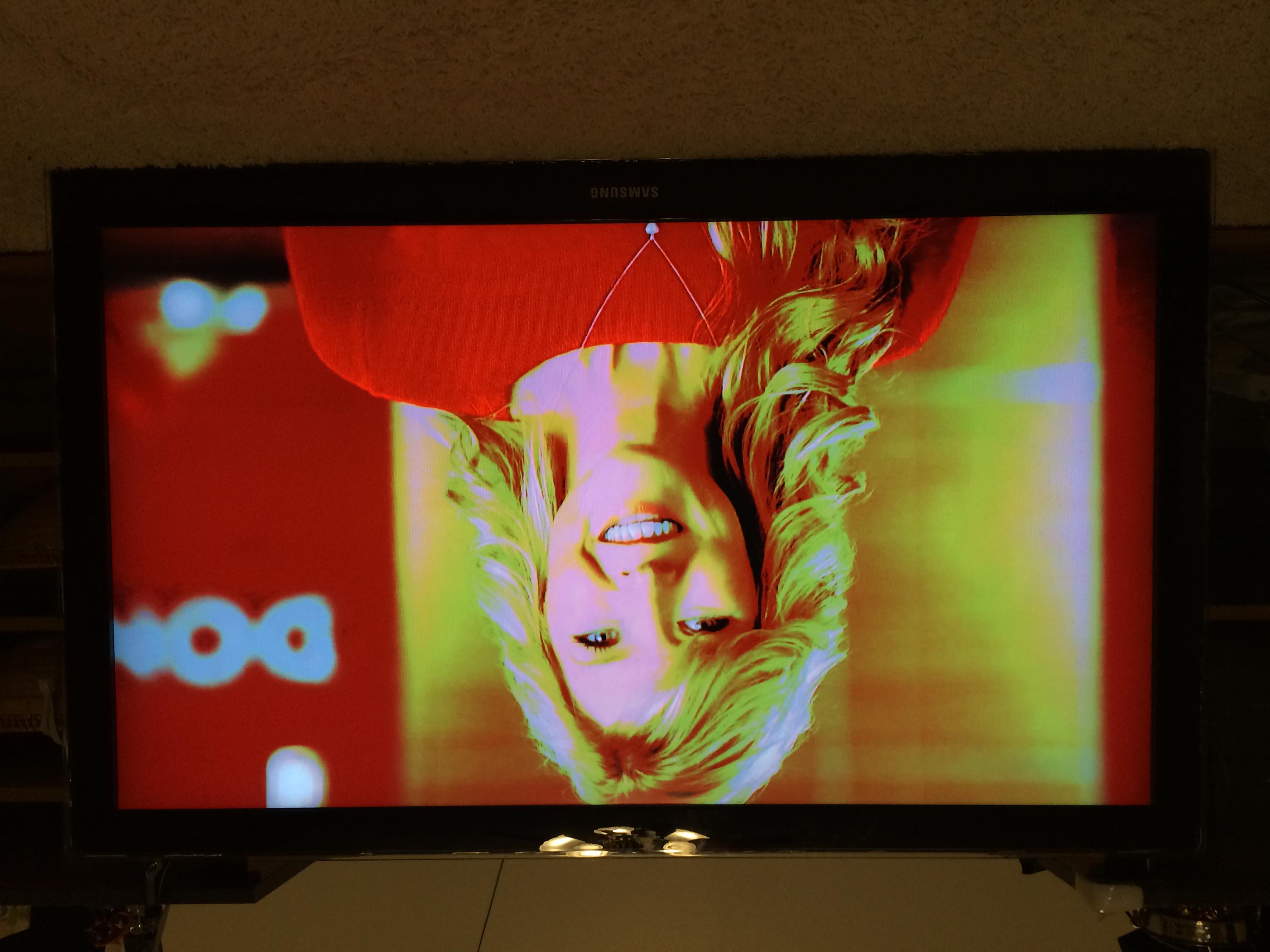

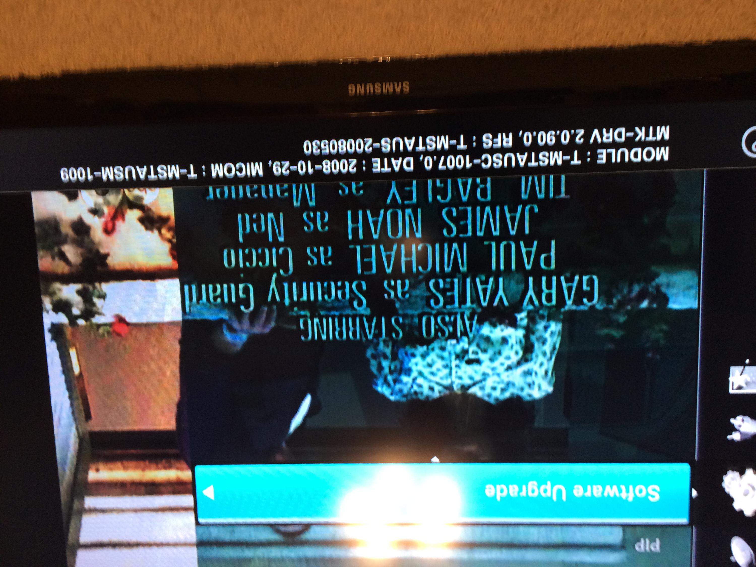

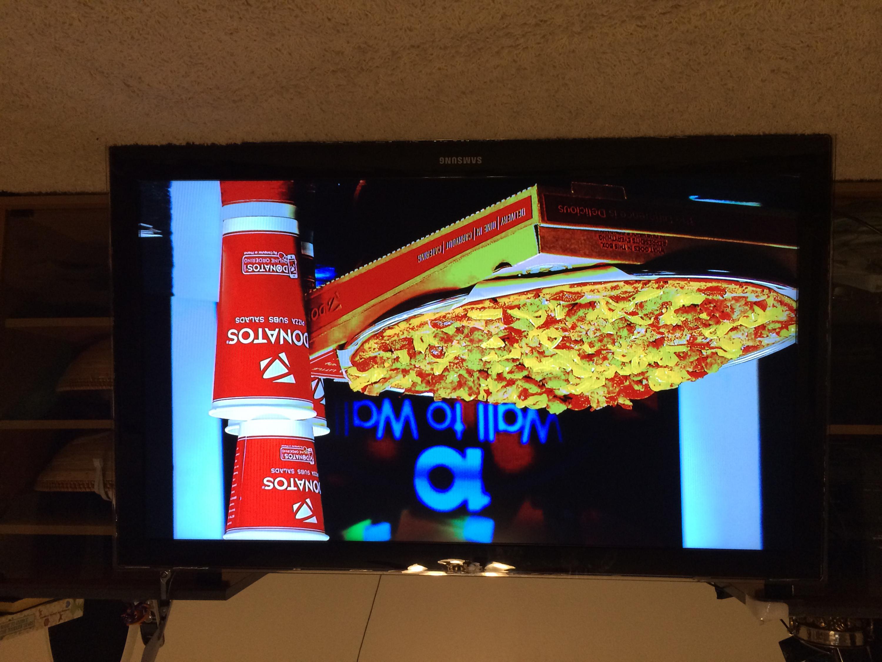

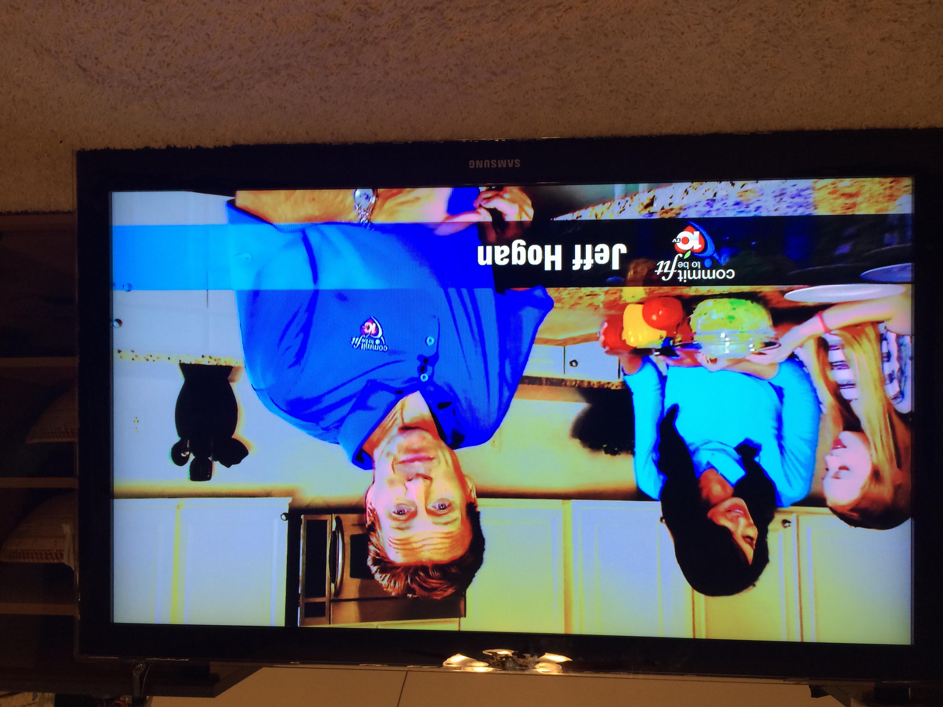

    I had this TV since 2009 and about 3 weeks ago started seeing this brightness issue. Initially I thought it was skin tones only. But it seems to be more than that. I do not have any issues with power cycling or red tinting,etc. I will figure out a way to add pictures here.
    The mfg date is Jan 2009

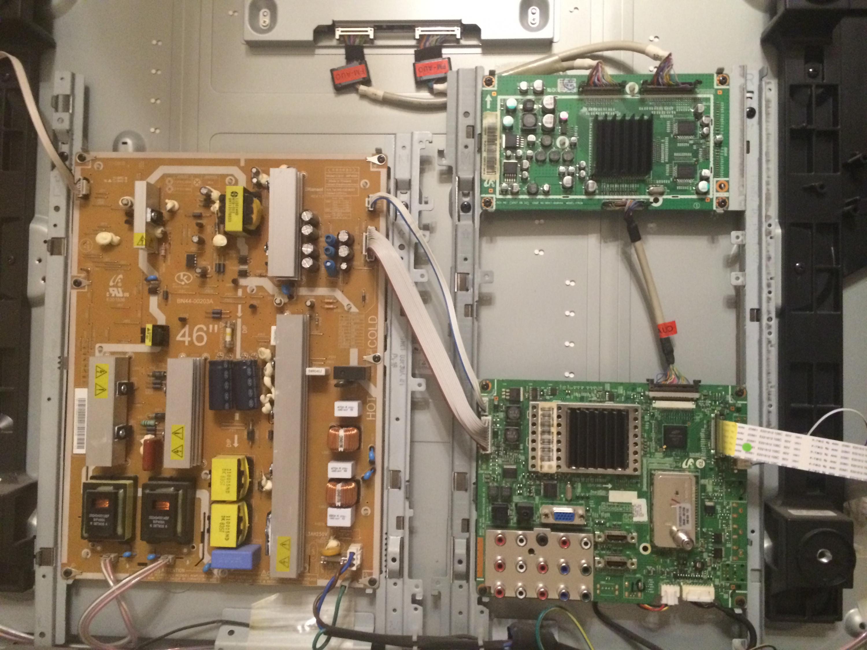

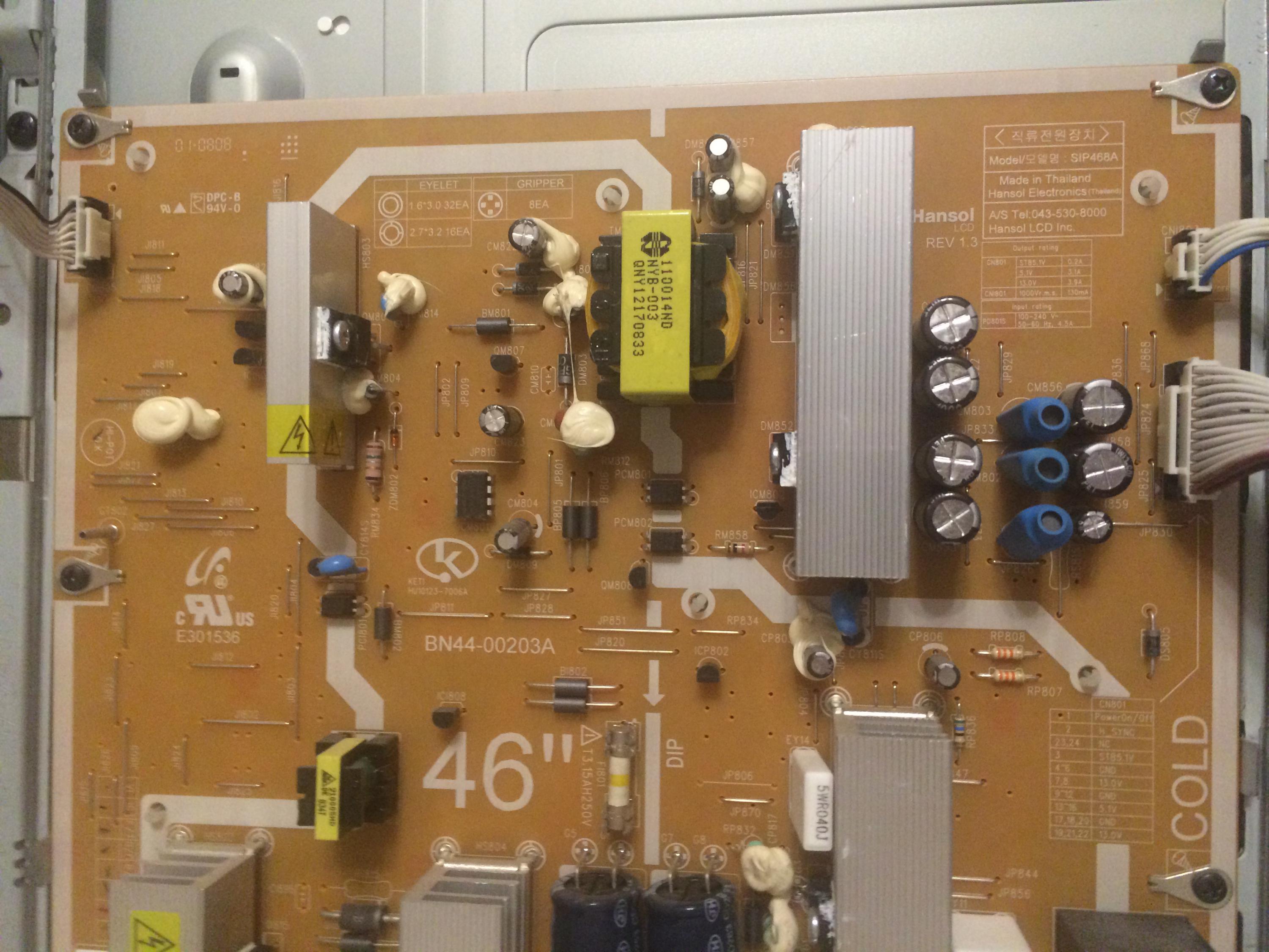

    I read about the capacitor issues and opened up the back and took pictures. The capacitors seem to be fine.

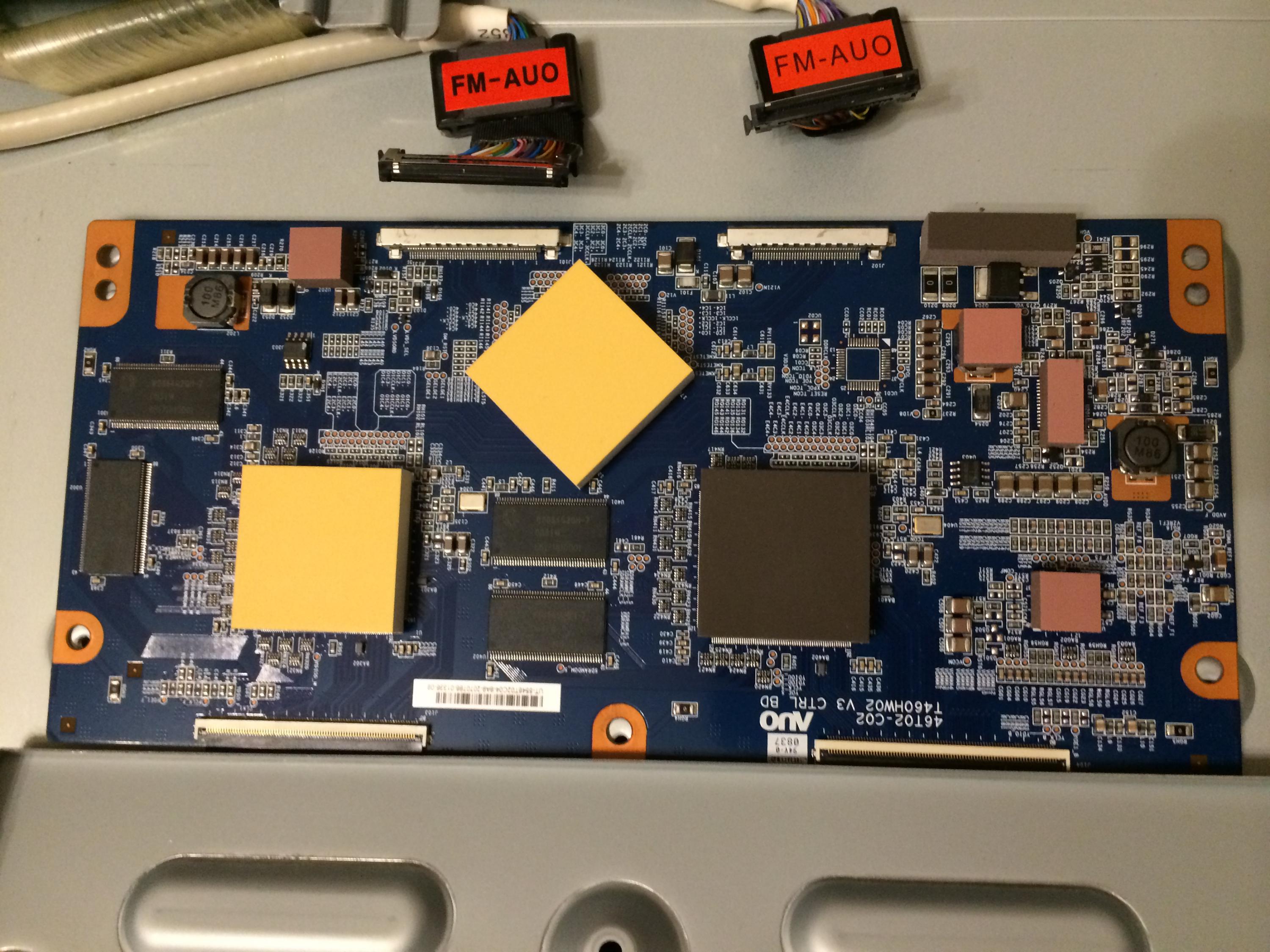

      I am going to go out on a limb here and say the AS15 gamma chip on your T-con board is going bad.
      There has been well over a dozen of these popping up over the last few weeks.
      Take a photo of the t-con board it's behind a metal shield.

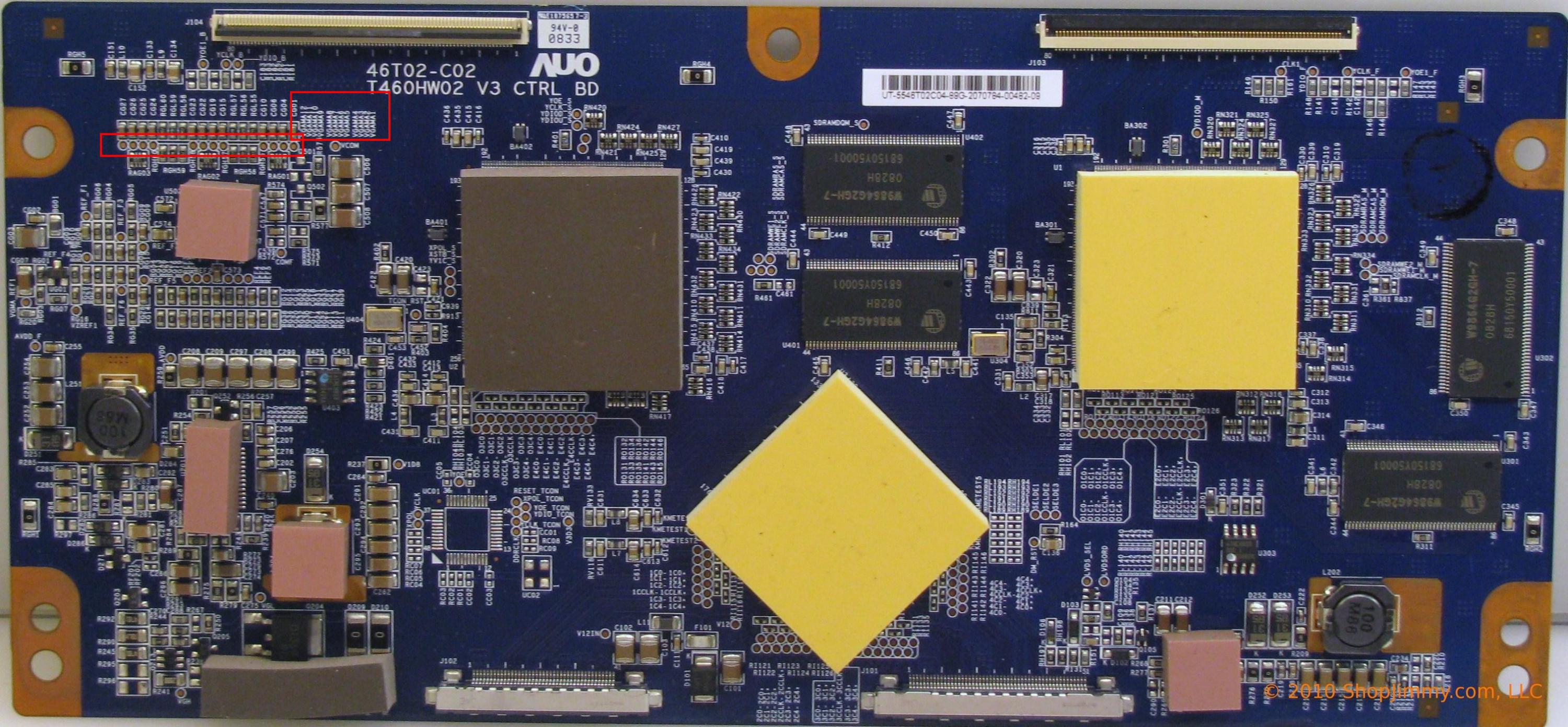

        Take the DC voltage reading on those test points VGMA1~18.
        You have one of these two T-CON board.
        http://www.shopjimmy.com/media/catal...16584b-top.jpg
        http://www.shopjimmy.com/media/catal...03334j-top.jpg

          I had to open up the tv again!!!
          The tcon bord I assume is the one in the picture I am attaching. This was behind the metal plate at the top center of the tv.

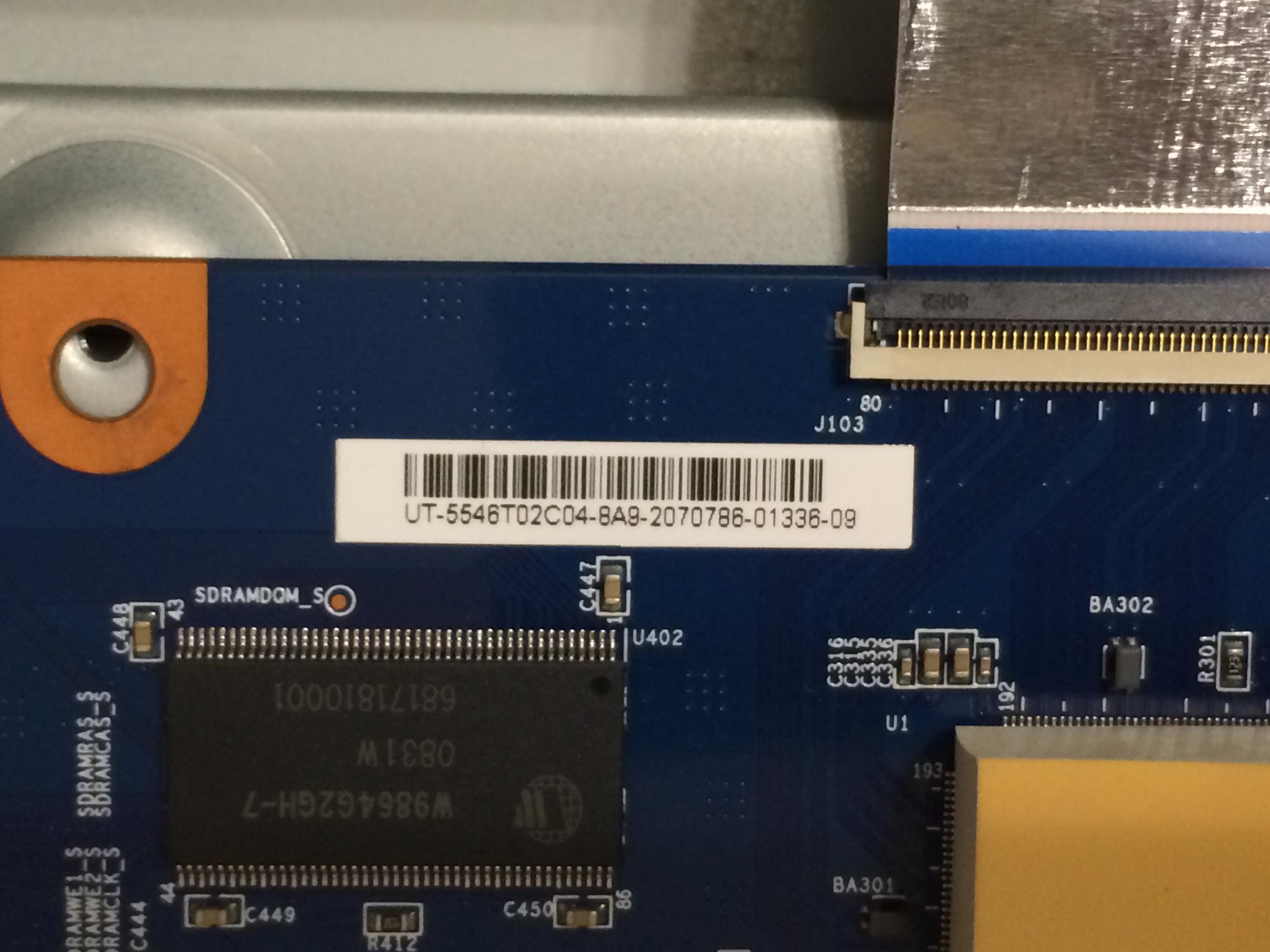

            Third pic does illustrate a gamma type problem pretty well....
            Under one of the smaller heat-pads, one of the chips will probably be an AS15 chip--which is the suspect....

              Re: Samsung LN46A630 - too bright picture
              http://www.shopjimmy.com/auo-55-46t0...-con-board.htm
              Picture provided by SJ.
