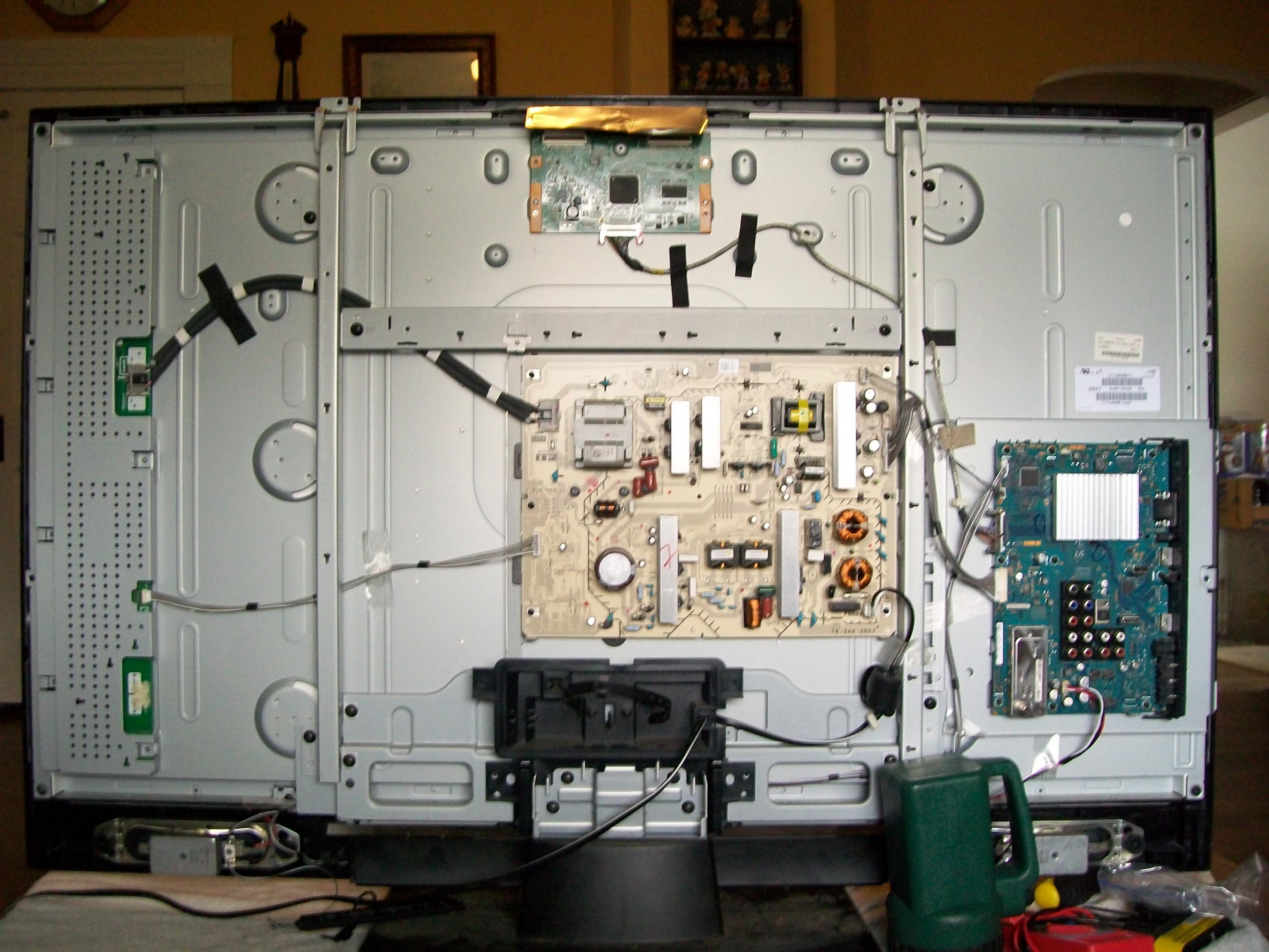

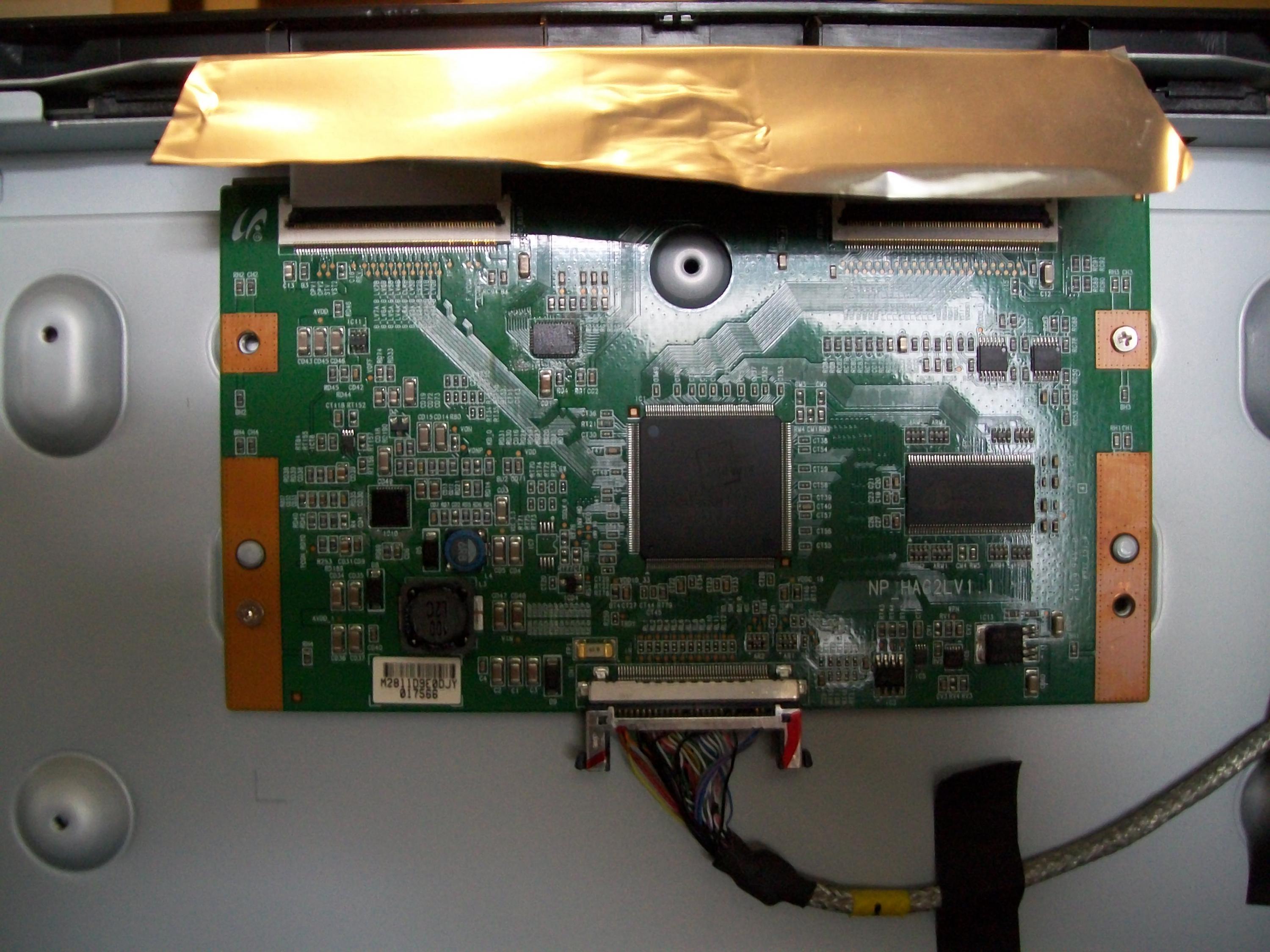

    Working on a Sony KDL-46S5100 for a friend of mine.
    When first plugged in there is no standby light (not sure if this model has one). Press the power button and a light on the bottom turns green and stays lit solid (no error light blinking).
    I hear a click from the PSU area, then the back lights come on and the screen lights up like a TV/Monitor would with no signal. Kind of a blue/grayish color.
    Pressing the menu or input buttons doesn't do anything.
    I checked voltages at the PSU connector and they all seemed correct. 3.3v, 15v, and 12v.

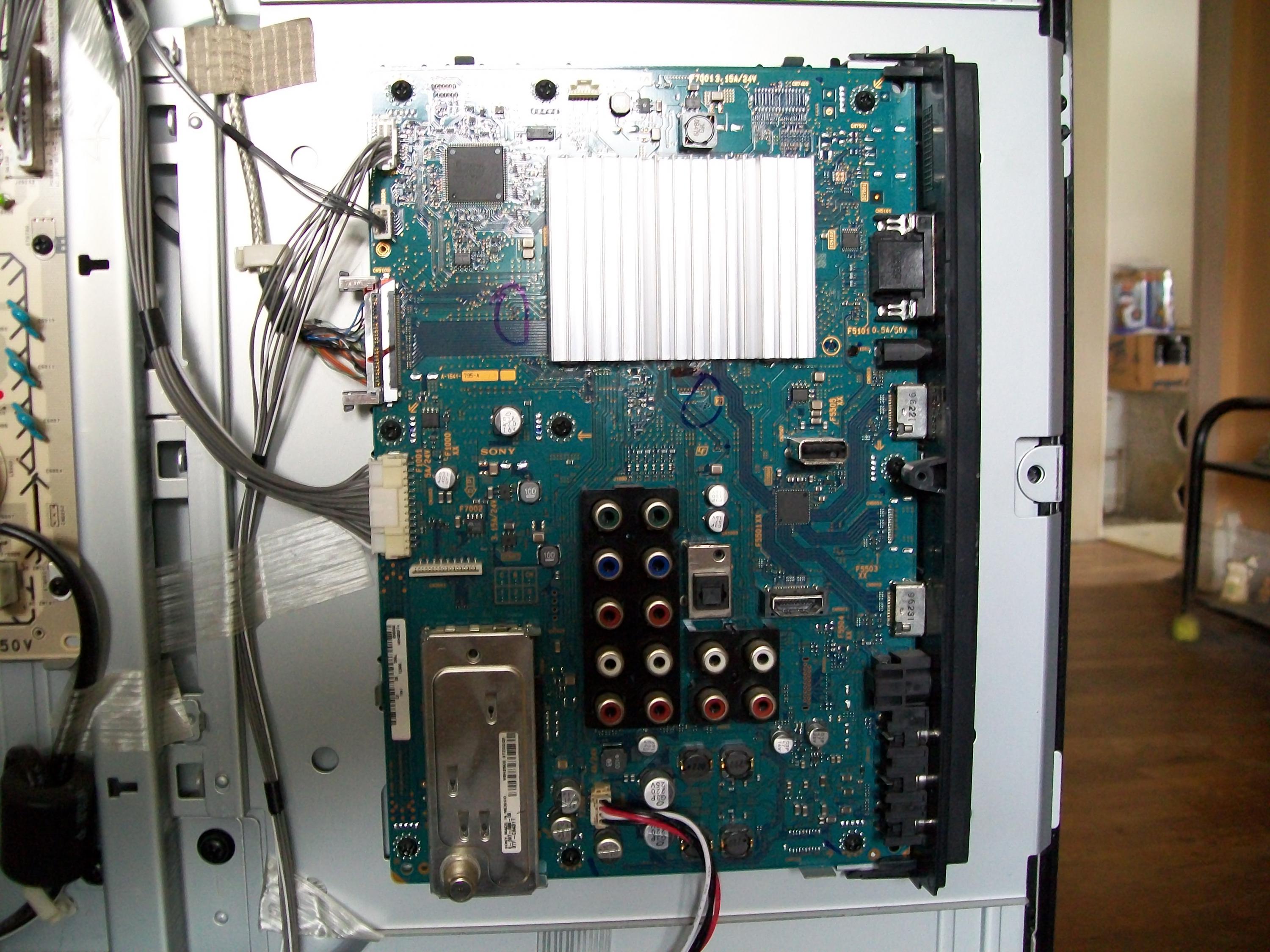

    Since the TV powers up and the backlight and screen lights up I am thinking the main board is the likely problem or possibly the Tcon as I can disconnect the cable to the Tcon and the TV lights up just as it did before disconnecting it.
    Is there a way to trace it down to the component level or at least which board is bad?
    Mainboards for this TV seem a little salty like in the $80-$100 range.
    Edit: Mainboard model# is 1-879-020-12

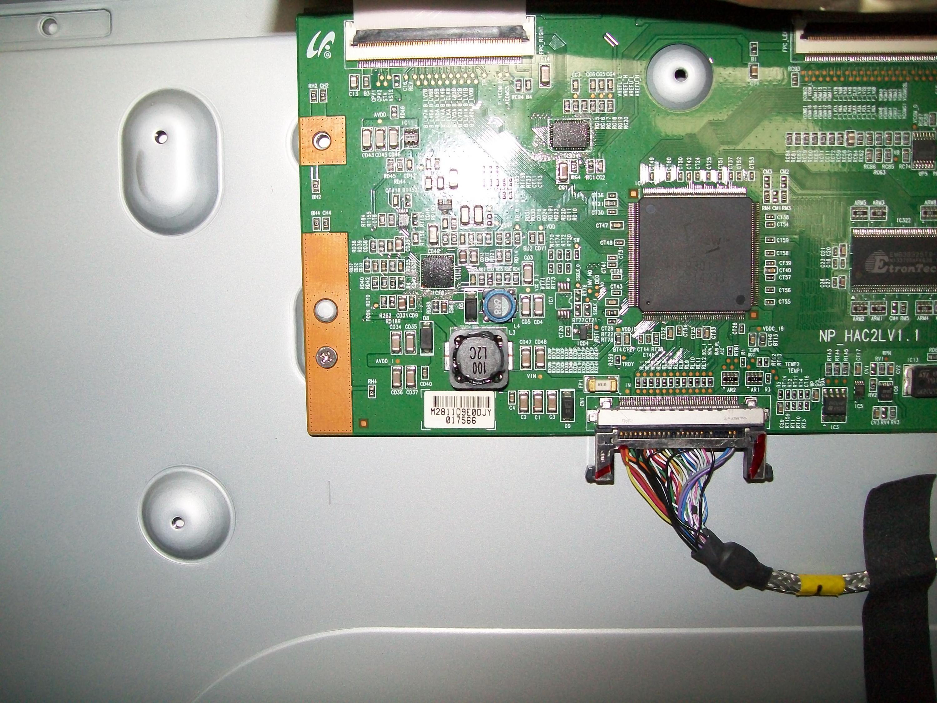

    Try checking the fuse on the T-con board.

      I could only find 1 fuse and it reads 0.00 with meter set on 20k ohm. With it set on 200 it reads.0.05.
        Re: Sony KDL-46S5100 Screen Lights Up but No Picture
        Do you have 12V both ends of fuse?

          Yep 11.9V on both ends.

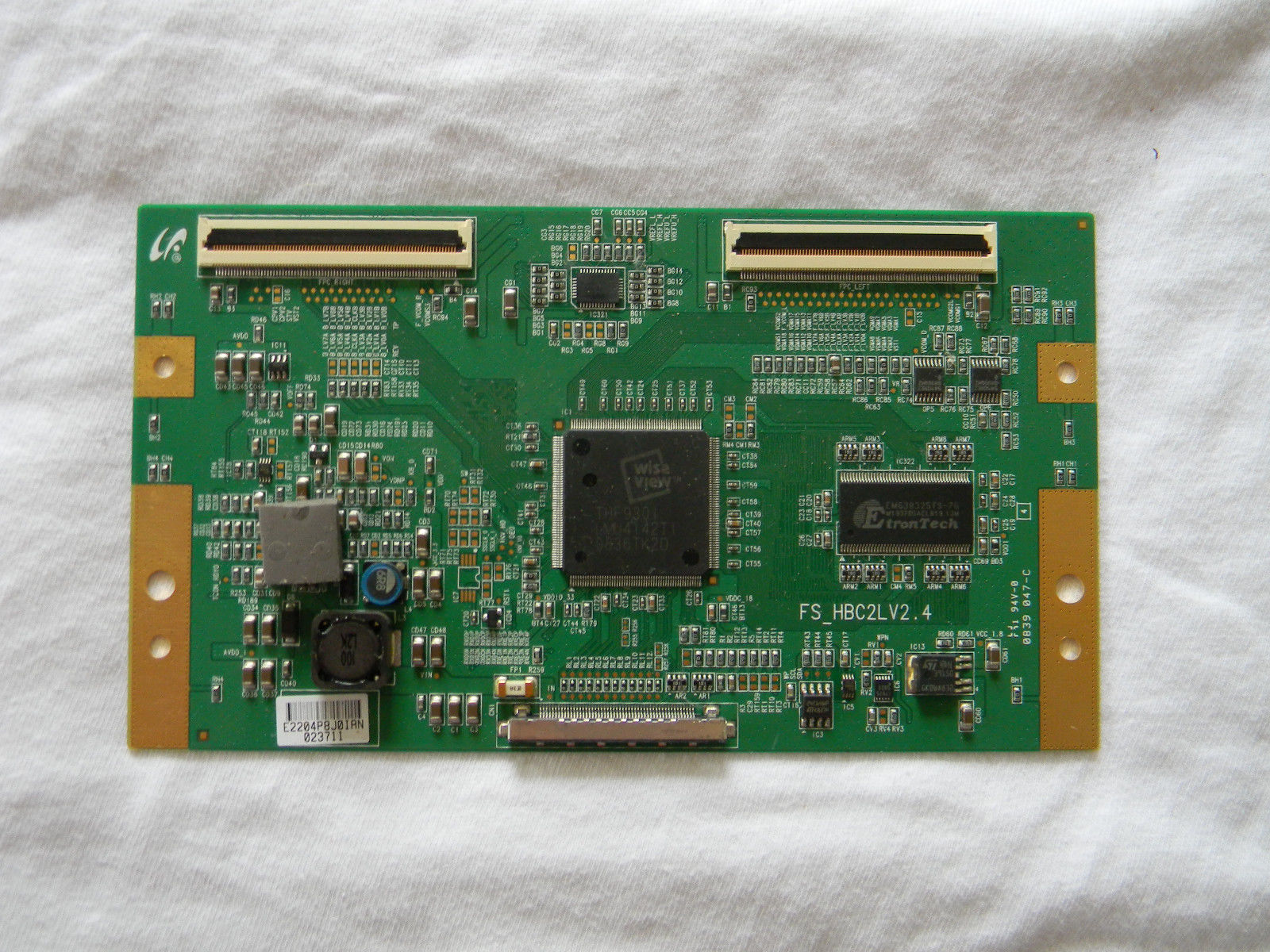

            Can you supply a picture of the T-con board?
              I'll have to wait until daylight to get pics of my board, but it looks just like the stock photo I uploaded here.
                FP1 is the fuse, check and see if you do have 12VDC at both ends of the fuse with ref to the chassis as ground ref point.
                  FP1 has 11.9V on each end.
                  I was looking through youtube and came across this video where the guy was working on a Sony with a tab bond problem..Could that be the problem with my TV or do you guys thinks its my T-Con or possibly mainboard?

                  Update: Added Pictures

                    Usually tab bond problems dont cause that symptom, but it's possible. I suspect it's a voltage on the TCON.

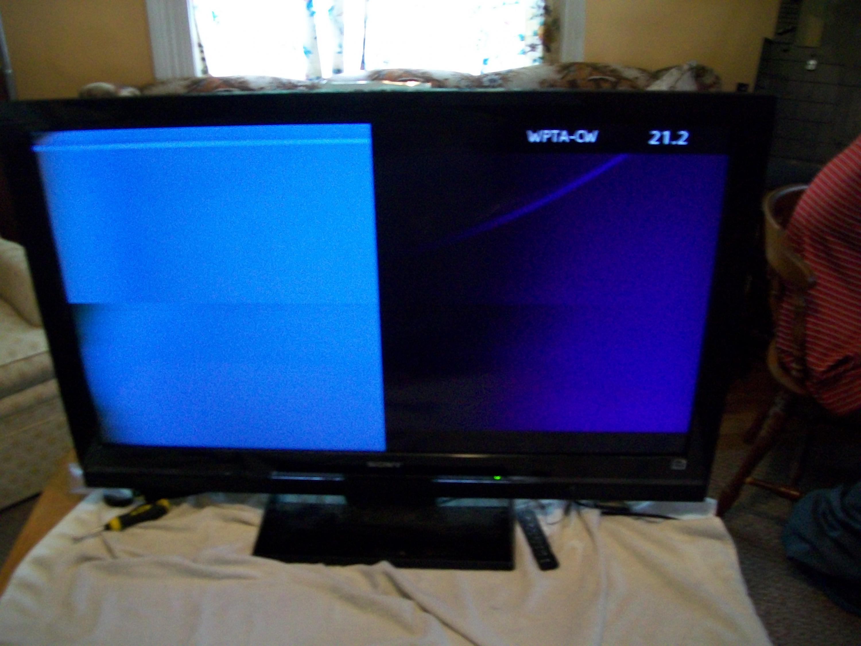

                      Try disconnecting one of the two ribbon cables at a time between the T-CON board and the LCD panel to see what happen.
                          With the left ribbon unhooked from the T-Con board I briefly saw the Bravia logo on half the screen then it went back to like it was before with no picture, but back lights on.
                          Tried repeating and the second time I didn't get the Bravia logo. Just the blank screen.
                          With the right side ribbon cable unplugged I get a picture on the right side of the screen and a brighter plain blue picture on the left.
                          There also seems to be a dark line going horizontal through the middle of the screen.
                          I uploaded a pic of the screen with the right side ribbon cable unplugged.
                          So it's looking like a bad T-Con right?
                          Can T-Con boards be fixed at the component level or not so much especially for a novice like me?
                          thanks
                            You have bad panel, half of the panel is shorted out, that is why when you disconnected the ribbon that feeds into the shorted circuit then it allows the T-CON board to function.

                                    He says that out of 100 TVs with a similar problem 98 had a bad panel.
                                    I was going to try a $20 ebay T-Con, but with odds like that I don't think it would be worth it.
