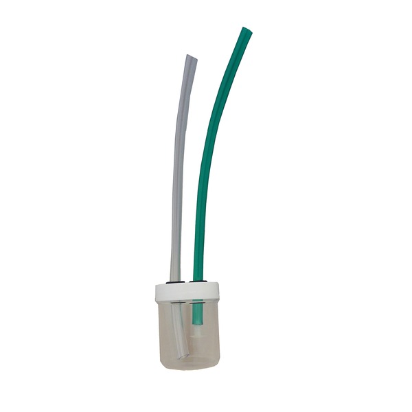

                        Soldering isn't that hard, As long as you have an iron and some solder its easy enough to swap components out.
                        *** Totally opposite view to the post above me, My Mrs can swap components in and out... Even fashioned a solder sucker ourselves when I was first learning. I am sure if she can do it with no experience then you can ***
                        If you want to know how we did a solder sucker... Ever seen those bug catchers.. Its a jar with 2 pipes going into it... One longer than the other inside the jar... Suck one end and aim the other pipe at a bug and it sucks it in. Due to the one pipe being higher than the other in the jar it just traps it. Works the same with solder. Only requires a quick sharp intake of air to suck up solder in a thin pipe... you won't inhale enough to get any fumes near your lungs so don't worry about that
