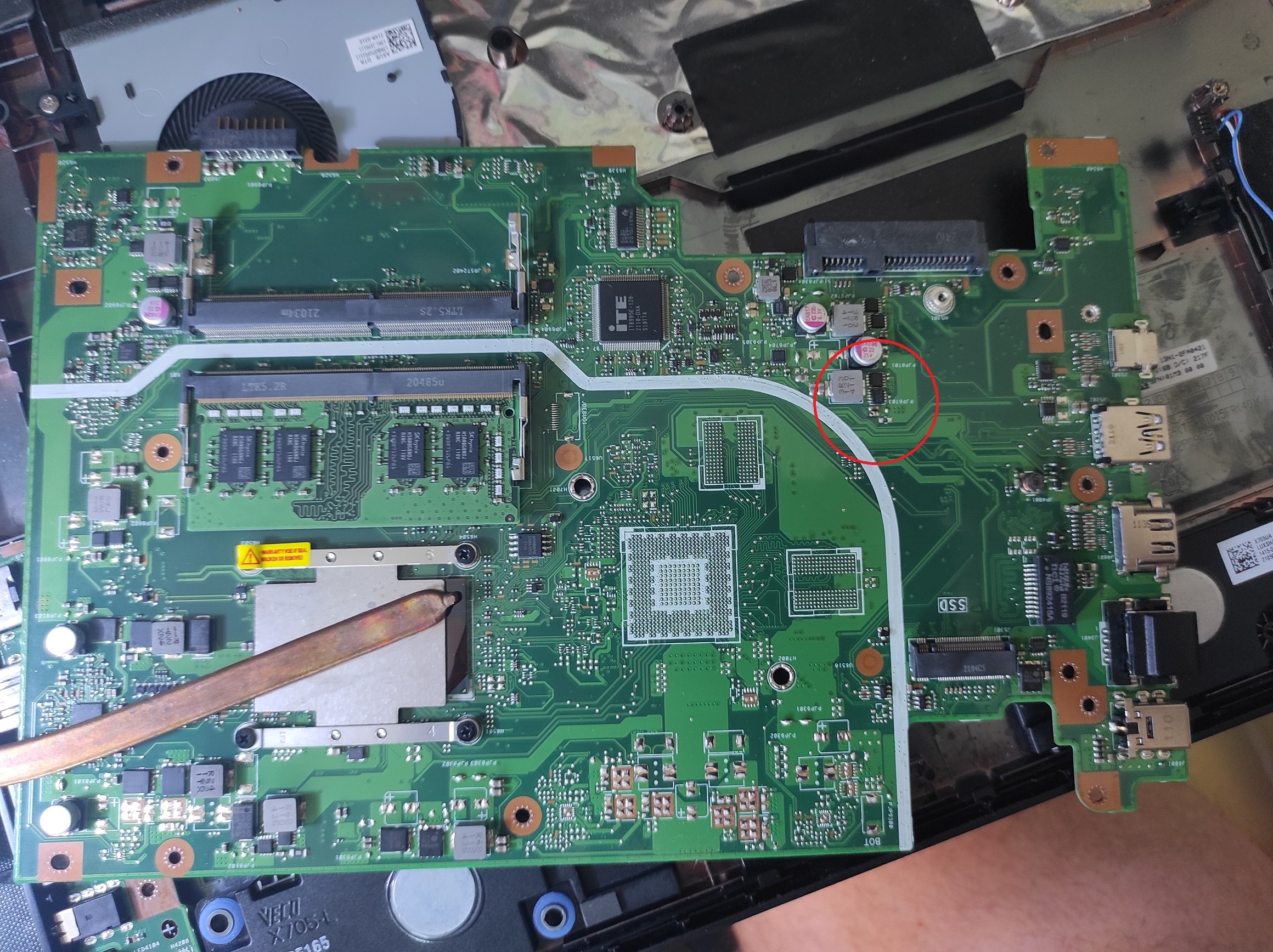

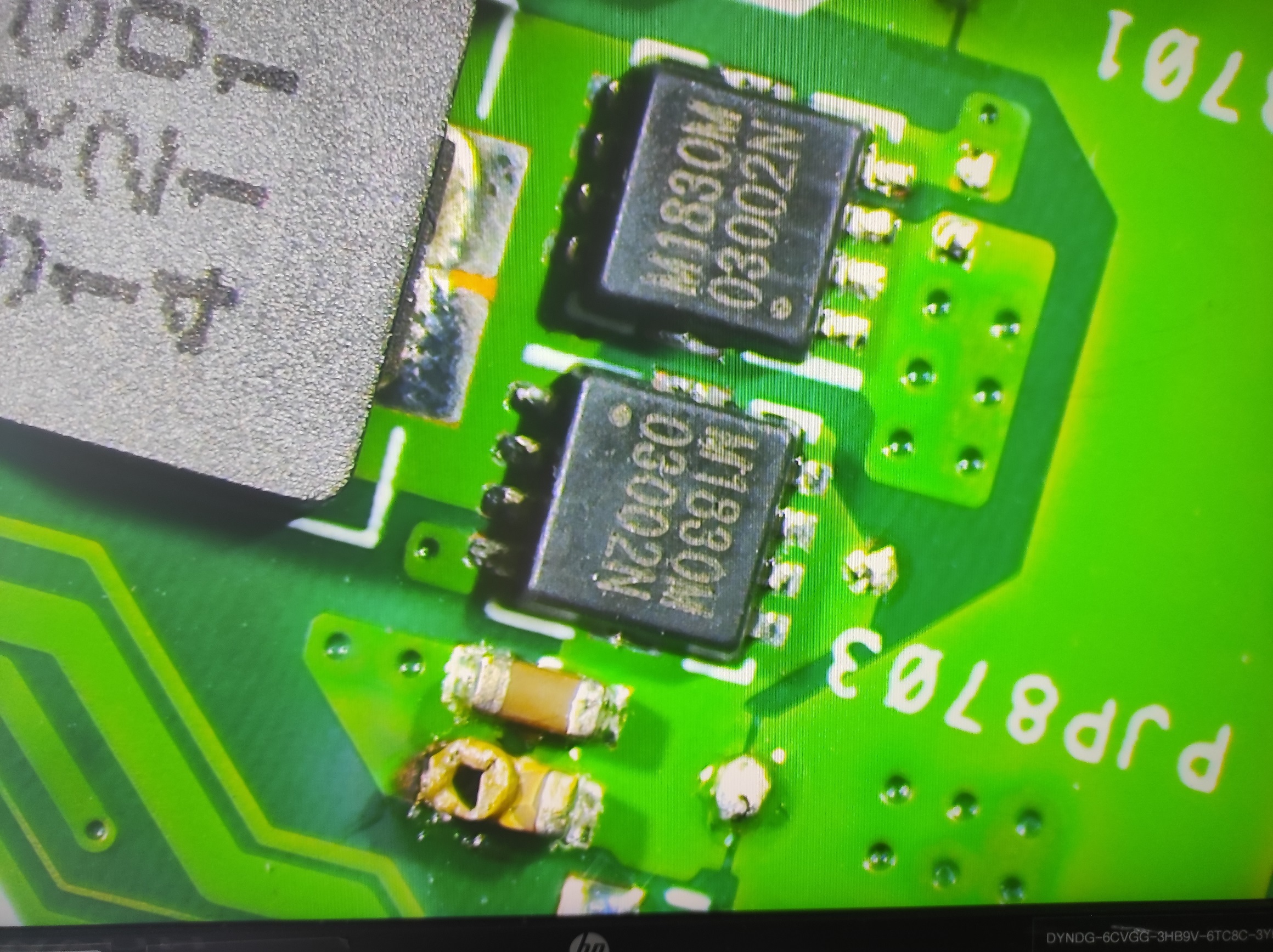

        Re: Power Issue with ASUS A705UA.
        Hello
        As a preliminary note, I must say that I performed about ten startups with both the battery and the power supply connected, and this time I didn't encounter any issues! Nevertheless, I removed the motherboard for an inspection. I'm having trouble locating the two MOSFETs in the main power line because right after the connector, the line goes elsewhere through the board via VIA and doesn't directly come out on the other side of the PCB. However, during the visual inspection, I discovered a melted capacitor. It's not short-circuited, and I tested the two MOSFETs right next to it. The drain of the first one is grounded, which seems normal to m, I believe it's a Buck converter. However, I'm getting an open loop (OL) reading between the drain, gate, and source on both MOSFETs...

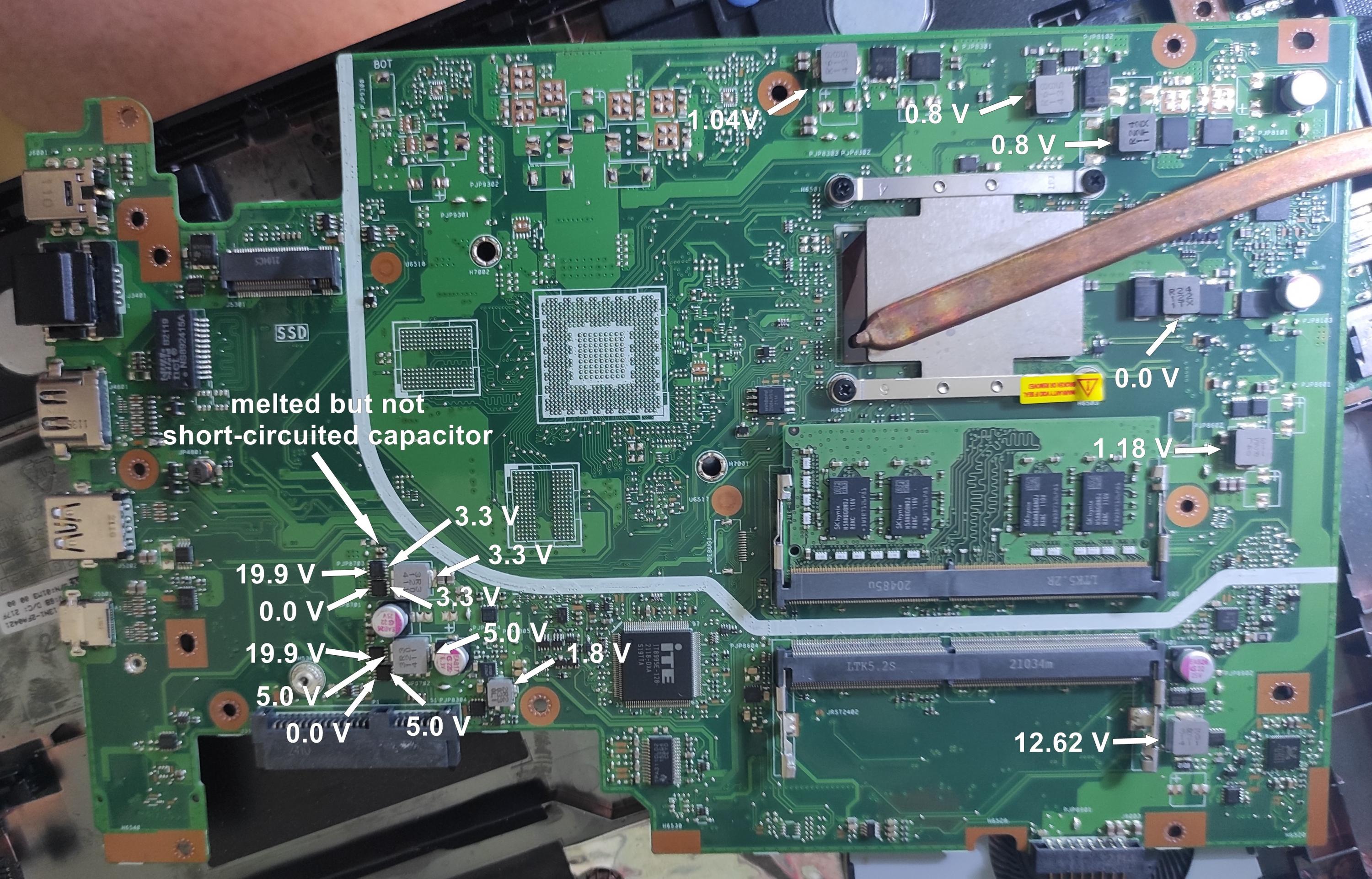

          Here is the voltage reading when the board is operating normally. During these readings, the board displays the BIOS on a screen via the HDMI port, and the board's power consumption is around 0.350 A. If I cut off the board's power and turn it back on, the consumption remains around 0.350 A, without needing to press the power button. Just turning the lab power supply to 'on' is enough. However, the BIOS display doesn't always appear. I have to disconnect and reconnect 2 to 3 times for the BIOS to show up, otherwise it's a black screen. (Core-i3 7100U operating at 58° with the heatpipe but without the fan connected.)
