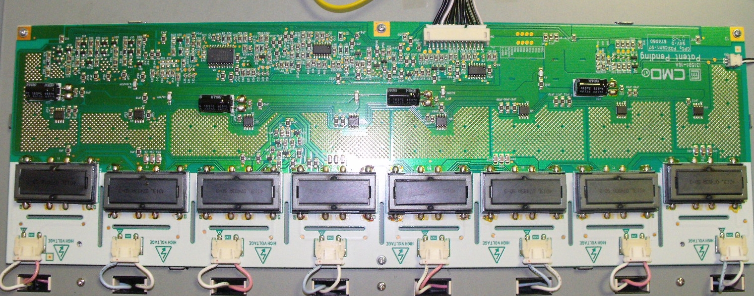

    Sanyo DP32648 Push power and LED on front turns green then the backlight flashes on then goes out. Visually caps look good and I see no hot spots or anything out of the normal. I checked each inverter on the board with a test bulb and all looked fine so I would say not inverter or bulbs so something making it go into protect mode.But what to check next?

    DARFON inverter, so check the transformer secondaries using your multimeter's 20kohm range. With TV unplugged place meter across outer lower two terminals of transformer. Record reading for each.
    Any reading substantially different from any other reading indicates a bad transformer, which can be replaced, they are about $15 each on eBay.

      I thought testing each transformer with a test bulb would show a bad one??

        Not necessarily - if your bulb requires less drive than the panel one it won't show a partially bad transformer.

          Well just checked them all and all are about the same.

                My bad tom66, I took another meter (el cheapo) and did find a bad transformer.
                  Re: Sanyo DP32648 Backlight on/off
                  Got another board and that fixed it! Thanks tom66.

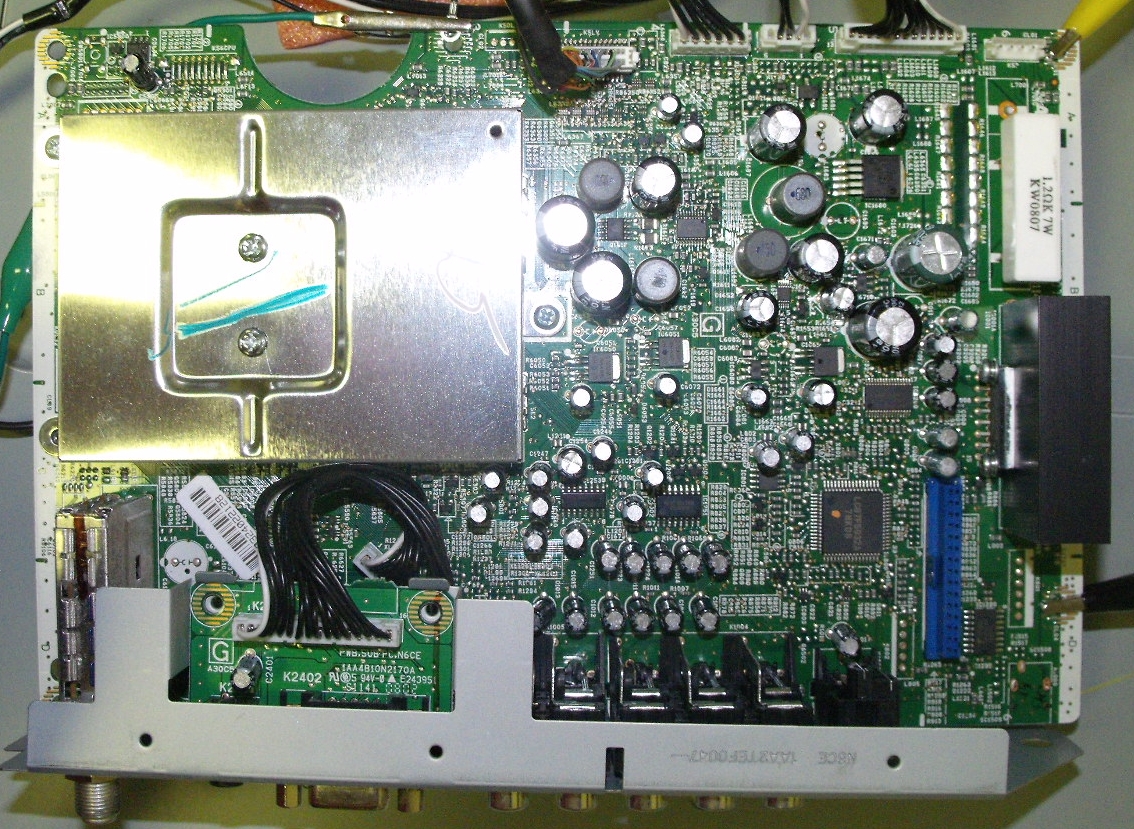

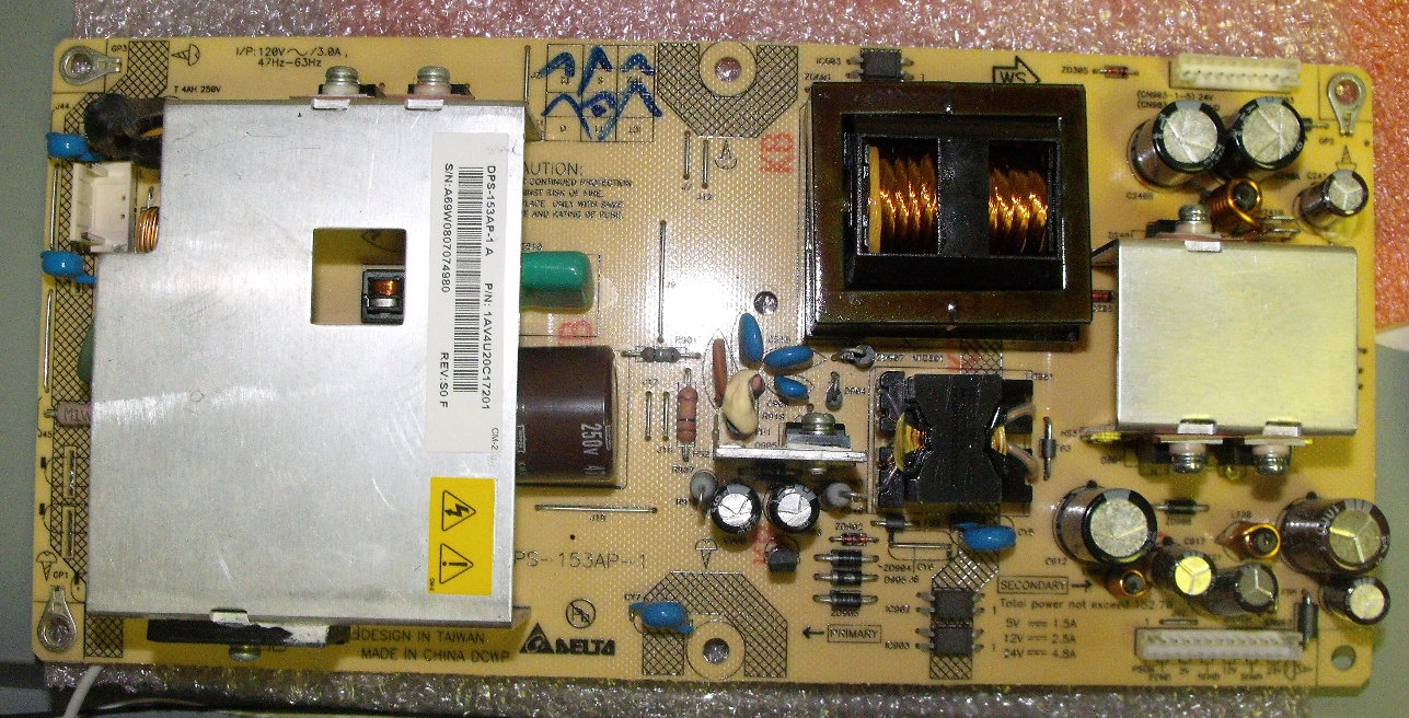

                    CraigR I have the same problem that you had same model which board did you replace the one with the inuts or the tan board in your second picture? Thanks
                      the green inverter board.
                        So the board in your first picture? Sorry I am new to this.and would like to try to fix it before I purchase a new one. Thanks
                          Last pic.
