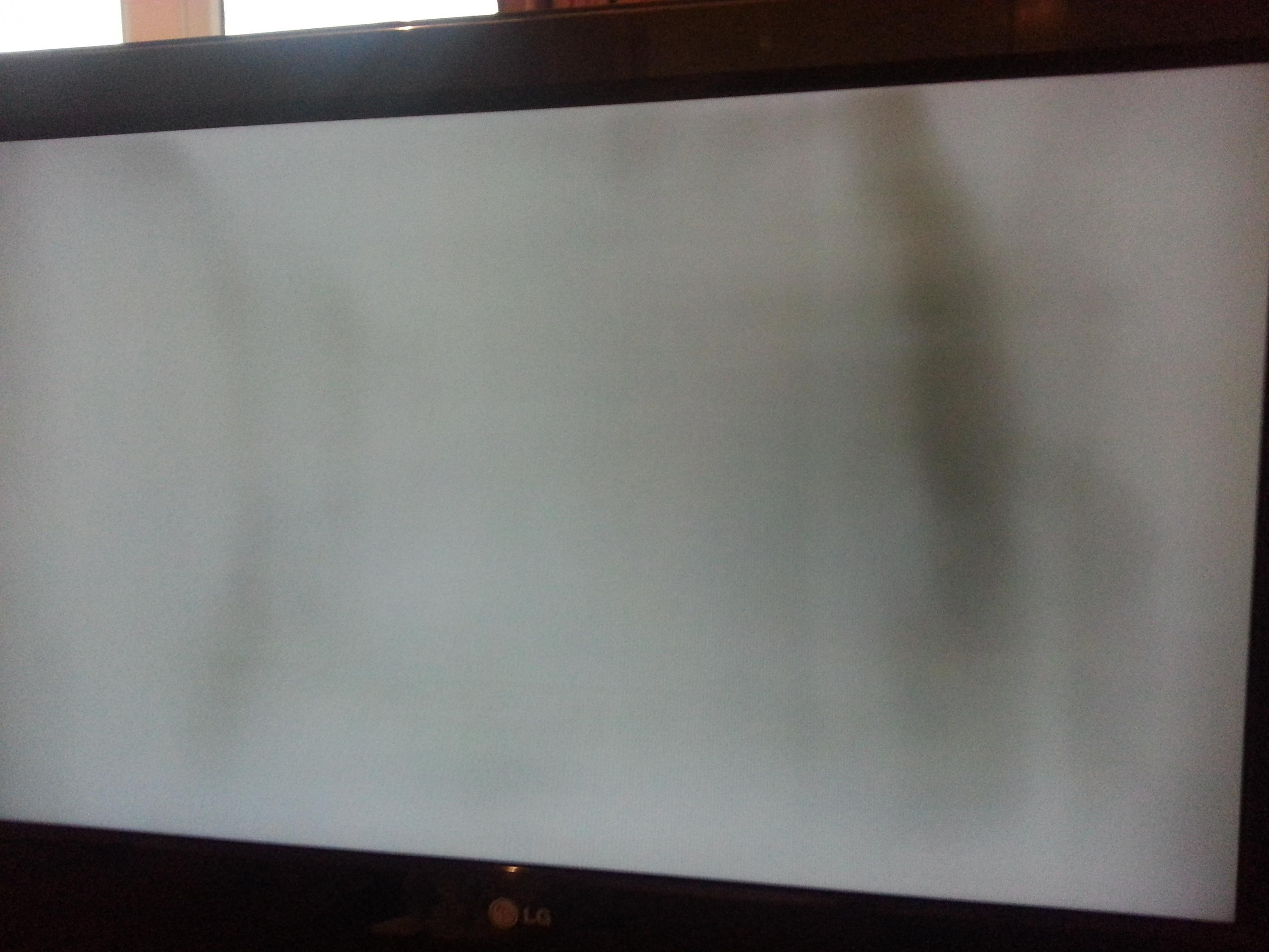

    lg lcd 32 shaddow on screen
    Any one any idea how to get rid of these shaddows
    • 31185
    Re: lg lcd 32 shaddow on screen
    i call that "bruising",
    it's caused by pressure damaging the glass sandwich afaik.
    i'v also seen what looks like a liquid-stain in one corner once that i think is caused by ecessive heat.
    i dont think you can fix it.
      I've had a few like that from my experience it cannot be fixed.
      • adamp91gvm
        • Jan 2014
        • 706
        • uk
        Dam just made it work it would not turn on
          For future reference would you share what you did to make it work?
          • adamp91gvm
            • Jan 2014
            • 706
            • uk
            Yer it was only a cap change so did not think it was worth it swollen caps
              Was it a 32LC5D or 32LC7D?
              • adamp91gvm
                • Jan 2014
                • 706
                • uk
                32lc46
                  Ah KK, yeah, same generation as the 5D/7D.
                  I had a 42LC46 with bad caps and it had no screen issues... guess it's just bad luck.
