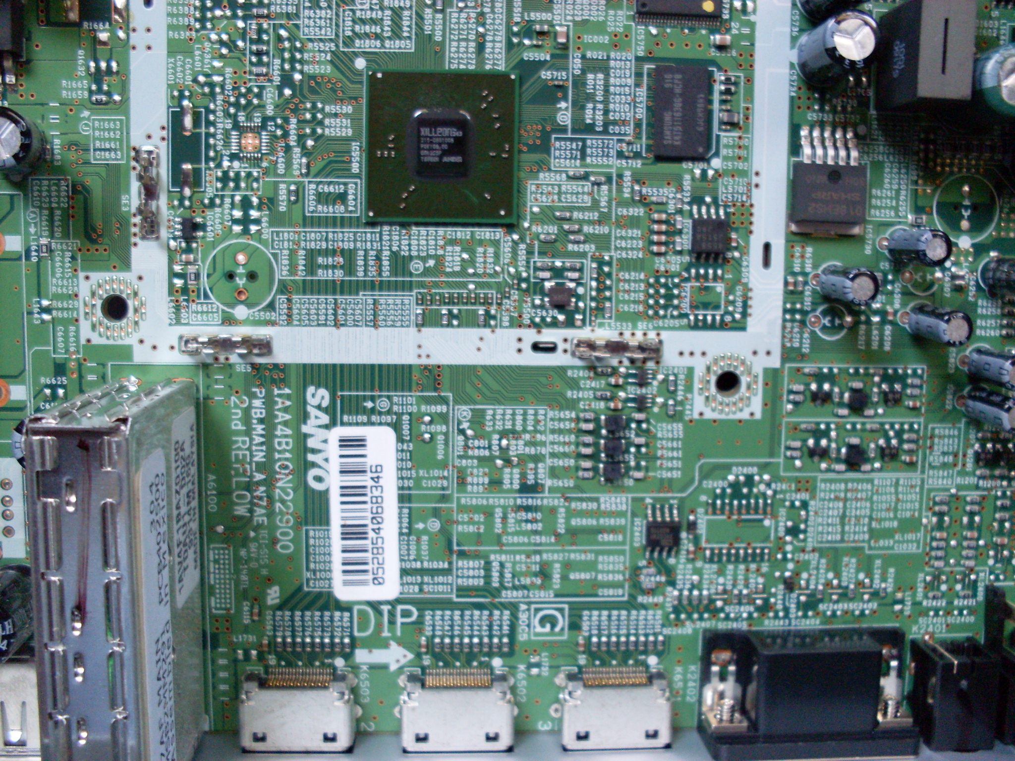

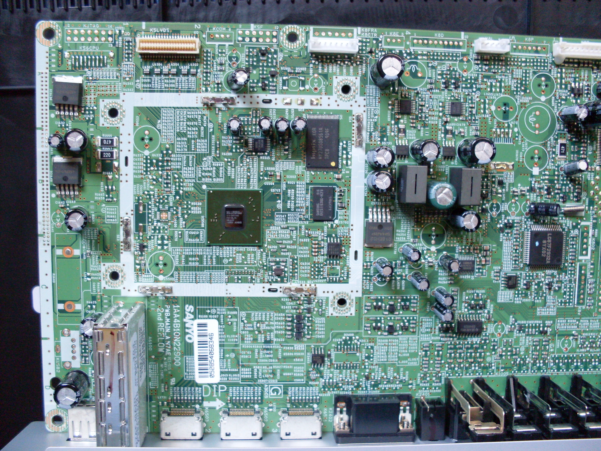

              Would you be able to help me identify where it is?

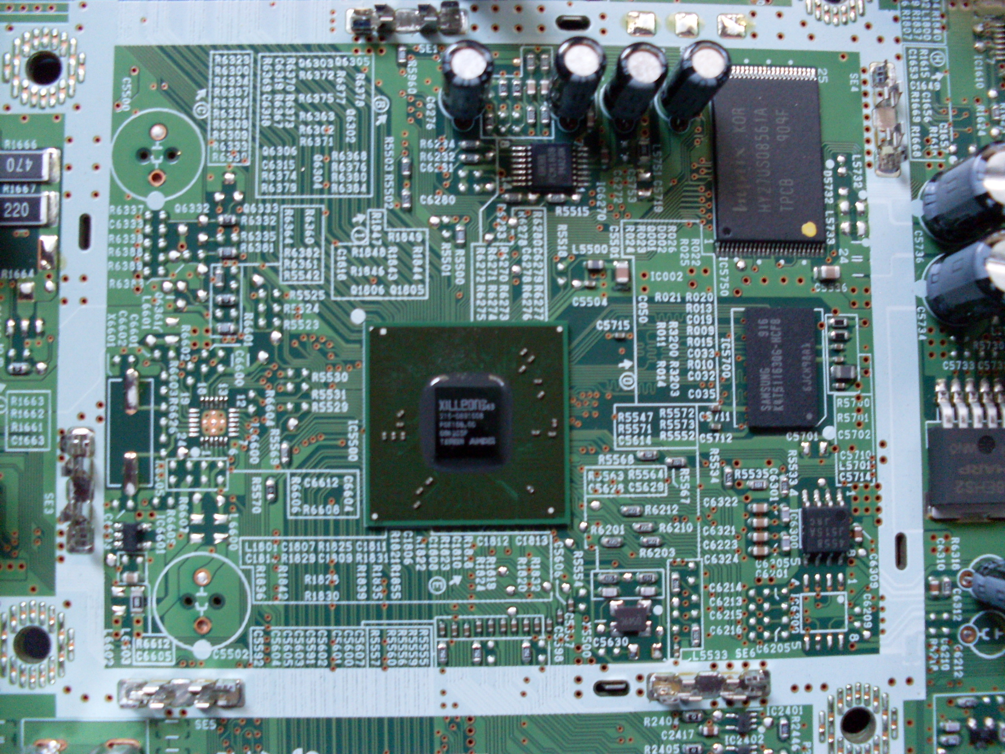

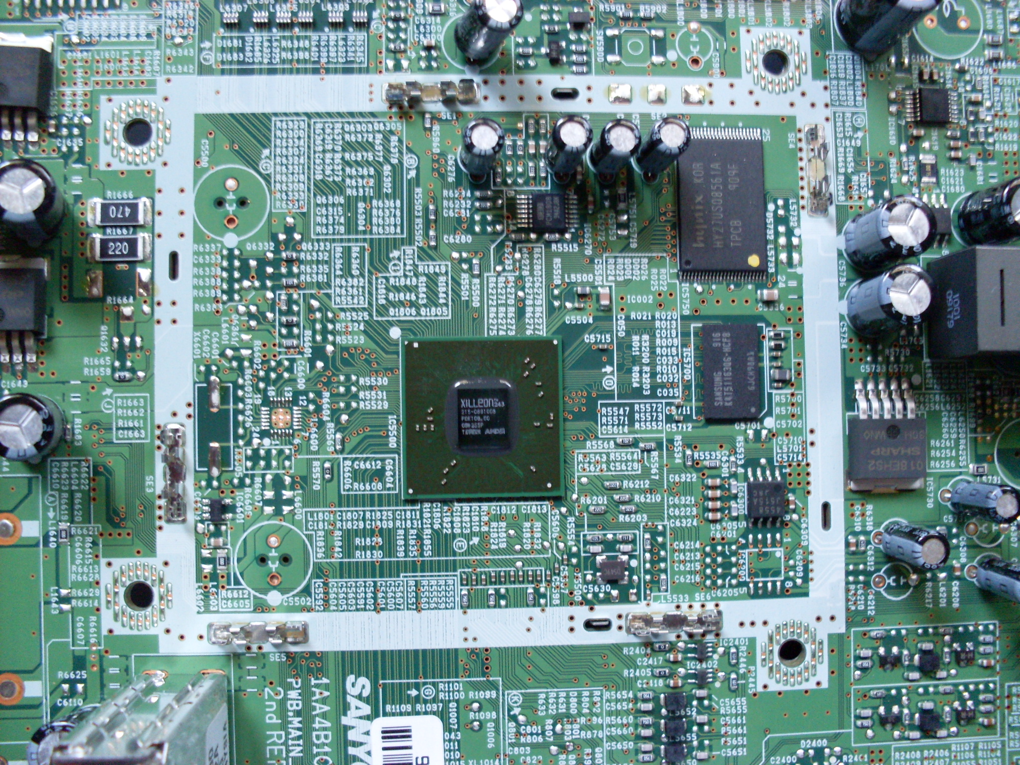

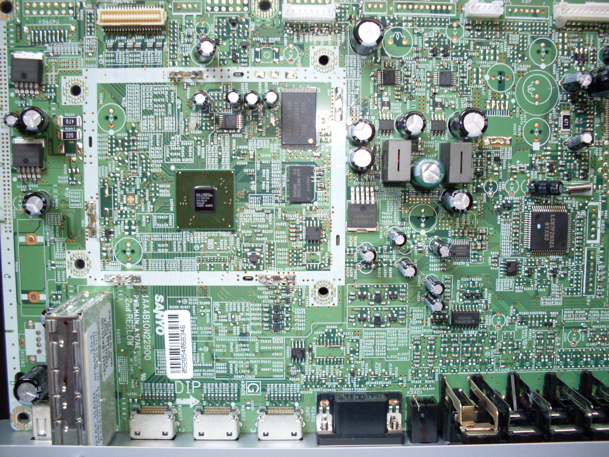

                Re: Sanyo DP42849 - HDMI Doesn't Work
                Think the HDMI chip is buried under the shield, which I hope comes off with some screws...
                • NihonNoir
                  • Jan 2014
                  • 231
                  • US

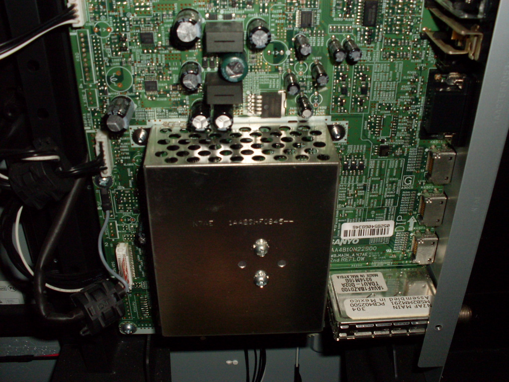

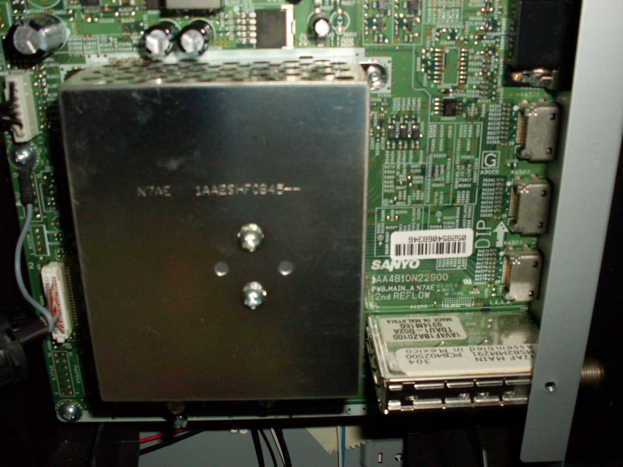

                  . . . knowing this stupid TV, who knows? It's one difficult thing after another with this beast.
                  Can you tell at all from this pic? Looks to me like there are some screws holding it to the board . . .
                    Yeah, I'm just hoping only screws, not solder...

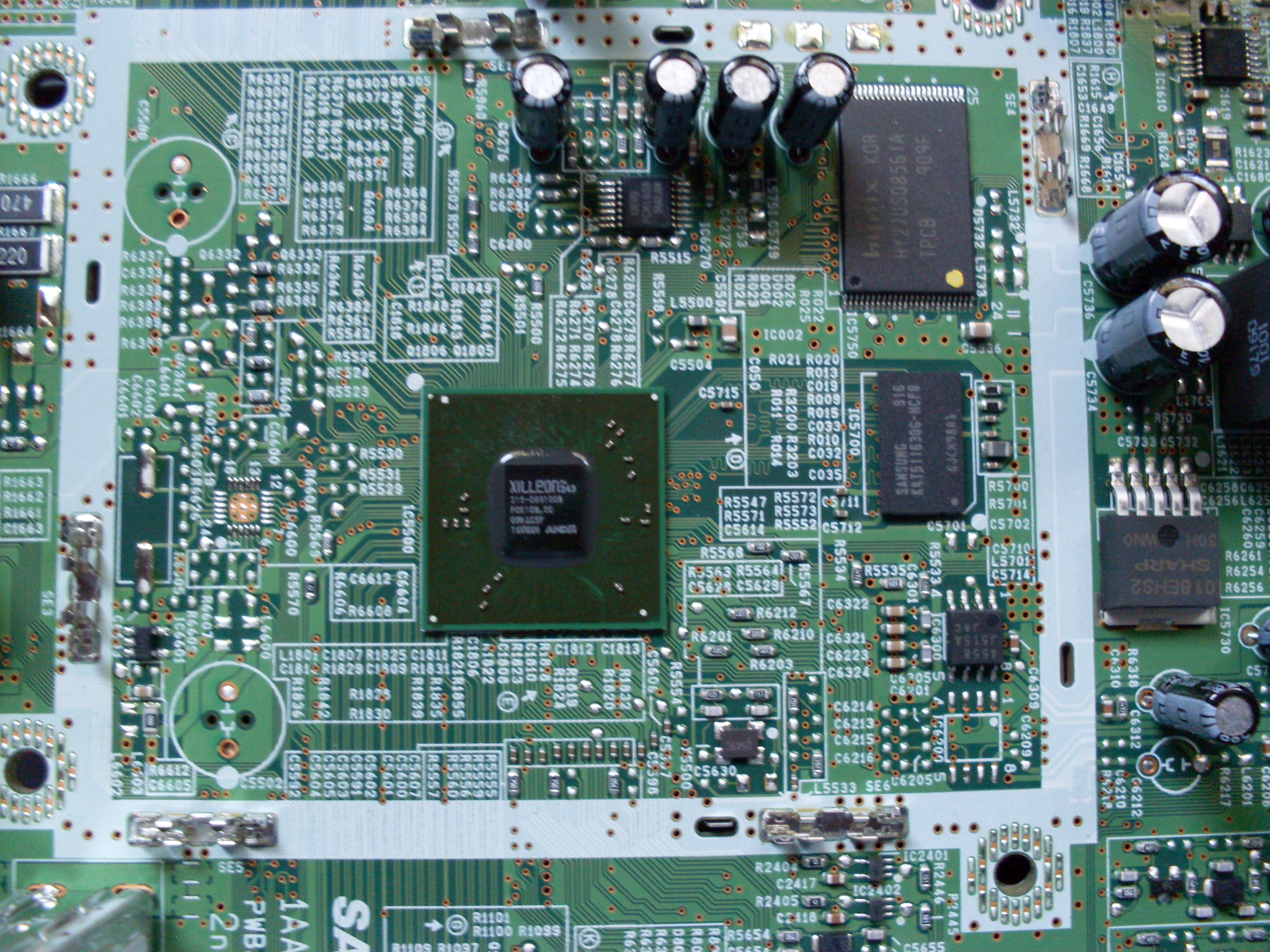

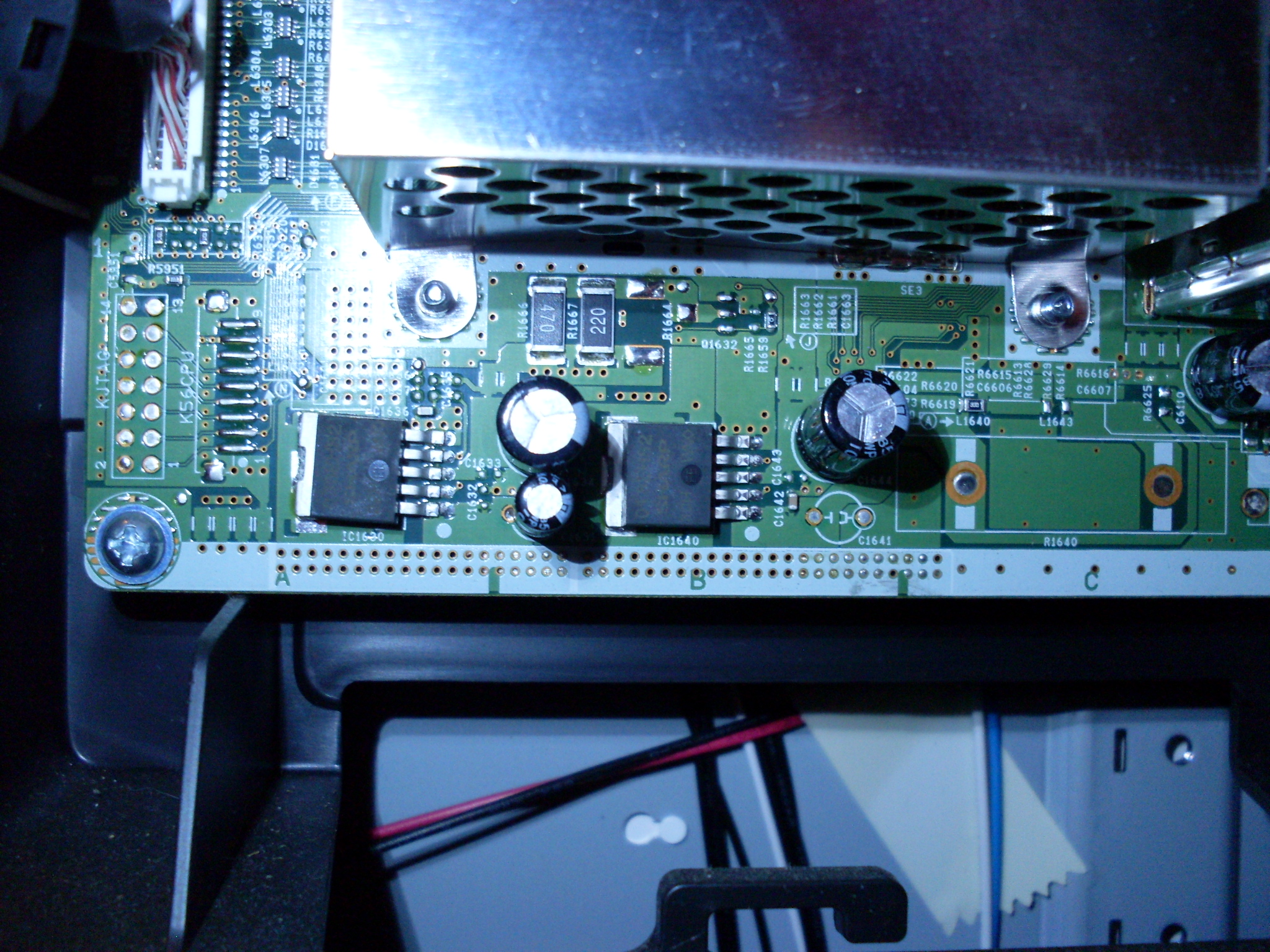

                                      Finally found some time to mess around with this TV again. The shield does come off easily - here are some photos.
                                      To recap: this is the television that didn't work at all, likely as the result of a power surge. Got it working, but none of the HDMI ports work.
                                      Component works, but it has trouble displaying darker colour saturation without pixelating. Not sure if that's normal for a large TV, or if that's an issue with this particular model, or what.
                                      Any ideas would be helpful, thank you.
