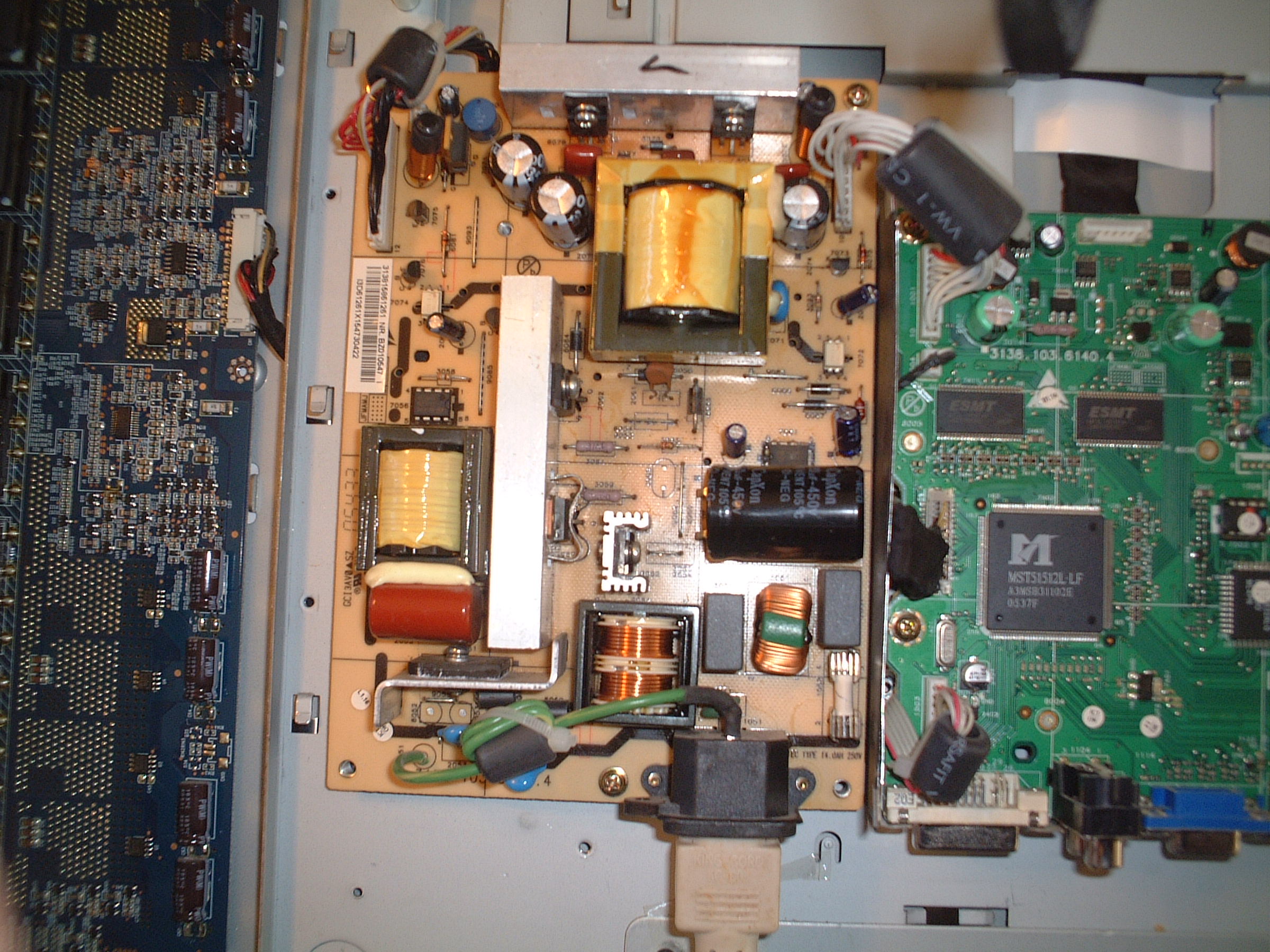

    magnavox 32MF605W TV wont turn on pwer light goes to green and right to orange. ireplaced caps on powerboard and then replaced the board. still the same
  • Dgtech
    E. Technician
    • Apr 2009
    • 1462
    • Steeler

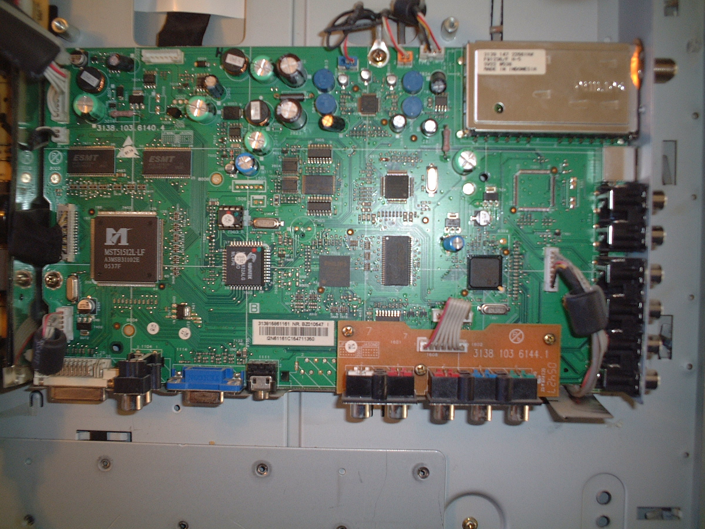

    Re: magnavox 32MF605W TV wont turn on
    Add pics of your boards. We go from there.

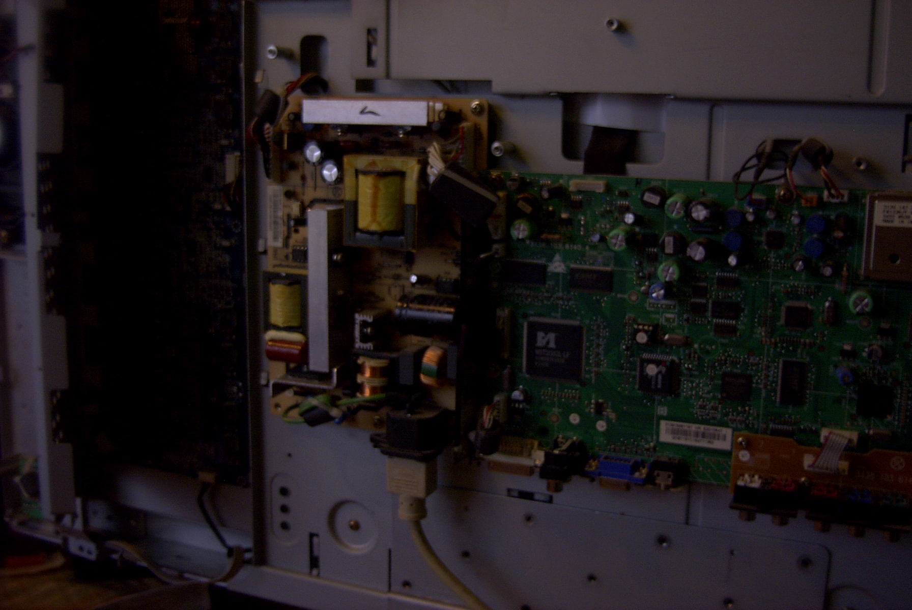

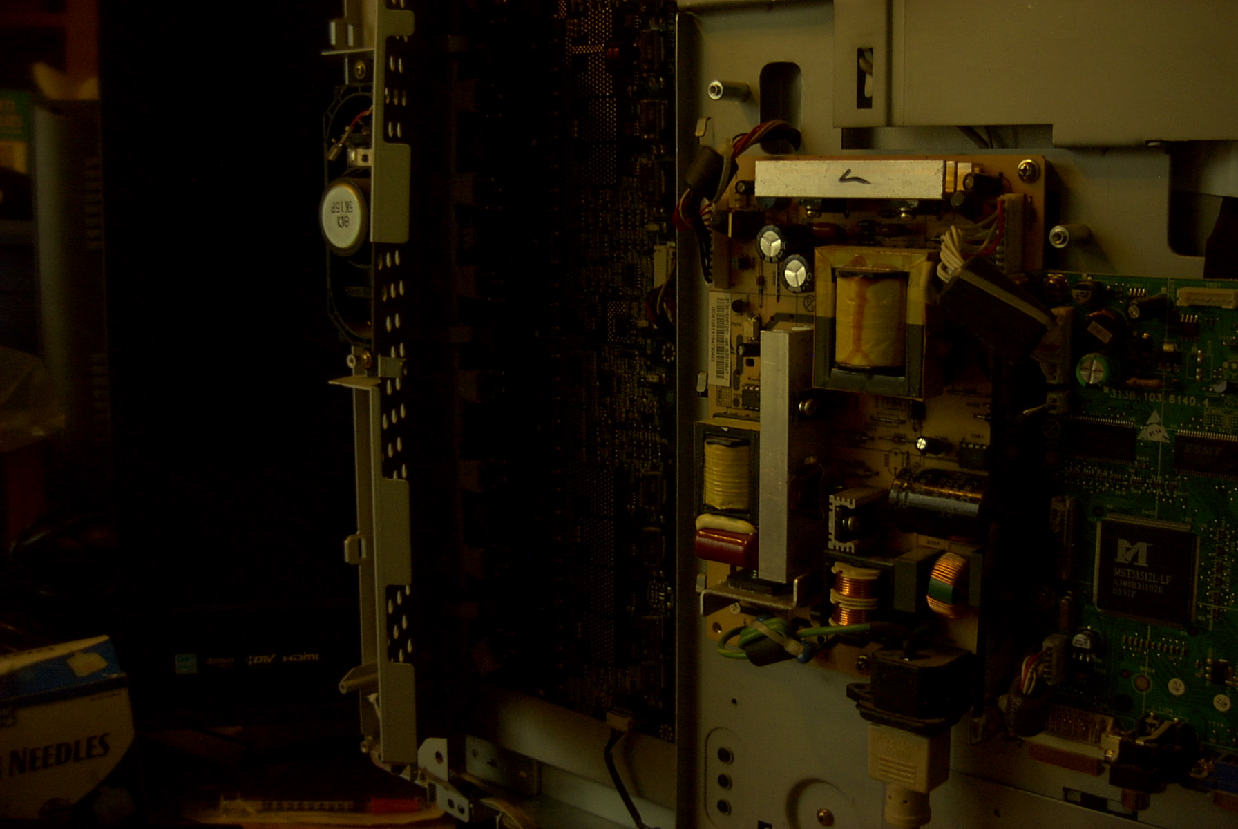

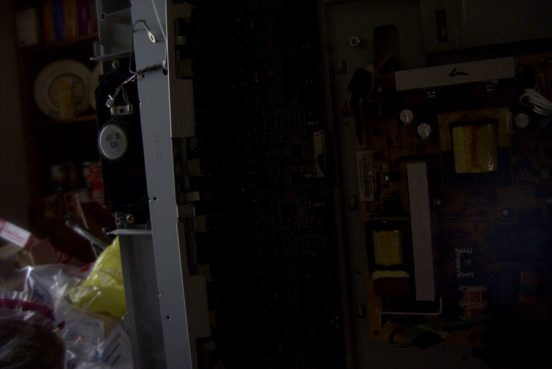

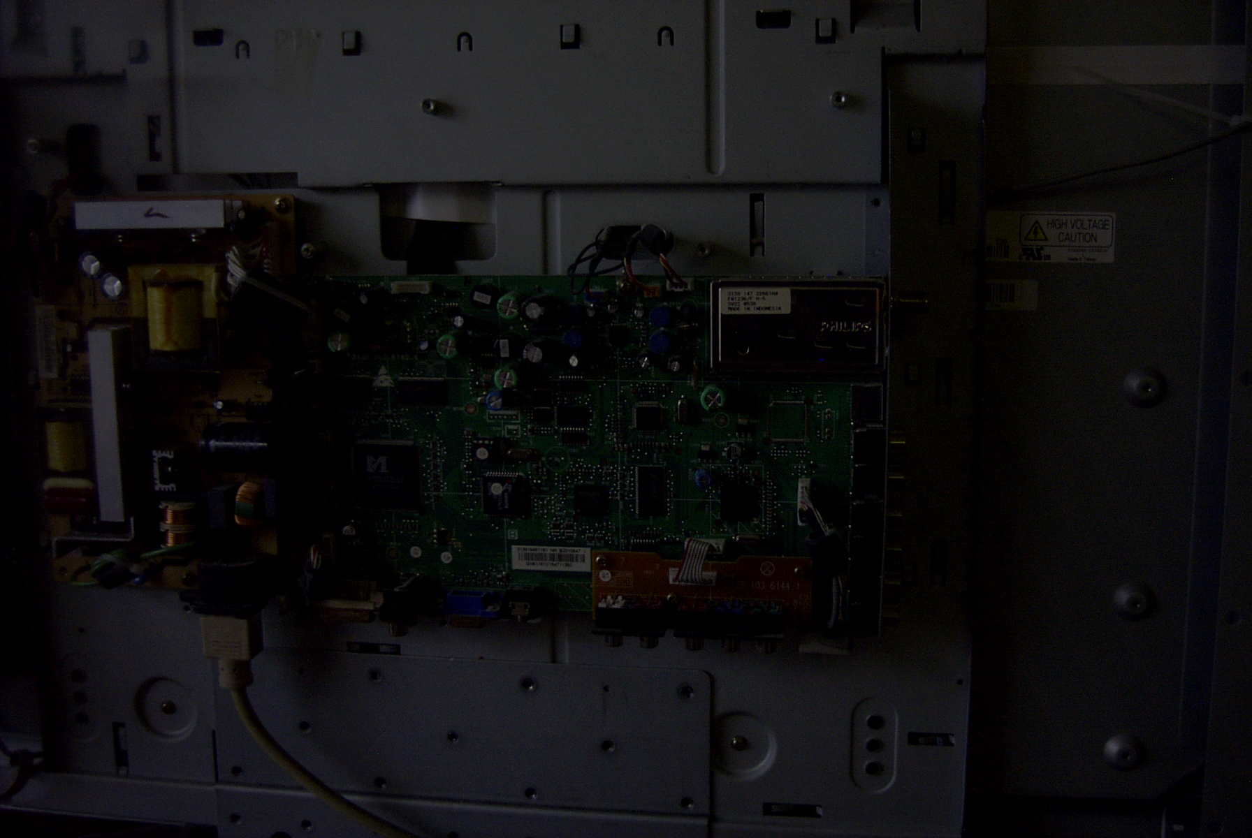

      best i can do
        Sorry, but those are nearly useless. Can you get some sunlight on them? Or turn on the room lighting? Avoid flash - it tends to reflect off too much metal.

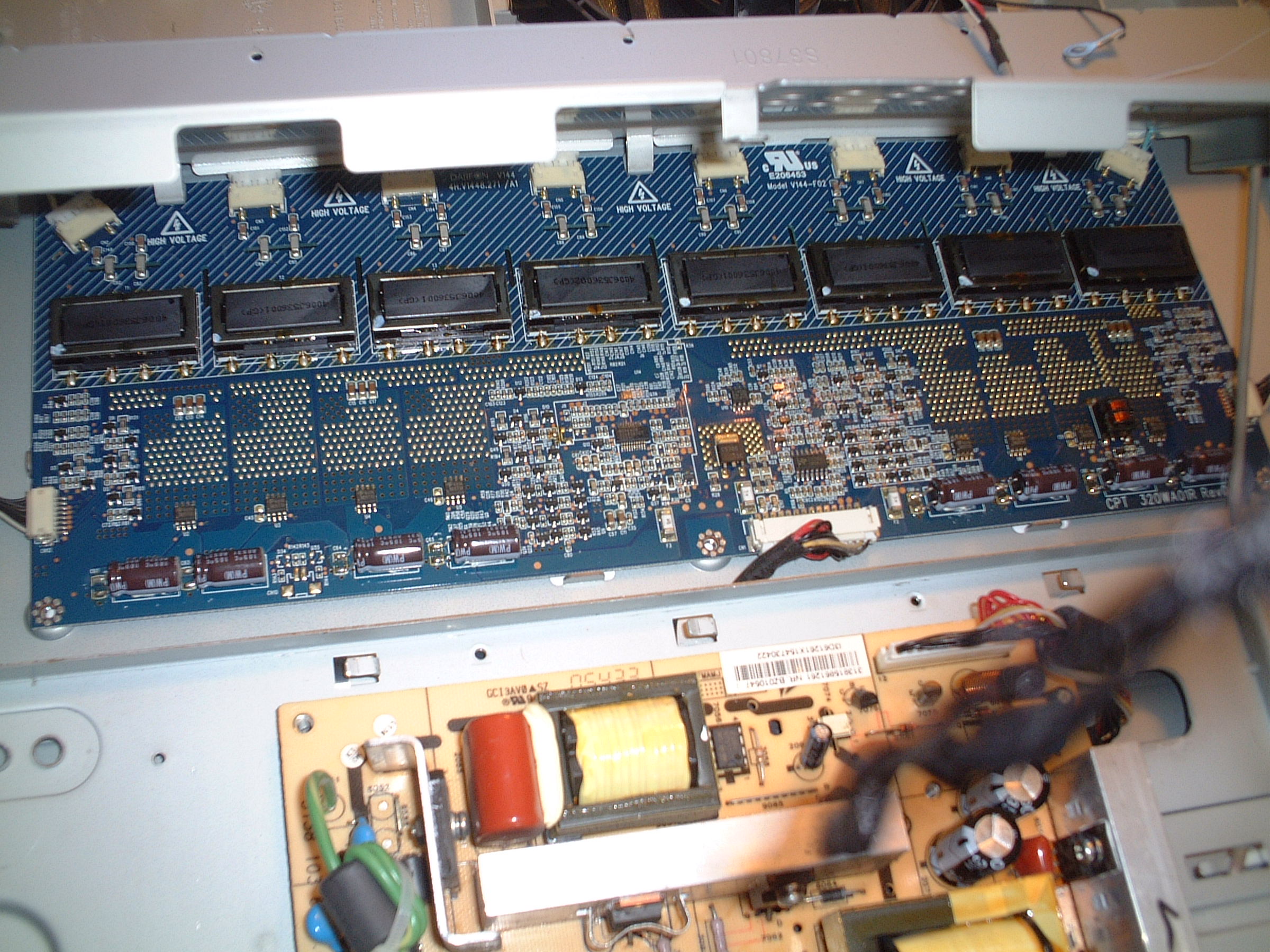

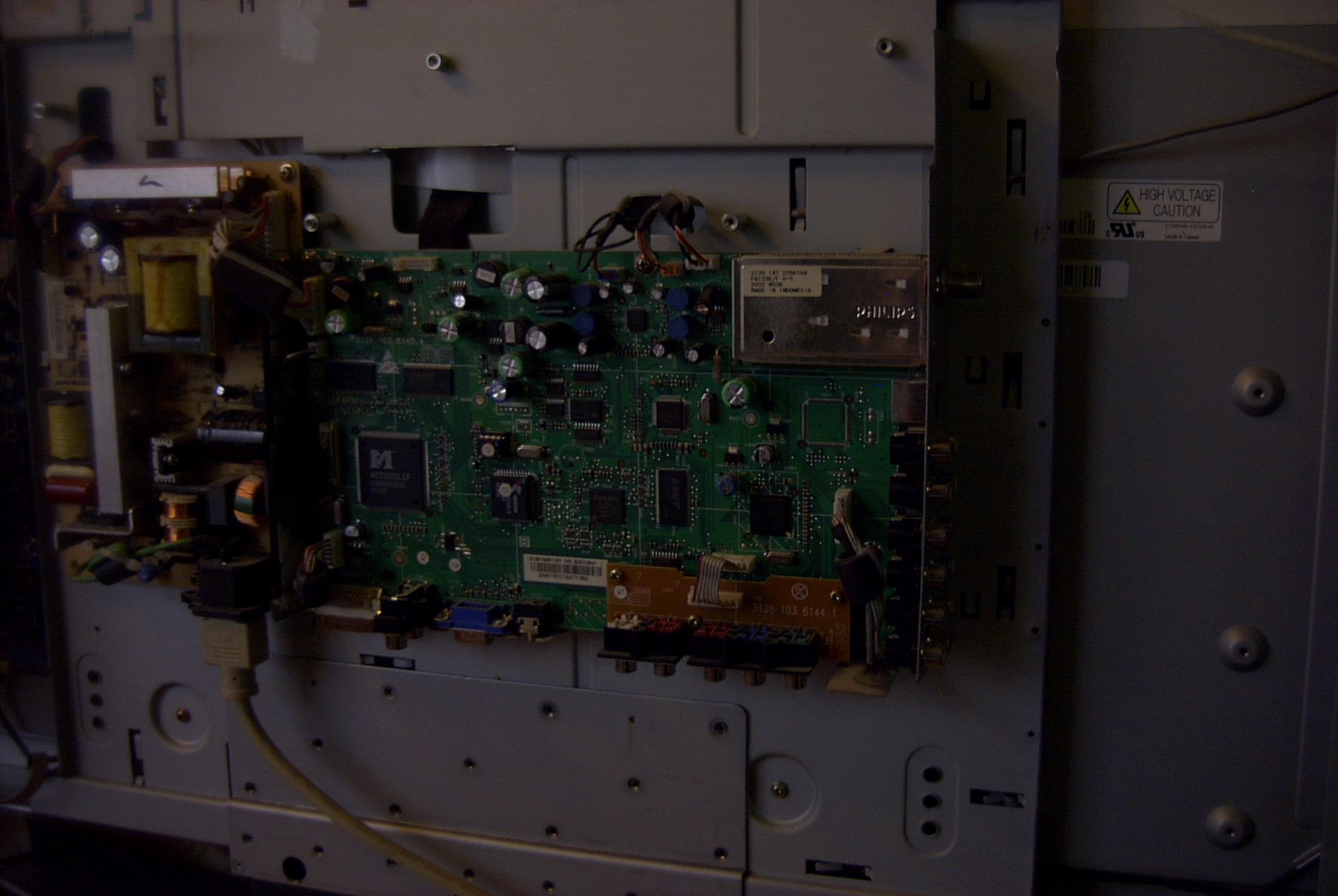

          some more pictures
          • jack1
            • Mar 2013
            • 30
            • usa
            got another camera
              OK, we can work with those.

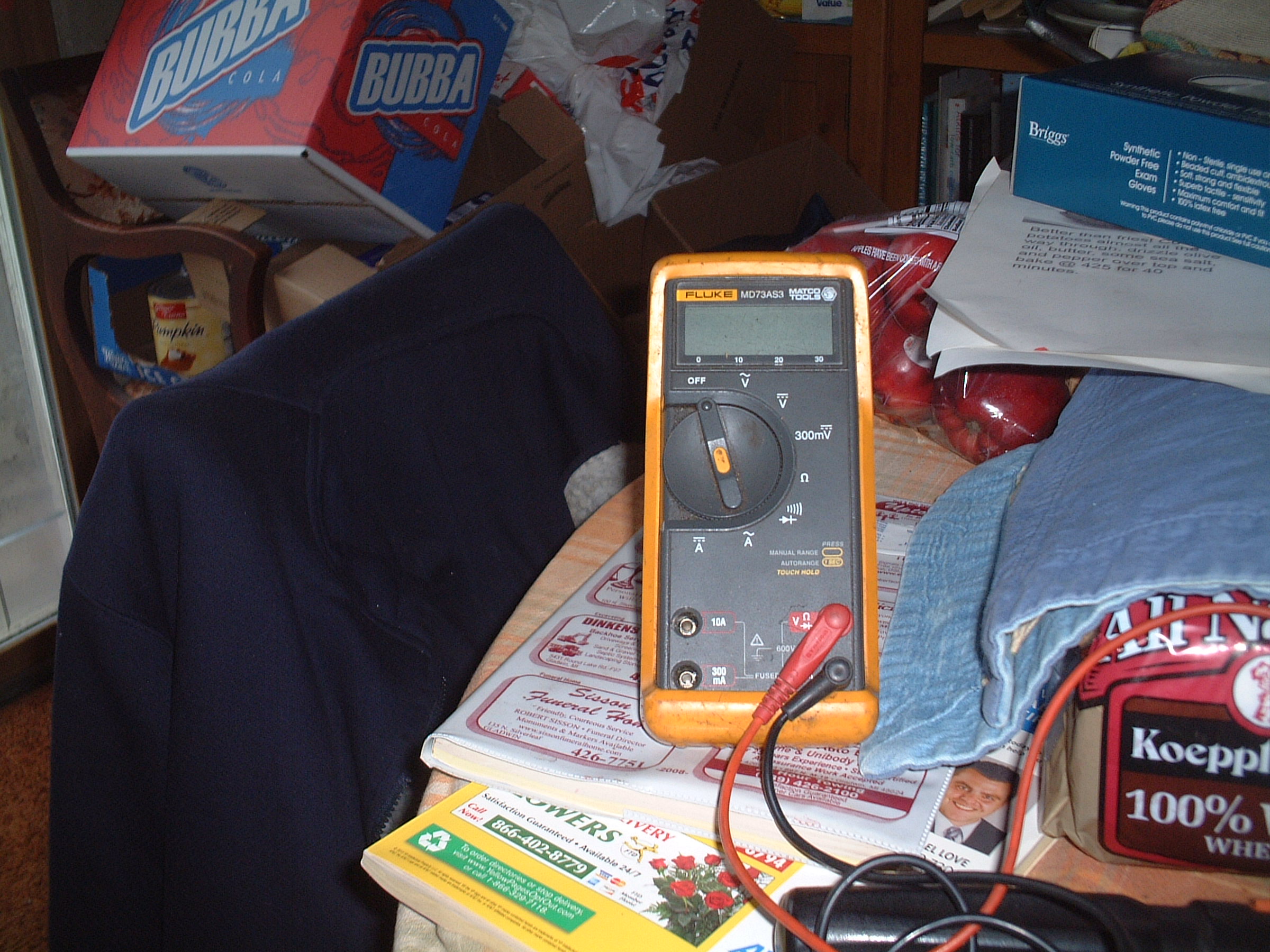

                                  checked with battery.used my fluke meter. still 3.0 on all 9 connectors not 8 and also checked bottom connector to mainboard same. meter has one setting for ac. here is a picture
                                    thanks for help. sorry if i am doing something wrong .no offence. i discovered something new .i pushed the menu button and green light stayed on so i hooked dvd to component and i now have sound but black screen and no backlight. original problem was power supply and that is good. any idea what to do now
                                      You must use volts DC, which is one click to the right of volts AC.
