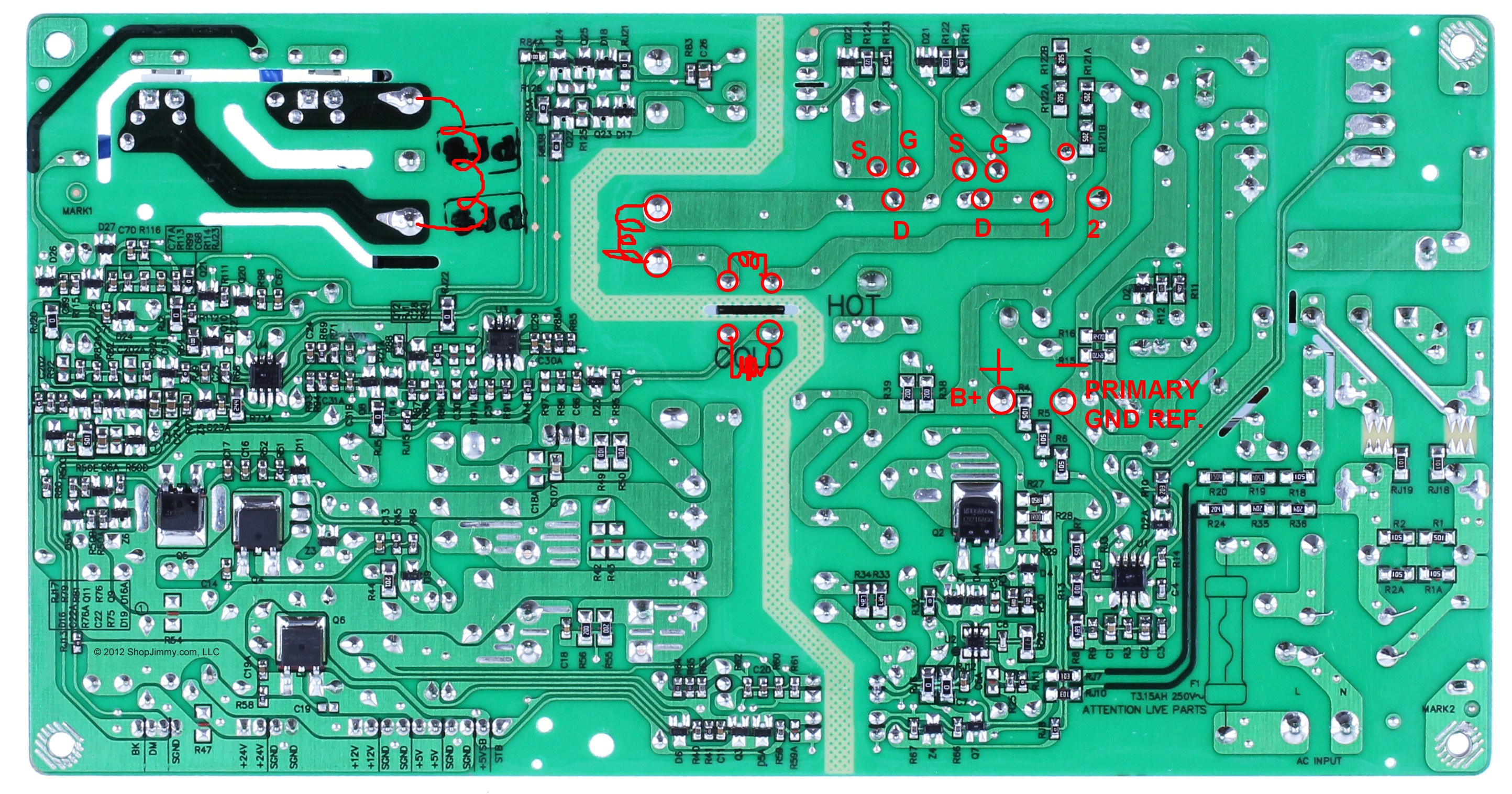

    OK, check the resistance between #1 and #2 (I do not know if it is fusible resistor or jumper wire).
      Re: Sceptre X32
      when I have my multimeter set on ohms for resistance my meter beeps as if it has continuity
      both with power off and power on
        Re: Sceptre X32
        Fuse is OK, could be one of those red poly caps is bad, or the driver IC is not driving the bulbs. My bet would be on the red poly caps.
          Re: Sceptre X32
          when I check across points1 and 2 that is.
            Re: Sceptre X32
            Yes, those two caps are part of the bridge drive circuit for the inverter transformer. If you have the scope, you will need to find out if there is GATE drive signal from T2 or not.

                  before I do that, should I take both of the red caps out of circuit and test them with my esr meter? or are they different that I cant test? I have only tested electrolytic capacitors up to this point with my esr meter.

                      An ESR meter can't test those, but if you have an ordinary capacitance meter it probably can.

                        mip320fl-t3 transformer is bad but finding a replacement is almost impossible because they don't sell just the transformer everywhere i looked. just spend the $34 and buy a mip329fl-q3 new power/inverter board. thats from china so it will take a while for shipping. what is the resistance between the 2 output pins of that transformer around 68 ohms? if you do by a new board compare the resistance of the old 1 to the new 1.

                                I just ended up buying a new power supply/inverter board on ebay, the mip329fl-q3, which looks like it may have some improvements over the one that failed. FYI.
