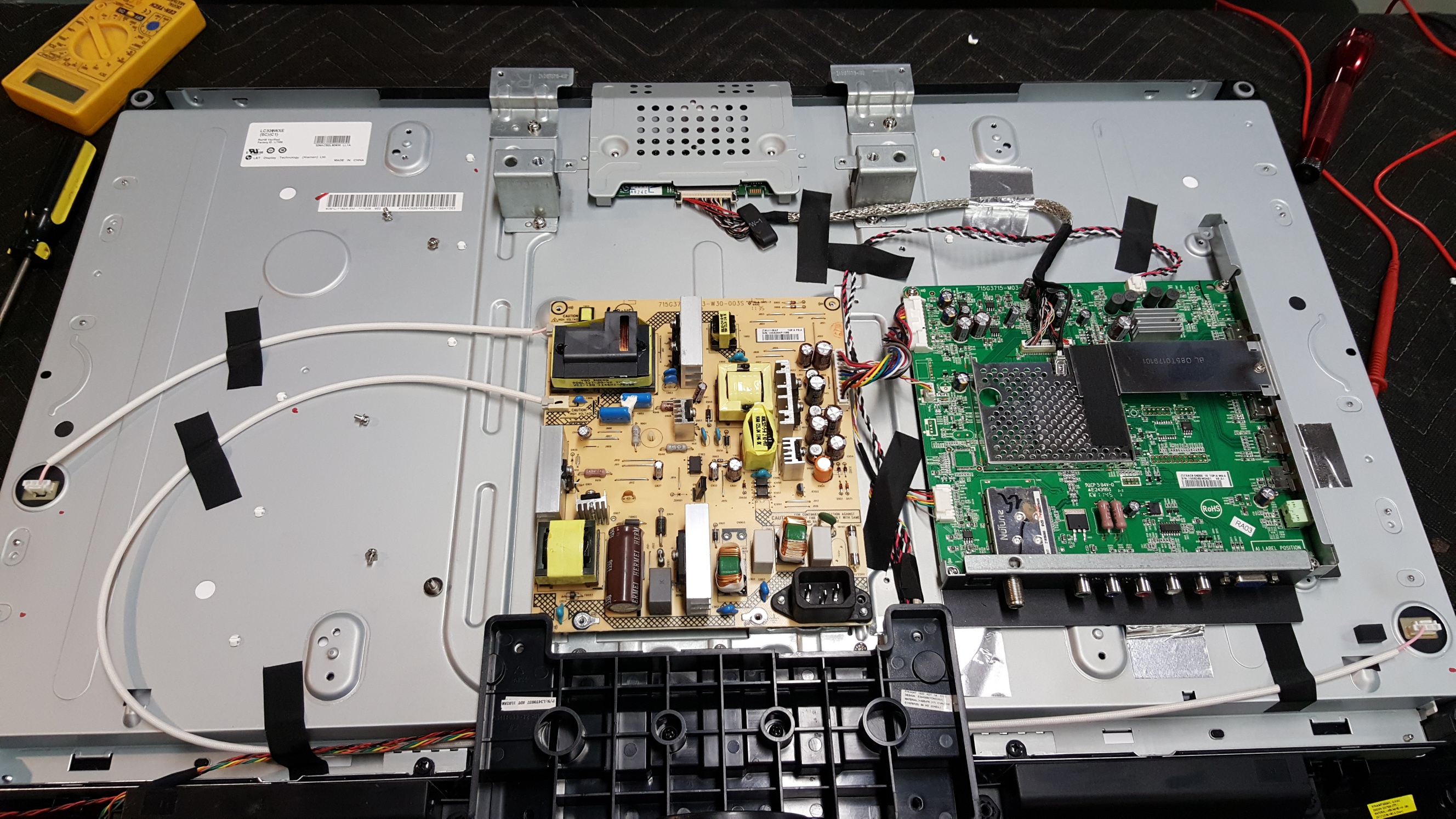

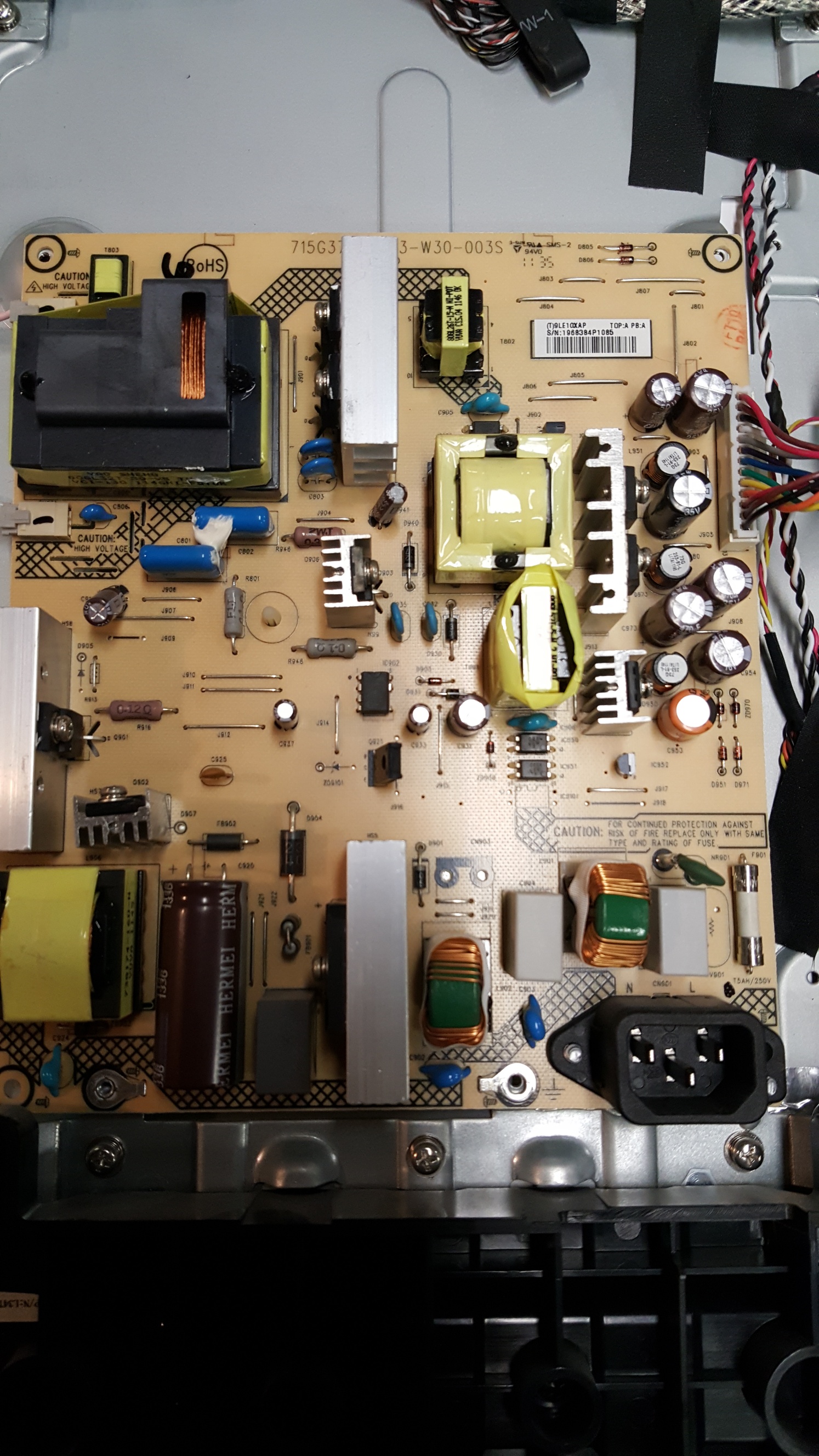

              Need good clear straight on pictures of back of tv with cover off and each board.
              • starmatter
                • Jun 2017
                • 9
                Re: Help with Vizio E320VA power board
                Here are some pictures(attached).
                Thanks,
                pw
                      Have you checked the fuse F901 for continuity.
                      What voltage do you have with the meter probes connected to each pin of the large capacitor C926.
                      • starmatter
                        • Jun 2017
                        • 9
                        The fuse F901 shows good. I don't see a C926 but I do see a rather big one C920. I got different readings between different meters for some reason. I have two cheep ones and a more expensive one. ALL three of them read the same between the fuse F901 & ground which is roughly 110-120VAC. But between the + side of C920 & ground my two cheep meters agree at roughly 120VAC but my more expensive one reads around 74VAC.
                        Thanks for your help!
                        pw

                            You are making Voltage measurement in the Primary hot side of the circuit so do not use chassis GND as the GND ref. for the meter, you need to use the negative leg of the main filter cap as the GND ref for the circuits in the primary side. The fuse is good otherwise you will not get any DCV on the output connectors in the cold side of the circuit.
                            Main filter cap C920 should have 380~400VDC between the two legs of the cap.
                            Fusible resistor R801 is good, showing <1 Ohms or so?
                            Right now I would say you do have main board problem because you are not getting VIZIO logo on the bezel to even come on.
                                The big green board with the input/output connectors.
                                Right now the DCV on the main cap should be close to 400VDC if the PFC Voltage booster is working, so you have more than one bad boards.
                                BTW, Does PS-on Voltage change state at all when the power switch is toggle on-off?
