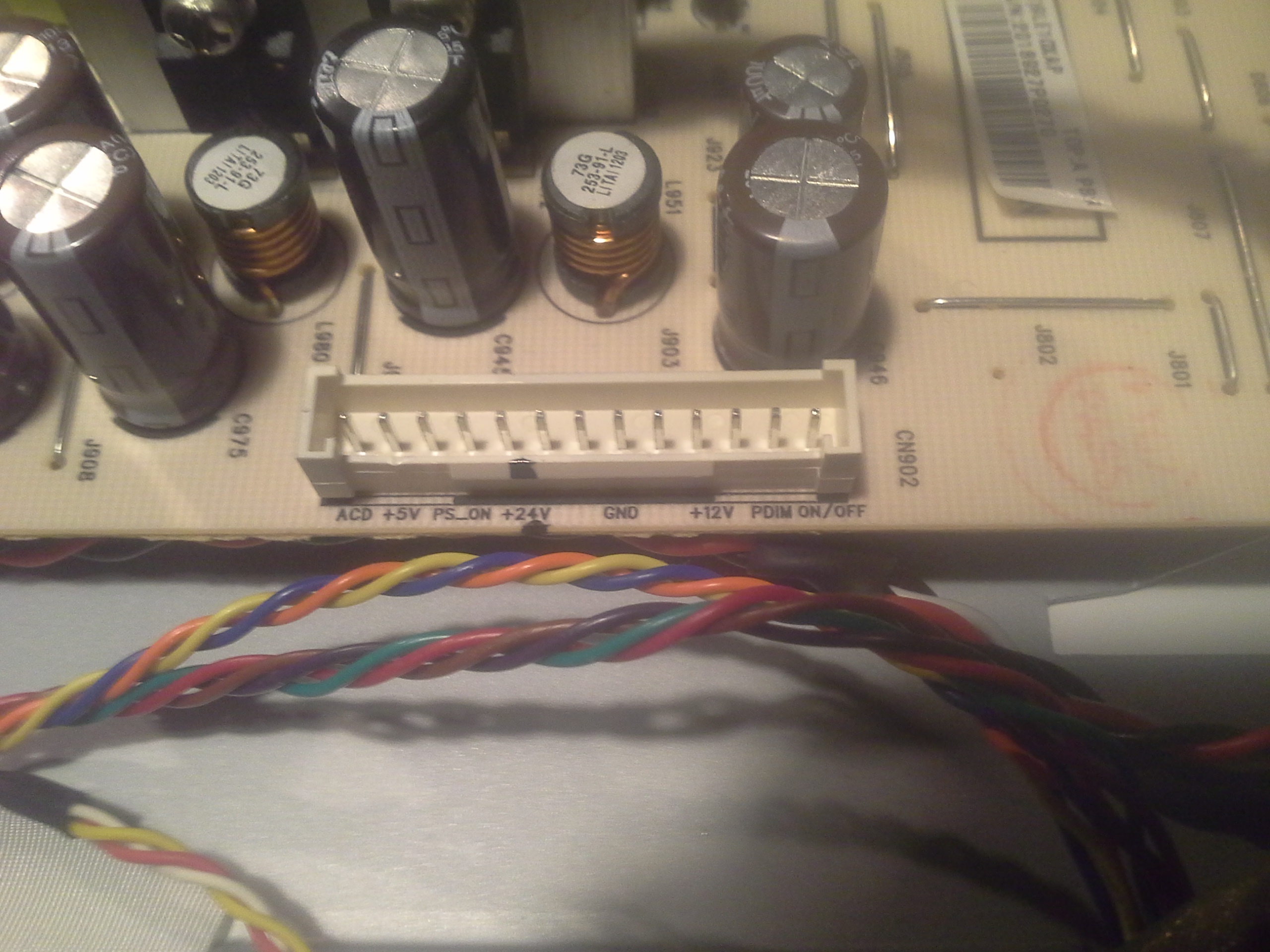

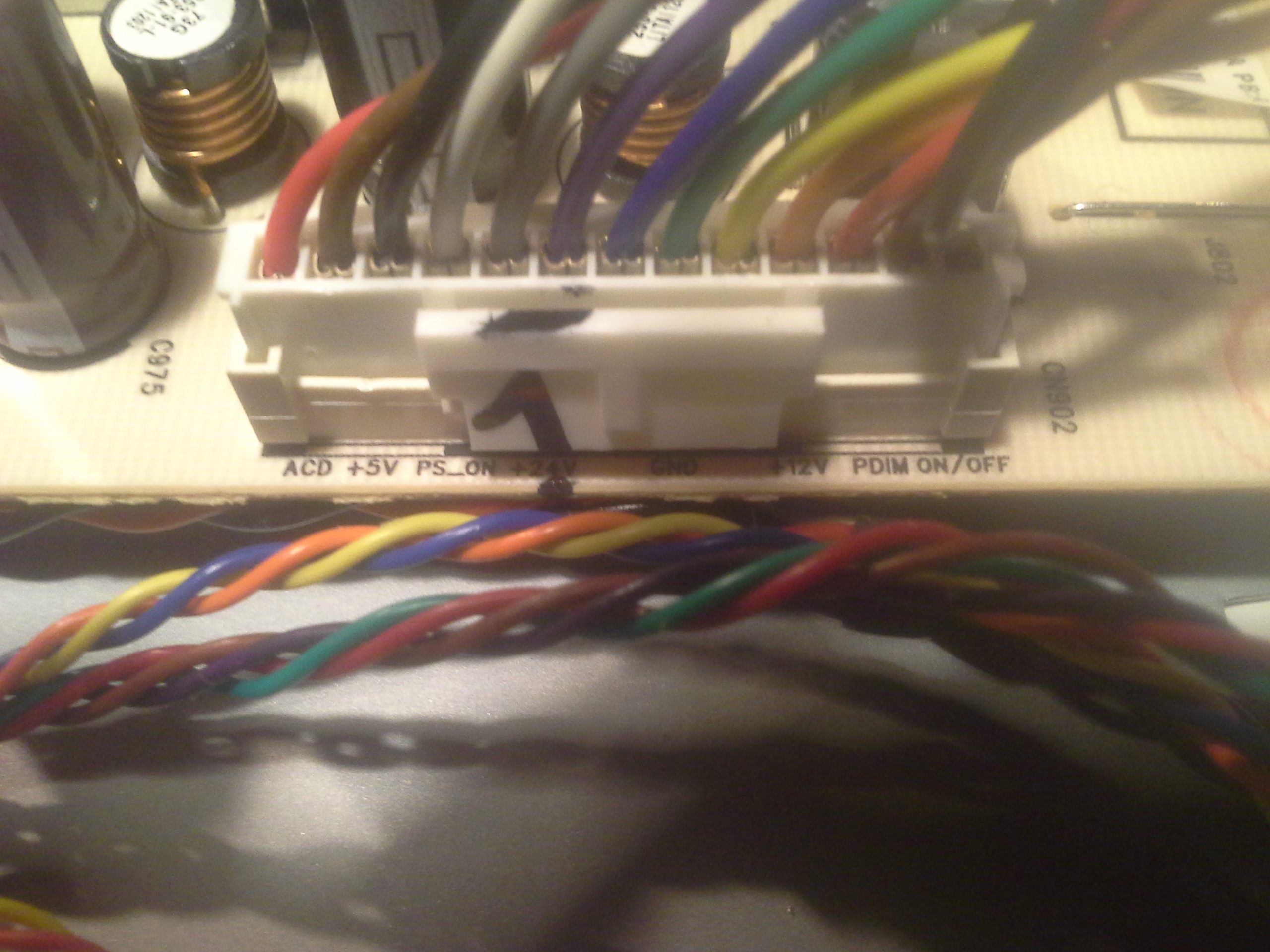

          Re: Help with Vizio E320VA power board
          Thanks for the reply
          For reference:
          I attached pics of the molex we're talking about.
          I'll measure the voltages later hopefully ...
            The set never turns on. The VIZIO logo on the front never illuminates.
            The remote control is functional (tested it with the cell phone camera).
            The manual power switch on the side, I'll assume to be OK.
            Below are the measurements:
            black off ---
            brown PDIM ---
            Red 12+ 12.3
            orange 12+ 12.3
            yellow gnd ---
            green gnd ---
            blue gnd ---
            purple 24+ 24.8
            gray 24+ 24.8
            white PS-OFF 2.9
            black 5+ 3.2
            brown 5+ 3.2
            red ACO ---
              So the main board is sending the PS-ON to turn on the main power supply which is OK because you are are getting the switched 12V and 24V, but the main board is not sending the BL-ON (ON/OFF), or Dimming control signal.
              ACD (Incoming AC detect to tell the main board if the incoming AC is within the operating range or not) is at 0V which I am not sure if '0V' is = normal AC or >2RVDC is = to normal AC or not.
              I do expect the Vizio logo to be on if the main board is good.
              You can try disconnecting the ACD wire from the power supply board side and then use 1K resistor between 5VSTBY and that wire to simulate the ACD signal feeding the main board to see what will happen.
