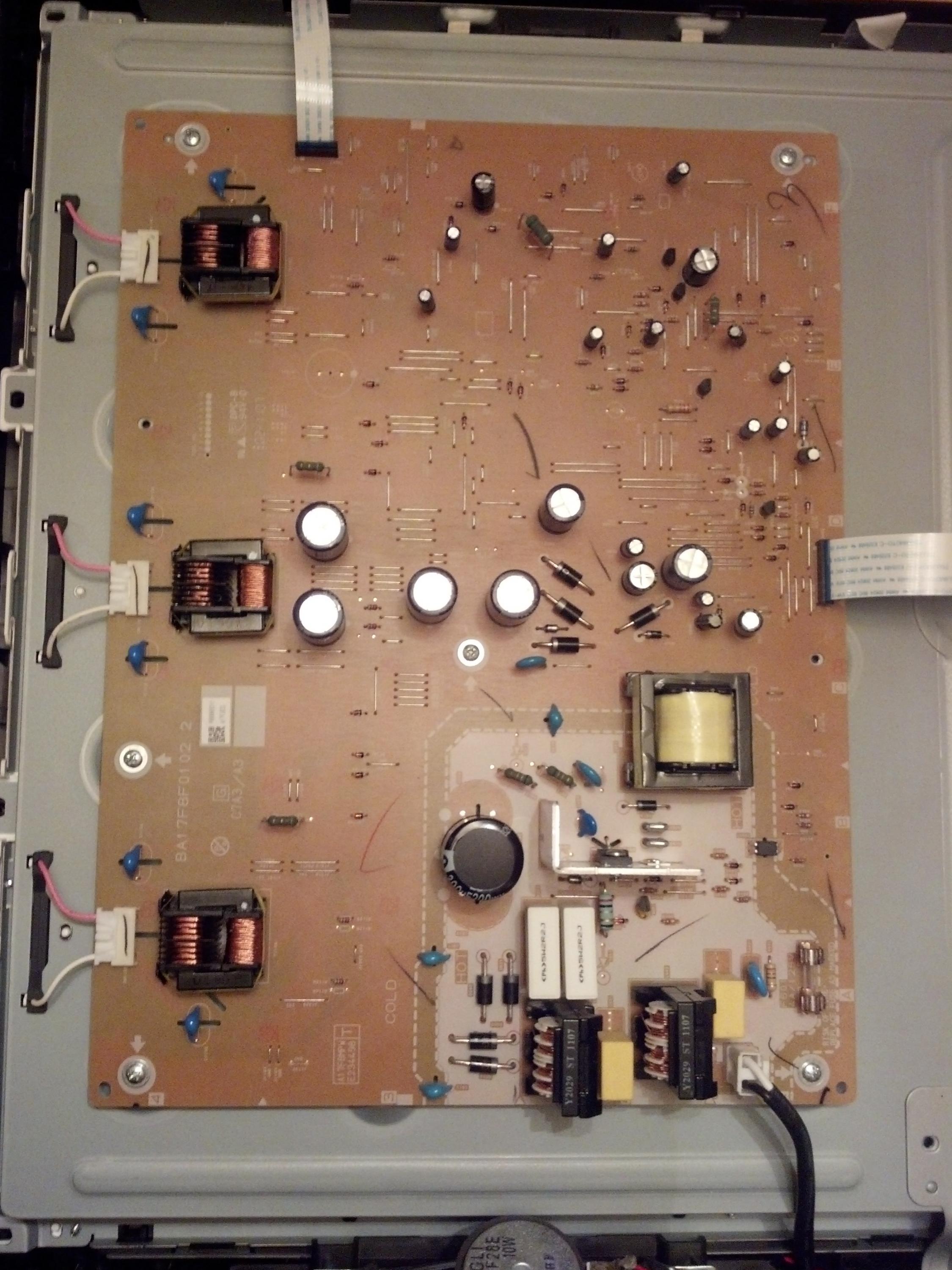

        Re: Emerson LC320EM2 No power after Kit Replacement
        Picked up a couple sets over the weekend, the first I opened was a 2011 magnavox and low and behold this same crappy power supply. q600 shorted, check d640 shorted check, d604 shorted check, seems like deja vu.... Gotta order some more parts. Does anybody have a compatible q601 (2sc2120) transistor number that is still in production? dont really want to wait two weeks for a shipment from china. I wish digikey would fix their search engine so you could actually find something with the drop down filters.

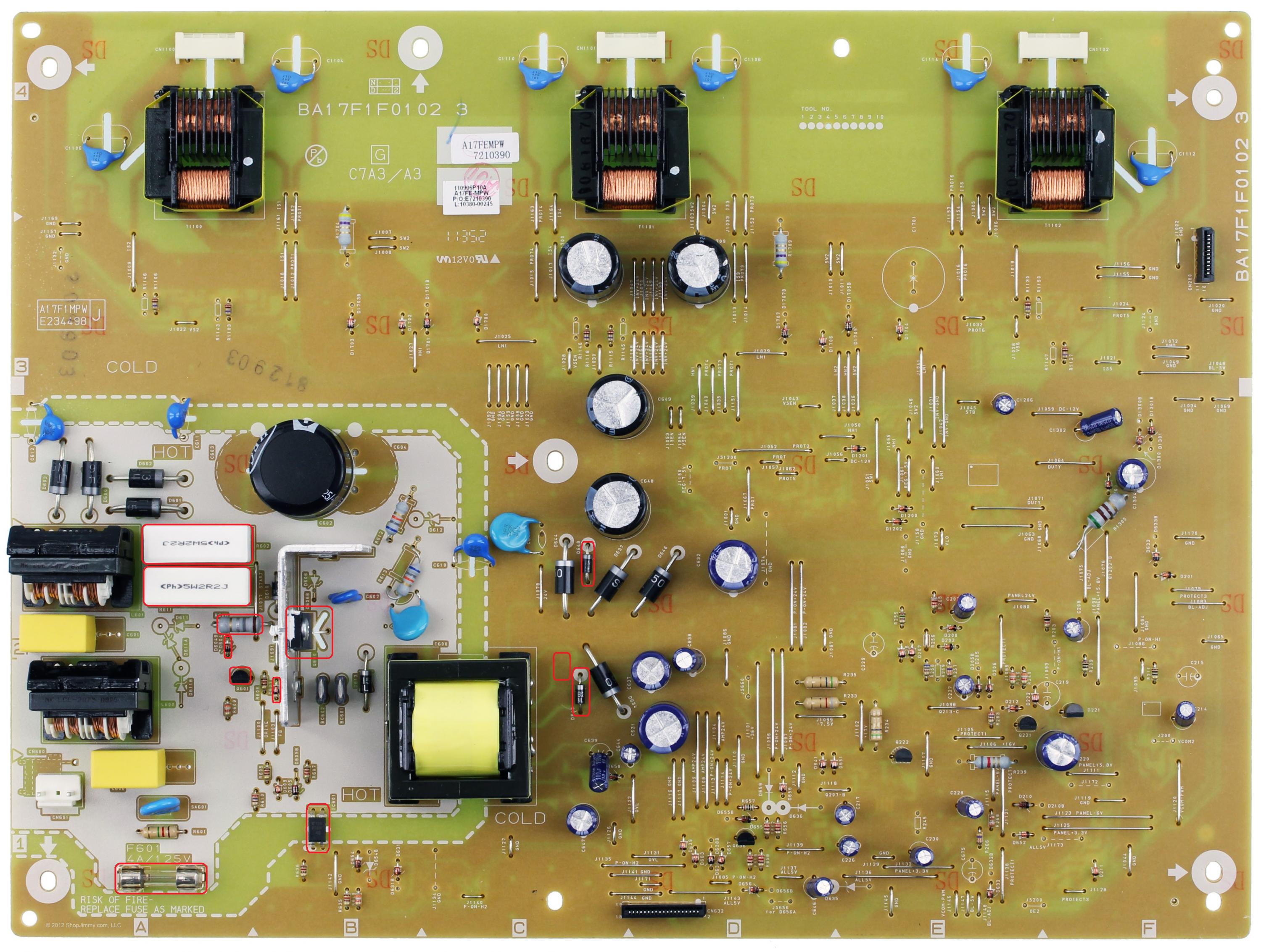

          Caleb,
          I am working on my first one of these A17F8MPW power supply inverter boards. I think a good replacement for Q601 is BC33725BU-ND available from digikey. Look it up and let me know what you think. I have not tried one of these yet, I am just going by the specs.
            This is a self-oscillating PSU (ringing-choke converter)
            * The initial startup pulse comes from the 220K Rs R603, R604, R600.
            * Once the MOSFET begins conducting (Vgs>2V) current flows through T600 pins 3-5 building a field up in the transformer.
            * The sudden increase in primary current causes a reflected current across pins 7~8 of T600 which drives the gate fully into saturation (about 20V) limited by zener D604.
            * Once the primary current hits a certain limit (defined by approx 0.7V/R608), the transistor Q601 will start discharging the MOSFET gate.
            * As the MOSFET gate discharges below the threshold the primary current begins to drop and this causes a large negative pulse across pins 7~8 of T600 which rapidly discharges the FET gate, improving efficiency.
            It's quite a clever circuit, but it has no intelligence. It'll do it's best to drive a dead short, like a shorted output diode, quickly resulting in the destruction of the MOSFET due to overcurrent or overstress.

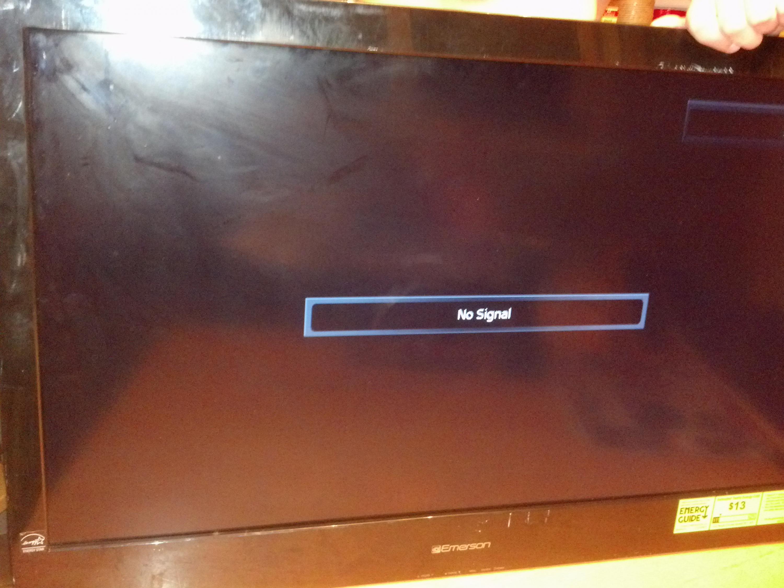

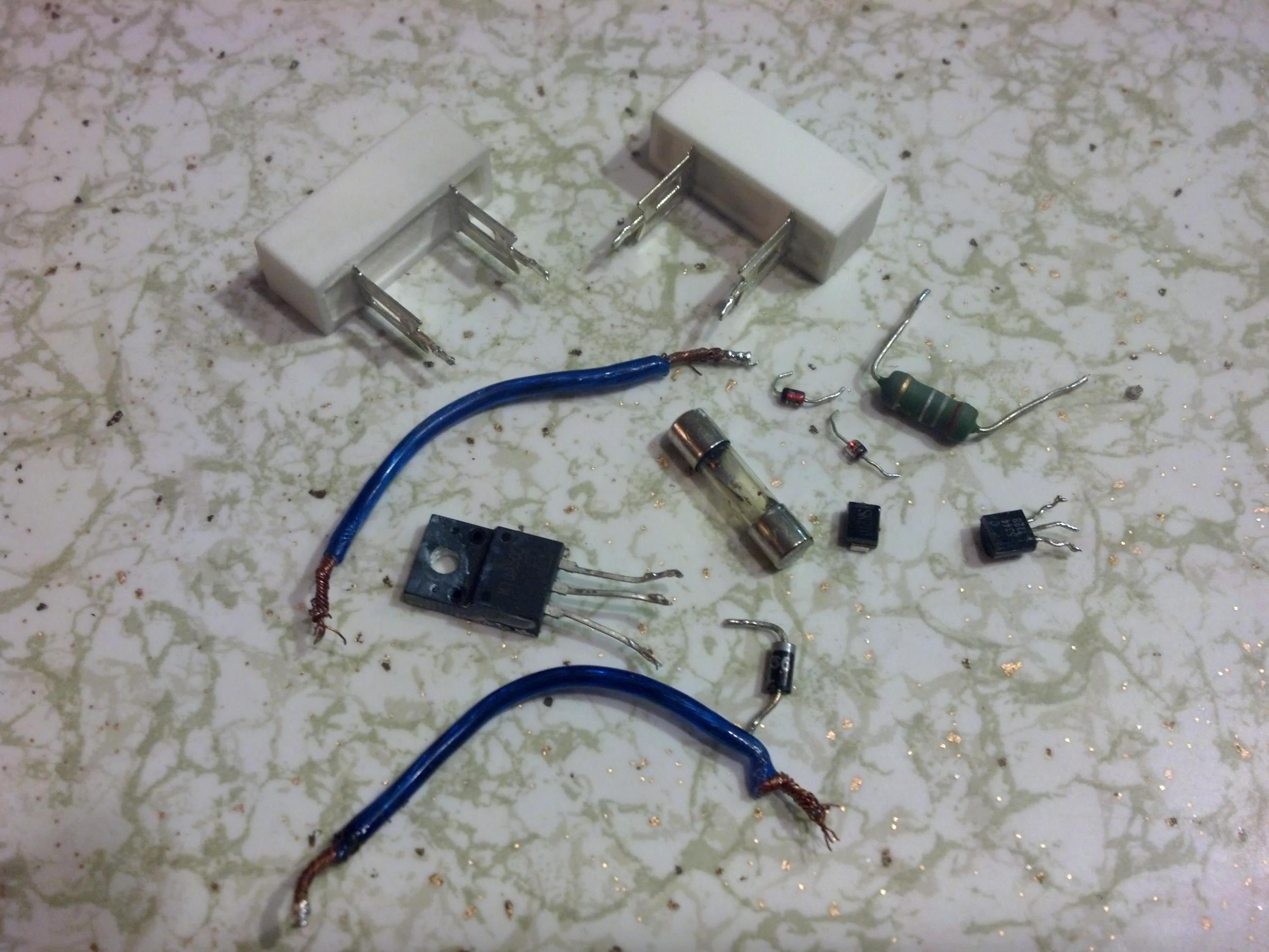

                                  My parts arrived yesterday, glad I ordered extras as I picked up another Emerson set the day before. The guy I bought the Emerson from had removed the power connector from the board and soldered in 2 wires, still haven't figured out why, he also ran a wire across the fuse, probably why it was in worse shape than normal. On the Emerson I replaced
                                  Q600- TK10A50D mosfet
                                  Q601- 2sc2120y transistor
                                  D604- 27v zener
                                  D610- 36v 1w zener
                                  D609- 4148
                                  D640- rectifier diode
                                  R602- 2.2 ohm 5w
                                  R611- 2.2 ohm 5w
                                  R608- .18 ohm 2w
                                  Fuse
                                  power connector
                                  The Magnavox wasn't in as bad of shape, on it I replaced
                                  D604- 27v zener
                                  D609- 4148
                                  D648- 36v 1w zener
                                  R608- .18 ohm 2w
                                  Fuse
                                  On a side note, I ordered up a couple of the bc337 transistors and was able to substitute one for the 2sc2120y, I insulated the emitter leg and wrapped it across the back to give the proper pinout. The set works fine with the new transistor. I was pretty happy to be able to save a couple more from the dump.
