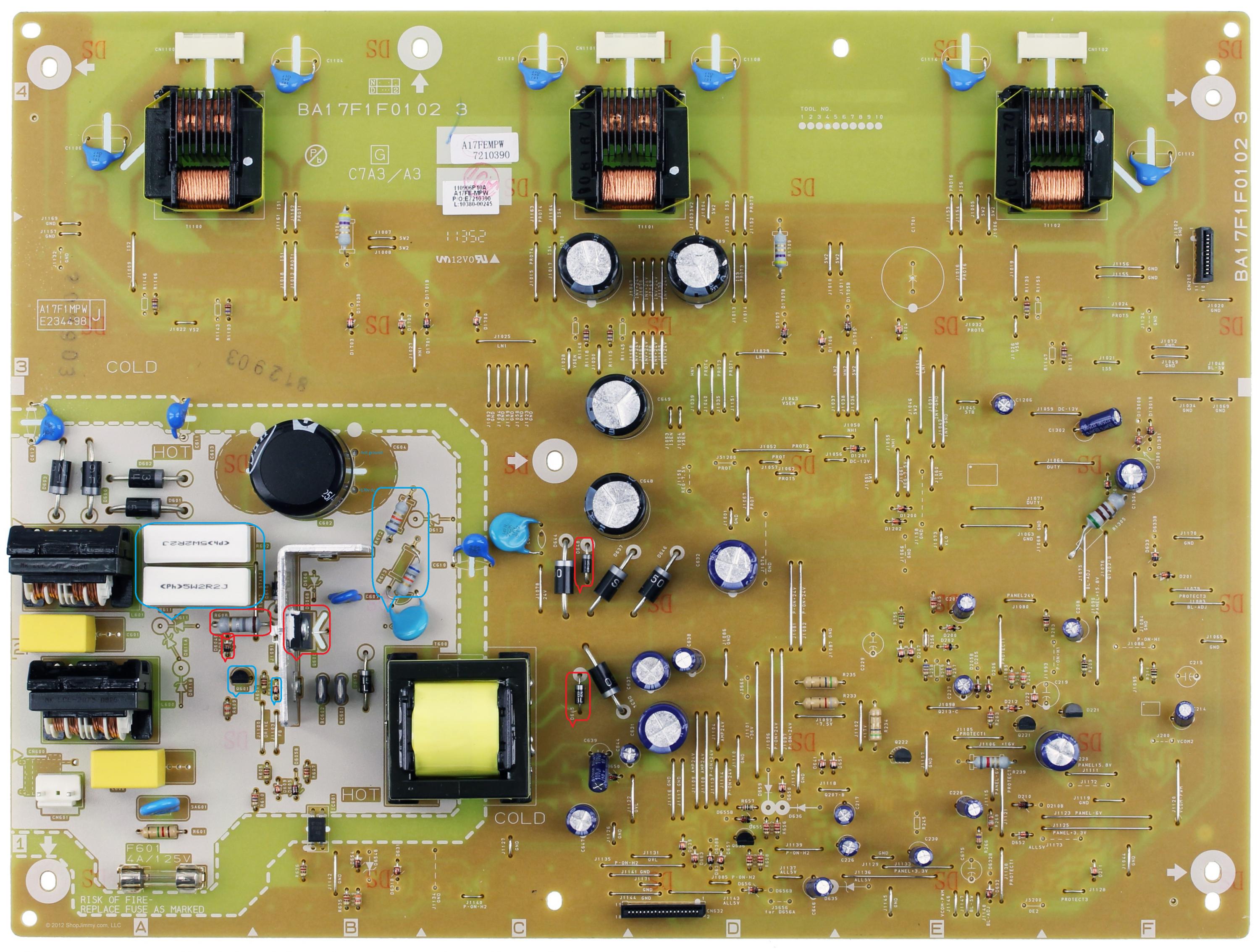

    Re: Emerson LC320EM2 No power after Kit Replacement
    Do you think R608 might be the culprit??
    • paulstef
      • Dec 2013
      • 724
      #42
      R608 shows 0.18R in the schematic. If it originally was 0.18 it should be replaced with the same value.
      If D640 was shorted then there was negative voltage on C637 and D645 was conducting forward for some time. There is a whole lot of other components after that. Did you check D645?

            #45
            This is a self-oscillating PSU (ringing-choke converter)
            * The initial startup pulse comes from the 220K Rs R603, R604, R600.
            * Once the MOSFET begins conducting (Vgs>2V) current flows through T600 pins 3-5 building a field up in the transformer.
            * The sudden increase in primary current causes a reflected current across pins 7~8 of T600 which drives the gate fully into saturation (about 20V) limited by zener D604.
            * Once the primary current hits a certain limit (defined by approx 0.7V/R608), the transistor Q601 will start discharging the MOSFET gate.
            * As the MOSFET gate discharges below the threshold the primary current begins to drop and this causes a large negative pulse across pins 7~8 of T600 which rapidly discharges the FET gate, improving efficiency.
            It's quite a clever circuit, but it has no intelligence. It'll do it's best to drive a dead short, like a shorted output diode, quickly resulting in the destruction of the MOSFET due to overcurrent or overstress.

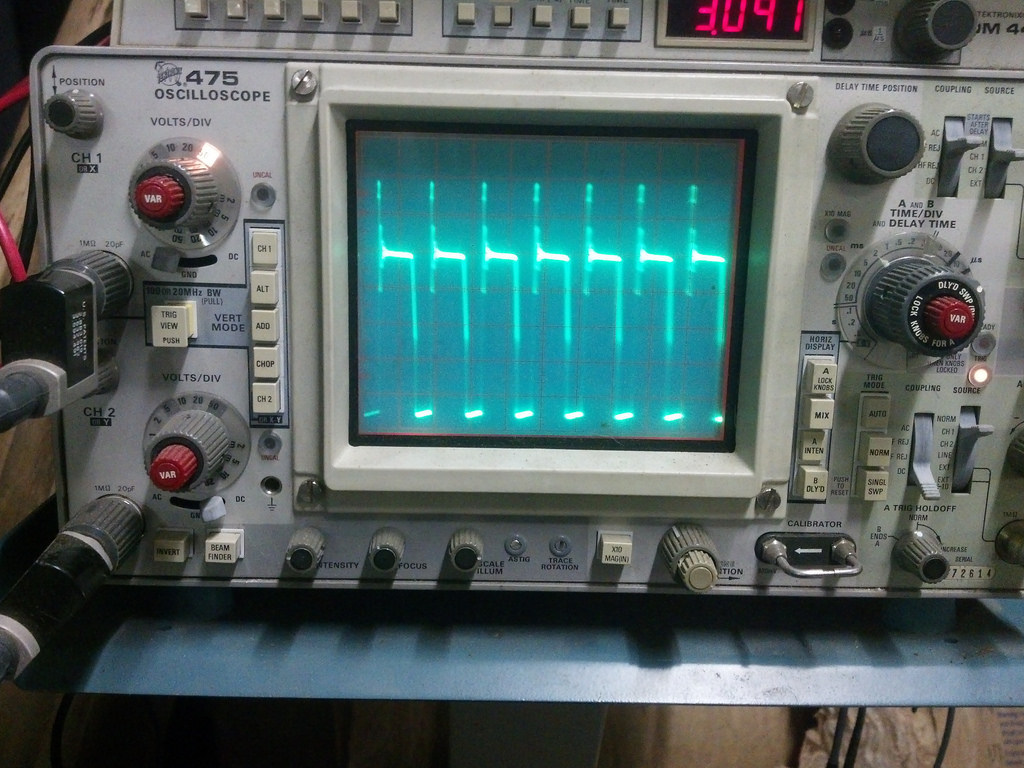

                    Back to trying to repair this set. Below is the voltages I get on the Secondary of T600.
                    Off Transformer pin 14 D640 Cathode 7.3v
                    Off Transformer pin 10 D649 Anode -20.2v
                    Off Transformer pin 15 D646 Cathode 9.8v
                    Off Transformer pin 15 D634 Cathode 10v
                    Off Transformer pin 13 D642 Anode -3.4v
                    Off Transformer pin 10 D643 Cathode 3.7v
                    Off Transformer pin 9 D660 Cathode 14.1v
                    IC601 Pin 1 6.9v
                    Ic601 Pin 2 5.7v
                    Thanks for any help..

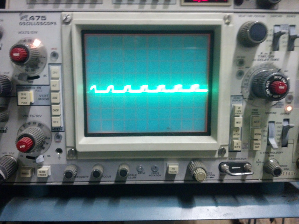

                                        #59
                                        Well after several hours of frustration and about 12$ worth of parts and my set is now working. I ended up burning out those large cement resistors as well as one new mosfet and zener d604. Ended up replacing the opto and the driving transistor as well. I dropped the value on d604 to 24v as the only pin compatible transistor I had on hand was rated for 30v instead of 35v. Attaching scope shots of drain and gate of q600 (50v per division)
