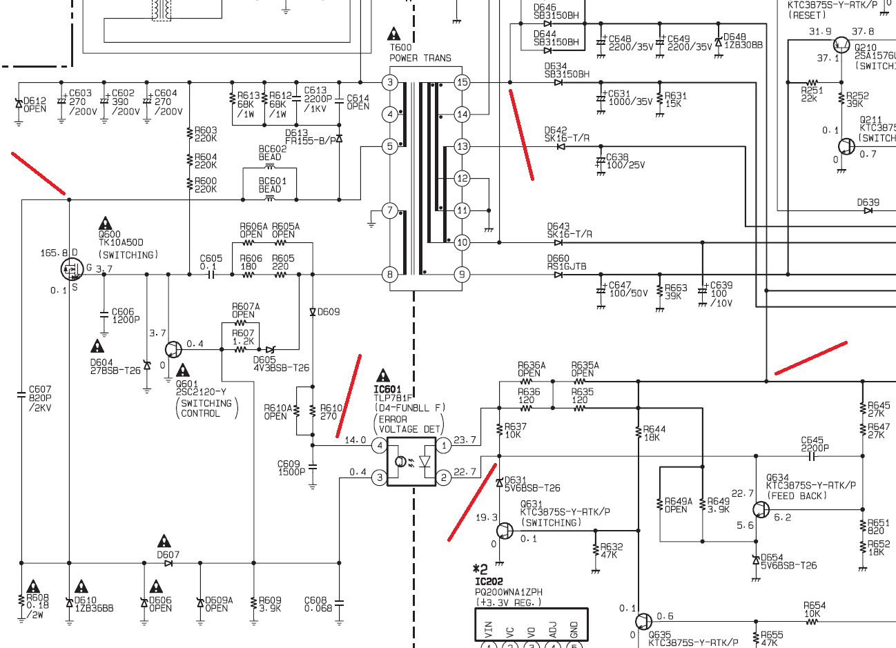

    After replacing most common shorted components from a shorted (Q600) mosfet and blown fuse I still have no startup. I measure changing voltages at the drain. I also measures 2.7 volts at the gate. Anyone else have any luck repairing these Emerson sets after the repair kit has been installed. D640 the smd has been replaced along with R608, D610, F601, D607, D604, IC601, Q601 and Q600. I have attached the closest schematic I have for the tvs. Bad thing is I have 2 of these sets in the shop needing repaired for the same problem. I have fixed several of the them in the past with the kit I found on ebay, but not this time. Any ideas are most appreciated. I have also read through the other threads on this model tv. Thanks.

        Look at the attached diagram. I presume you don't have an isolated differential probe to measure on both primary and secondary, right?
        My suggestion: Measure drain of Q600 to hot ground. Then measure pin 15 of T600 to cold ground. Try to relate these two oscillographs and post them here. This will get us started.
        Since your main MOSFET is kind of switching it seems it charges the gate through the 3 startup resistors of 220k but its not enough to create its own power supply then and start oscillation.
        You may have too much load on one of the secondaries (or short) or some problem in the feedback loop.
        Measure also the voltages indicated in the diagram I attached. We need to relate them to the main switching element Q600.

          I don't have any oscilloscope images to post, but I have the following voltages
          IC601 pin1= 6.94 volts
          IC601 pin2= 5.72 volts
          IC601 pin3= .08 volts
          Ic601 pin 4= .11 volts
          Q600 Drain charges to 14.6 and cycles
          Q600 Gate is 2.7 volts
          Q600 Source 0 volts
          D645 Cathode in Secondary supply 8.26 volts
          Q601 Emitter= 0 volts
          Q601 Base =.08 volts
          Q601 Collector = 2.7 volts

                    1. Measure anode of D642 and cathodes of D643 and D660 to cold ground.
                    2. You say on cathode of D609 to hot ground you have almost no voltage?

                          Q600 gate is stable at 2.7V? Then why does the drain vary from 0 to 15V?
                          From what I see if the output voltage on the secondary is higher than what it should be (around 24V) the optocoupler IC601 will turn on. Since your voltage is much lower the opto output should be open. If it's open then C609 would be charged through D609 everytime Q600 turn on.
                          It looks like it's something on the primary side.
