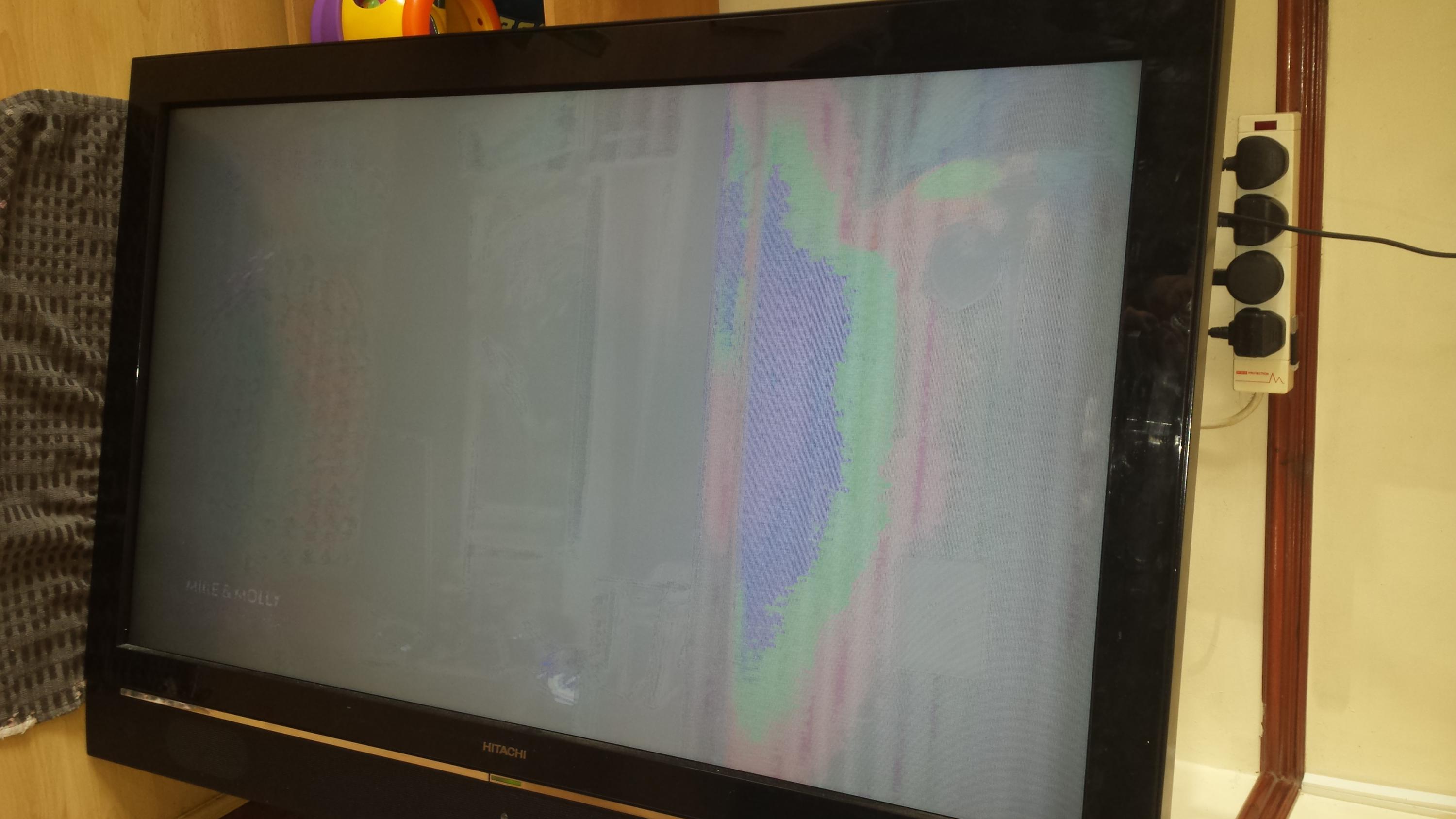

    It worked properly but we kept losing signal and id have to wiggle the ariel on the bk to get picture back and sometimes it would go and I wouldnt be able to get it back for a few hours also when using scart it would cut out, wasnt all the time but every few days. Picture wise it was perfect no red lines or anything. When I used the pc through it I never had 1 problem
    i think there is crud in the hdmi ports causing this.
    also check around the tuner on the main board for dry joints,lift off the sheild on the tuner and check the ariel connection there,re-solder that connection..
    you ran the pc via the VGA on the tv?.
    clean an reseat every connection to rule out also.the LVDS ribbon top priority both ends.
    with tv running,flex all boards with insulated tool to see if fault appears again

      right done most of what multimeter said but found one problem if i plug in scart lead to (avi 1) i get the red lines but if i use (avi 2) its fine

        right i think im giving this back to my friend got a replacement board today still no good thats two ive tried with both boards i get a blue effect solarized picture but if i put in the original board everything is ok but if you use avi 1 you get the red lines

          Looks like panel setting is wrong. MENU 4-7-2-5 (or 7-9-3-5 or 1-3-2-5) and change panel option.

            Ok tom ill try that I'll have to use old board to see service menu the replacement board is from a 37 inch Hitachi so change it to that ?

              @tom in the service menu it won't allow you the option to change in the panel
                #47
                Re: Hitachi l42vp01ub
                Hmm, may be write protected - if EEPROM swappable you can try with a blank one.

                    It's a strange one put the old main board in and you can change the panel settings but with the others it's a no
                      #50
                      The EEPROM is the chip in the socket, left hand side of main board.
