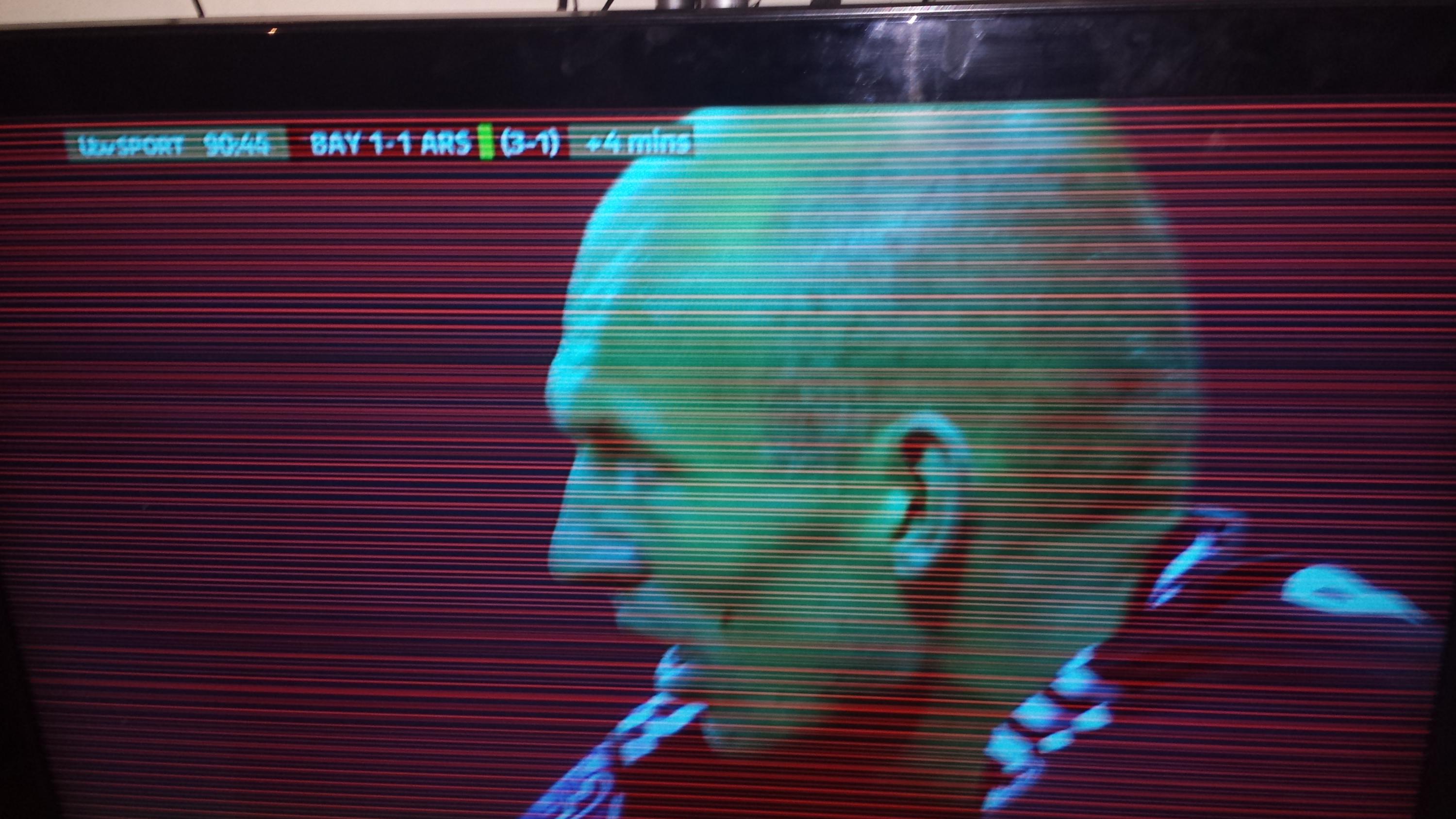

    Hi repairing this tv for a friend strange red lines going across the screen
    Re: Hitachi l42vp01ub
    LVDS fully seated? check both ends.
    Happens on only one/a few sources or all sources?
    Does it affect menu/volume control?
    PSU 12V & 5V are OK?
      Strange my friend told me the the avi and hdmi gave the red lines but the pc lead was fine
      12V is 11.7
      5V is 4.8

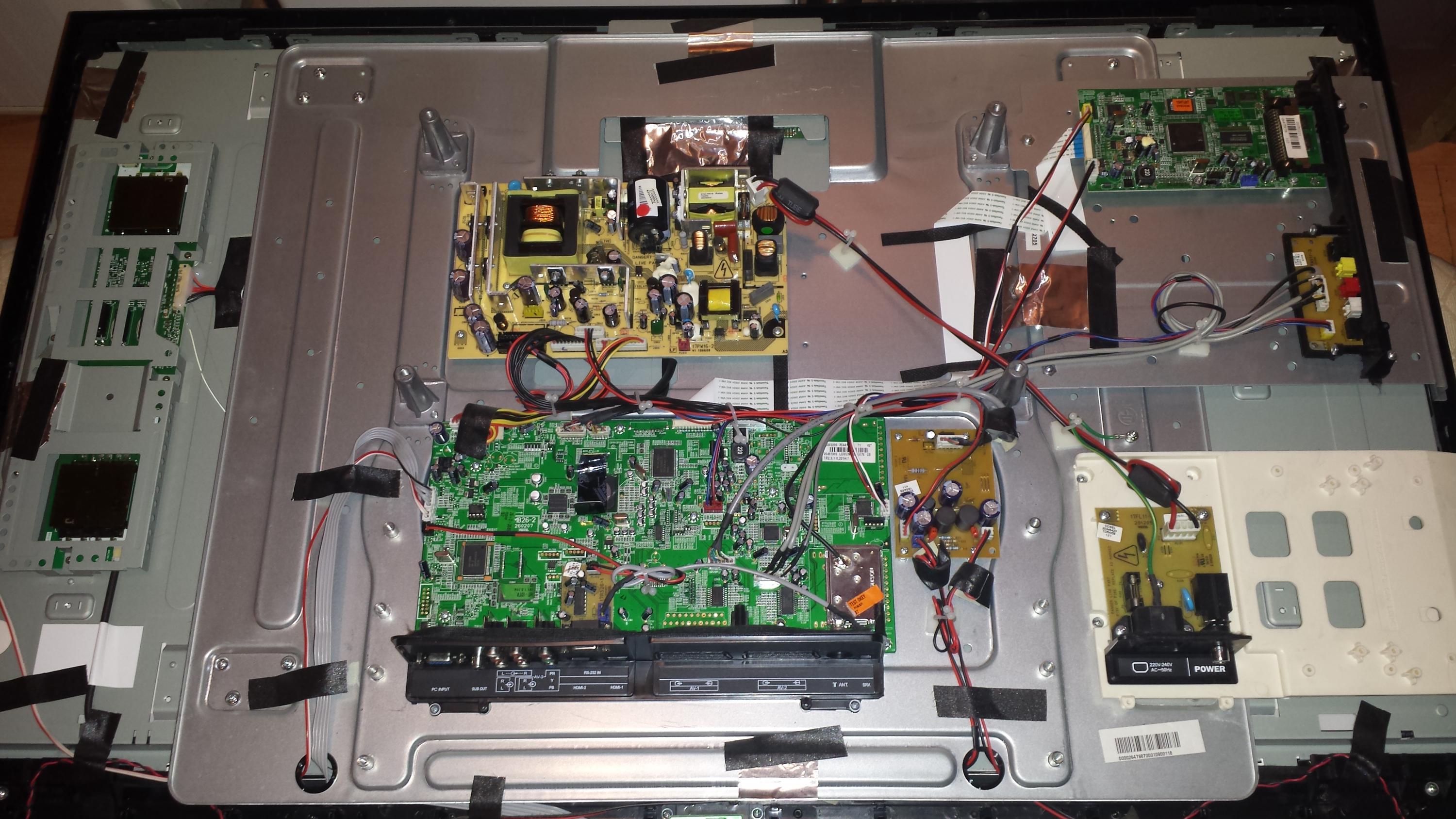

      But just removed the cover and running it and all inputs are fine no more red lines ?
      • sordids999
        • May 2013
        • 2155
        • uk
        Ok all back together now I suppose I'll run this a few days to see if it does it again very strange

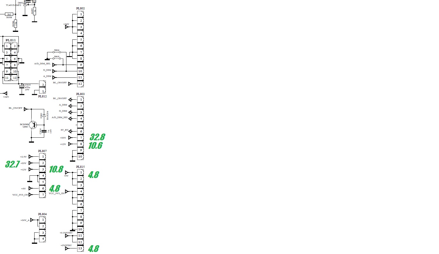

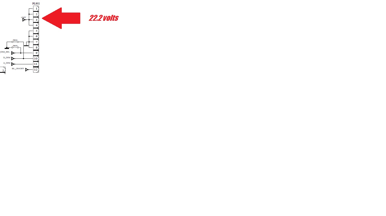

                          ok turned on the tv this morning red lines are back checking voltages ive noticed the pl802 on the schematics im only getting 22.2 volts compared to 24 volts and the main cap on psu im only getting 330v
                            How's the 12V & 5V?
                            • sordids999
                              • May 2013
                              • 2155
                              • uk
                              picture attached the 12v are reading low
                                You have a PFC fault...I've had two like this and never fixed them. I'm sure it is fixable I just haven't invested the time.
