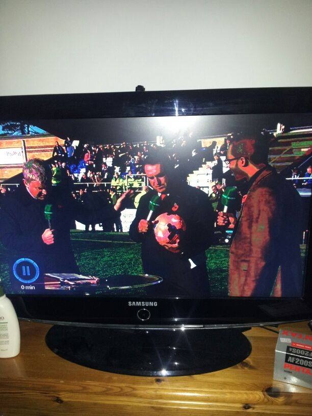

    is this tv worth getting to fix or do you think panel is gone see pic many thanks guys

    could be a faulty tcon?

      that was my gues but wanted to check and dont want to ends up with bad panel tv lol

        ldvs board ?
          Re: le32r87bd
          LVDS board = T-CON.
          looks like LVDS mode wrong, or gamma IC bad.

            thanks tom do you also think thats what its is ?

              Pretty much being able to say bad panel or not is too wide. We cannot be sure and this is a risk you must always factor into your purchase. Personally I would not pay more than £25 for that TV.
              It's a 32" LCD from 2007. It's well before the era of bad panels. It will probably use a good SAMSUNG panel. There were a few bad panels back then, but really rare. Maybe 1 in 100 TVs. Nowadays, it seems like 1 in 5 TVs have bad panels.

                the t con is about £8.00 on ebay so well worth the risk if the price of the set is right imo.

                  Hi guys, I'm new member on the forum, good to join you guys. I am doing online repair to t-con (and many other) boards on eBay in the UK. (in this one AS15F needs changed as a standard fault). My nick on eBay is zbyszekskibinski, thanks
