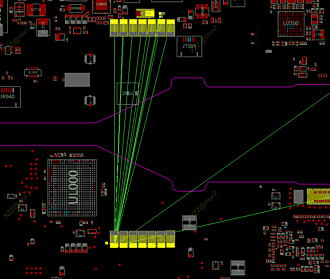

                    • mon2
                      • Dec 2019
                      • 14692
                      Focus on the caps in the blue region of your pic. Remove all power. Meter in resistance mode. One meter probe to ground. Other meter probe to one of these caps (they are all in parallel so any one is ok). One side of the caps will be ground so it should be ~0R ohms. You can touch your meter probes together to understand the baseline for your 0R ohm measurements. Now move the probe to the other side of the same cap. Still a low resistance to ground? If yes, then for sure you have a fault here - it is common.
                      Understand that there is a whole another bank that also is on the same power rail. See attached.
                      Would you have a thermal camera? If not, IPA (alcohol) should work to evaporate quickly over the cap that is shorted. It takes only a single cap to bring this rail down and disable the backlight. We did a similar repair a few weeks back and being lazy, plucked each cap one at a time till the resistance was no longer a short condition.
                      Certainly inspect the bank of caps on the bottom side to see if there is a crack or off color.

                      • Orux
                        • Sep 2025
                        • 26
                        • Austria
                        When i measure on the GND Side of the Caps i get 0.4 Ohms. So this means they have contact to ground in ur picture i measured the top caps wich u see when u open the bottom of the mac. if i measure the Yellow Points on all caps i get around 160kohms on all. so now i try the other side of the board.
                        • mon2
                          • Dec 2019
                          • 14692
                          Yes. So at least one cap is defective in this output bulk cap cluster. Carefully inspect each to check for cracks / discoloration. If a suspect, flux and remove it and then measure the resistance again.
                          You can also consider a voltage injection of even 1 volt here. Then check who heats up or cracks under this pressure.

                                    I have news. I powered the Macbook with the Original Charger. Because Battery does not work. I think its dead also. But the Macbook powers and all works. Then i tryed the Iso Method. Looking on the Caps when it Powers but iso stays and does not go away. But then i put some Iso on the 5V UP700 chip... When the Mac Powers. The Isopropanol instantly goes away...... So there is a short. And in the Internet it says the UP700 is the Backlight power Switch. so maybe change it and thats it?!
                                    • mon2
                                      • Dec 2019
                                      • 14692
                                      Locate DP800. Take a clear pic of this polarized part which is a diode for proper placement. Flux and carefully remove this diode.
                                      Allow the board to cool down. Measure the resistance to ground again of the caps on this rail. Do you still have a low resistance? If yes, then there is still at least one capacitor that is shorted and must be removed. It is possible that the backlight controller (UP800) is also defective but we need to rule out the caps as well.
                                      Is there a RP831 on your board? If yes, remove this part instead of the diode. We are trying to isolate the caps from the controller to locate the shorted component(s).
