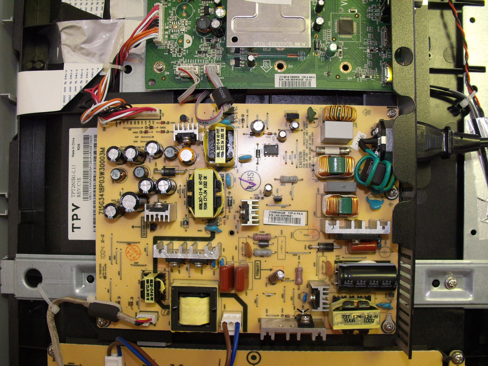

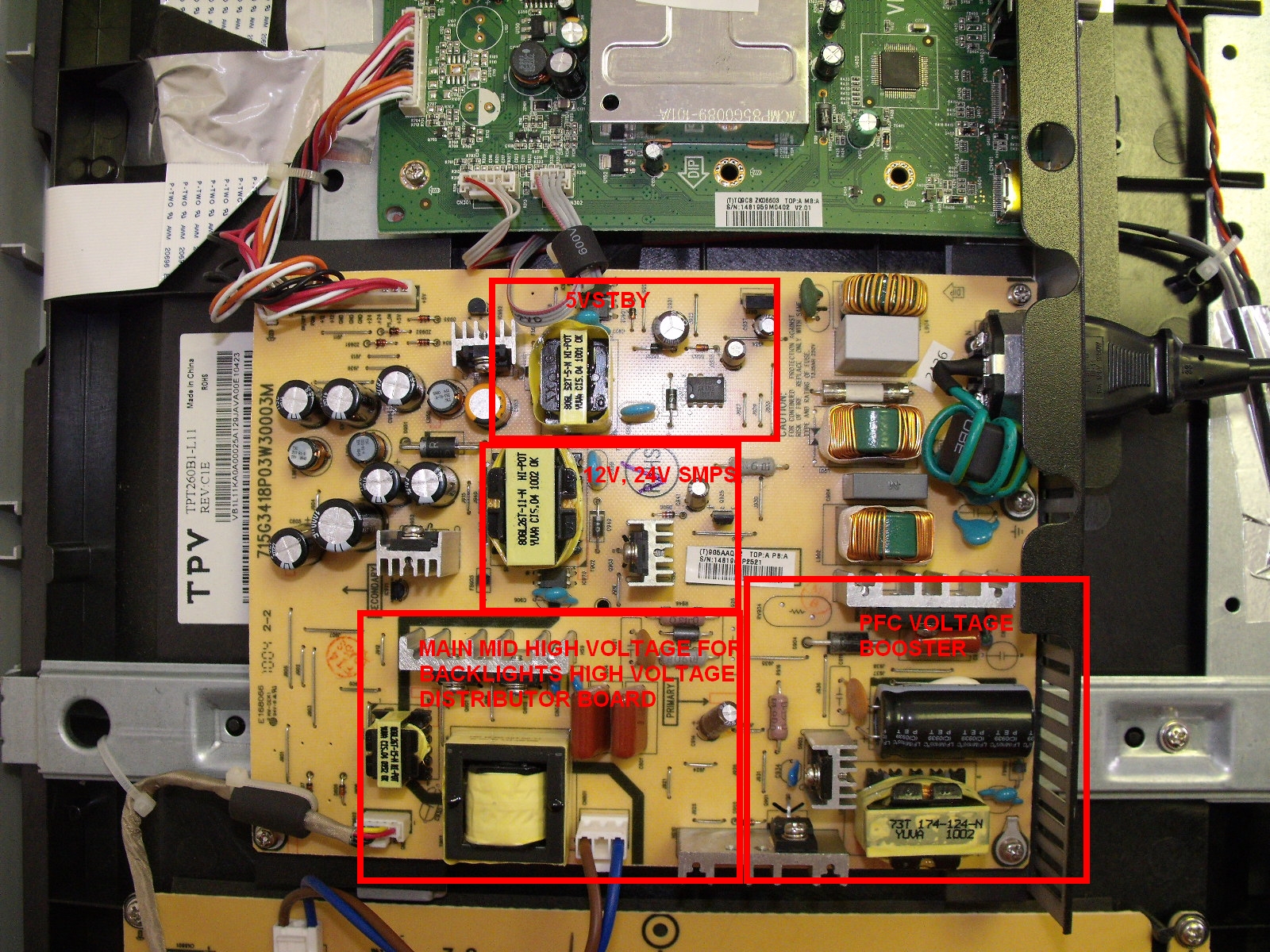

    Vizio VA26LHDTV10T When plugged in the logo is white and when the power button is pushed the logo turns orange and stays that way. I get no picture or sound. I checked the voltages at the connector and I am not getting the 24v or the 12v as stated next to the connector but I do have the 5v and 5v at the PS_ON just not sure what my next step should be.
    Re: Vizio VA26LHDTV10T
    What DC voltage (measure right at the two legs of the cap) do you get at the main filter cap (450VDC cap laying on its side) when PS_ON is present?

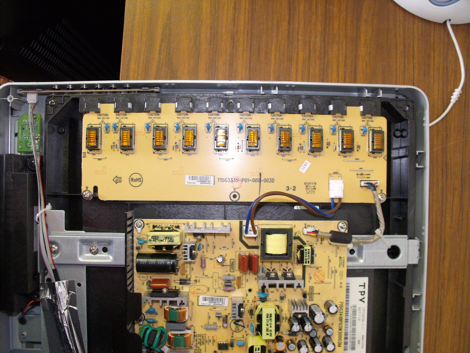

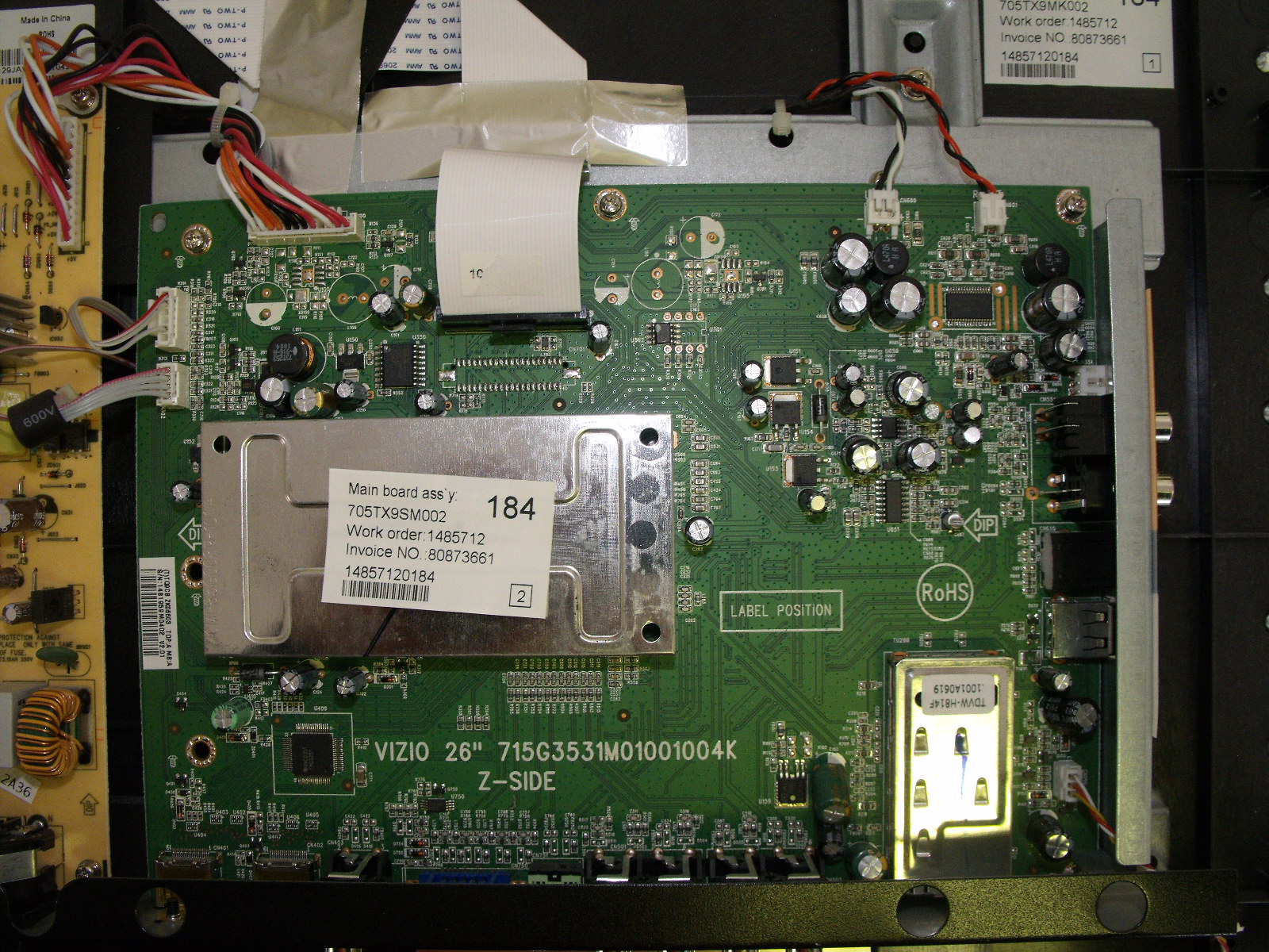

    Can I see the pictures of all the boards? There is a board with Brown/Blue wires connected to it, like to know what that board is.
      Here is the other board. I will check voltage also.
        I also get 393.1 volts at the cap.

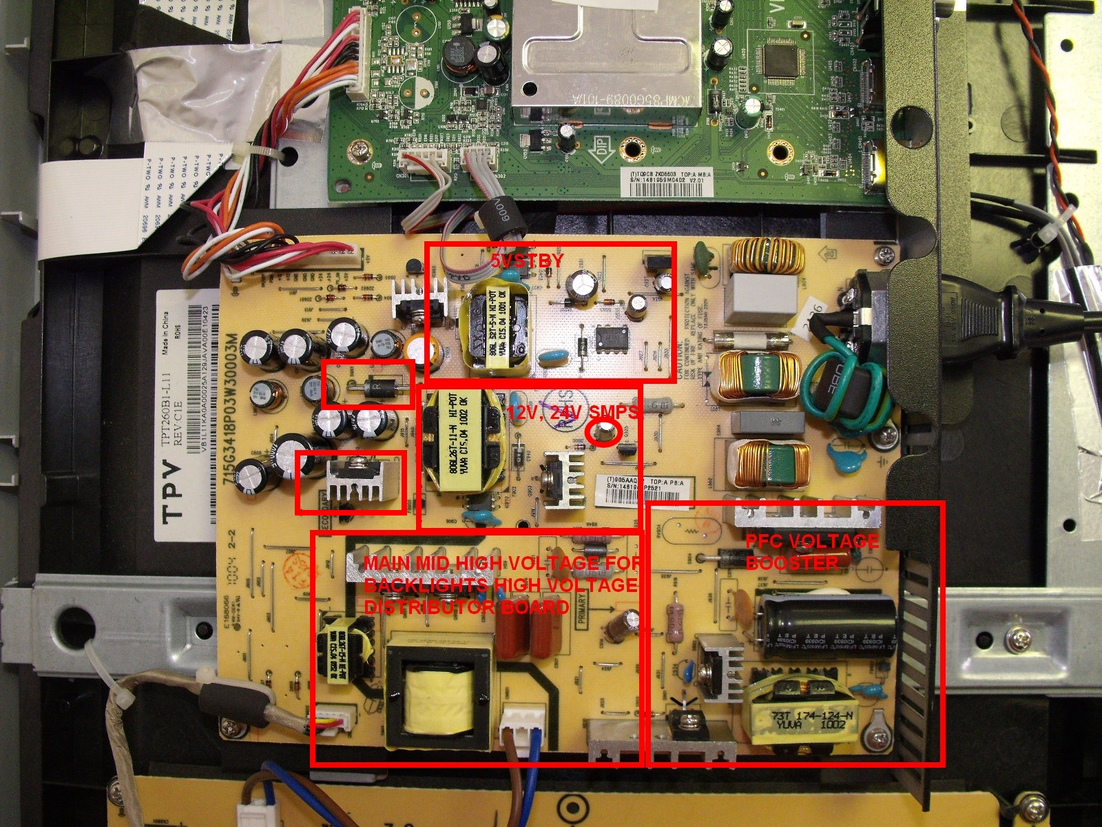

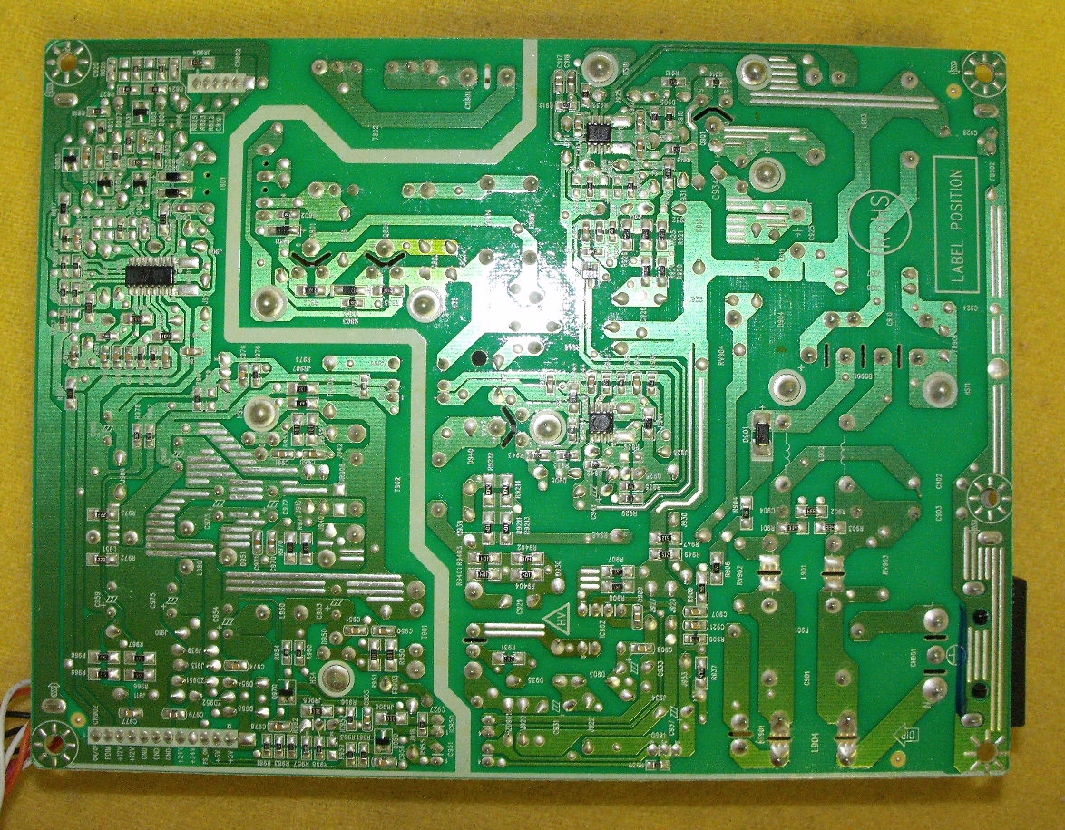

          OK, so the PFC Voltage booster is OK, you need to inspect the 12V, 24V SMPS section next. Post the picture of the bottom side of the power supply board, then look at the area of the 12V/24V section.

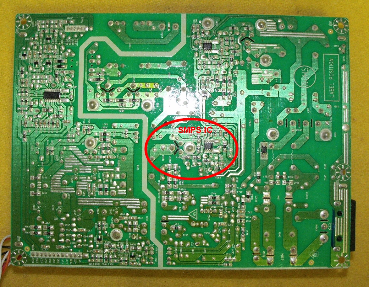

            Here is the bottom.
              Just pulled out of circuit and checked the diode the cap and the mosfet it the 12/24 volt section you marked and all good.
                OK, there is a SMD 8-PIN SMPS IC that drives the MOSFET for the 12V/24V, can you get the number?
                Also there is a small electrolytics cap next to the MOSFET heat sink, you can try replacing that cap which is the start up cap.
                BTW, the two rectifier Diodes for the 12V (Axial lead) and the 24V (TO-220 case mounted on the heat sink) checked OK?

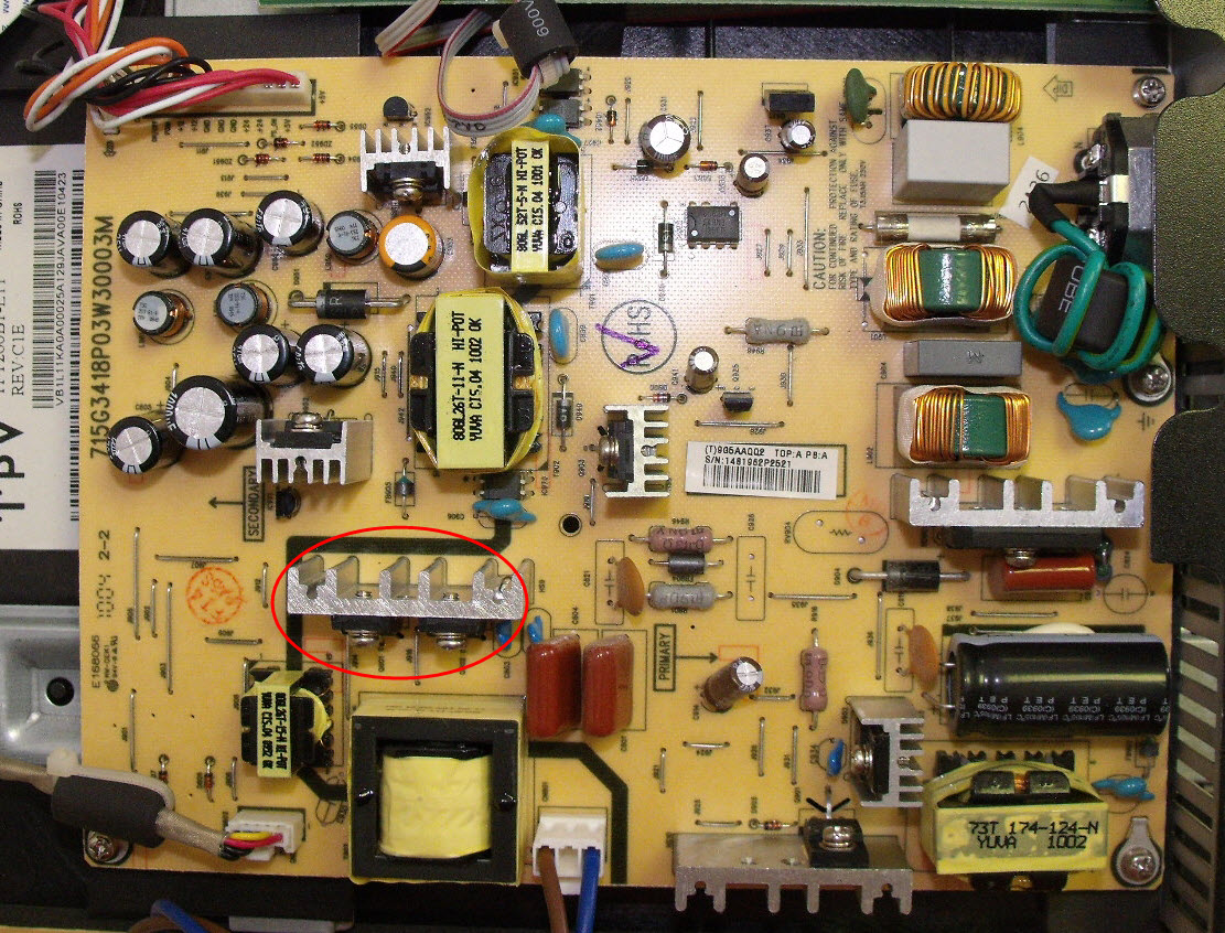

                  I assume you mean the tiny chip on the bottom of the board. all I can make out is 23A and under it looks like 4388. I had that cap out and tested with esr meter and is good.Are you talking what I have circled in the picture to check? If not would it be possible to circle what I should check in the picture? Thanks.
                    Those are MOSFET for the inverter circuits, you need the one I marked as 12v/24v SMPS section.

                      Ok The diode reads 1337 one way and 228 the other and I'm takeing the other out of circuit now.
                        And that reads with the black probe on the center leg 215 for both sides with red lead and OL in any other configuration. Do you think it would pay to pull all the caps out and check them?
