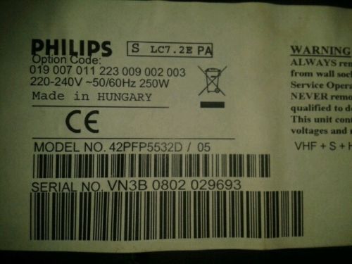

    Hi I have a philips 42PFP5532D which is stuck on standby and the power LED flashes 1 long flash then 4 short ones, then 1 long and 5 short, then 1 long and 2 short? Does anyone know the problem? Does anyone know any blinking codes for TVs??

    What's the chassis code - printed on rear of set for example Q599.3E-LA? Next to normal model number.

      Hi tom66 Where would I find the Chassis code? I have the serial and model number but nothing saying the Chassis code

        Can you provide a picture of the back model number label?
          Re: philips 42PFP5532D stuck on standby
          Hope this helps

              Yes chassis is LC7.2E-PA.

                  Here's exact manual
                  Error codes page 18.
                  error code 4: General I2C error
                  error code 5: Trident video processor error
                  error code 2: +12V low/missing
                  I'd focus on error code 2. It looks like it could cause the other two errors. Check +12V at PSU.
