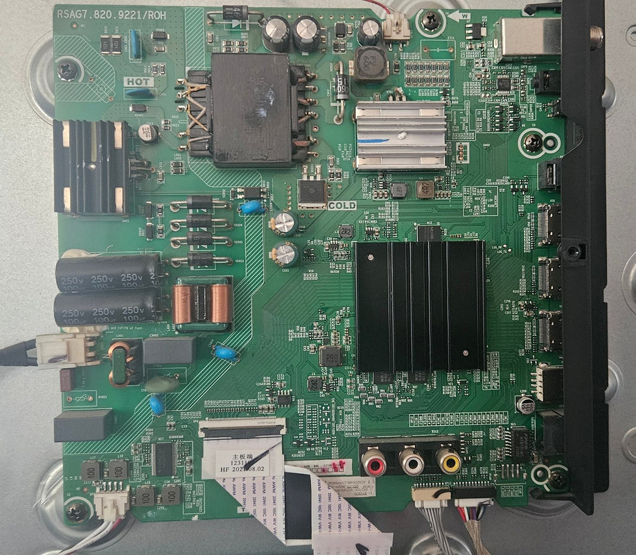

    Hello all,
    I was driving around and found a free hisense r6e3.
    I figured what the he'll I fixed a free tv before with a new lamp.
    So I plugged it in and got sound but no picture i see it light up though.
    I've tried using a flashlight to see a faint image no luck.
    I've tried unplugging a ribbon cable off the tcon board and the left side shows white when right is unplugged. All black when right is in.
    I saw a video were someone taped off some off the ribbon and it worked but I don't know how you find which pins to block off. And if that wont work whats the next steps to test so i could fix it.
    I've been reading and seen the main board and power board go out alot but how do itest before buying random parts.
    Thank you all for any help.

    Would help to know full model # as we dont know what size tv you have. Also pictures of the boards are extremely helpful too.

        See if those 2 capacitors are perfectly flat on top, looks like one is bulging, any bulge at all and it's bad.

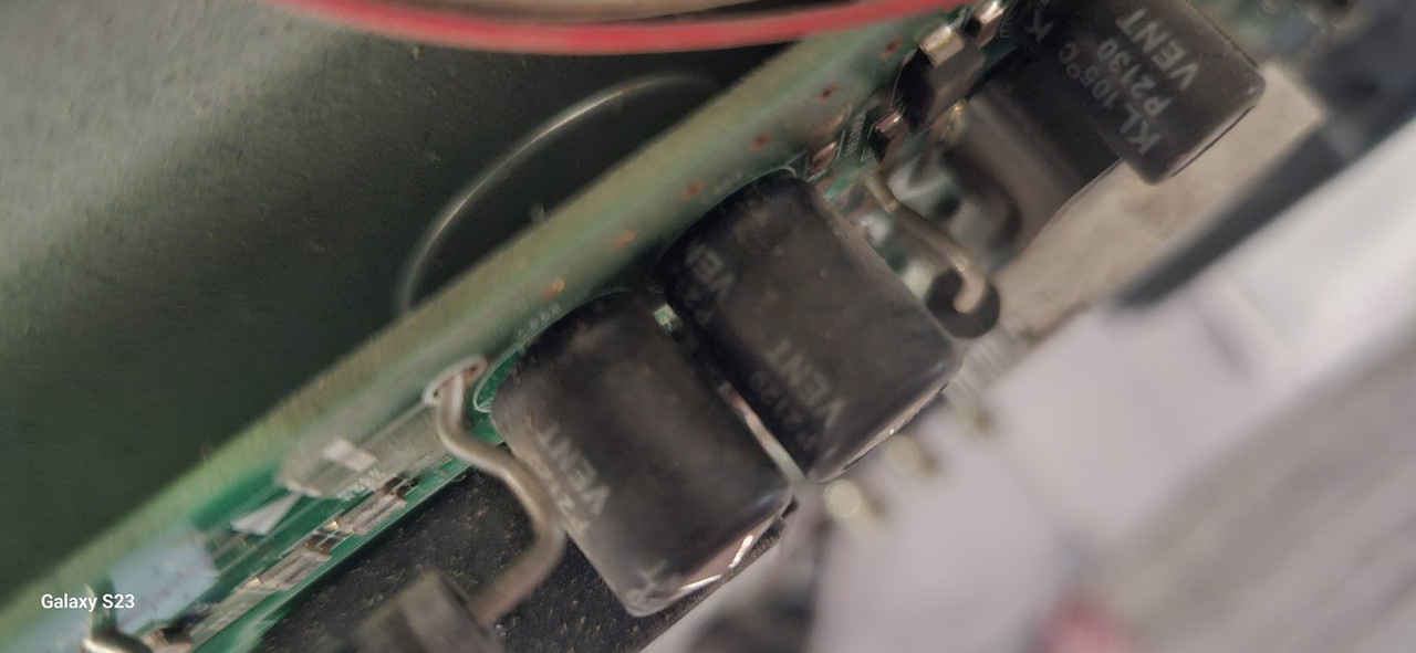

              I tried a bunch of times with the tape no luck.
              I took a Pic of the caps and is this one on left considered bulging

                Yes it's bad, replace it and retry tv.
