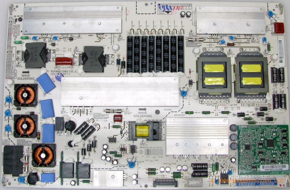

    Got this set for next to nothing because it had failed. The owner had replaced the main input fuse but no joy, so sold it for next to nothing. I found a power diode short circuit near the LED driver board. I replaced that and the power supply appears to fire up but nothing on the screen. (The fancy coloured lights beneath the panel come on and flicker in response to the remote control.) It would be easy but expensive to replace the power supply/LED driver board. But I was hoping that someone might have experience with these sets and set me in the direction of what to look for. Fuses blow for a reason; something else would seem to have caused that to happen and that's what I need to track down. Yes, I know I need to start making voltage measurements at the input/output of the LED driver board, but in the first instance I just thought that someone might know this as a common fault.

    Re: LG 42LE5400 Backlighting & power supply
    Perhaps post a good clear picture of the power supply front and back using manage attachments - someone may have seen the board in another set.

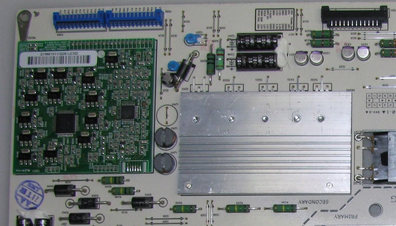

                              If the snubber is not right, the MOSFET will do run hot and can get damaged. The snubber will usually connected across the winding of the drive side or across the S and D of the MOSFET.
                              Can you show me the pictures around the areas of this MOSFET circuit?
                              • dkneyle
                                • Dec 2013
                                • 441
                                The MOSFET is hidden under the heatsink. It is Q241. The diode in question is next to it, running at an angle. Yes, I think it does go across S & D in actual fact.
                                Off the top of your head, any thoughts on the correct diode type?
                                I've seen some images of this board without the diode. Would it be too risky to remove, if only for a short time to check whether the overheating problem goes away?

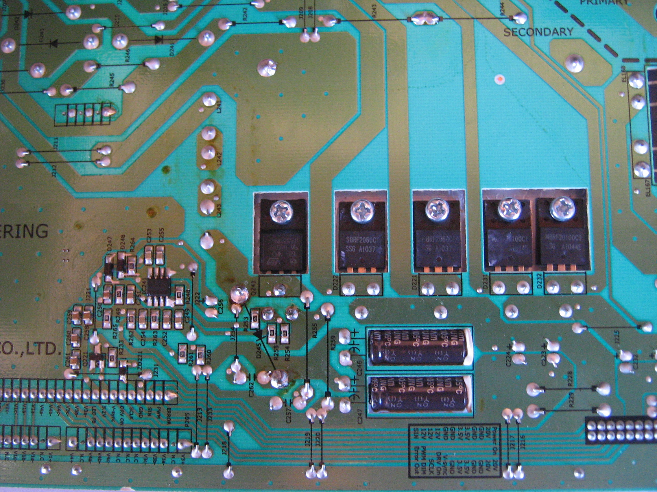

                                  can I see the bottom side of that area? Trying to see what the D is connected to, Typical Clamping Diode will be around 200V.
                                  • dkneyle
                                    • Dec 2013
                                    • 441
                                    Here you go.

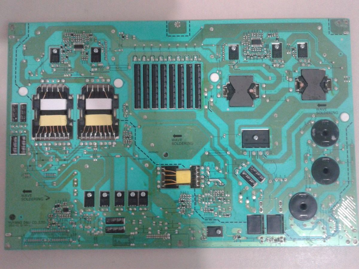

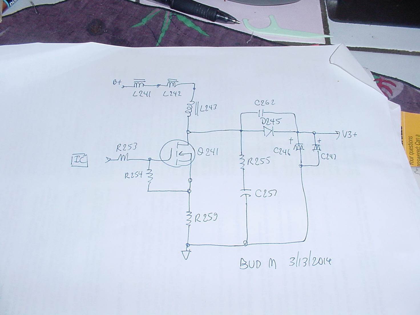

                                      That Q241 is V3+ (connector P205) switching power supply, that diode is the rectifier.
                                      Picture of the whole bottom side?
                                      The snubber is the RC netwowrk R255/C257 for the MOSFET, and C262 snubber for the rectifier D245.
