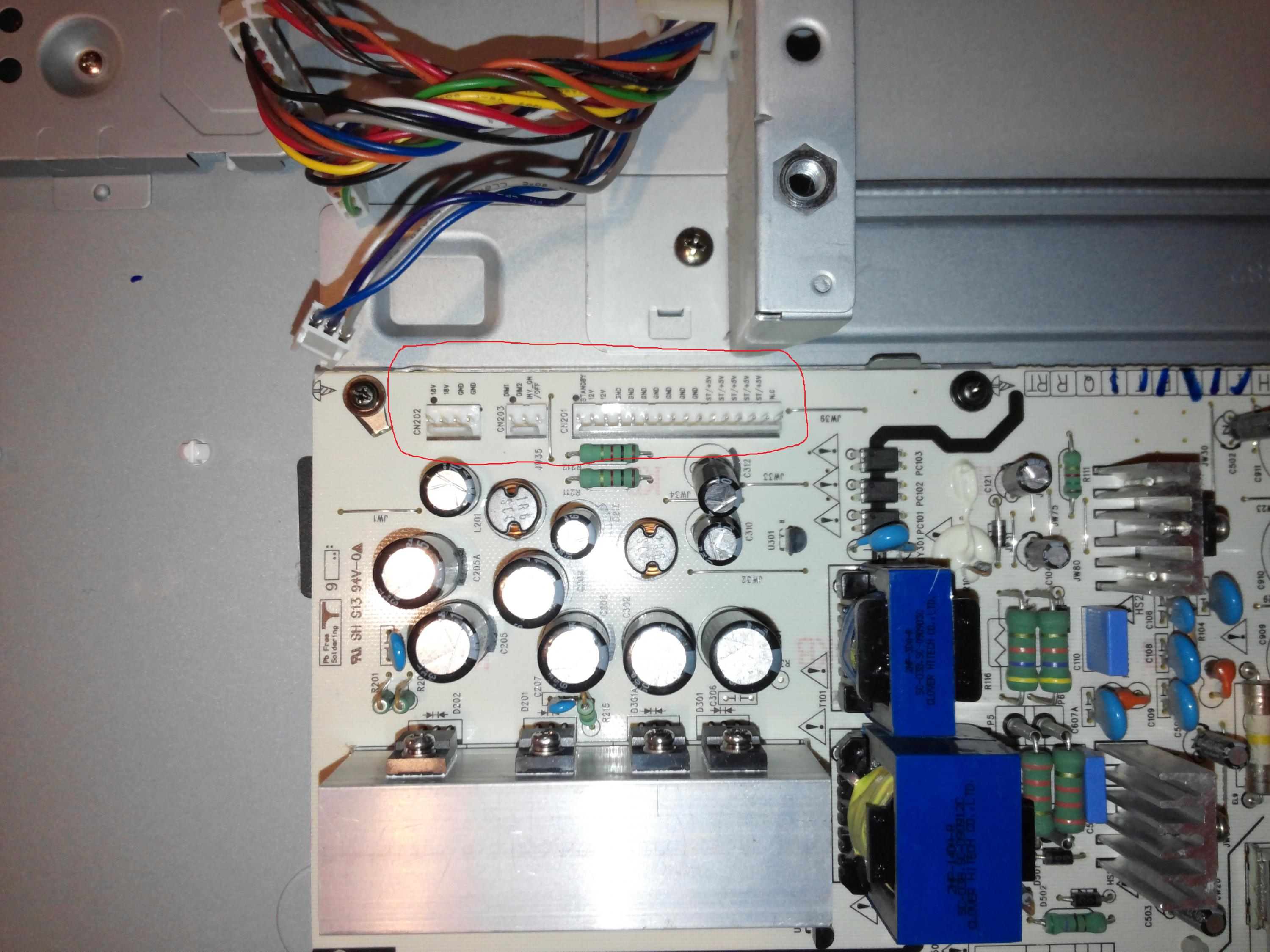

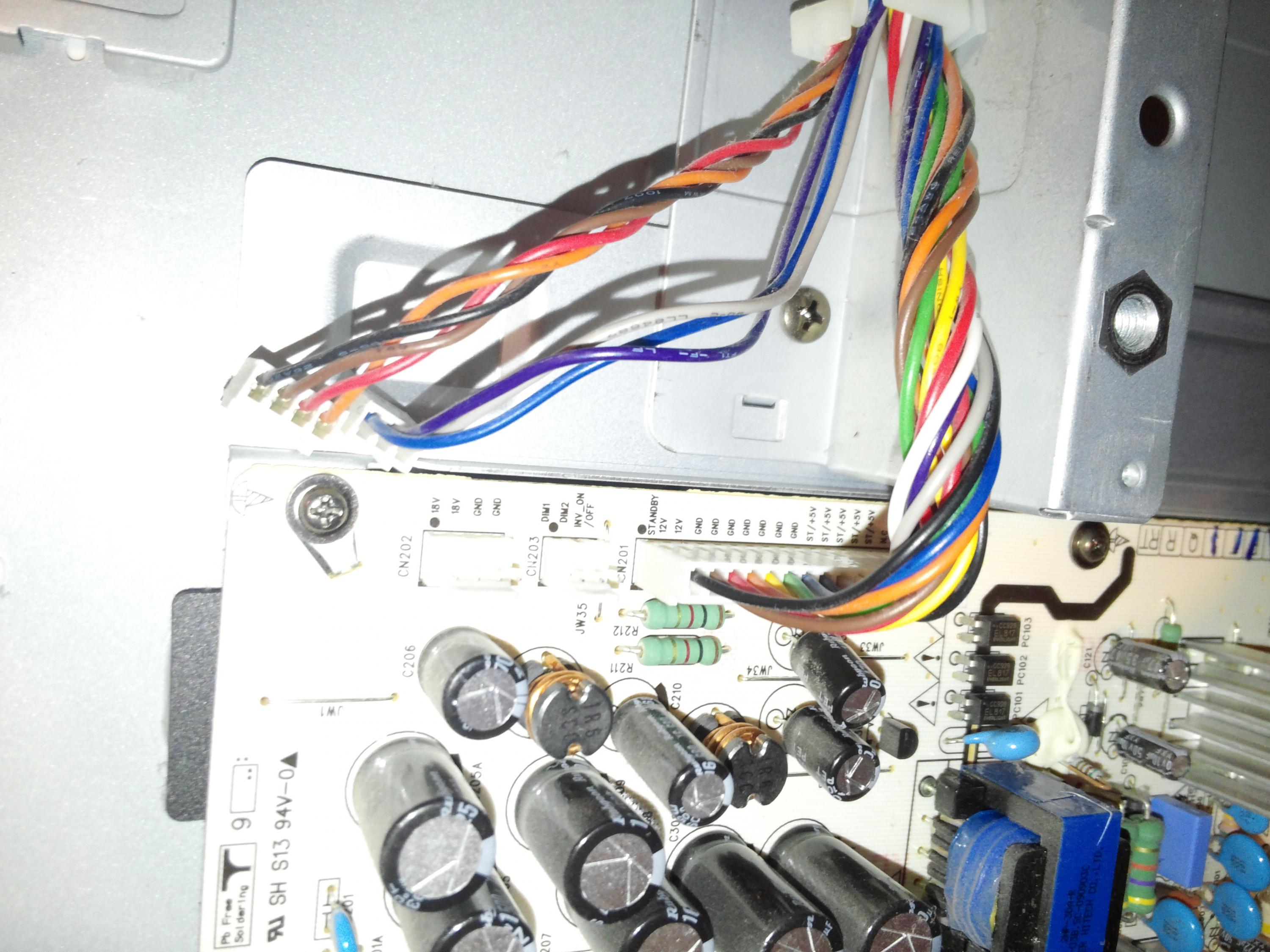

                OK a small update. I have reviewed most of the data that was supplied by budm and was blown away. To be hones I'm a bit overwhelmed. I did do some testing with the the TV plugged in (something that I wasn't so sure I should do before reading the documents). I took some photos that I'll use to help tell my story. Because of my symptom "TV has power but won't turn on" I decided to try and isolate the problem to either the power supply side or the control side. In the picture "Overall layout of boards" I'm calling the left side white board the "power supply" and I'm calling the right side green board the "control side". As I stated, I plugged in the TV and tested the fuses for power (as opposed to just checking them for open). In the picture "power supply with Fuses highlighted" the Fuse marked "Fuse A" had a good 120V. The fuse marked "Fuse B" only had about half that; coming in at about 60V. This doesn't seem right to me; am I on to something here? Also I was going to try to test for the "on signal" from the power supply to the control but couldn't find the right pin to check. I though that I'd find the "PSON" pin. I have included a picture of the available pins to check in a photo called "power supply with connections highlighted". Would you be so kind as to give me some advise?
                • mmartell
                  • Oct 2013
                  • 3189
                  Re: Vizio model SV422XVT "VIZIO" logo lights orange but won't turn on
                  Hmm that's interesting I see no such pin. Perhaps a similar shot of the main board connectors may help.
                    CN201 STANBY PIN is the same as PS_ON pin, when TV is turn off it should be <1VDC, when TV is turn on, it should be >2VDC.
                    " The fuse marked "Fuse B" only had about half that; coming in at about 60V" You get that reading due to using the wrong ground ref point for the PRIMARY (HOT, DEADLY SIDE) side of the crcuit, the Negative leg of the 450VDC Main filter cap is the ground ref point for the PRIMARY side, the SECONADRY (COLD) side ground ref point is the chassis which is tied the Ground of the SECONDARY side on the circuit board or some time through the board mounting screws.
                    We know that the 5VSTBY power supply is working , otherwise you will not be getting the orange LED, but must be checked to make sure it is stable at 5VDC.
                    Did you check the two fuses on the main board (where you have those input connectors) and the voltage regulator ICs as requested in post 2 yet?

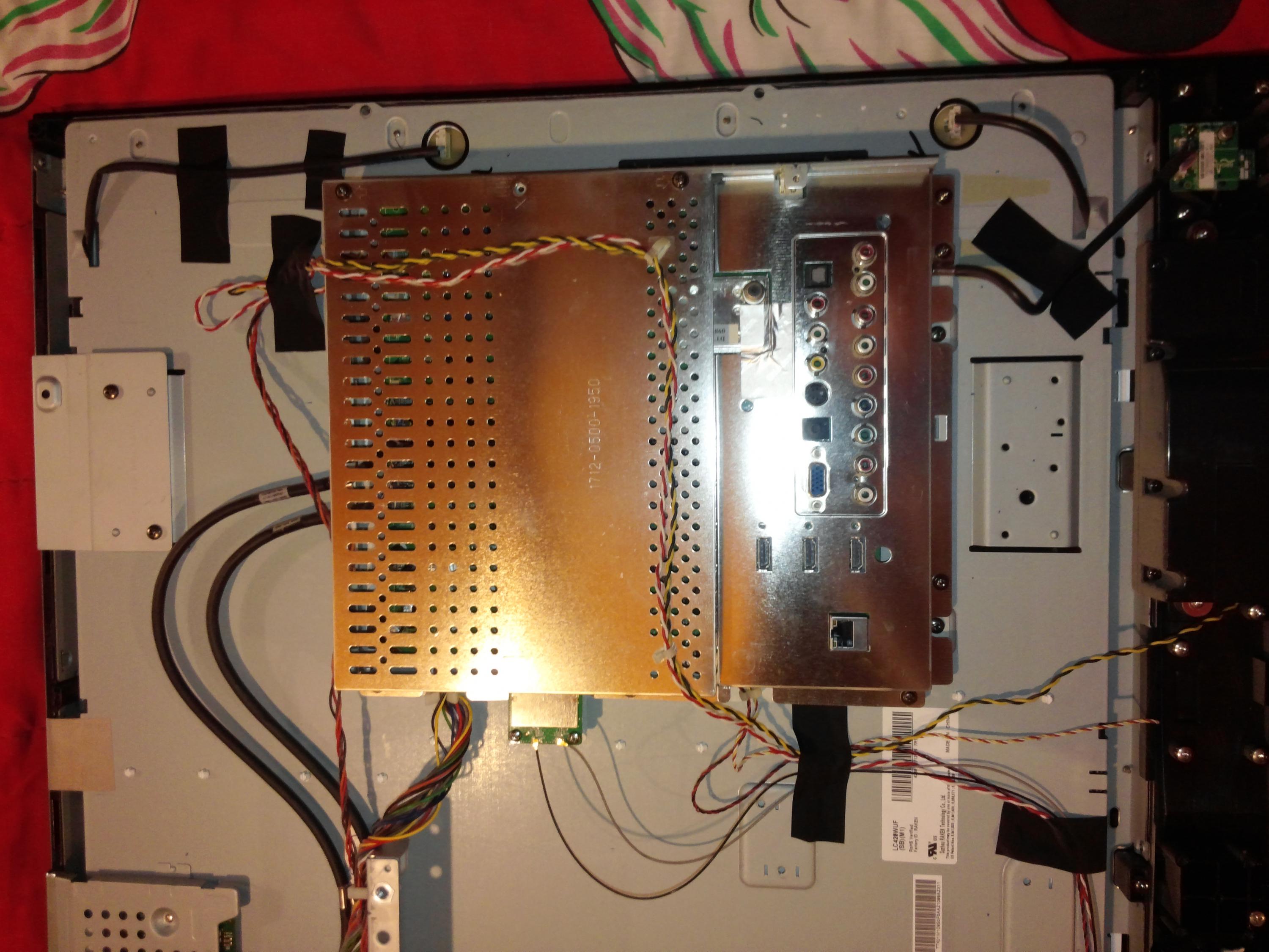

                      Thanks budm. I'll recheck the fuse. Your statement "Did you check the two fuses on the main board (where you have those input connectors)" is something I'm not clear on. I know that the White board has two fuses and I have checked those. The green board has three very small fuses. I checked them for open but obviously could not get a voltage reading because I have no power to that board that I'm aware of. And voltage regulator ICs I have checked...I think. I checked everything that looked like the pictures within the post but to be honest I'm really not sure which ones to check and even if I'm doing it correctly. :0( Any Idea based on the photos which ones I should be focusing on?
                        OK, the pictures were not clear enough, I see three fuses now.

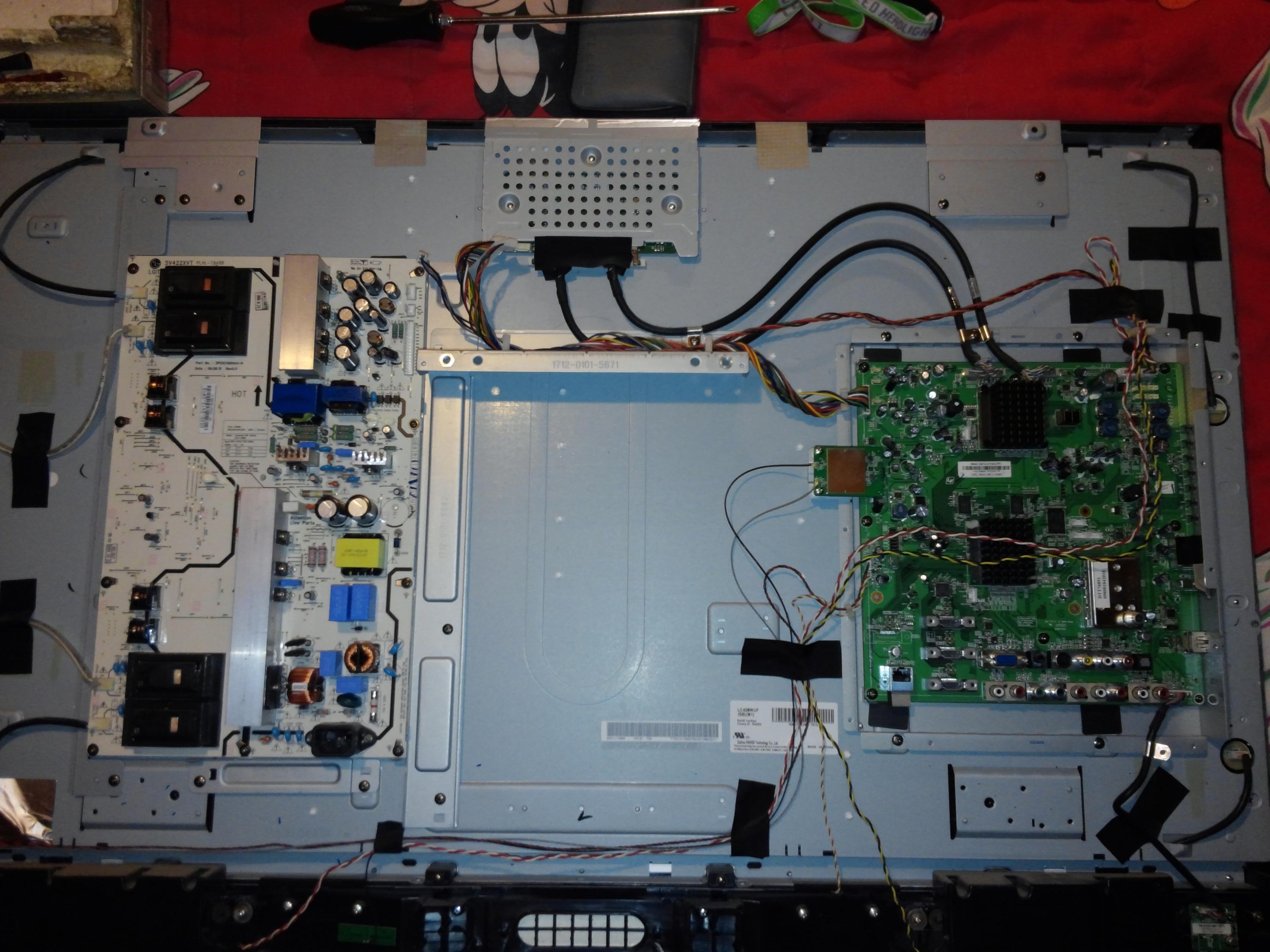

                          OK I have confirmed my voltage regulator measurements (VR). I have included a better picture of the logic board with the measurments indicated on each VR right on the photo (I will also include the measuremnets belowwithin the body of this post). Also on the photo I have indicated my ground point. As a point to note I have not been able to find the Negative leg of the 450VDC Main filter cap for properly reading voltage accross the fuse maked "FUSE B" in the photo "power supply with Fuses highlighted" (posted above). I did move my negative lead around the board to different mounting screws to test my reading but ended up with the same results. Below are my VR readings:
                          U5
                          L373
                          0117
                          PIN1 (ADJ) = .287
                          PIN2 (OUT) = .460
                          PIN3 (IN) = .007
                          U7
                          L373
                          0117
                          PIN1 (ADJ) = .008
                          PIN2 (OUT) = .016
                          PIN3 (IN) = .007
                          U71
                          L373
                          0117
                          PIN1 (ADJ) = .000
                          PIN2 (OUT) = .000
                          PIN3 (IN) = .034
                          U88
                          L373
                          0117
                          PIN1 (ADJ) = .036
                          PIN2 (OUT) = .058
                          PIN3 (IN) = .000
                          It seems that I am not getting the desired reading on any of them. Would you agree? And if so what would you recomend next? Thank you so much for you help!!

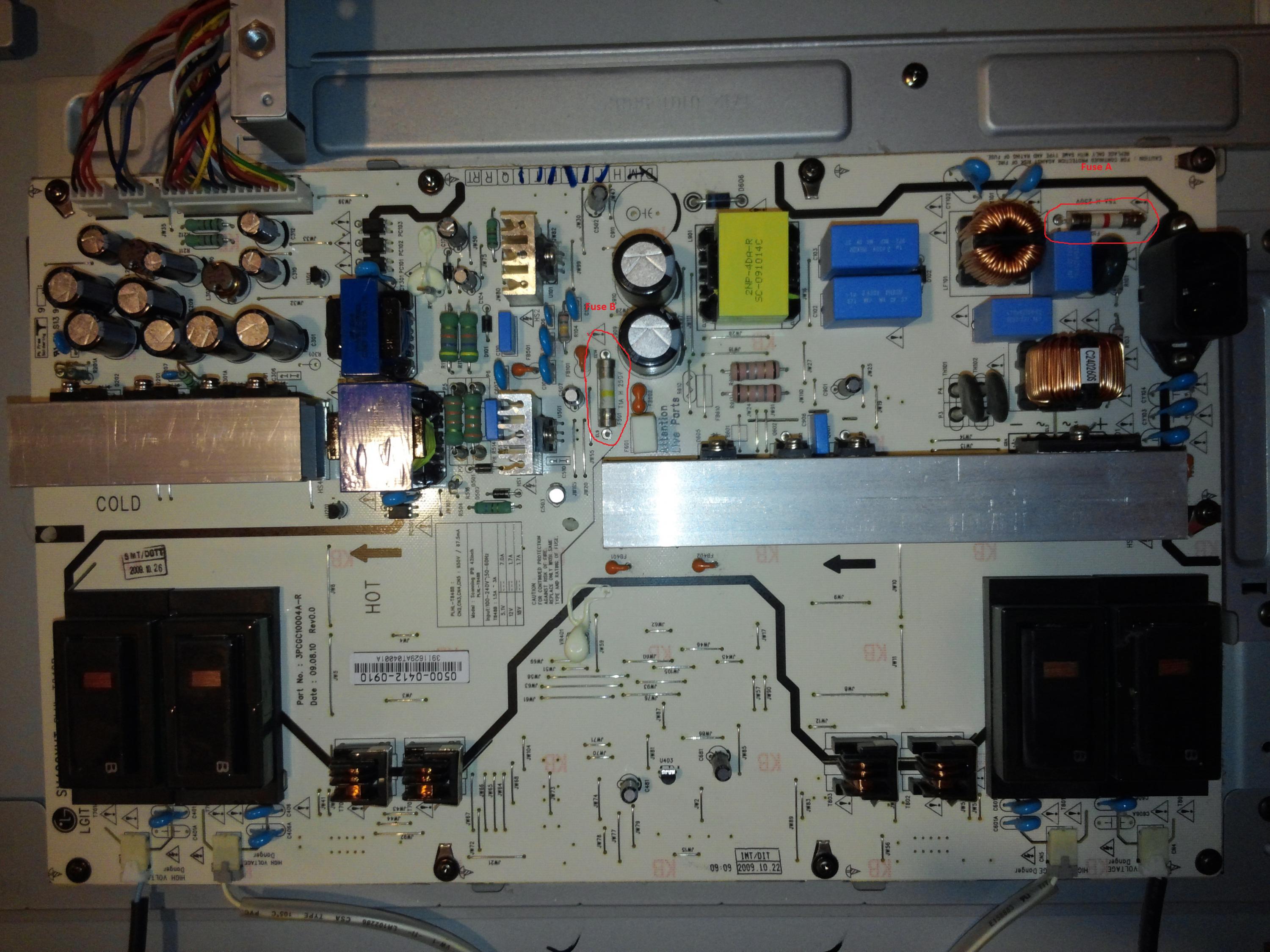

                            Anybody know where the Negative leg of the 450VDC Main filter cap is?
                              You can see the two "K" capacitors. Just near "Fuse B".
                              https://www.badcaps.net/forum/attach...6&d=1392945402
                              There's a blank space for an additional capacitor not installed on this model, the left hand pin is positive, right hand is negative. That's your 450V cap negative.
                                When you work in the secondary side of the circuits, in this case, the main board, you will use chassis as the Ground ref. point for you meter. You use the negative leg of the main filter cap in the primary side when you are working in the primary side of the circuit.
                                So take the readings again on the main board.
                                One of the 3 fuses on the main board should at least show 5V which is from 5VSTBY of the power supply board, the other two fuses, one of them will be for switched 12VDC.

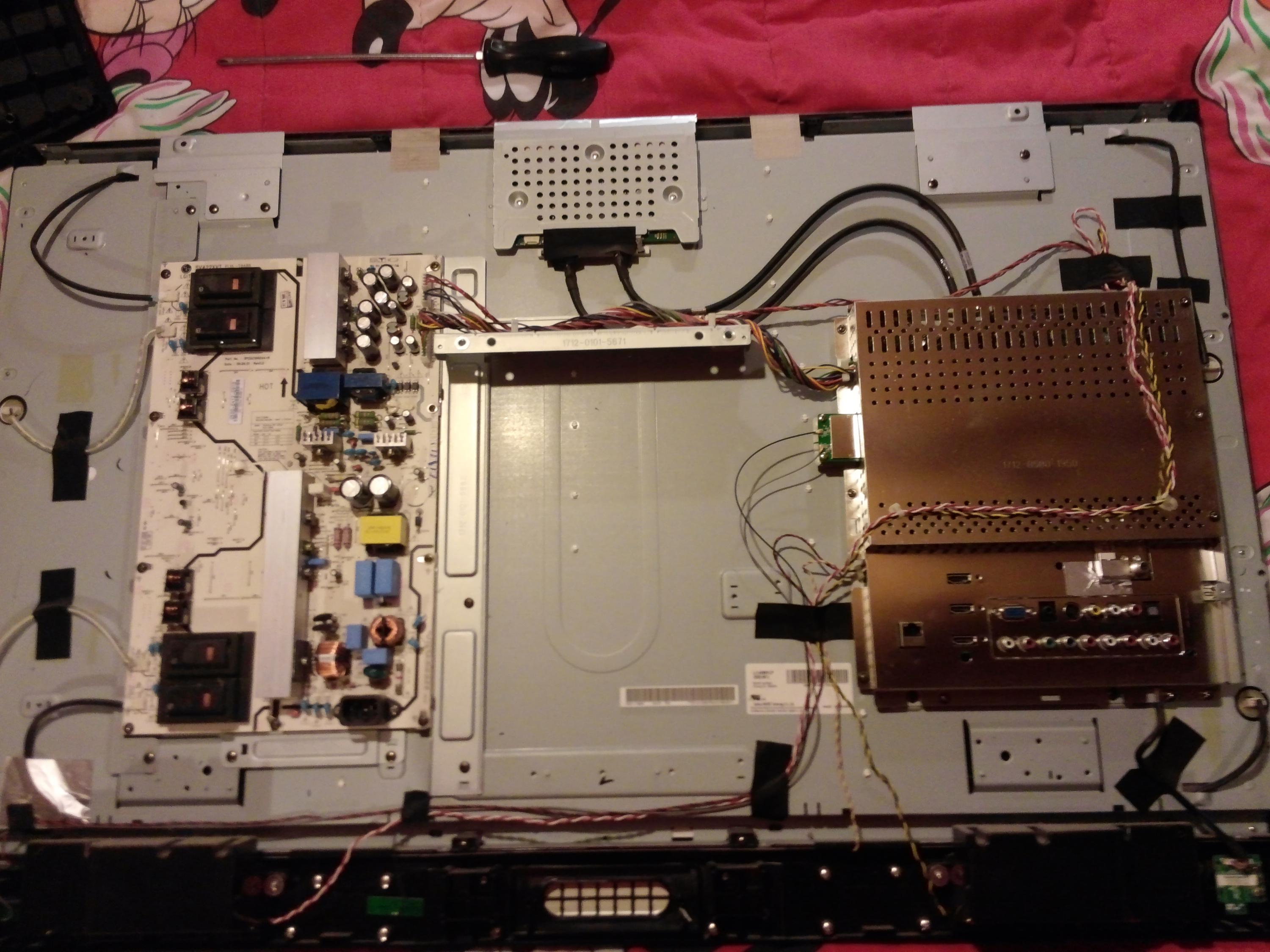

                                  Thanks everyone. When I measured voltage using the 450V cap hole on the main board I got a reading of 37.6ACV on Fuse A (Red stripe) and a reading of 17.47ACV on Fuse B (Yellow stripe). This to me seems suspect in that I am not getting a 120ACV on any fuse now. To take the reading using the 450V cap I just jammed a lead to my meter in the hole of the cap as described by "tom66". The symbol that was where I probed for ground using the 450V cap negative (and no capacitor was present) had this symbol: (- near it. Is this the correct spot? I also measured voltage at the 5VSTBY pin and came up with a reading of only .351ACV. I did try it on a couple of other pins (marked 12V or 18V) and got the same reading. The 3 fuses on the control board still read nothing. Now I'm confused and not entirely sure that I'm testing correctly because my readings do not seem to make sense to me. But I really have no idea what I'm doing anyway which is why I'm so dependent on the good advice here. :0)
                                  Any tips advice?
                                  • Matt C
                                    • Feb 2014
                                    • 14
                                    Can I include some different information that would make it easier to guide me through the diagnosis? Or is anyone aware of the main part(s) that would cause this malfunction? I'm not opposed to replacing an entire board if that is what it takes.
                                    • Matt C
                                      • Feb 2014
                                      • 14
                                      guess that I'll call Vizio and have them come out to repair...
                                      • Matt C
                                        • Feb 2014
                                        • 14
                                        Follow up for anyone looking to do repair themselves. The repair ended up being the control board (green circuit board). Because the Vizio logo lit up but did not change when the power button was pressed the repair man deemed it the control board. He ordered and replaced the board, synchronized the remote and all work well.
