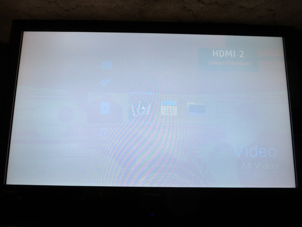

    My viewsonic went all bright white / negative, so after reading here it looks like a TCON issue, I measured all the gamma voltages and other voltages. I used the spreadsheet made by tom66 and it seems the voltages are all out, AVDD (3.27), Vcom(1.63), Von(0.7), Voff(2.48). Vin seems a little low (11.5V) Is there any further way to troubleshoot this, or should I just board replace?
    Thank you.

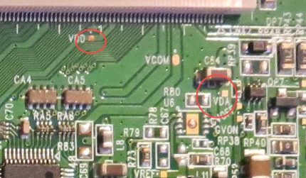

        Re: Viewsonic N4785P TCON Issue

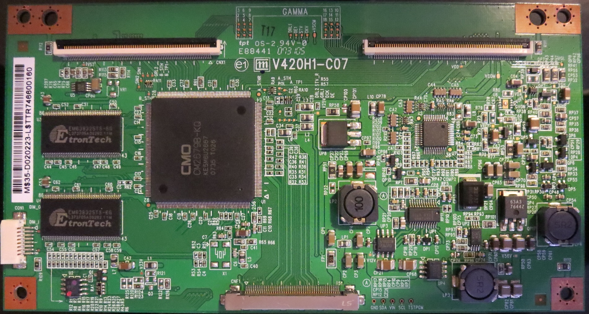

        Tom you are correct, I took VDD on the PCB to be AVDD and looks like on my board it is simply labeled VDA, it measures 13.7V. (attached)

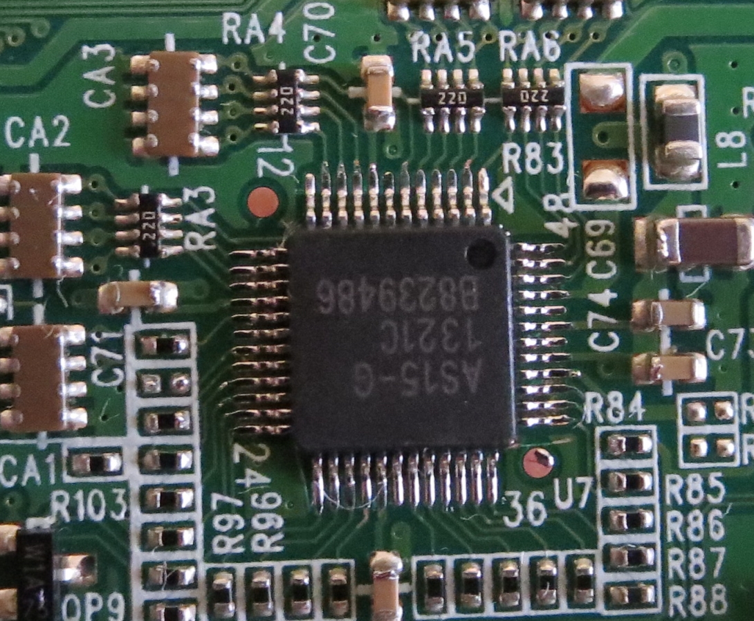

        The gamma IC is an i7868A, which appears to be an intersil chip, but I can't find any datasheets on it, does anyone know if an AS15 is pin compatible?
          from another user:-
          as15-f=as15-g=as15-u= as15-hf=tsl1014if=hx8915a=ec5575=sl1015i=rm5101=aat7200 = all are equal.
          https://www.badcaps.net/forum/showthread.php?t=33806
          Do not know if others will work, you'd have to compare datasheets.

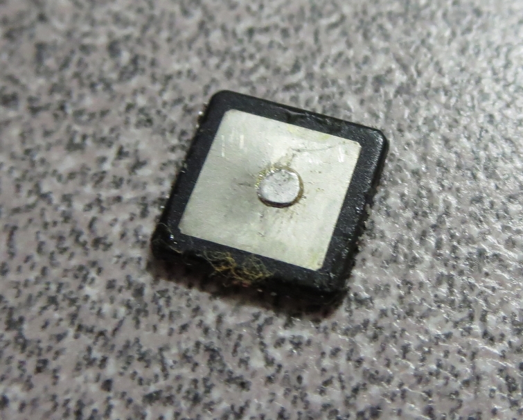

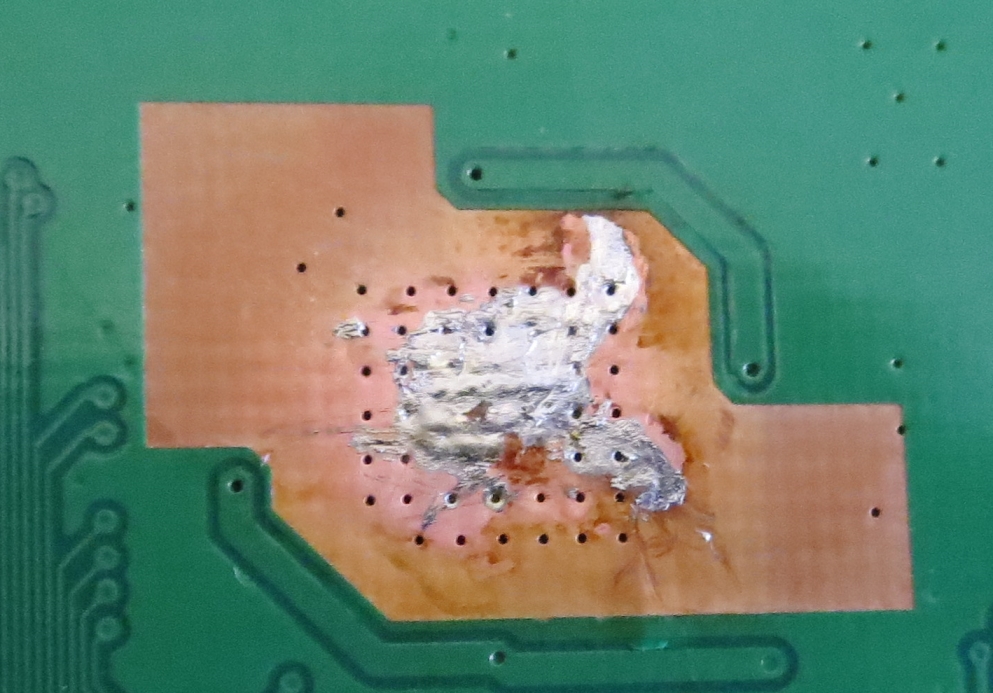

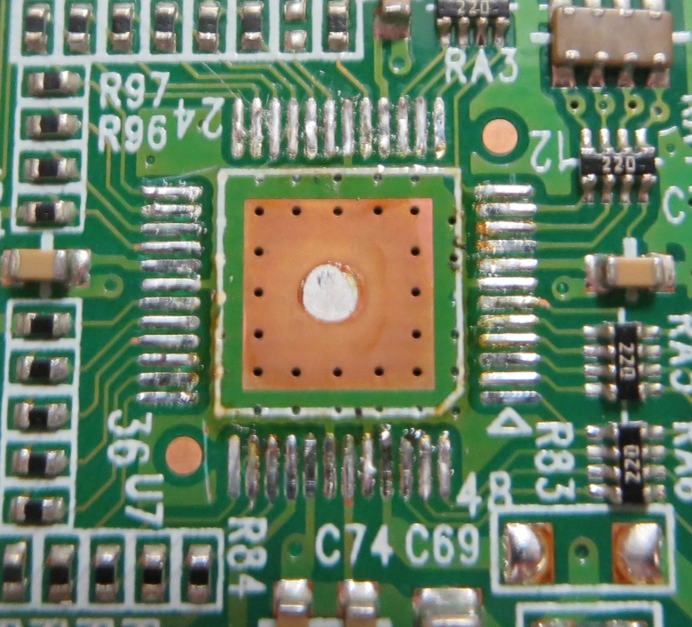

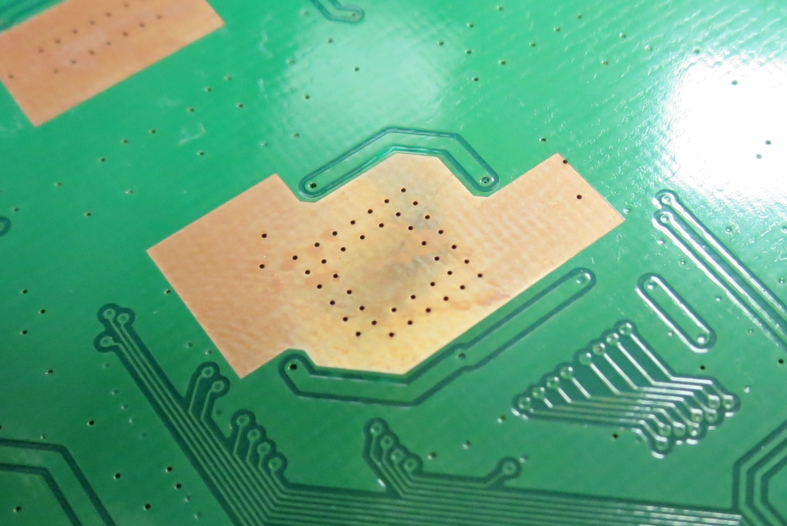

            Cut the legs off the IC with a razor knife, swept the legs away with soldering iron. Had someone hold the IC and hit the bottom of the PCB with a microtorch. Everything came away easy. Seems like this chip was poorly soldered to the thermal plane, possibly why it failed.

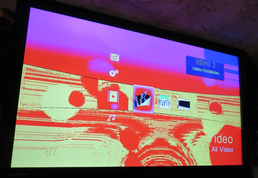

              Couldn't find the datasheet for the i7868A, so I figured I would try a AS15, waited a month for an ebay special, soldered it on. This is what I got, also it got really hot fast, so it would seem they are not pin compatible to the i7868A. (I have since ordered a i7868A). I soldered the AS15 thermal pad by hitting the bottom of the PCB with a 250W soldering gun, seemed to work ok.
