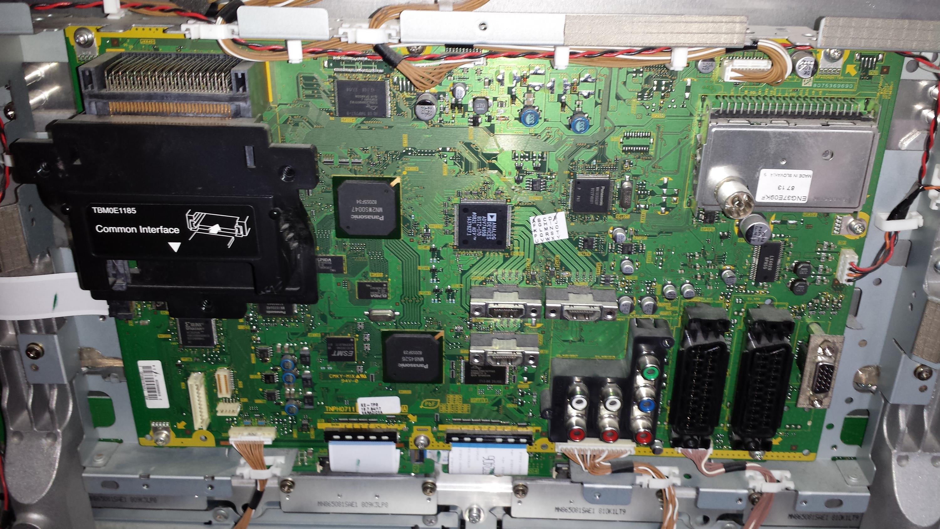

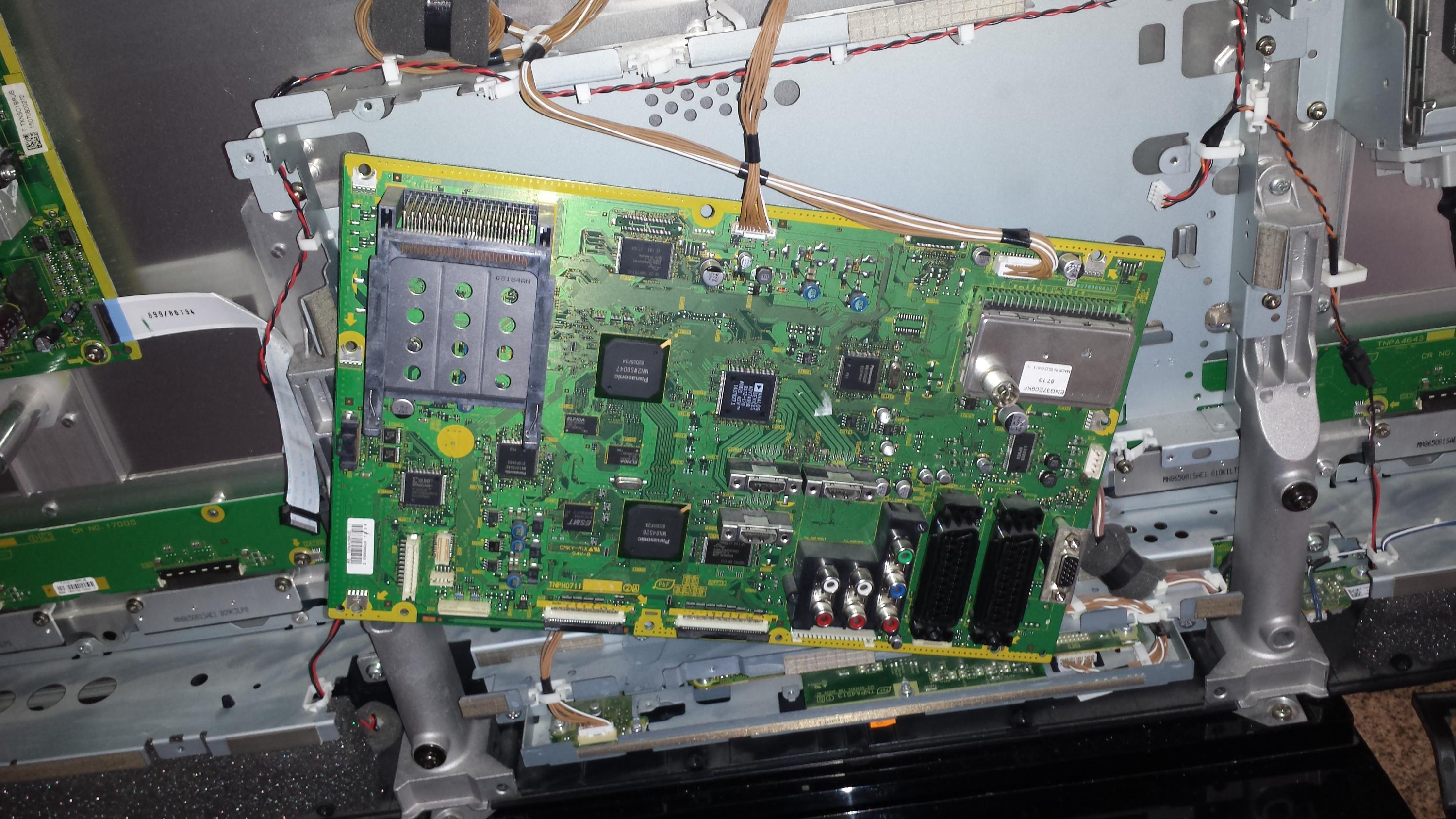

    1st I'd check the SUB5V, SUB3.3V on main board; close pictures of main board?
    • sordids999
      • May 2013
      • 2149
      • uk
      Re: Th-42px80ba
      pictures attached

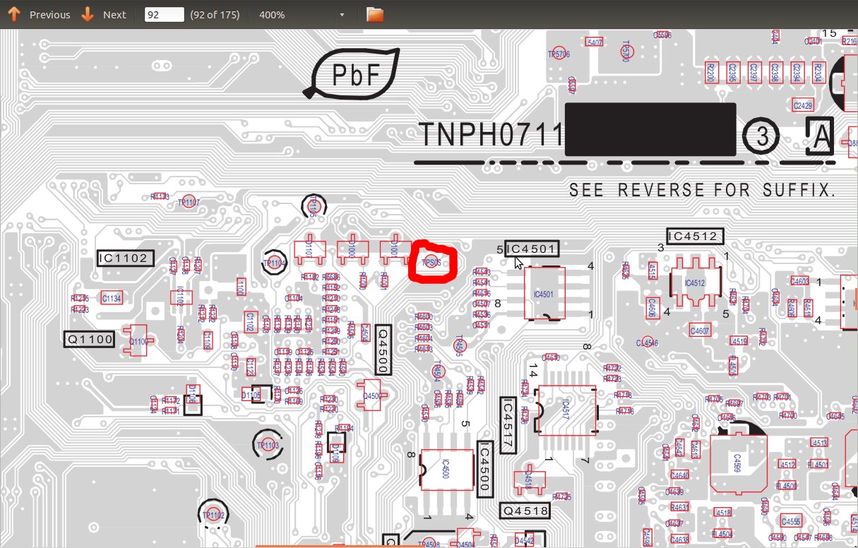

        If you need full schematic of A board, see service manual.
        SOS10 checks:
        - DTV9V
        - MAIN9V
        - SUB5V
        - SUB3.3V
        - MAIN3.3V
        - BT30V (via SOS10 ckt)
        - SUB5V (again, via SOS10 ckt)
        - DTV9V (again, via SOS10 ckt)
        You might be able find point TPS0S on A board which will go HIGH (>3V) when there is an SOS10 event caused by the last three, otherwise, you need to check the other voltages directly.
        Note, TP is on bottom of board - so you will have to lift board up with cables attached and test it there.

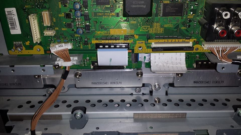

                            I'm thinking leave A52 off but what's the large ribbon? Any evidence of damaged SD or foreign object in there shorting 3.3V line. Measure resistance between pins 1 and 2 of that A52 cable.
                            • sordids999
                              • May 2013
                              • 2149
                              • uk
                              #34
                              Re: Th-42px80ba
                              the large ribbon connects to the buffer boards BUFFER BOARD TNPA4642

                                Re: Th-42px80ba
                                So try hooking everything up normally but leave a52 off, still would like resistance check at cable a52 1-2

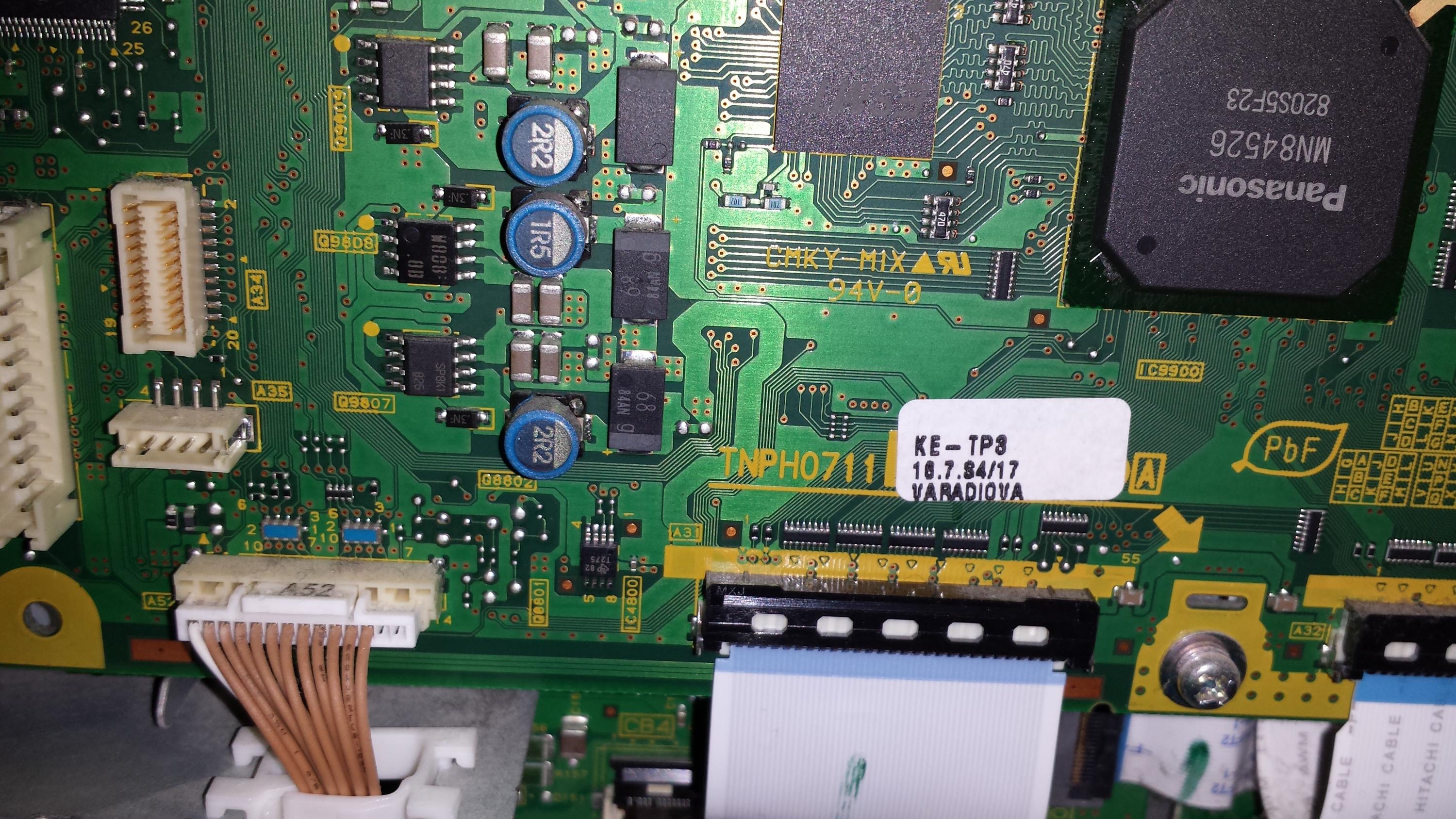

                                  Re: Th-42px80ba
                                  ok so while doing a few tests on A52 for tw2005 now i have the screen working but still cant use A52 thats still disconnected
                                  • tw2005
                                    • Oct 2011
                                    • 6458
                                    #37
                                    Re: Th-42px80ba
                                    well you have found the problem if it's working with a picture. The SD socket or GS board has shorted the 3.3V line which is one of the several voltages Tom had on the list to check.
                                    glad you like to experiment if this is the case, cut the fault finding down real fast.
                                    It is running with a picture ? yes?
                                    • sordids999
                                      • May 2013
                                      • 2149
                                      • uk
                                      #38
                                      Re: Th-42px80ba
                                      yes picture working but A52 still disabled
                                      • tw2005
                                        • Oct 2011
                                        • 6458
                                        #39
                                        Re: Th-42px80ba
                                        Well that's great mate a TV minus a SD reader , no biggy but cheap as chips to buy or remove the assembly and have a close inspection of it. may be salvageable and we have read of kids depositing coins in there.
                                        No major boards or expense
                                        One quick example, not sure if revision is critical but yours is Rev AE
                                        http://www.ebay.co.uk/itm/Panasonic-...item3f20a00071
                                        • tw2005
                                          • Oct 2011
                                          • 6458
                                          #40
                                          Re: Th-42px80ba
                                          You gotta put a pic of it running, that's the trophy piece
