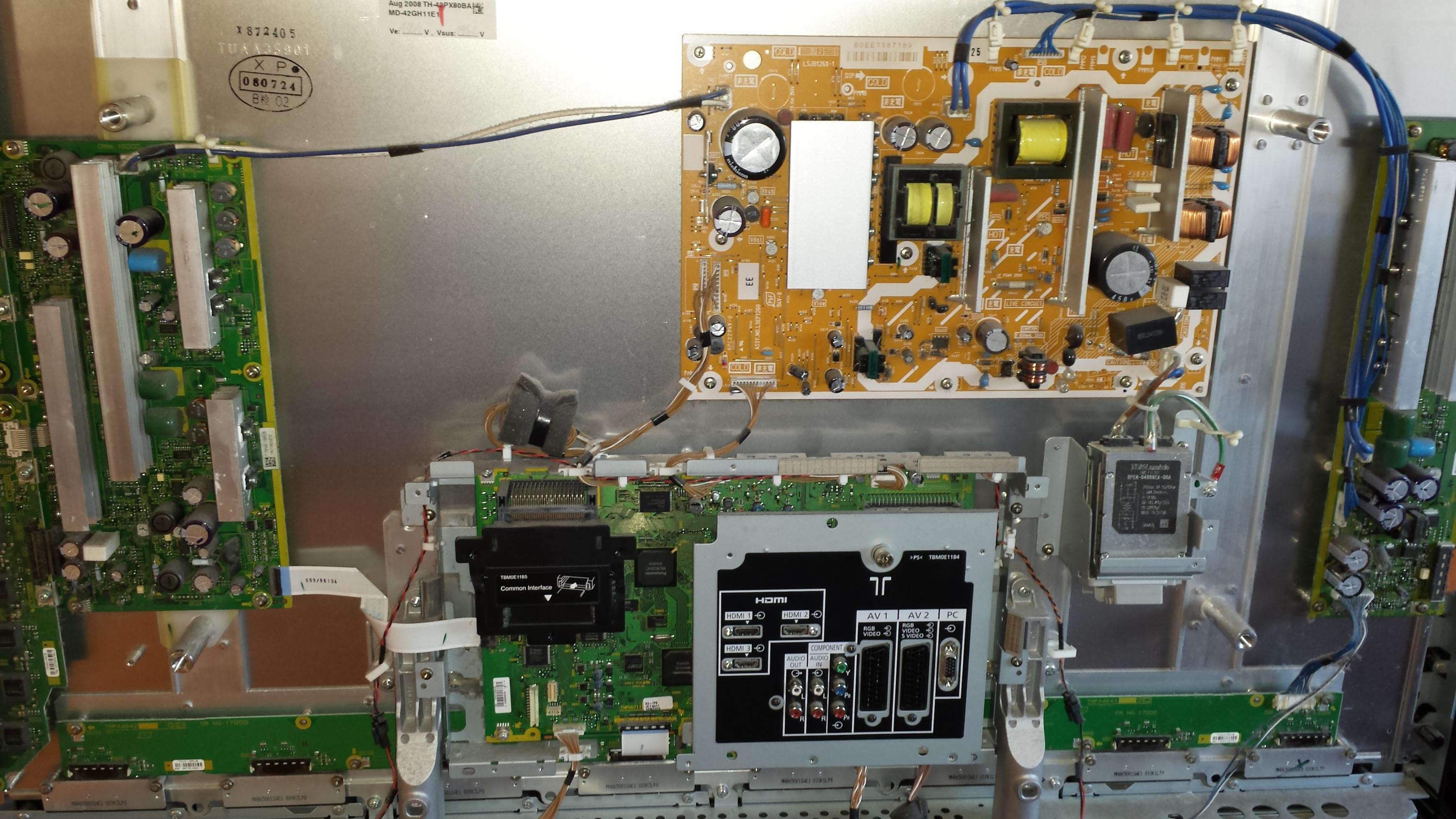

    Th-42px80ba

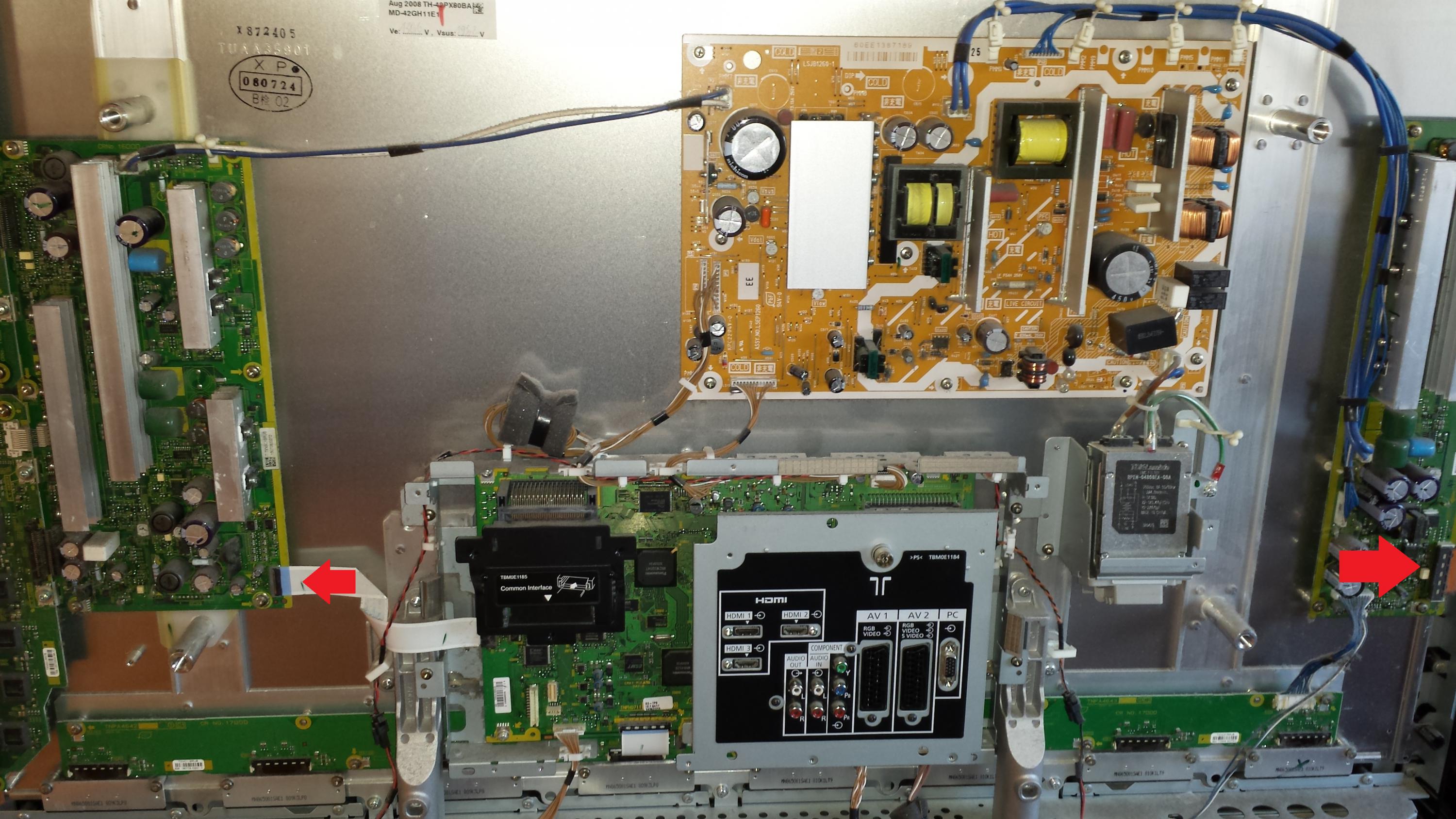

    Hi guys just got this plasma 10 red flashes
    Any ideas
  • Alastair E
    Chief Womble
    • Mar 2013
    • 1963
    • U.K.
    Re: Th-42px80ba
    Try a search--Its been covered recently.....
    TELEFIX
    • sordids999
      • May 2013
      • 2158
      • uk
      Re: Th-42px80ba
      Thanks mate for the reply searched around i cant find much info
        Re: Th-42px80ba
        Check PSU 15V. Is it good?
        • sordids999
          • May 2013
          • 2158
          • uk
          Re: Th-42px80ba
          Checked all voltages from the schematic p12 p6 p7 p25 no voltages,all i get is a clicking sound on the psu when its turned on
          • flocko
            • Nov 2012
            • 1121
            • uk
            Re: Th-42px80ba
            Have you checked fuses F401+F402 and Q406 for short on the power board
            • sordids999
              • May 2013
              • 2158
              • uk
              Re: Th-42px80ba
              Fuses seem ok
                Re: Th-42px80ba
                Try unplugging SC and SS ribbon cables, does blink code change to 6/7/8 blinks?
                • sordids999
                  • May 2013
                  • 2158
                  • uk
                  Re: Th-42px80ba
                  disabled both cable ribbons but still getting 10 red blinks
                    Re: Th-42px80ba
                    OK ribbons back in what's the voltage you get on connector P6 (power board) pin 7,8,9, multimeter black on chassis ground, red on pin.
                    • sordids999
                      • May 2013
                      • 2158
                      • uk
                      Re: Th-42px80ba
                      pin 7 2.0 volts
                      pin 8 0.8 volts
                      pin 9 0.8 volts
                      these measurements are when the tv is first turned on but quickly drop to zero after a few minutes
                        Re: Th-42px80ba
                        Can you hold the reading on pin 7 as the TV clicks on and off and note any changes in the voltage? Go from unplugged to 10 blink code.
                        • sordids999
                          • May 2013
                          • 2158
                          • uk
                          Re: Th-42px80ba
                          pin 7 15.35 volts when the TV is first turned on then drops to 2.35 volts after the clicking sound,then keeps dropping until zero volts
                            Re: Th-42px80ba
                            OK, now try pin 1 and hold the reading in the same way.
                            • sordids999
                              • May 2013
                              • 2158
                              • uk
                              Re: Th-42px80ba
                              pin 1 1.0 volt then again it drops to zero
                                Re: Th-42px80ba
                                OK, now check pin 11 of P25; the PANEL_MAIN_ON. It should turn HIGH for +15V(S) to turn on, which is pin 1 of P6.
                                • sordids999
                                  • May 2013
                                  • 2158
                                  • uk
                                  Re: Th-42px80ba
                                  Pin 11 of P25 nothing
                                    Re: Th-42px80ba
                                    OK, this is looking like a main board fault.
                                    I've got a PZ70BA right now with a similar problem.
                                    Does set have any fans -- if so do they spin at all?
                                    • sordids999
                                      • May 2013
                                      • 2158
                                      • uk
                                      Re: Th-42px80ba
                                      No fans tom
                                      • sordids999
                                        • May 2013
                                        • 2158
                                        • uk
                                        Re: Th-42px80ba
                                        Ill try and find a replacement board thanks tom
