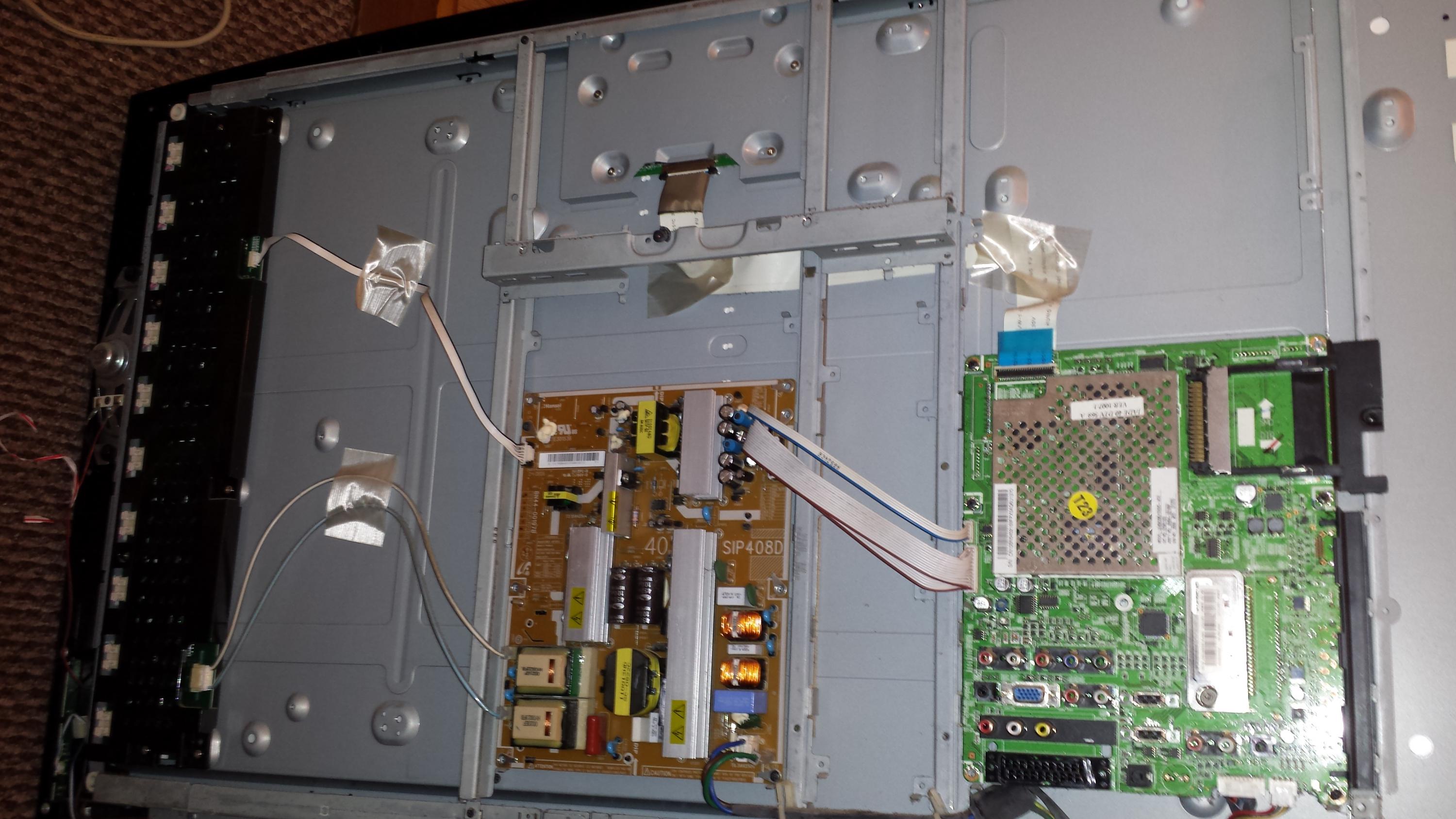

    Hi all, I got this samsung 40 inch lcd and its got no power coming from the power board, I tested the 5V_STB pin and it read 0v with power cord connected, I had a look about the board and found one of the fuses had blown, I tried replacing the fuse with one the same value but it blew straight away, Would anyone know if i could repair this on a component level, I have all the equipment and am ok with a soldering iron just don't know how to go about diagnosing the exact fault, I've included a few pics that might be usefull, Can see any other visable damage on the board apart from the fuse,

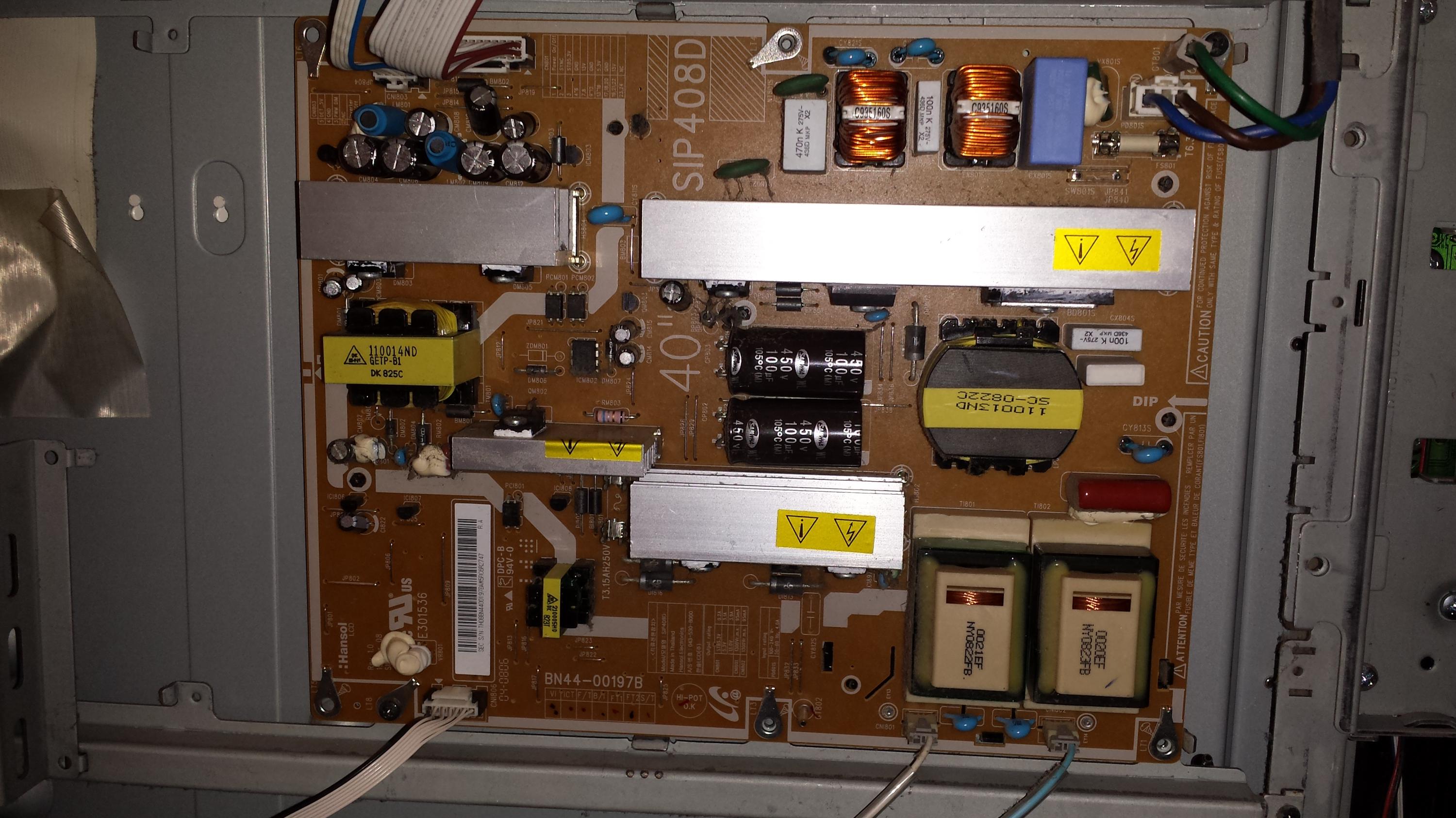

    Re: LE40A336J1DXXU No Power
    1st thing you want to do is an in circuit test of the bridge rectifier marked BD801S ON THE PCB BOARD.
    you will see on the bridge markings of -~~+
    you want to test - to ~ you should have reading ONE way only,when reversing meter probes, with dmm set to 200ohm ,and power OFF AND UNPLUGGED FROM THE WALL OUTLET.
    ~ to ~ you should have no reading either way
    ~ to + should show reading one way
    do these readings and report back what you find
      and the part number of ICM802....
                Schematic for reference:

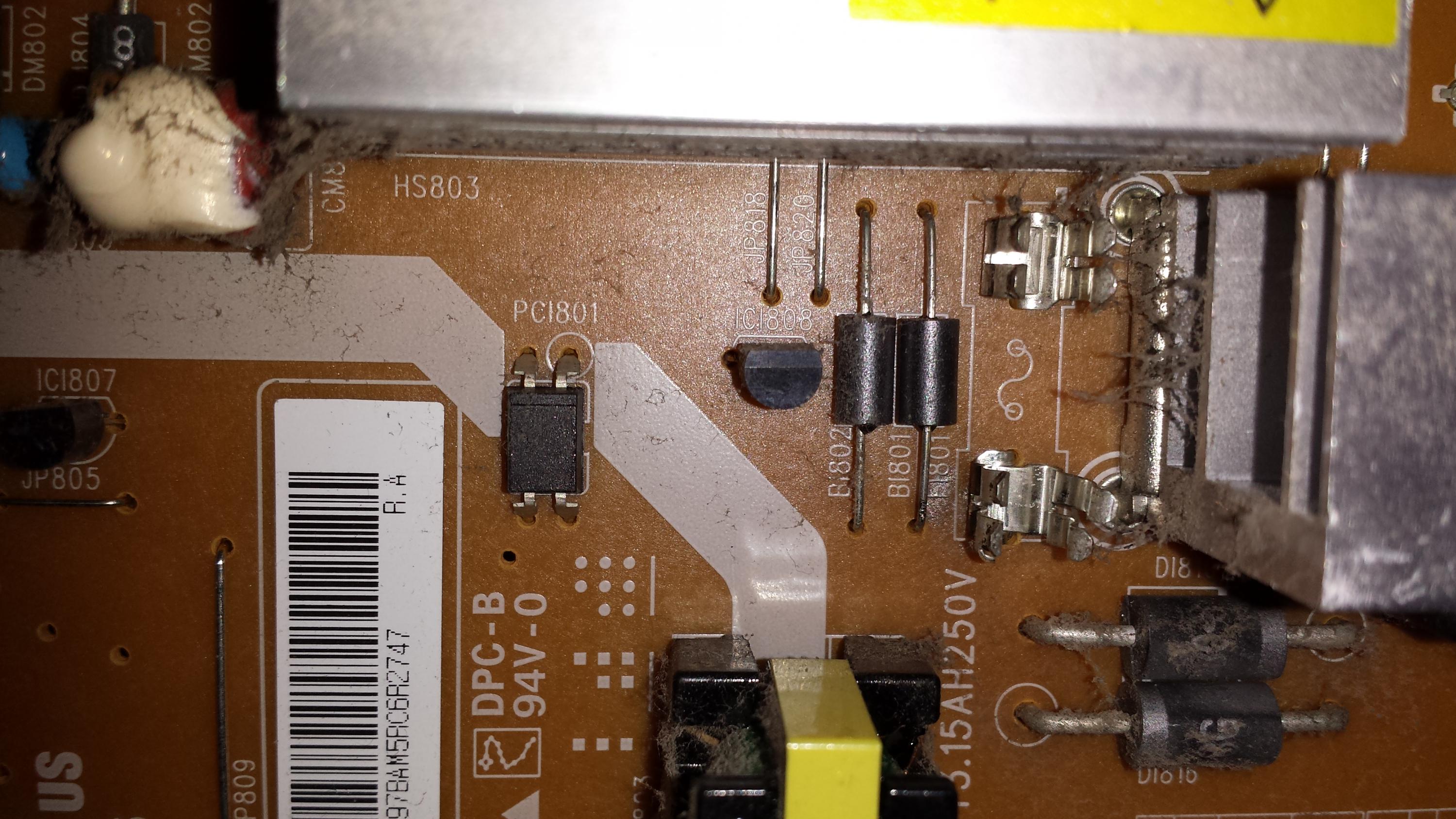

                  nice one tom.
                  check pins 7 and 8, 200 ohm setting this is VCC and GROUND what reading do you get? datasheet here
                    Again I got 0 readings when multimeter was set to 200 ohms so changed it to 2000 again and now i got .699 one way only, Hope this helps. ;-)
                      hmm ,strange your not getting a reading on 200ohm range twice,have you checked the battery in your meter,and for a blown fuse in the meter?.
                      what reading do you get when shorting the probes together?on 200ohm range?
                              Ok so i have 2 of the exact same multi meters, when both are set to 200 ohms and i short probes i get i reading of 01.2 and on the other a reading of 00.6, Maybe you could suggest a good multi meter i should invest in, ;-)
                              the meter showing the lowest resistance (00.6)ohm is ok.
                              the fuse is obviously blowing due to a short,id suggest taking an ohm reading across the fuse clips and record that reading,you have a couple of heatsinks around that fuse and what looks like the stb transformer.
                              try removing the transistors/diodes one at a time on those heatsinks and recheck resistance across fuse holder ,if you find it goes really high resistance after removing one ,its quite likley thats the culprit.
                              then test the transisitors/diodes on those sinks for shorts,better results when they are removed also as you wont be picking up random resistance from anywhere else.the atlas dca tester is absolutley brilliant for doing this,it cuts the guesswork out.
                                What resistance do you get measuring at the two legs of the main filter (450vdc CAPS laying side way)?
                                BTW, there are 2 fuses, one is the main AC fuse, the second is the fuse for the B+ PFC out put, so which one is blown?

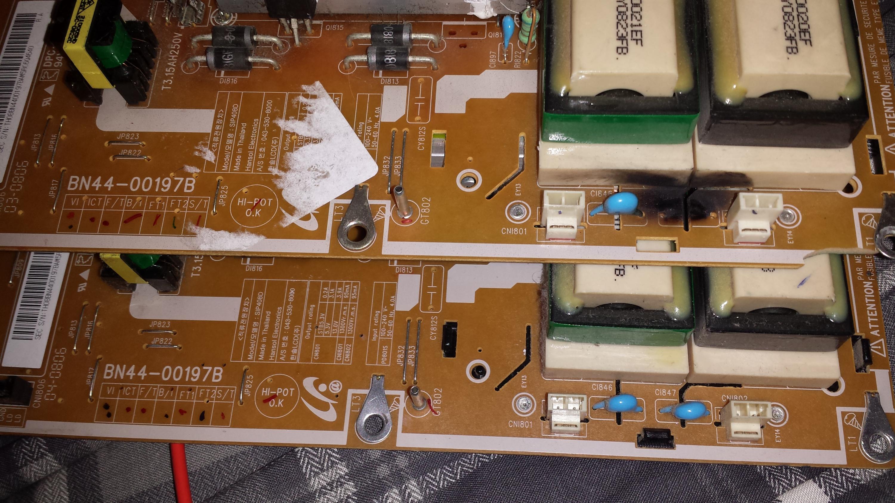

                                    If you mean the top board, if that's the only fault, clean off the carbonisation and replace the blue cap.
                                    • Easky15
                                      • Sep 2013
                                      • 285
                                      • Ireland
                                      Tried this and its now just stuck in standby,
