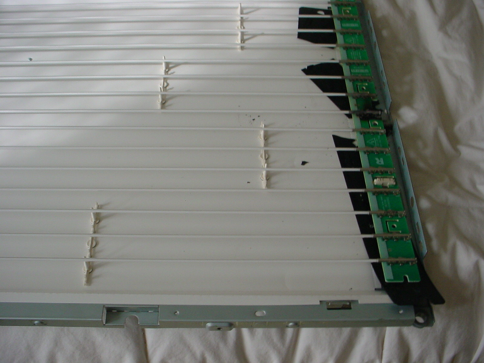

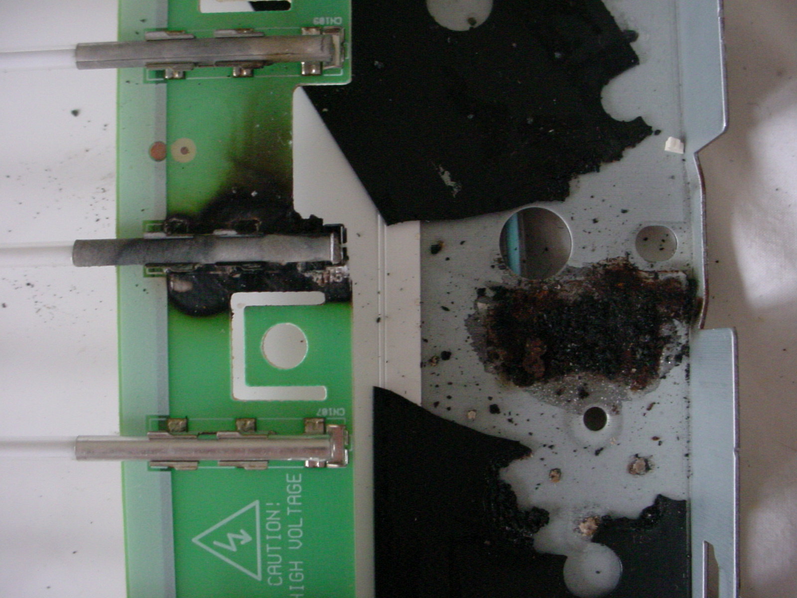

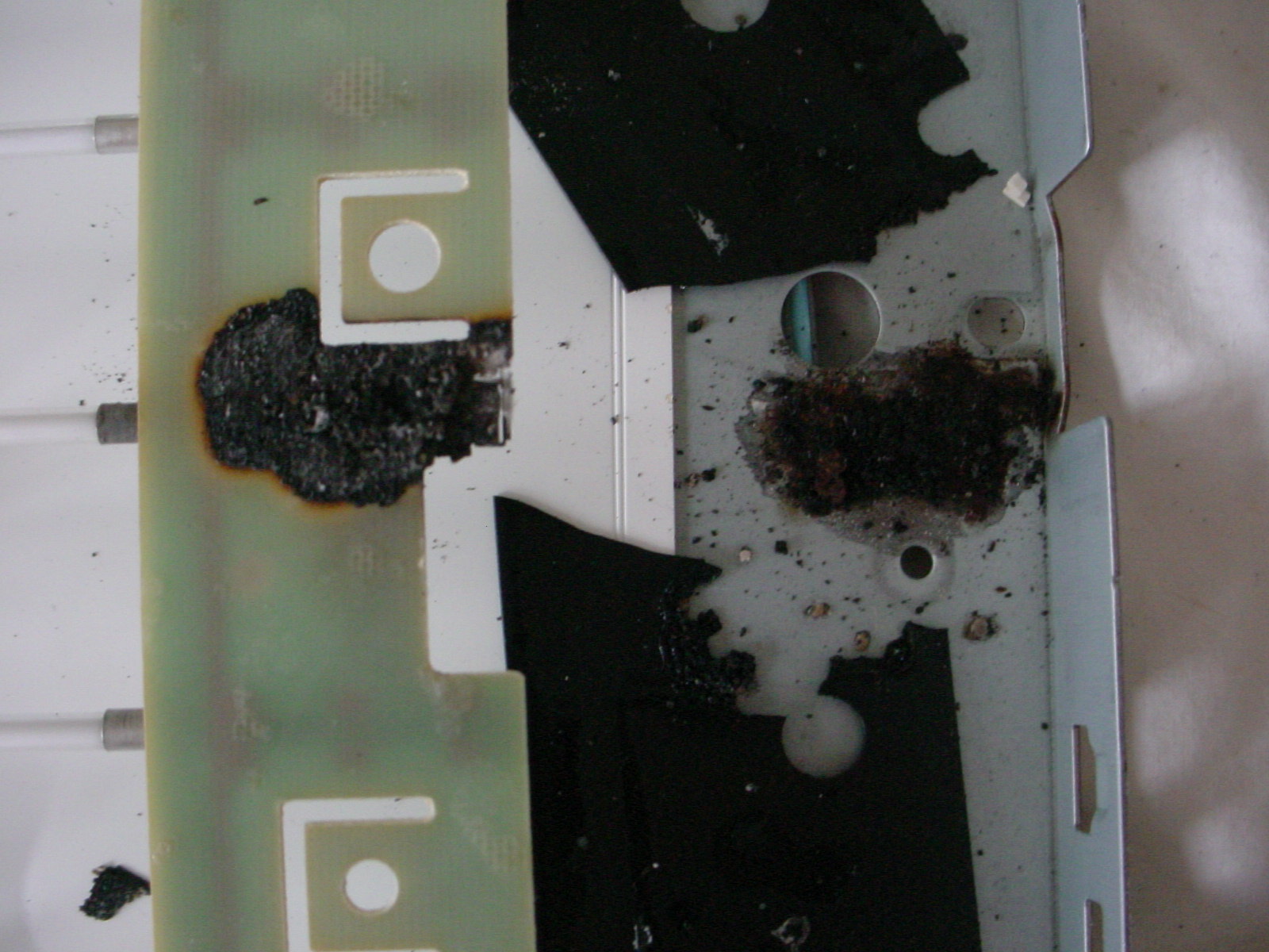

                Found The Problem... Short to ground in Bulb assembly. See pictures...
                  Re: VIZIO VL320M Dark Screen,has sound
                  Ah I see why we did not see the lamps flash on at all, they are EEFL not CCFL so they are connected in parallel with no ballast caps for each lamp, since the the high voltage is shorted to ground the high voltage never gets to the lamps. Great job taking the panel apart.

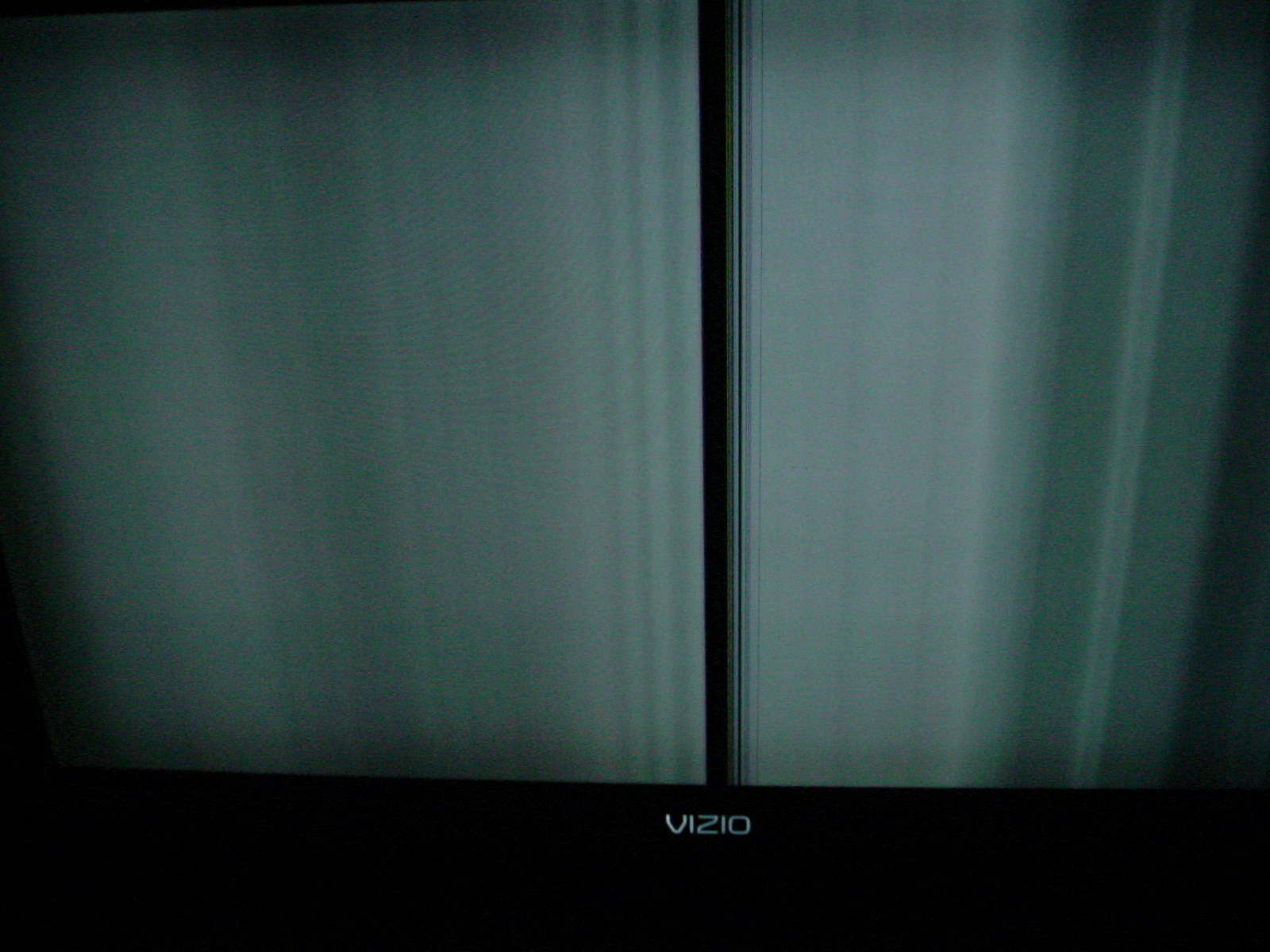

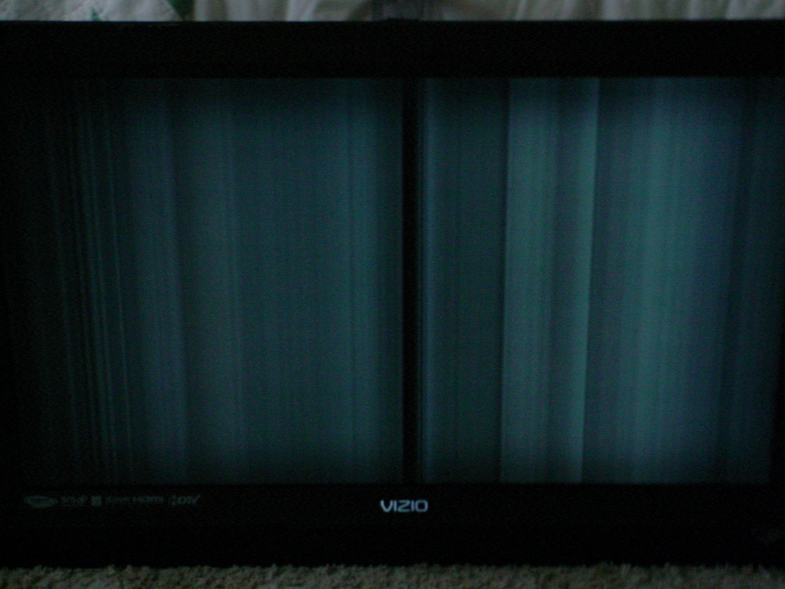

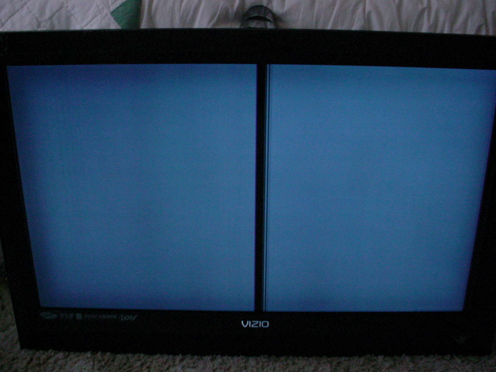

                      Hi budm, I hope you are still with me. I received the new lamp holder and insulator and installed, I have lines on screen but no pix. Has sound and there is movement on the screen but no pix. Will send pix with this. Very dim, I'm sorry but I can get better pictures this evening if you need.

                        another picture, not much better

                          Looks like some thing went out on the panel or the T-CON, something to do with TFT drive IC on the flexible ribbon between the glass panel and the long circuit board where the tab bonding are. Did you see this problem before the backlights quit working?

                            I think this is most likely a bad panel especially if that middle black bar never moves.

                              I did not see any pix before I got the backlights on and then I had this. There are two or three panels between the bulbs and the screen. I could have those reversed in order. Those ribbon cables could have touched the chassis while I was working on the bulb holders.

                                The back lights failed again and I have turned it into a parts set. Thanks to all that assisted me in the attempt to repair it...Geraposi
