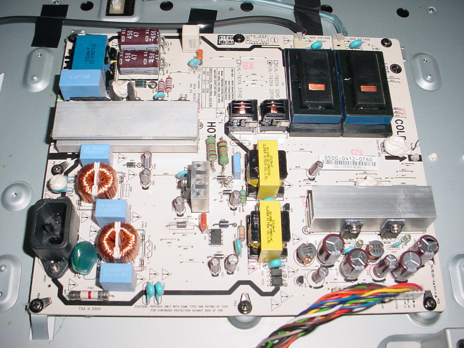

    Picture of the power board?
      Re: VIZIO VL320M Dark Screen,has sound
      Hope this is clear. Thanks for the quick reply,

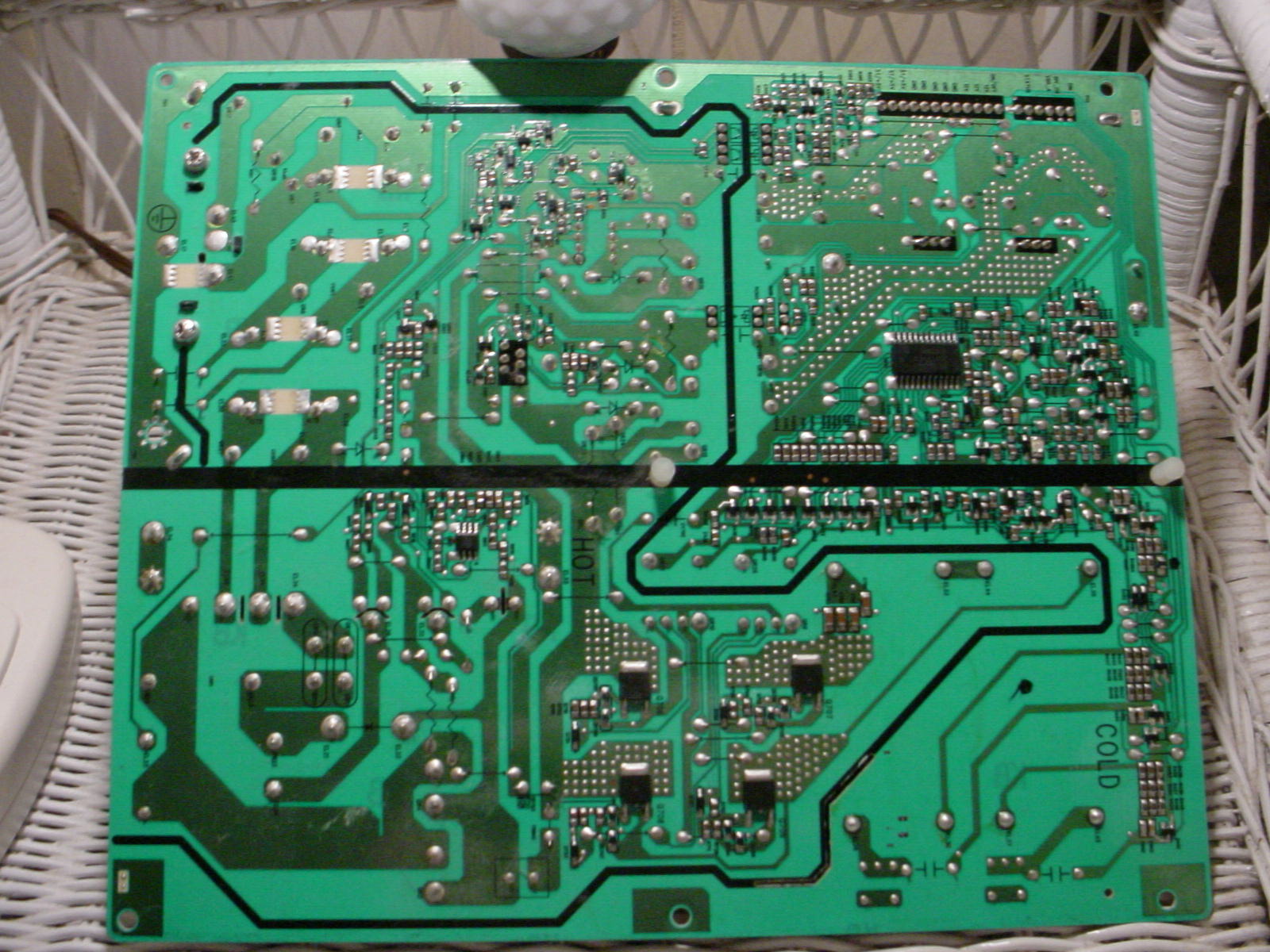

        The power supply-inverter board is getting correct signals from the main board for the backlights. Pictures of the bottom side of the board?
        http://www.shopjimmy.com/vizio-0500-...t-inverter.htm
          I hope you were talking about the back of the power board...

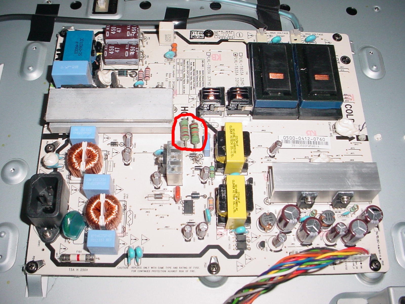

            Using that photo these resistors highlighted appear to be for fusing the inverter feed. Test them on an ohm-meter - they should show very low ohms (<10 ohms, I'd guess.)
              The resistors you circled are color coded, red red orange, 22k. They are in parallel with each other and measure close to 11k.

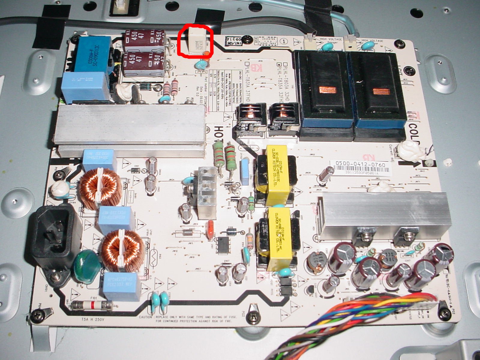

                D'oh - that's my error. Try this resistor instead.
                  That is F601. It is good. You may be talking about R608 and R618, two resistors thatare hooked in parallel and connect to the negative terminals of the two 47ufd 450v caps, they are very low resistance and measure less than ohm
                    That F601 (Fusible resistor) is for feeding the B+ to the whole circuits (inverter and the rest of the power supply), at least the power MOSFETs for the inverter is not shorted out. It can be the PWM circuit that is not driving the Gate drive transformer.

                      budm, Did I have the back side of the correct board?
                        Yes. The board is only $34.
