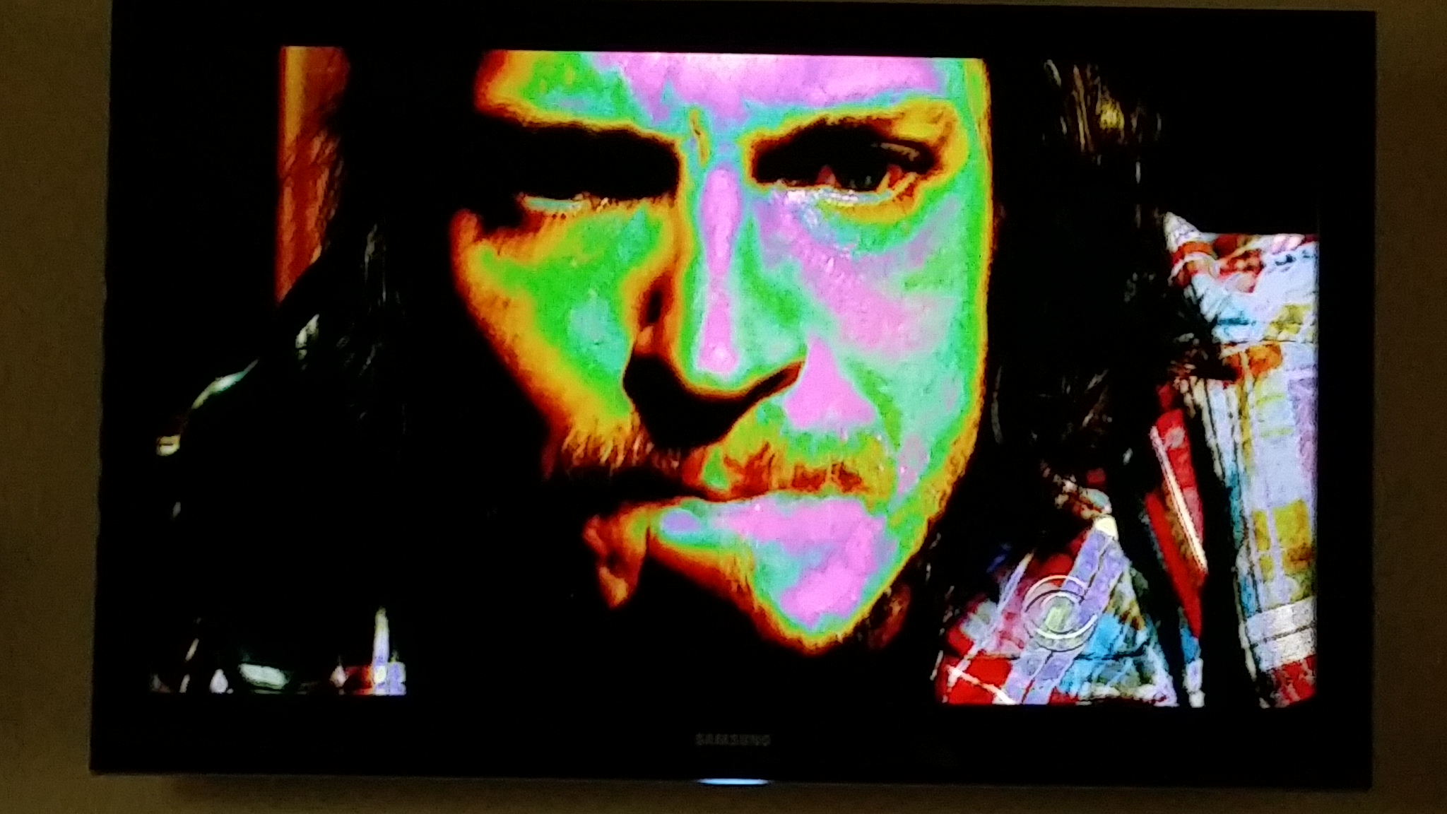

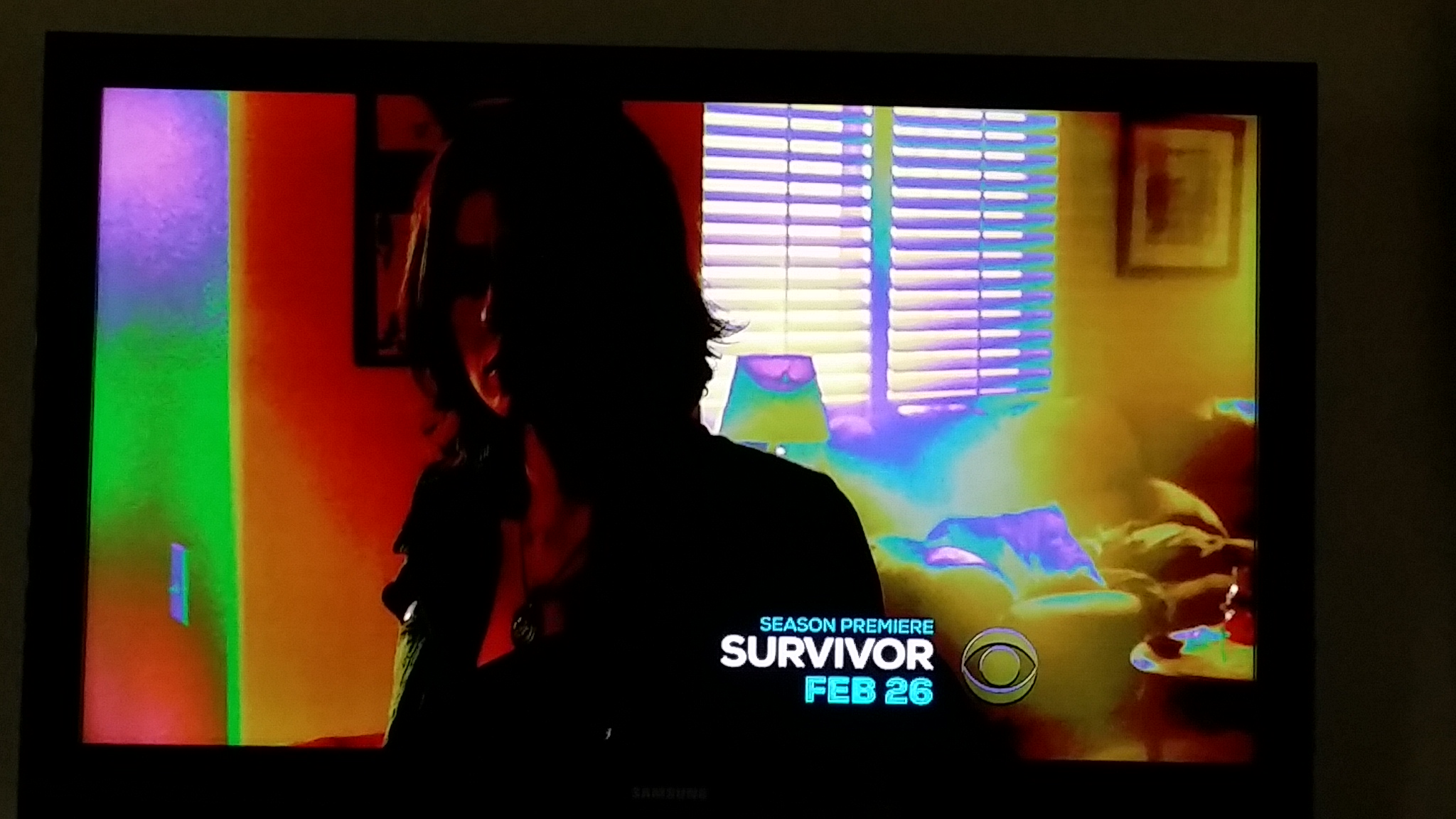

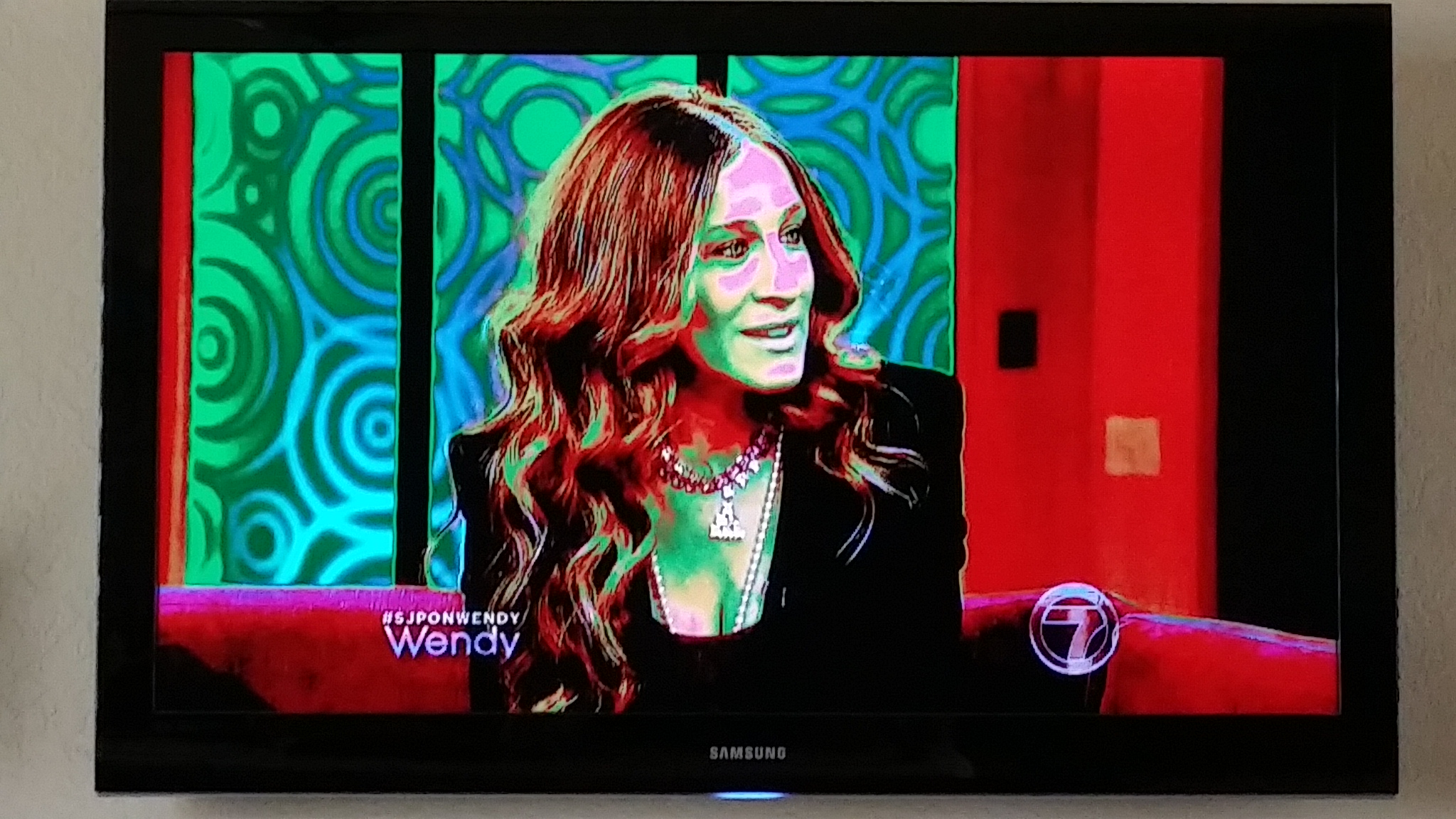

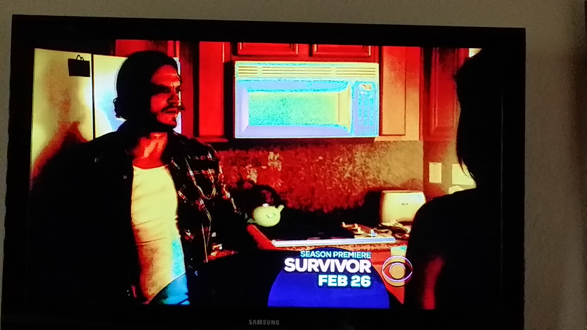

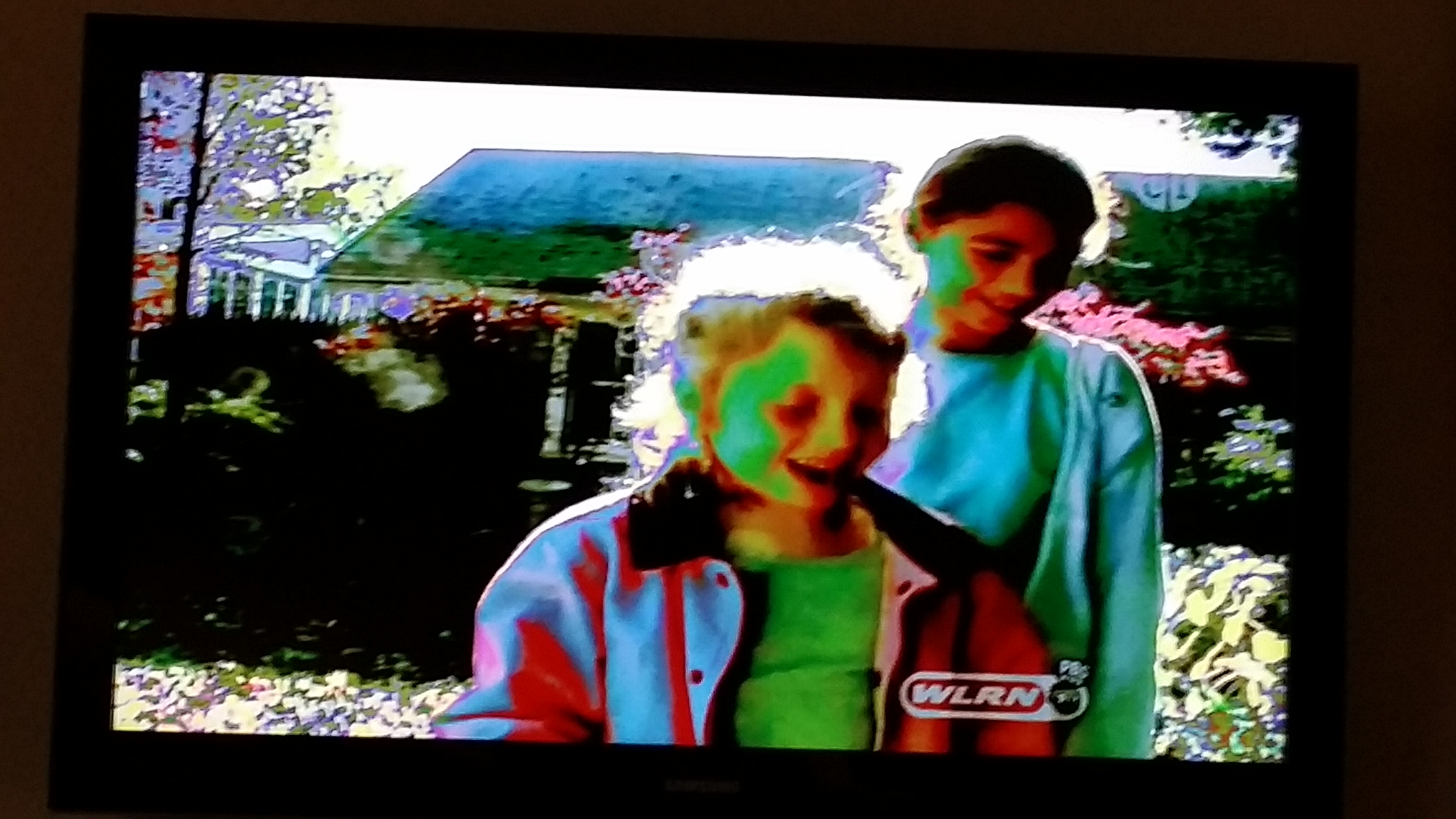

    Hi, I've got an issue with my LN46A550 that just started and I'm not sure if it's in the PS, TCON or Mainboard and was hoping somebody could dx this from pictures to at least have a high degree of confidence in what part to replace. I looked at the PS and did not see any obviously bad caps and I removed and reseated all 3 connectors on the tcon board with no changes. I also went into service mode and did a factory reset.
    Any idea what the problem may be based on the pictures? Thanks!

    Re: Samsung LN46A550 Picture Issue
    Because of the sharpness of the image, meaning it's not washed out, I'm gonna say main board. You can test the T-Con but I'm not able to tell you how. Highly unlikely to be PSU
      Wrong panel setting? At first I thought gamma chip but I looked up the tcon for this model and it doesn't seem to have the chip. So I would guess main board as well, try to access the factory settings and change the panel setting.

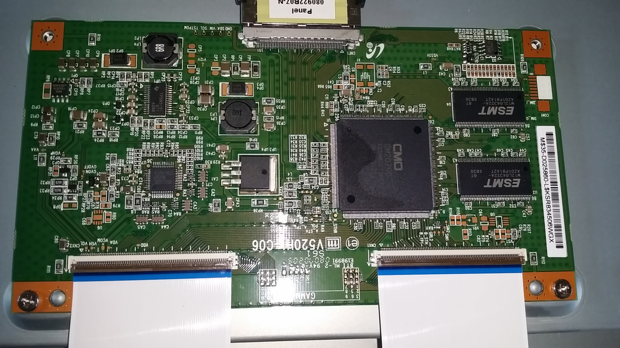

          Hmm, I'm wondering looking on the tcon model number, does your tcon have the AS15 chip? Can you post close up photos of the tcon?
          • tibimakai
            • Jan 2012
            • 3680
            It looks like a gamma chip went south.
            At shopjimmy, shows a A19-H16 chip.
            I have never replaced one of these yet, only the A15-F or G.
            You would be able to measure the test points on the T-con.
            They have to increase gradually from one test point to another.
            The test points are on the top center where it is labeled Gamma. Strat from 1, 2, 3...
            It there is one that is out od the line, then most likely the Gamma chip is bad.
            • T-Rex
              • Feb 2014
              • 14
              Yes, it looks like a A19-H1G chip (attached). So you are talking the 2 square pads of contacts by the ribbon cables labelled 1-9 and 10-18 on the opposite side? And these should be measured to ground. And you say the voltage on each sequential number should be higher, like pin 1 = 1 volt, 2 = 2 volts, 3 = 3 volts (examples)? Sorry, I'm not an electronics tech but I can sorta figure it out with guidance - thanks!

                Yes you got it. A plotted graph of the points should either be linear or slowly curving (tom ?) Any big deviations are likely chip malfunction.
                  In box marked GAMMA. Voltages will either INCREASE or DECREASE but not both. 1V, 1.5V, 2V, 3V, 4V, etc. and 4V, 3V, 2V, 1.5V, 1V are both OK. 4V, 2V, 3V, 1V, 1.5V is NOT OK. The voltages will not correspond with the numbers but will range from around 0V to 15V.
                      In my experience, a faulty gamma chip will cause similar problems, but the entire picture will be slightly washed out. It's kinda hard to describe. Both times I've had the kind of image you show, a new main board fixed it.
                      Gamma Problem
                      https://www.badcaps.net/forum/attach...5&d=1387969634
                      Main Board Problem (not the best image)
                      https://www.badcaps.net/forum/attach...1&d=1365633902
                      Do you see how the colors are vivid in the second pic? Kinda like your pics.
                      Try diconnecting any sources from the set, power it on, and pull up the menu. If the menu looks fine with a source disconnected, it's not the gamma IC.
                        You have bad Gamma voltages. Similar picture to one of my repair.
                          Hmmm, I can see partly both. I see the problems in johnboys mainboard picture but I also definitely see the issues in budms picture.
                          The menus also do look off with no source - they are clear but color is kinda off in places like white are yellowed and the gradients are rough instead of smooth.
                          With the voltages off I guess it's safe to say AT LEAST the tcon needs to be replaced. I'd just hate to invest in tcon then still have to replace mainboard. I think at that point it may just warrant a new tv . I guess there is no way to test the mainboard to tell if it is also bad?
                            Yep, agreed. Gamma curve is wrong. You will have to replace t-con or gamma chip. I doubt there is another fault.
