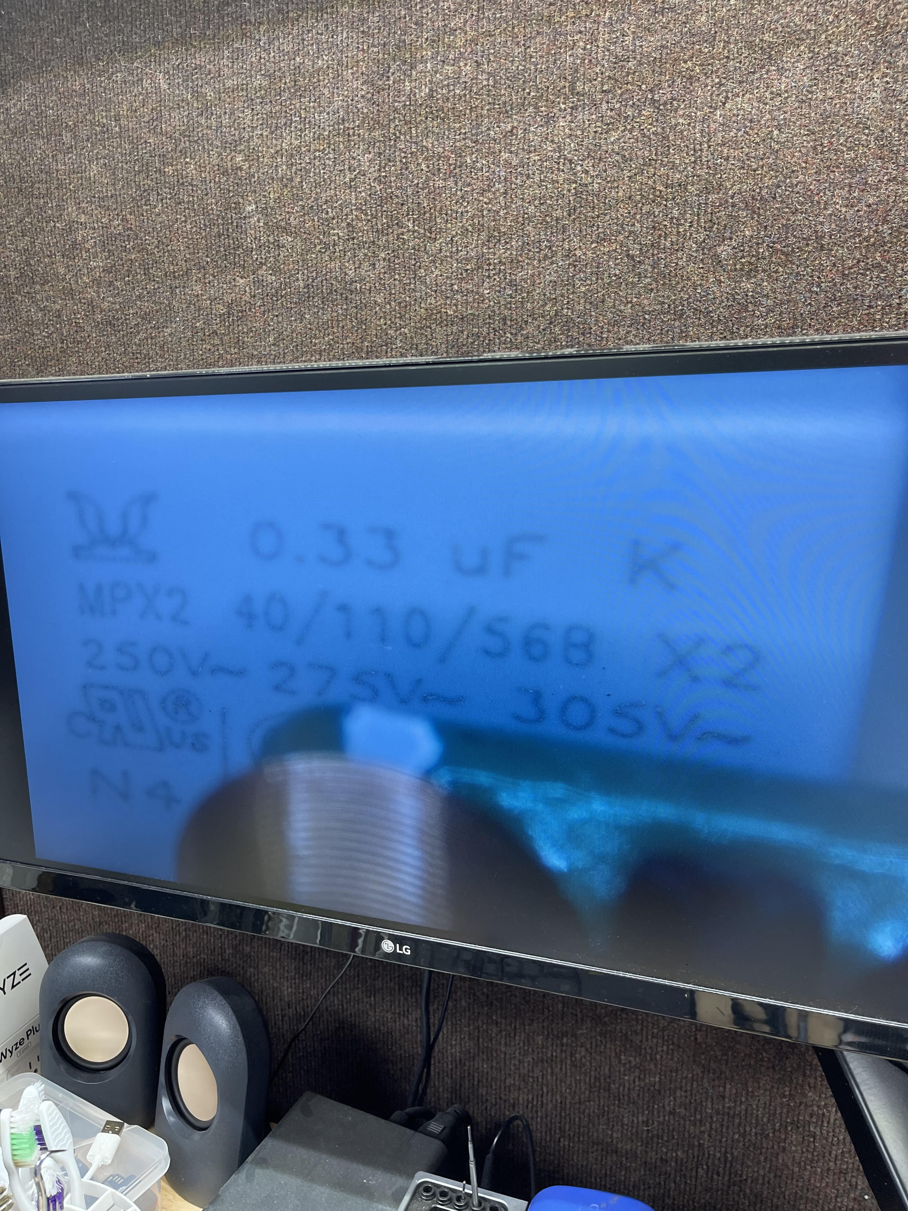

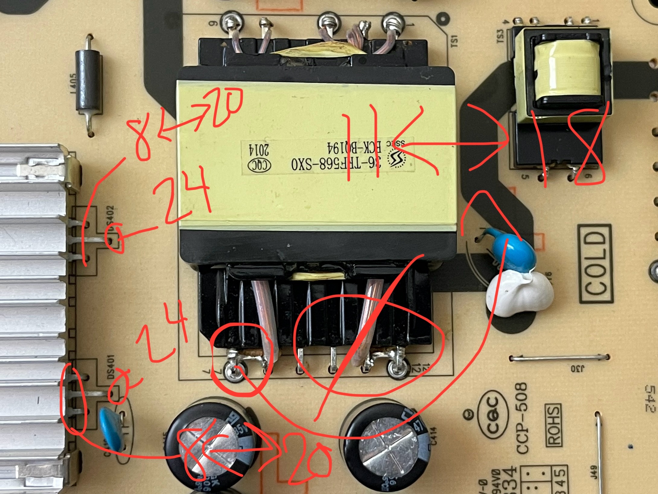

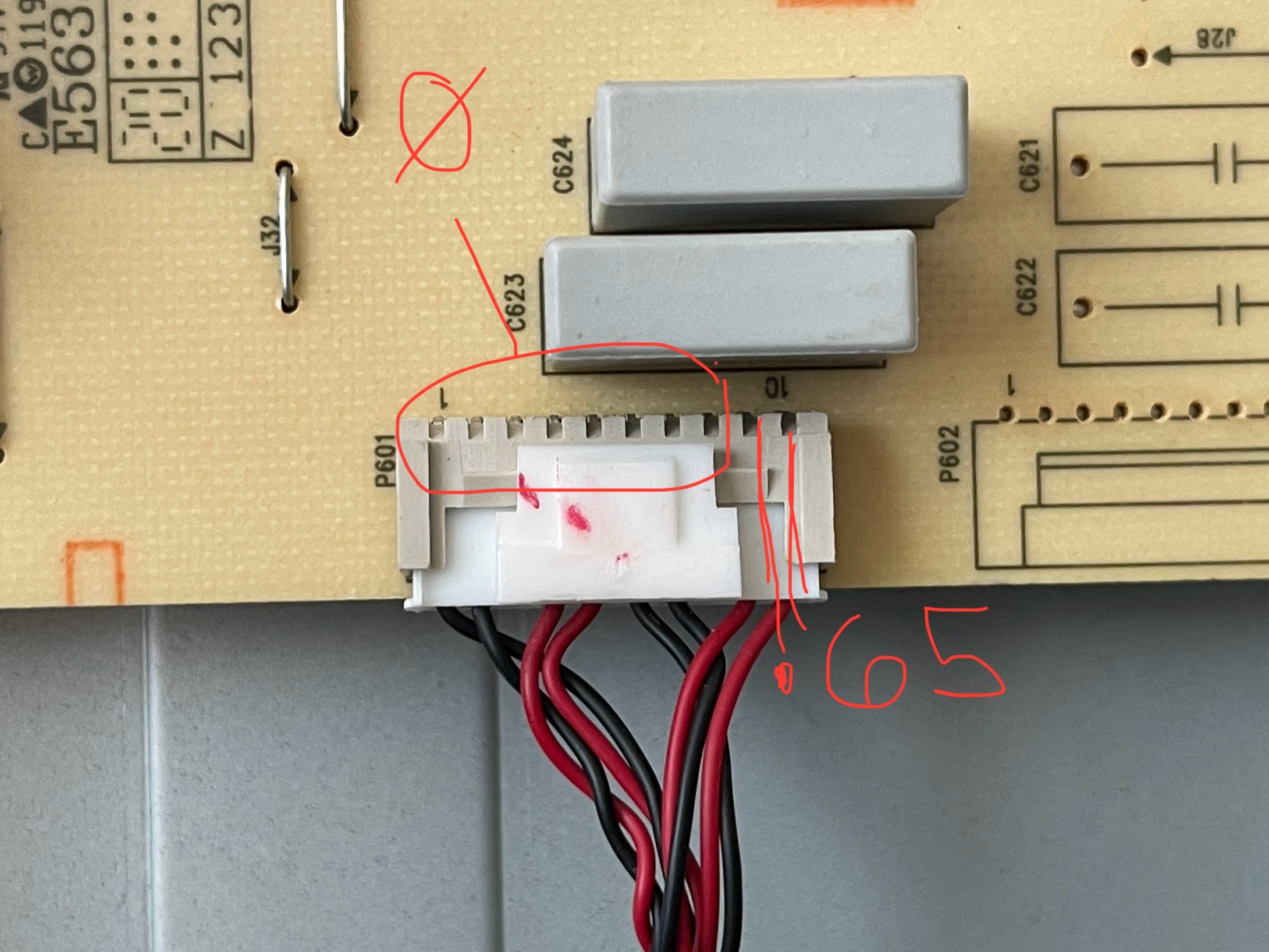

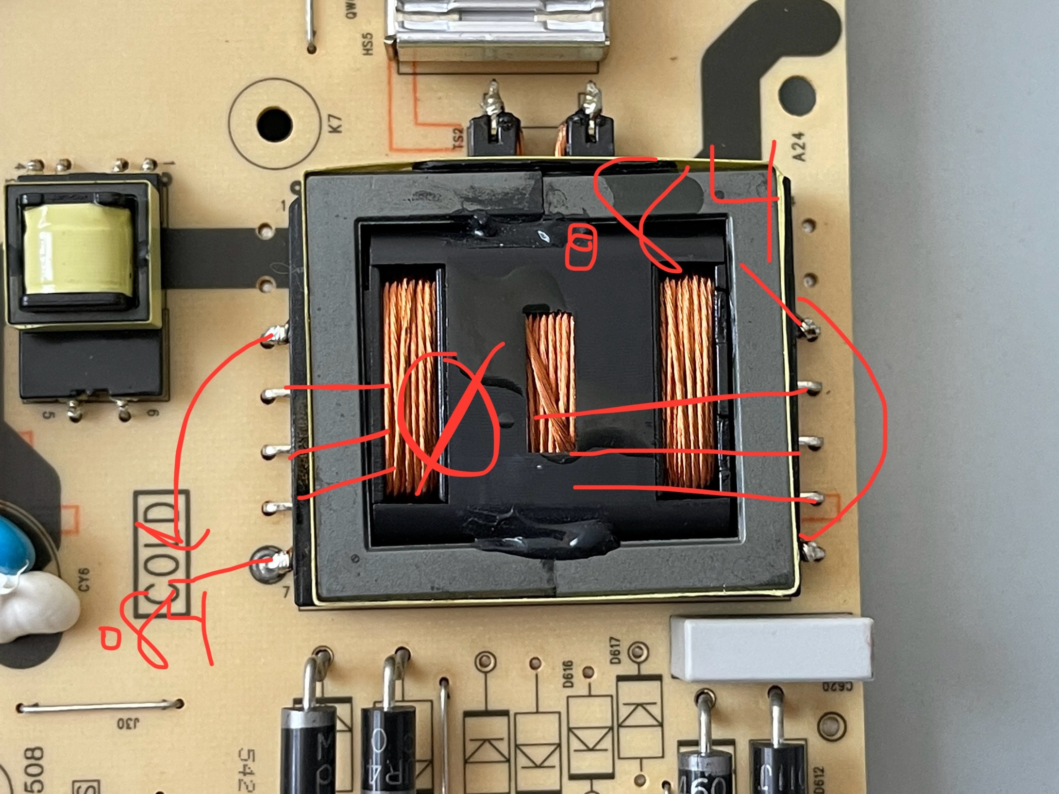

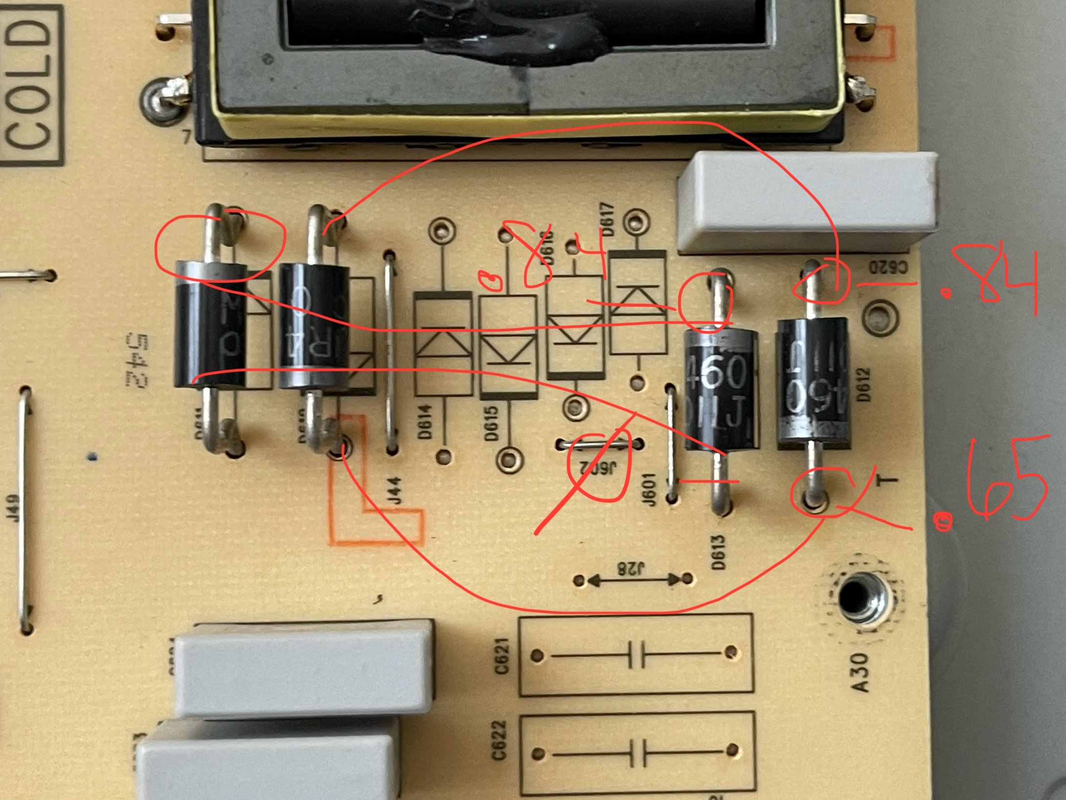

Hello everyone, I got a TCL 75S421 with no backlight. I swapped out the LEDs and still getting nothing. I checked a few readings, see pictures below. Can anyone point me in the next testing area or what to look at next?
TCL 75S421 New Backlight LED's Still No Backlight

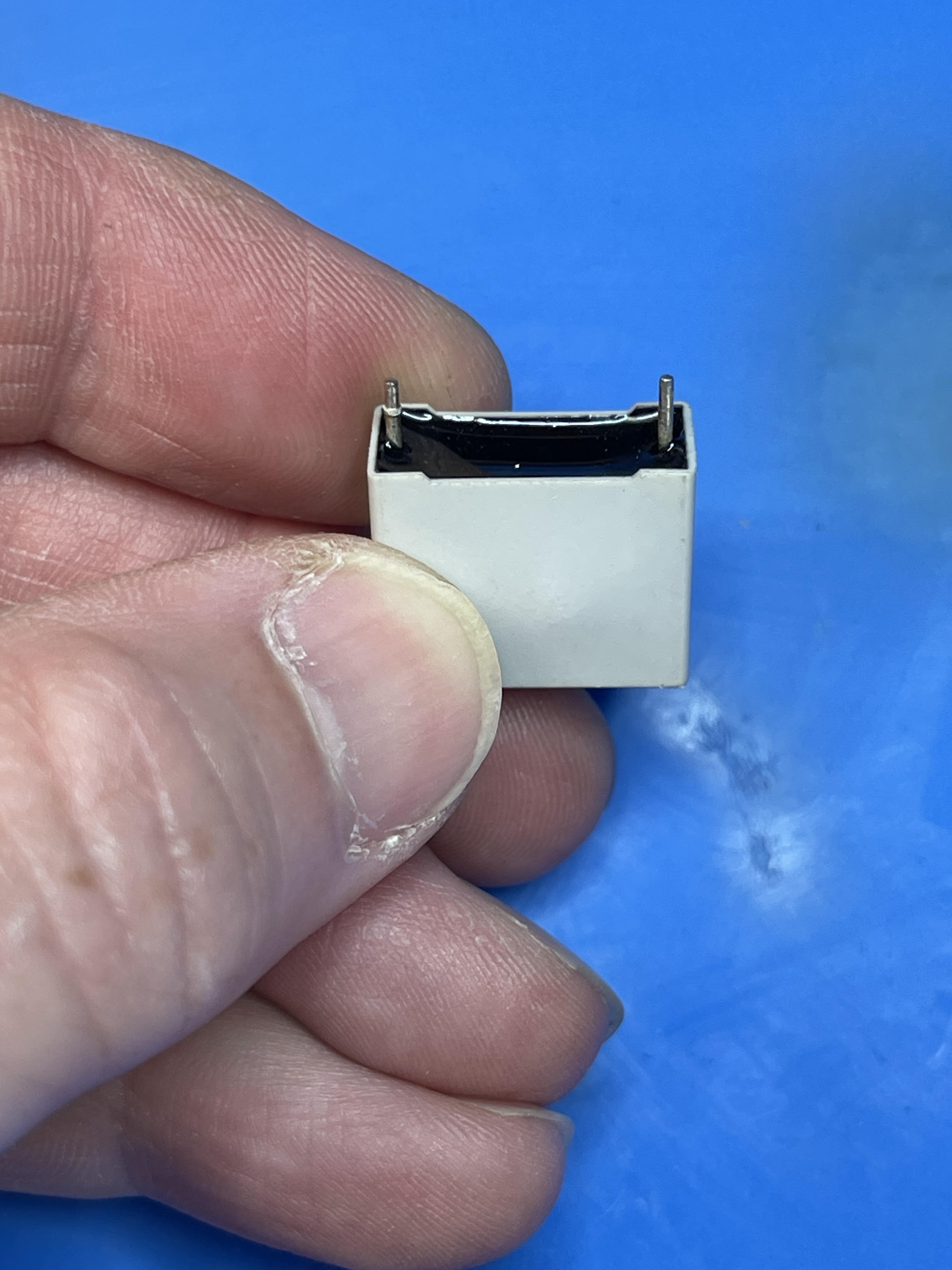

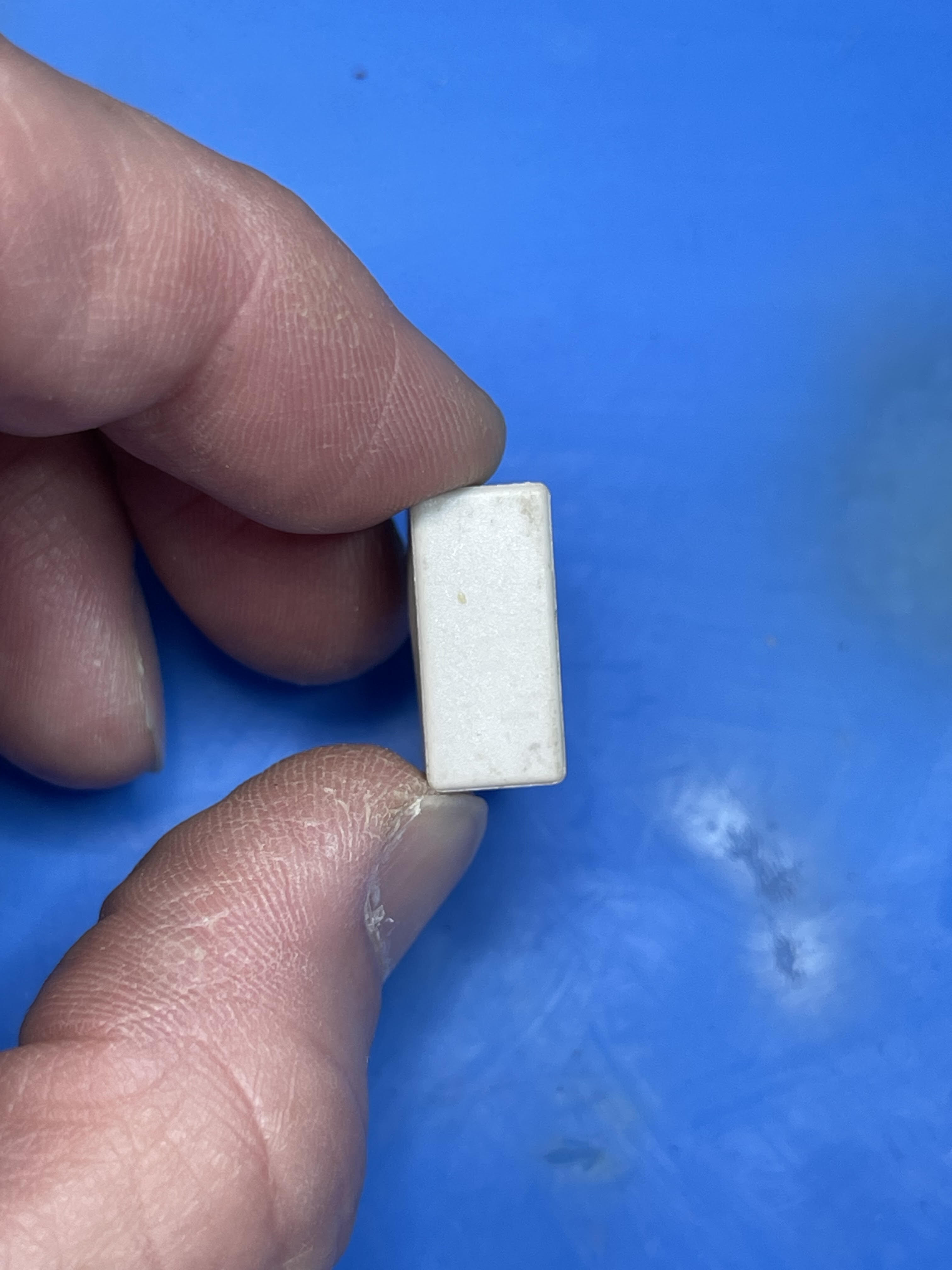

Hello, you will want to check a capacitor. I have replaced many of them in this power supply. When you remove it you will feel a slight bulge on one of the sides. It is c614a . Hope this helps. -
Thank you for that info. I checked all the capacitors similar to C614A and none have bulged or no continuity. Should I just replace it just in case?Comment
I recommend removing c614a and feel it between your fingers. It’s usually very slightly bulged on one of the sides. Normally you cannot see it until after you have felt it. If you have an exact match for that capacitor definitely just replace it and see if that resolved your issue. Also one thing about this board it is very easy to short out the transistors when testing them. If you have tested them and got any kind of zap from your meter leads, that it’s likely something has shorted.Comment
I took this off before and just overlooked this tiny spot! Wild but it still doesn't show as open. Now I need to find a replacement!I recommend removing c614a and feel it between your fingers. It's usually very slightly bulged on one of the sides. Normally you cannot see it until after you have felt it. If you have an exact match for that capacitor definitely just replace it and see if that resolved your issue. Also one thing about this board it is very easy to short out the transistors when testing them. If you have tested them and got any kind of zap from your meter leads, that it's likely something has shorted.Attached Filesif you find these attachements useful please consider making a small donation to the site
Is this a good candidate? Not sure what I should be looking for!I recommend removing c614a and feel it between your fingers. It’s usually very slightly bulged on one of the sides. Normally you cannot see it until after you have felt it. If you have an exact match for that capacitor definitely just replace it and see if that resolved your issue. Also one thing about this board it is very easy to short out the transistors when testing them. If you have tested them and got any kind of zap from your meter leads, that it’s likely something has shorted.Attached Filesif you find these attachements useful please consider making a small donation to the site
This one seems to match more closure to what I have read so far. I'll wait to get confirmation.I recommend removing c614a and feel it between your fingers. It’s usually very slightly bulged on one of the sides. Normally you cannot see it until after you have felt it. If you have an exact match for that capacitor definitely just replace it and see if that resolved your issue. Also one thing about this board it is very easy to short out the transistors when testing them. If you have tested them and got any kind of zap from your meter leads, that it’s likely something has shorted.Attached Filesif you find these attachements useful please consider making a small donation to the site
Did you test the new leds with led tester from the connection that plugs into PSU? I have, to eat crow, done this a few times where I forgot to connect maybe one of the connectors and had to tear it apart again in order to see what I did, and a connector was off or loose. But led tester will show short on the line if so.Comment
to be hones I cant remember if I did or not. I want to say i did lol. Can I test from the LED power line? I know I can't test from the back lol.Did you test the new leds with led tester from the connection that plugs into PSU? I have, to eat crow, done this a few times where I forgot to connect maybe one of the connectors and had to tear it apart again in order to see what I did, and a connector was off or loose. But led tester will show short on the line if so.Comment

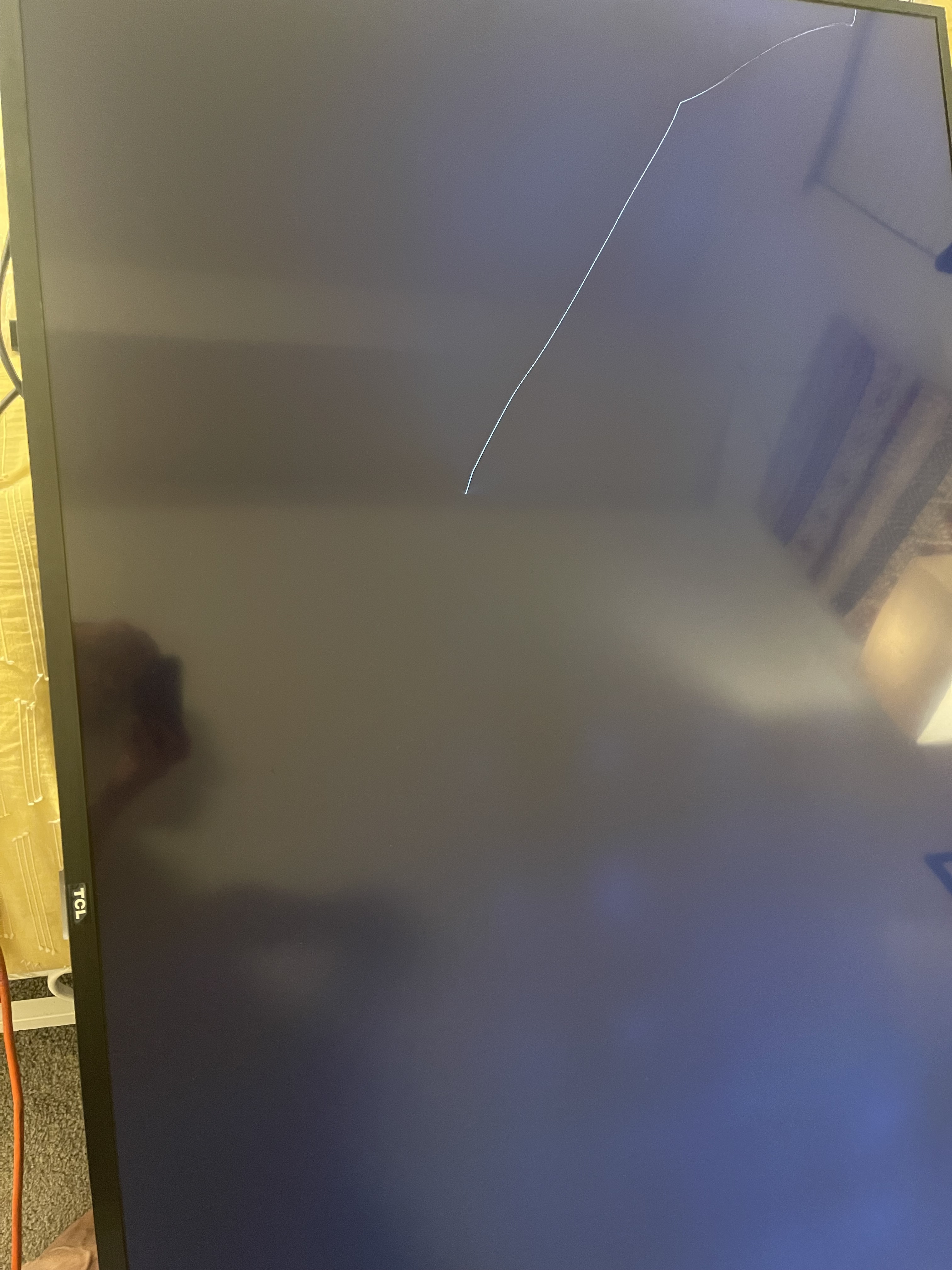

Well thats a $200 lesson for my first TCL backlight replacement. Though I wonder why the screen is still blank? I was just going to use it in the shop but its still not showing a picture.Attached Filesif you find these attachements useful please consider making a small donation to the site
You got new PSU and lights show up now? Cracked screen only sometimes shows picture, not always.
Poor tv, been there done that. I personally take the TV down to the bones again and practice my disassemble when this happens. Take the new lights back off. save for next tv.
