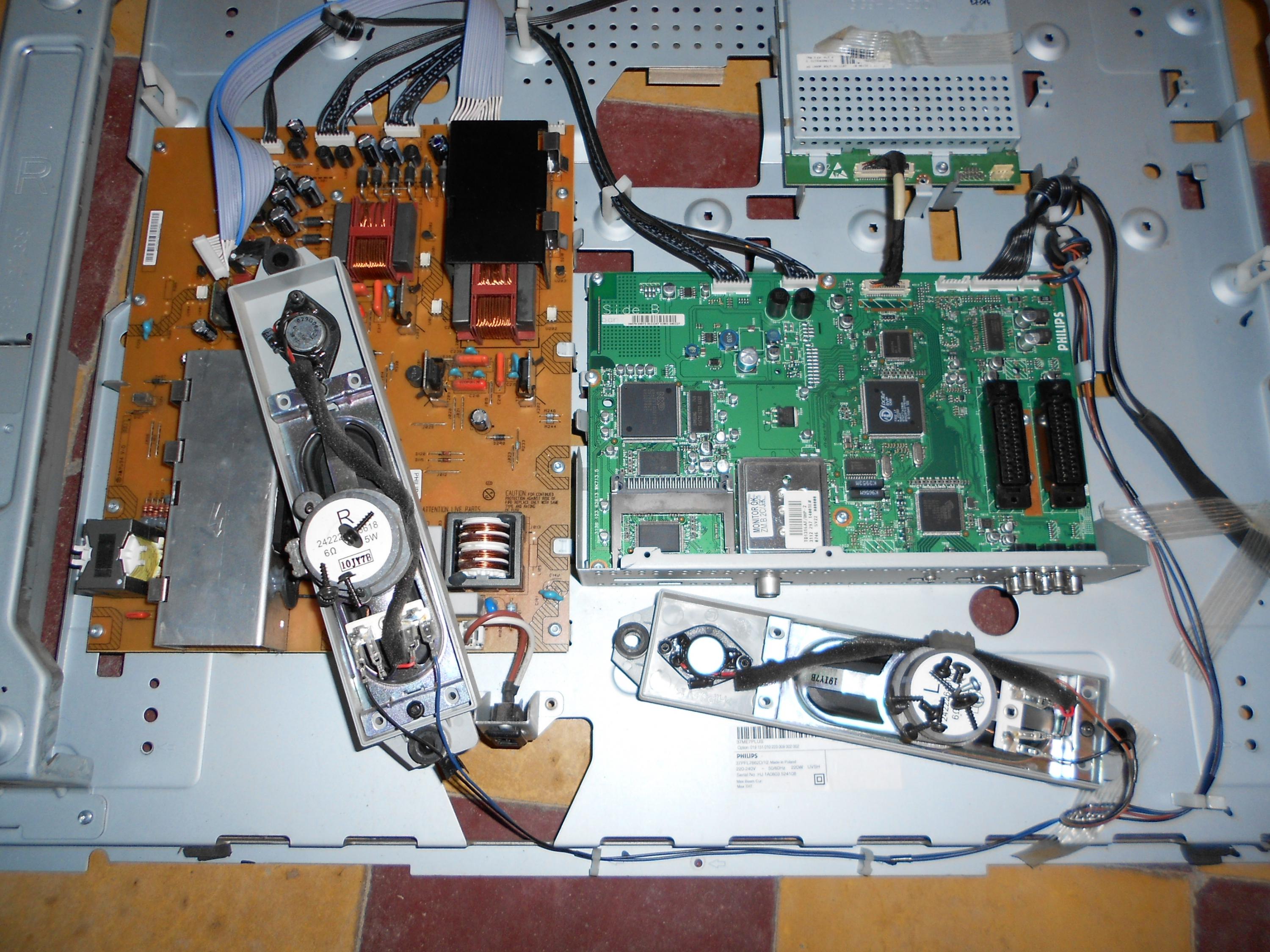

    My TV is showing a white screen, but the sound works. What should I do?

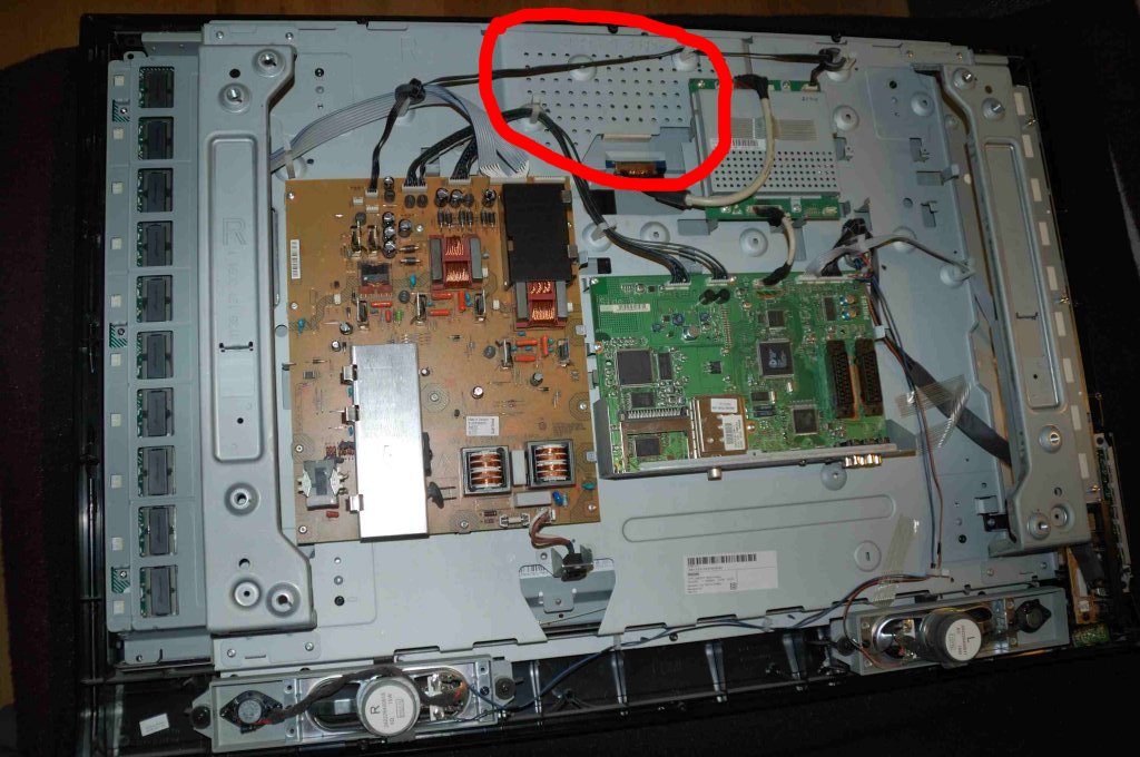

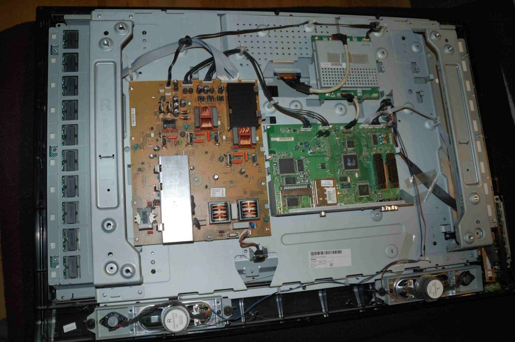

    Check t-con fuse. Post a picture of the inside of the TV with the back cover removed if you can't locate the t-con board.

      fast response thank you, enclose a check photo.je clothe F.

        See here. Under the metal shield, the blue board.

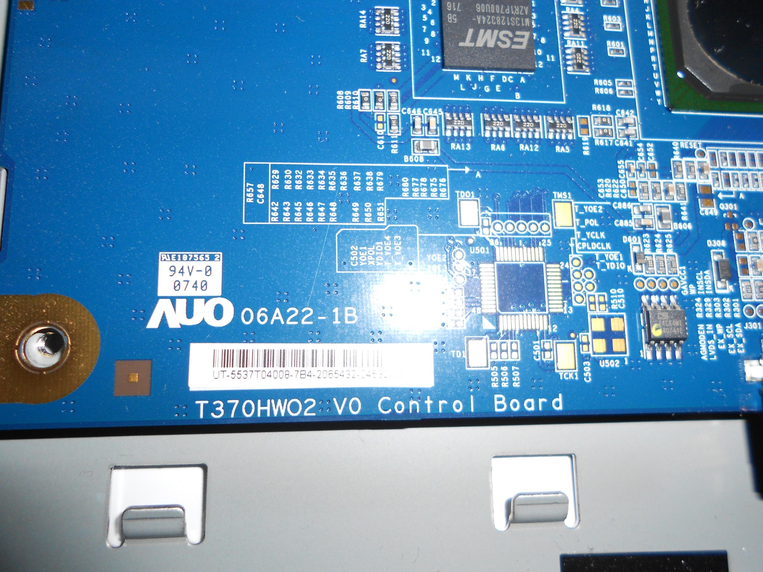

          tom66, good idea I removed the T-com thank you card.

                    wow i guess you really have it dismantled. you are not gonna check any voltages on the t-con that way. put the t-con back on but don't put the cover over the top of it. and hook the screen back up. all we wanted you to do was remove the cover over the t-con board not do a complete tear down.

                              hello, this is resolved after changing the module T-con gets a case.
