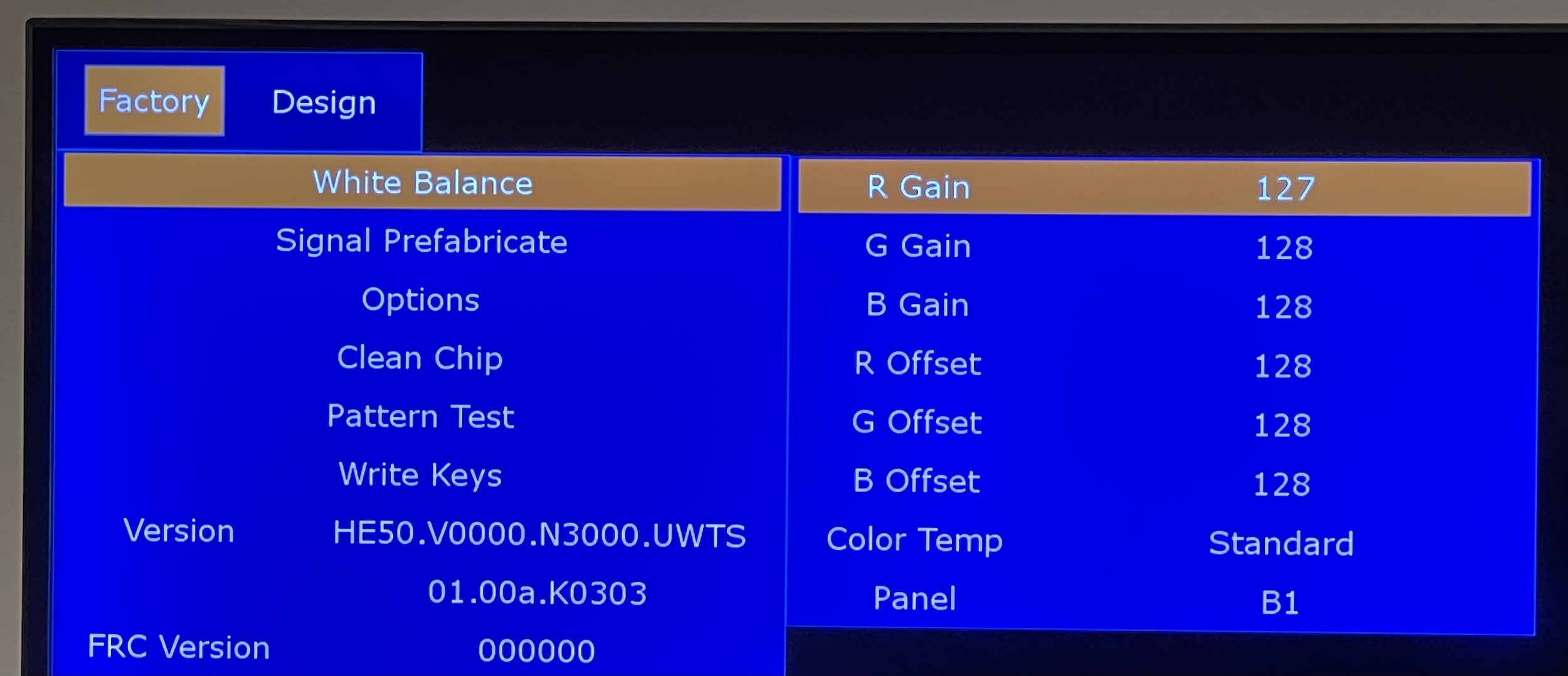

                              the 12V rail read less in STB mode are correct to read less then it goes high after switch TV ON
                              i am interesting to see yours service menu photo at white balance to see the values of Gain and Offset and Panel

                                Re: Hisense H50N5300UK reboots when showing full red images
                                Sure thing, please see photo attached.
                                  bring back R GAIN to 128
                                  after change and exist S menu... loh again S. menu and clear chip
                                    Can do. I reset the R GAIN back to 128 and then ran the ‘Clean Chip' command.
                                    Unfortunately the TV still reboots showing red in the Pattern Test.
                                      i dont think so... did you look at s,menu if r gain ready to 128 ?
                                      i wrote t to change value then exit s,menu,,,, then after turn on log again see if change in place then clear chip
