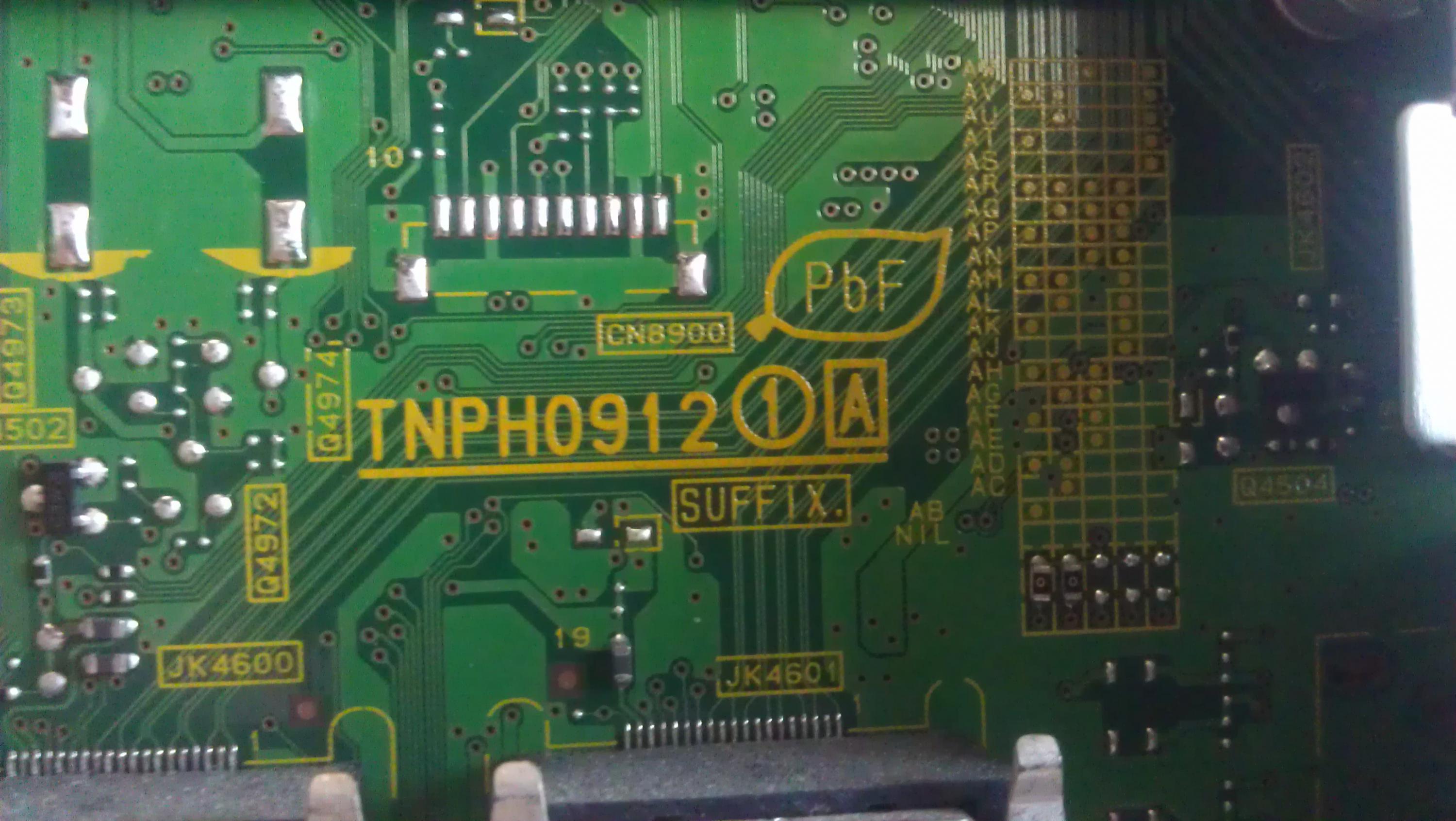

            soo whats the difference between all these boards ? mine is TNPH0912 with AB as the suffix? can i replace it with the same board but with AF as the suffix ?

              Re: Panasonic TC-P55ST30 one led blink
              okay i figured out i have AD, but does this mean i can switch it with any board as long as i change the resistors to match AD? does anyone know what these resistors are actually doing from model to model ?
                No. Don't think those jumpers do anything. The one you mention is 65", eeprom/flash data will be different for the size

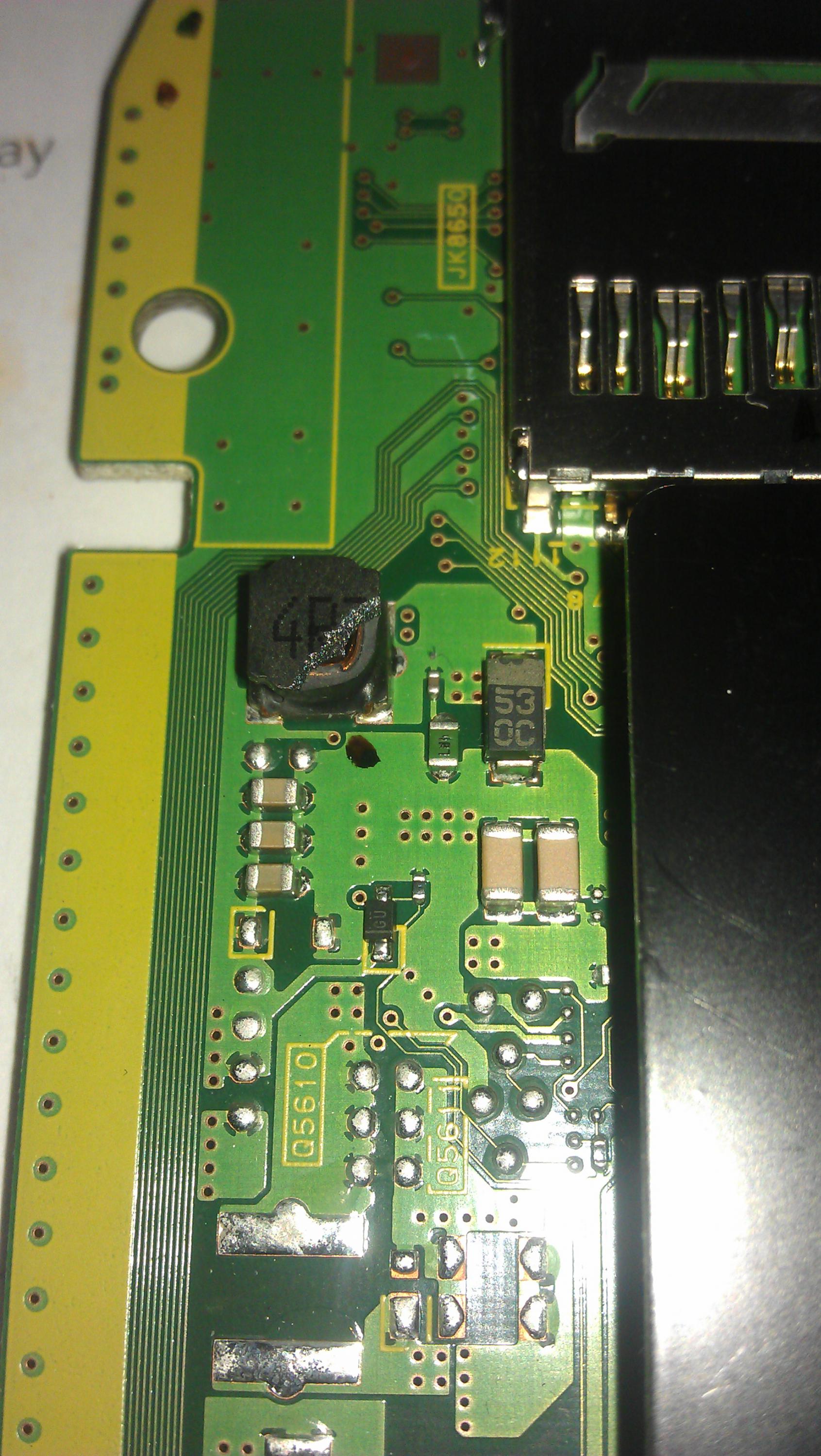

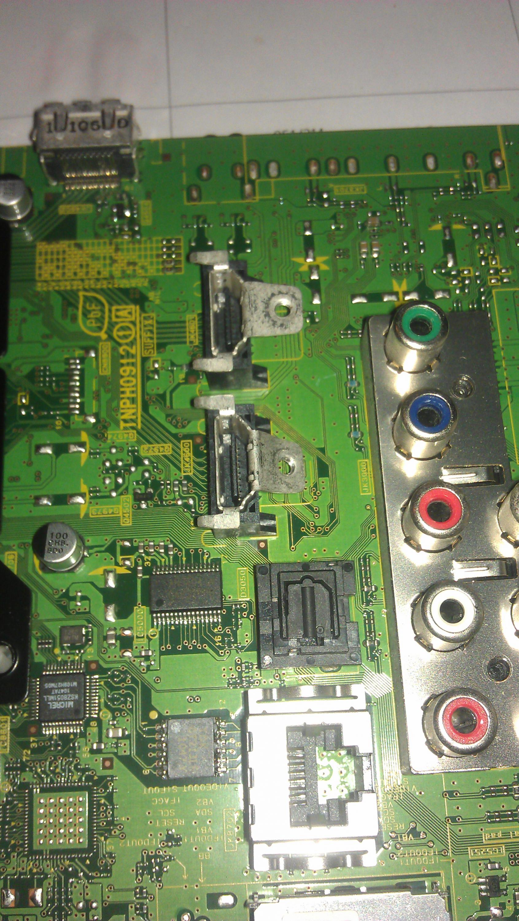

                  and a final thought the A board i got is damaged (see pics) you think it will be okay or should i have the seller replace/return it (and im pretty sure i need an A board i put the old one back in and tried the jumper trick from earlier and still only 1 blink )
                      Try slide 71 on since you've already got a clear startup with the SC50 jump.
                      You're certainly going to have to grab the HDMI body well if you attempt to straighten that tab. Could always try a partial refund? A boards can be hard to find so you probably don't have a lot of leverage.
                        sweet thanks, i dont have this service manual
                        im more worried about the other photo with the chip knocked off the part
                          Oh, ok did not check that one. Doubt that will be a major issue. It's just an inductor, probably not too hard to track one down. I'd have a go at getting a price reduction though. If using Paypal, you have evidence of it not as described.
