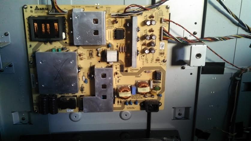

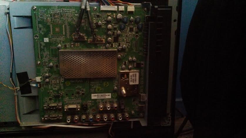

          Here's a couple pics. One is of the power supply and the other is the main board. I am still a rookie and I don't know where the main dc filter cap is, but I'm still looking around for info. online. I hope the pics can help you help me.
          If you had to guess right now would you say the main board holds the problem?
          Thanks again.

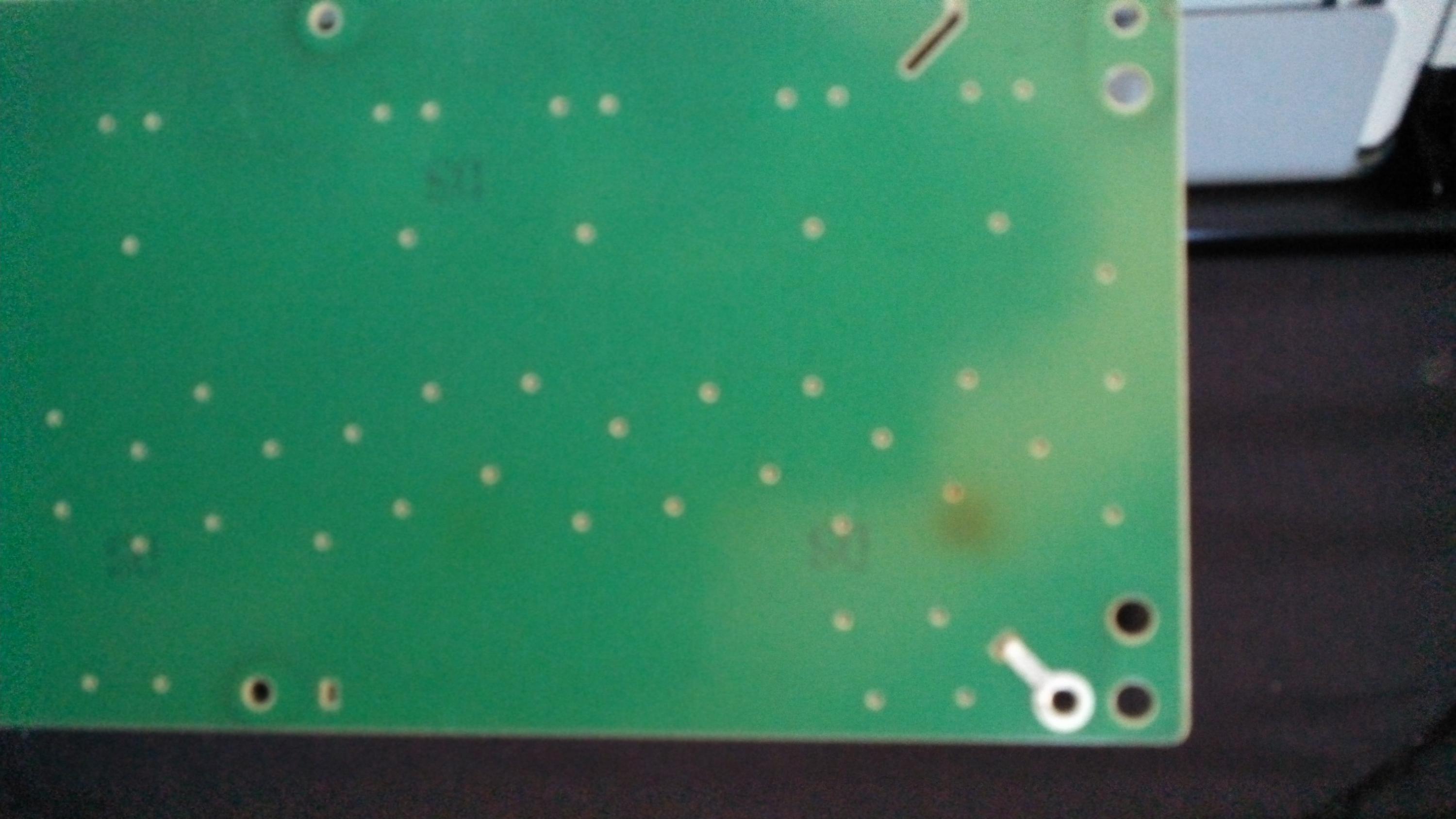

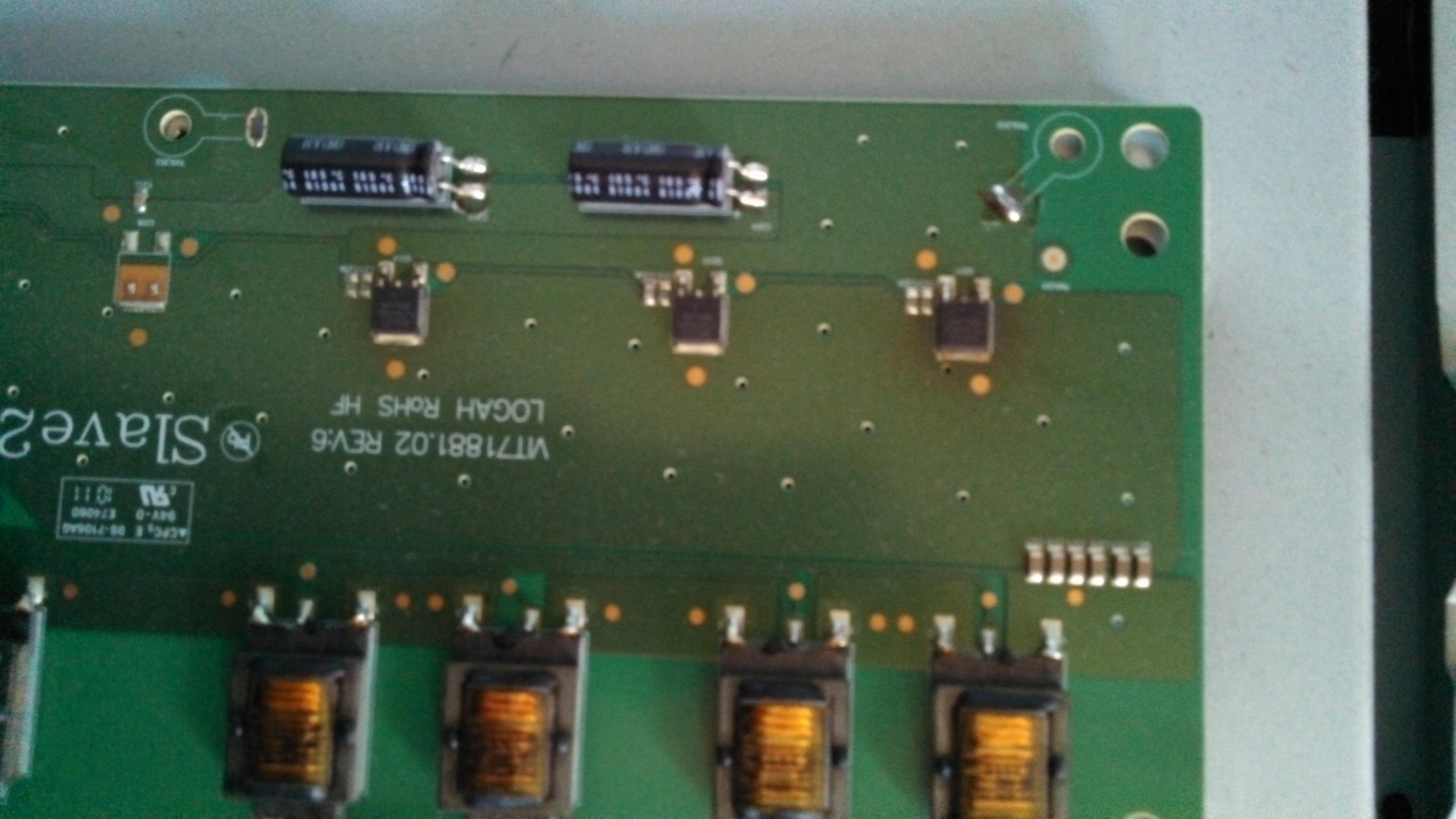

                  After that I really started tearing into it, to do a really good visual inspection and test any fuses i could find. I found an IC on the Slave 2 inverter with with brown around it and even on the back of the board (see pics). I don't know if it's okay to remount everything without the shields in order to test the IC ?
                  Even if I were to replace the whole Slave 2 board I don't believe it would fix my problem. I have done the flashlight test and I can't see anything. I have also tried other modes of input.

                    burnt slave board IC

                      Just wanted to say thanks for all the help. I unplugged the slave boards from the power supply and the backlights came on and have picture now. Have the correct power to everything. One half of my tv is dim cause slave 1 & 2 disconnected, but other than that all is good . Thanks again.
