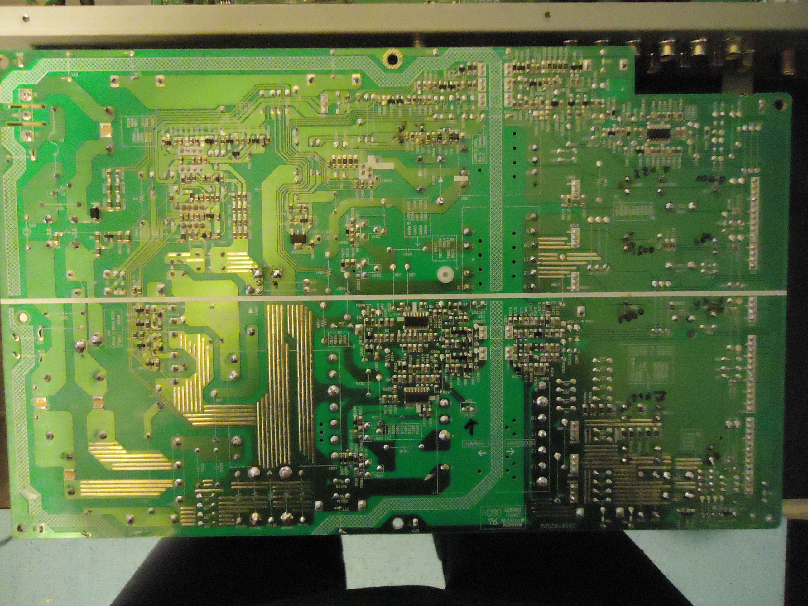

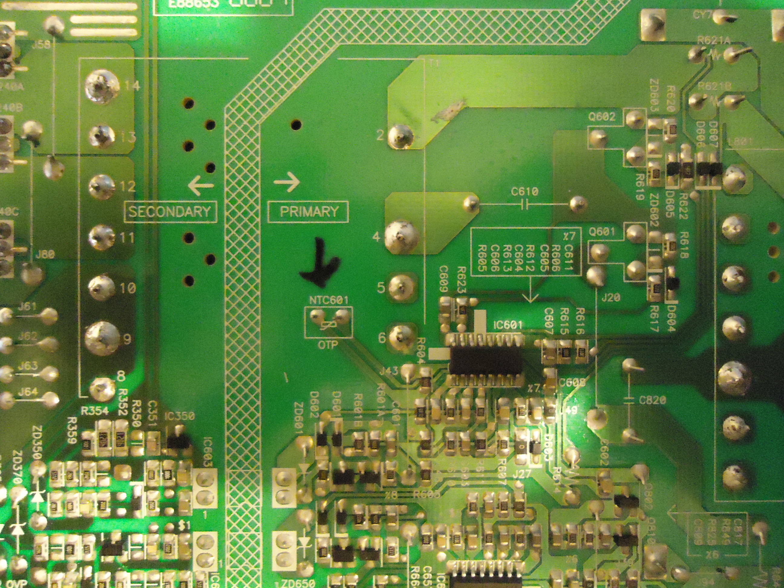

    Hi all I have been rebuilding the boards on this tv for a while now.
    Now I an stumped There is a symbol on the back side of my power supply
    marked with a black arrow . I have no clue as to what it is. It is under a transformer. Any one know what it is?
    Re: Vizio 47 vo47l

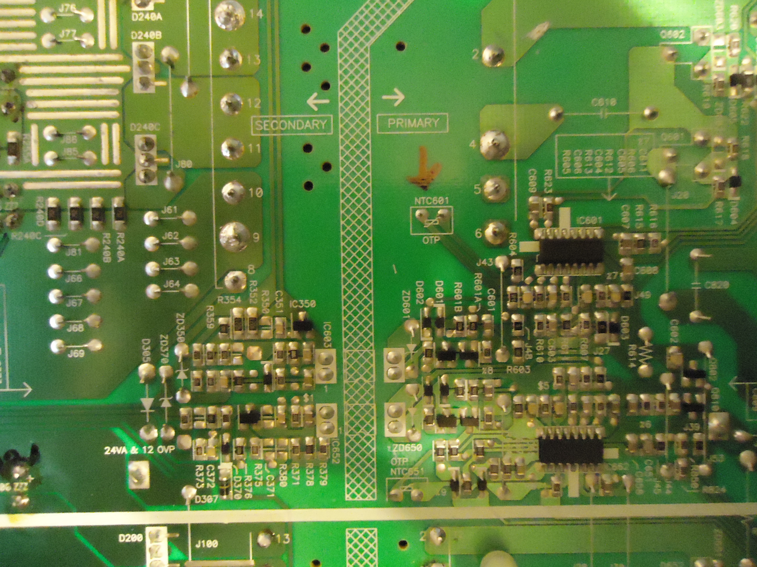

    That is the Thermistor (can be Positve or Negative type) for temperature sensing, OTP= Over Temperature Protection. It looks like Negative type (NTC).
    What is the power supply not doing?

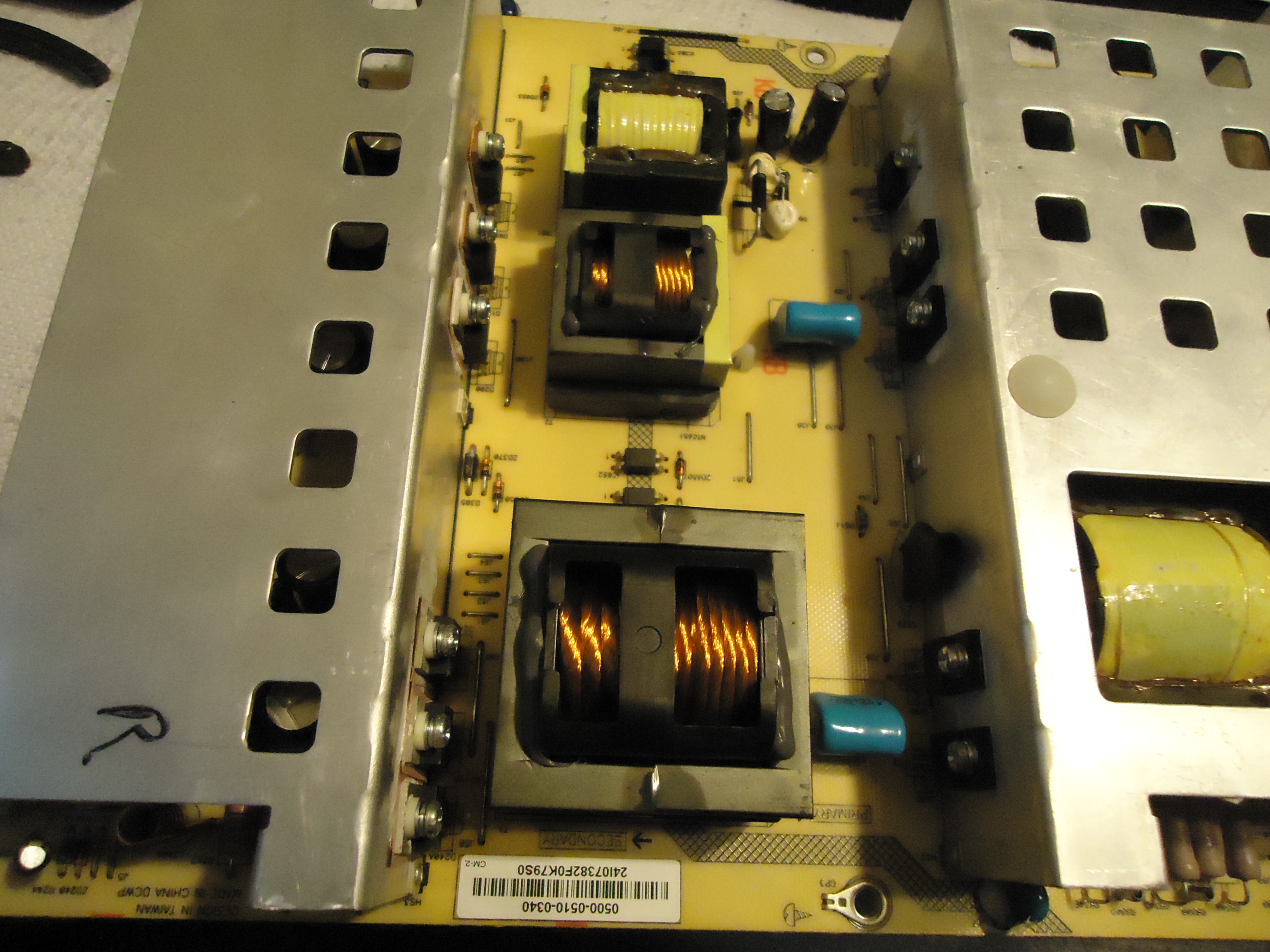

        Re: Vizio 47 vo47l
        The transformer that it is under will not power up.

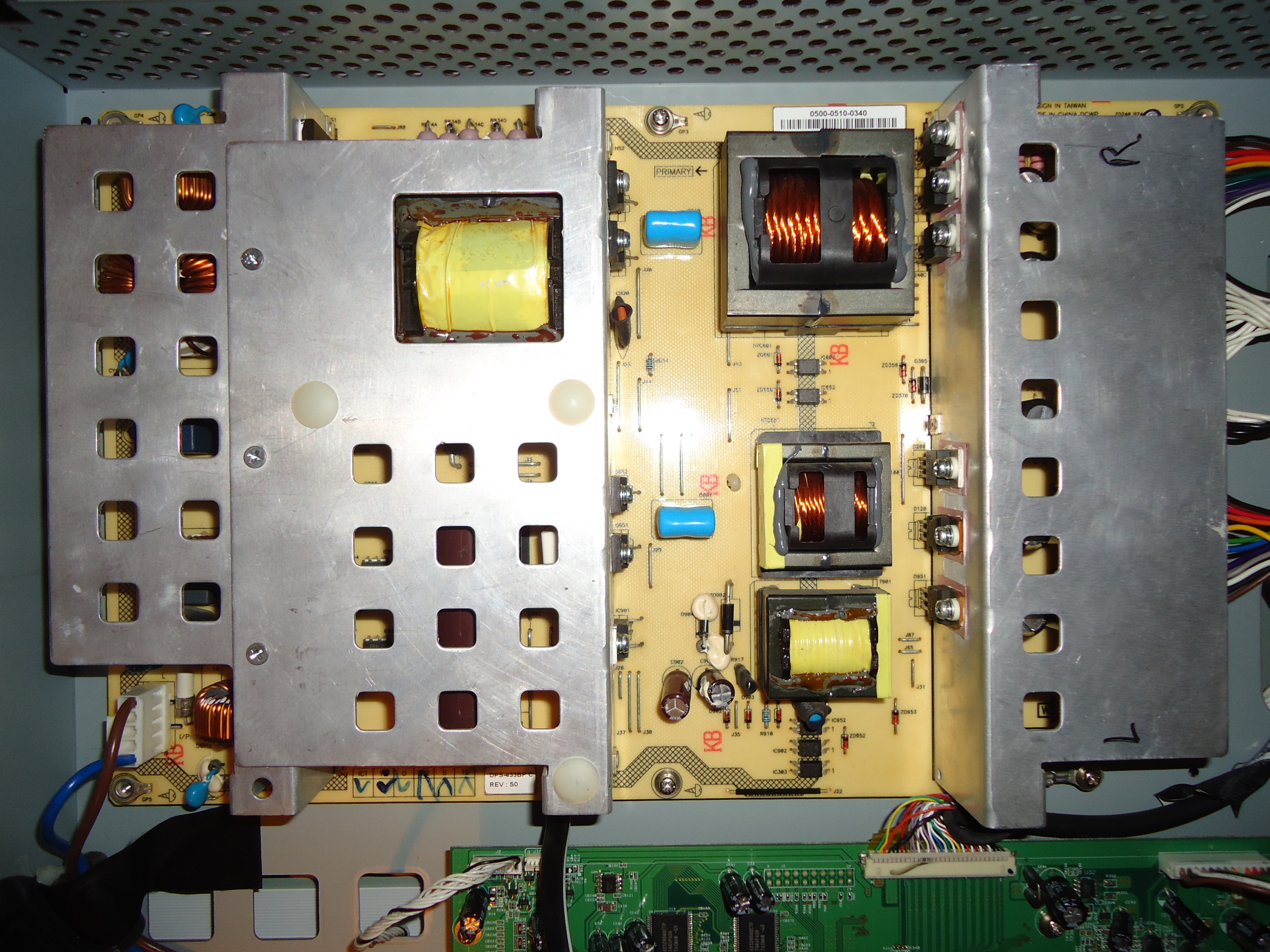

          Re: Vizio 47 vo47l
          Its the big transformer at bottom of picture.

            I just checked the thermistor By warming it up with my solder iron and the resistance goes up . It is a negative type heat will increase resistance. A PTC is positive and the resistance goes down when heat is applied. Thank You BUDM for telling me what it was.
              Re: Vizio 47 vo47l
              Negative type, resistance goes down as the the temperature goes up, opposite reaction for PTC.
              Do you get about 380~400VDC at the two legs of the main 450VDC filter cap when PS_ON is applied to the power supply board? Board numbers?

                Re: Vizio 47 vo47l
                I will have to solder a couple wires under the board to find out.The cap is in a heat sink cage.
                  Re: Vizio 47 vo47l
                  For the 12v/24v switched power supply to work, it will need PS_ON, PFC Voltage booster circuit to work to supply 380~400VDC for the power MOSFETs that drive the 12V/24V transformer to run on.

                    Its getting late here I will report back tomorrow. The set I am working on has all volts good but no 24 volt from the big transformer. I changed all the radial caps but not the big one. And I changed all the regulators on the inverters, and main board.All fuses good pson is good and back light control voltage is good,and the panel is good too.Need sleep now I don't need to fry myself working on this piece of crap. Thanks BUDM good night

                      OK I had to check I am getting 398 volts.
                        Re: Vizio 47 vo47l

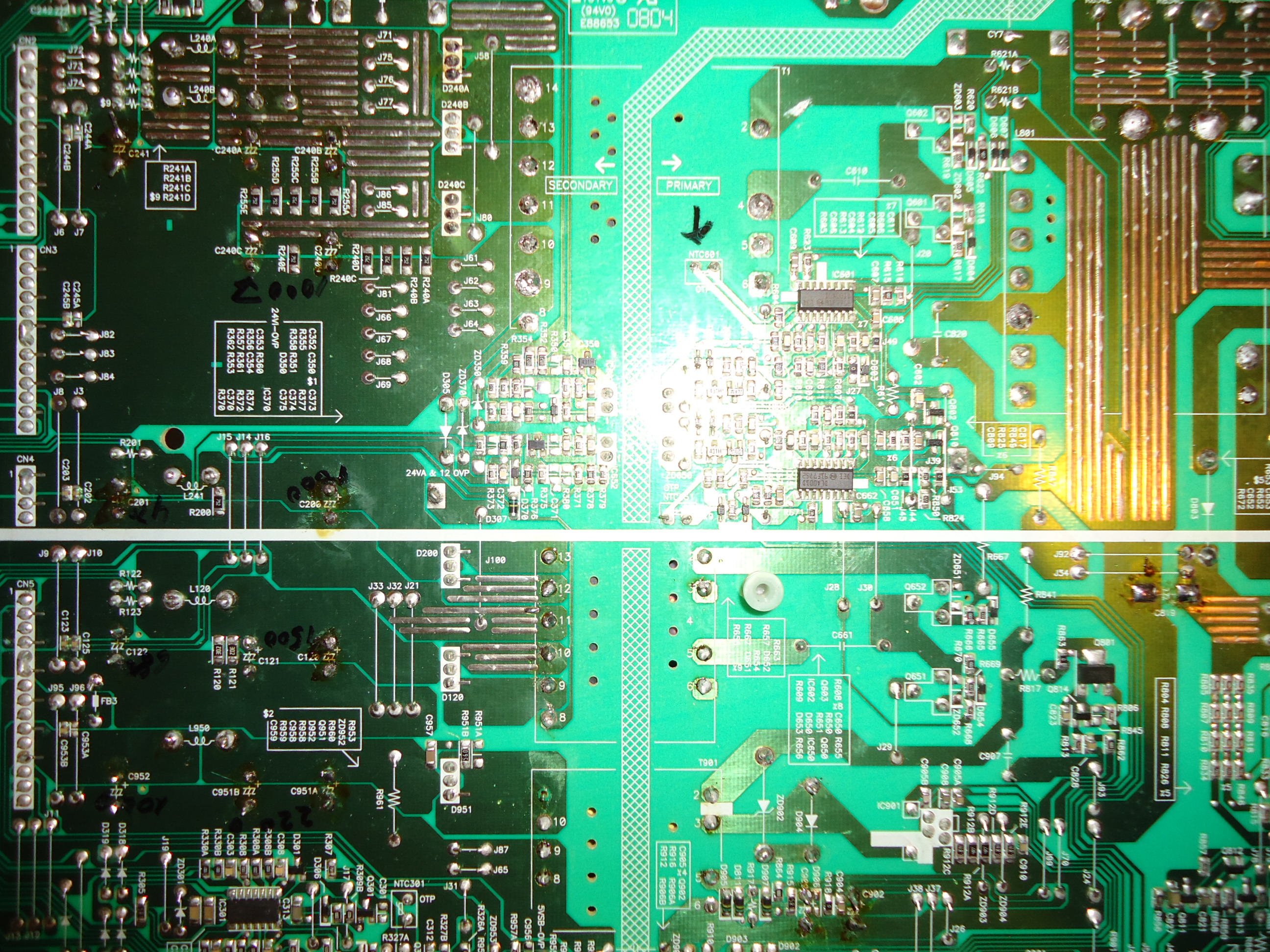

                        OK, that is good, so we need to concentrate on the 12V/24V drive circuit next. We will have to trace out the connections on the board. Do you have P/N of this board, we will need good clear pictures of both sides of the board, they must be good enough to clearly see the traces.

                          I have p/n and I will take some good pictures right now.
                          board number is 0500-0510-0340 be back in a couple minutes picture time.

                            Re: Vizio 47 vo47l
                            Got the pictures you asked for

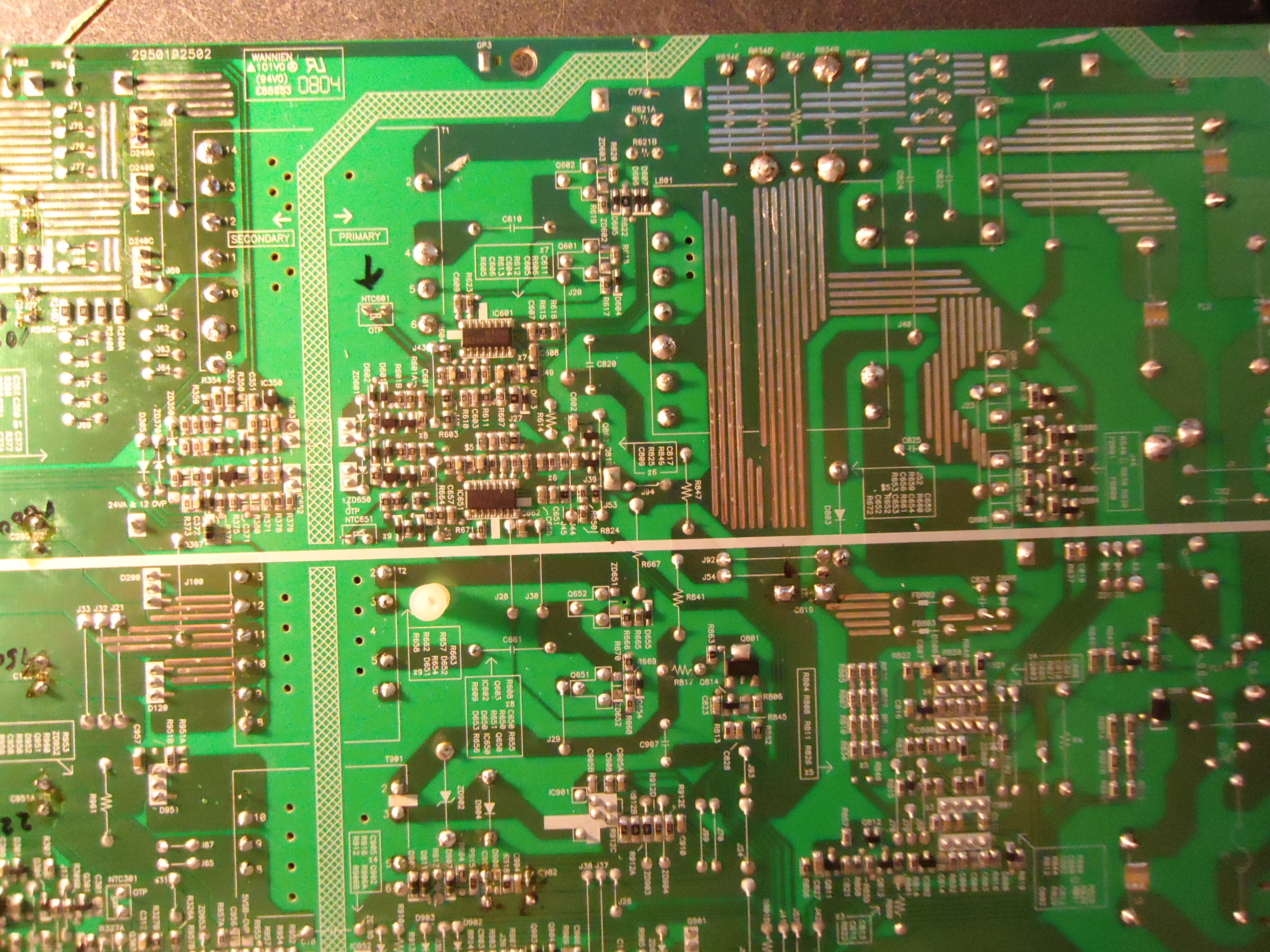

                              Re: Vizio 47 vo47l
                              Wrong picture

                                Re: Vizio 47 vo47l
                                try this one

                                  Re: Vizio 47 vo47l
                                  The correct PS name is DPS-433BP , but unfortunatley I was unable to find a schematic for it!

                                    Re: Vizio 47 vo47l
                                    I don't see a fuse but here is a picture.
