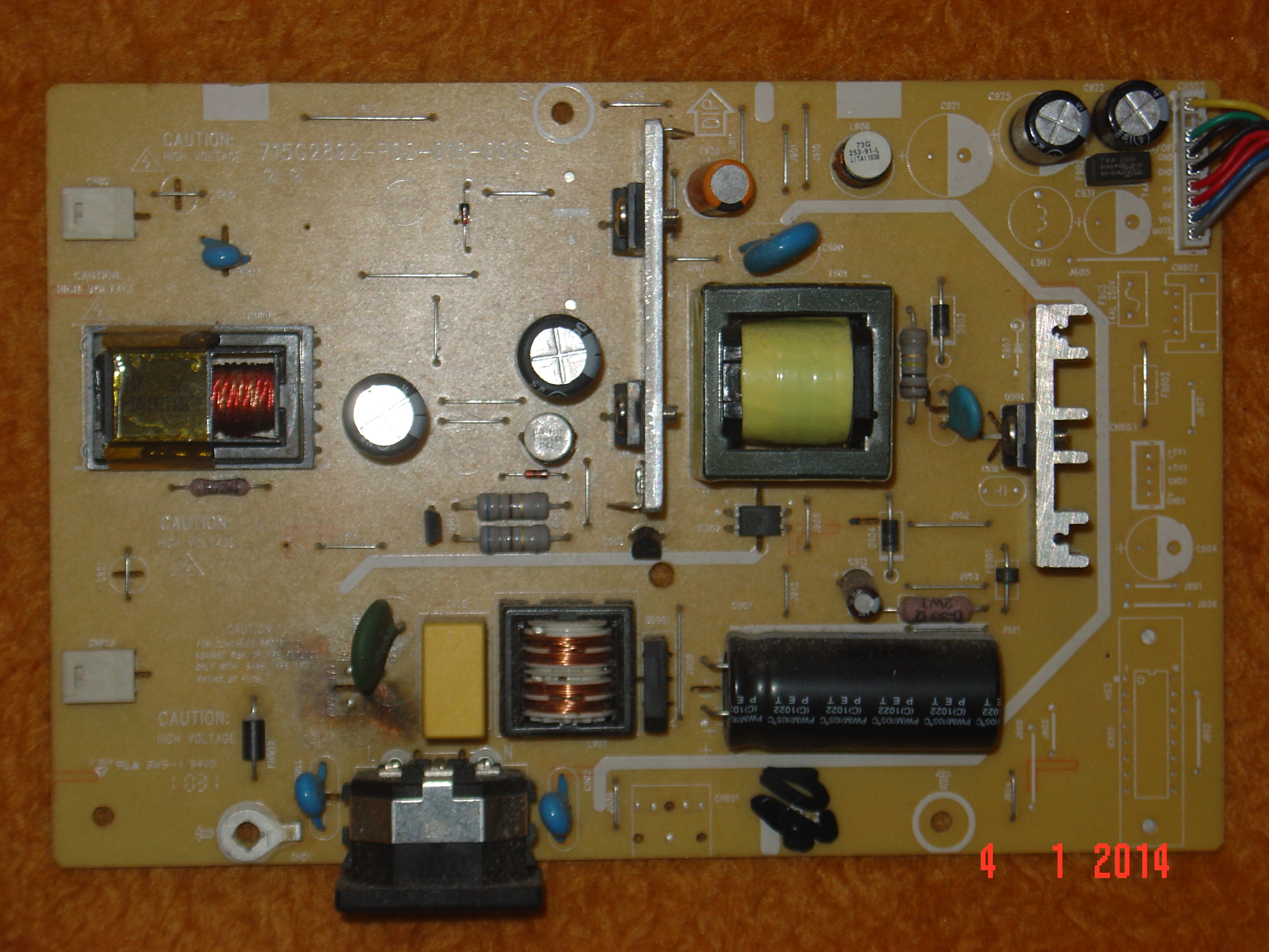

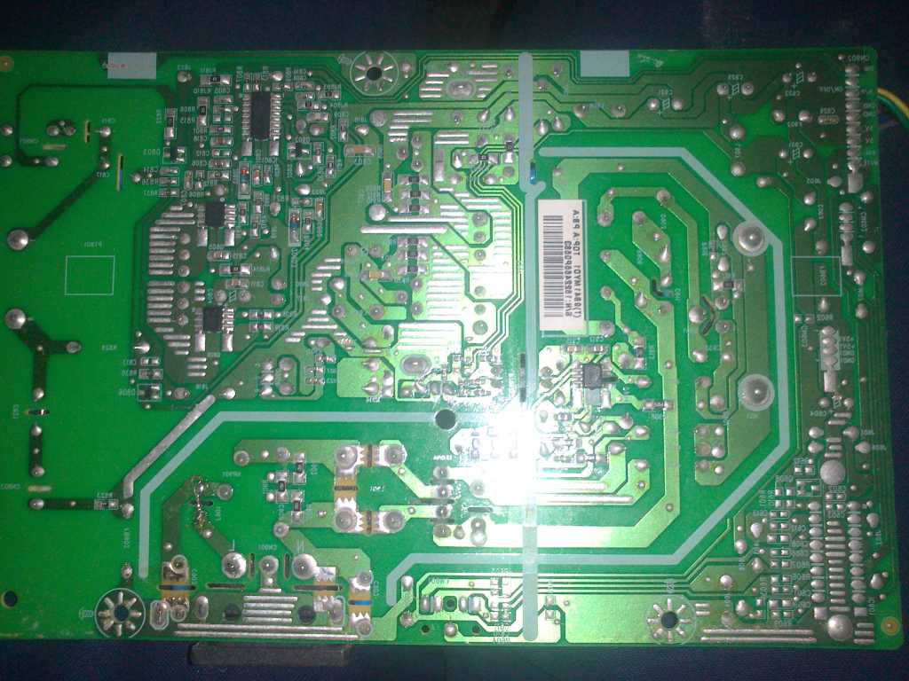

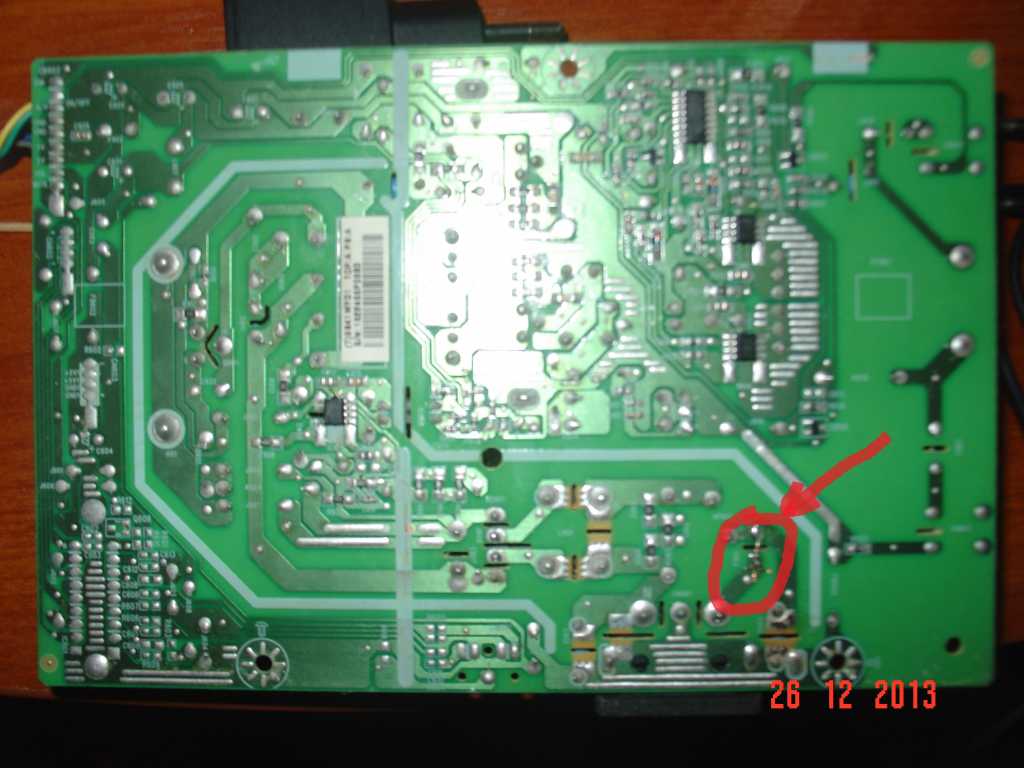

    Have this one bugging me for a long time and finally got time to deal with it.
    It was thunderstruck and the main fuse was blown, couldnt find it any shops
    here so I shorted it with thin copper string. (marked on the picture)
    Now, it turns on but keeps showing no signal input cable detected.
    It has to be something with the logic board? Didnt check the VC regulators...
    I could try to get better pictures if needed.
    Thanks in advance

    Re: Aoc n2041s THUNDERSTRUCK
    Nice pics of the table but the main board ones are useless.
    What are the output voltages like on the power supply

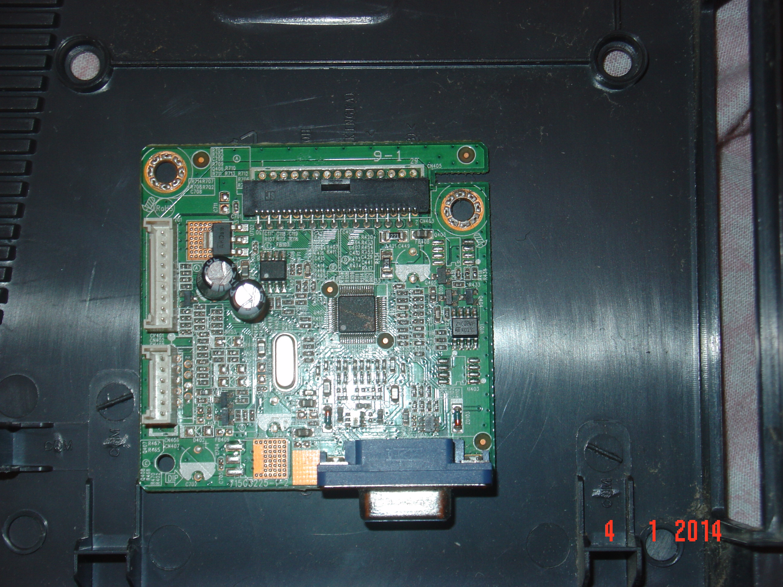

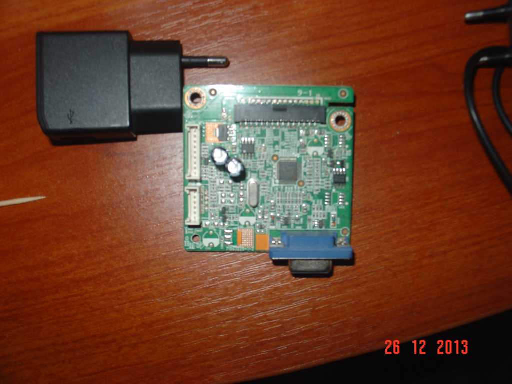

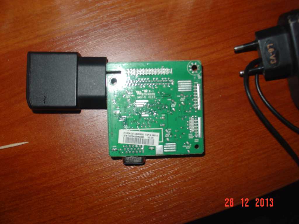

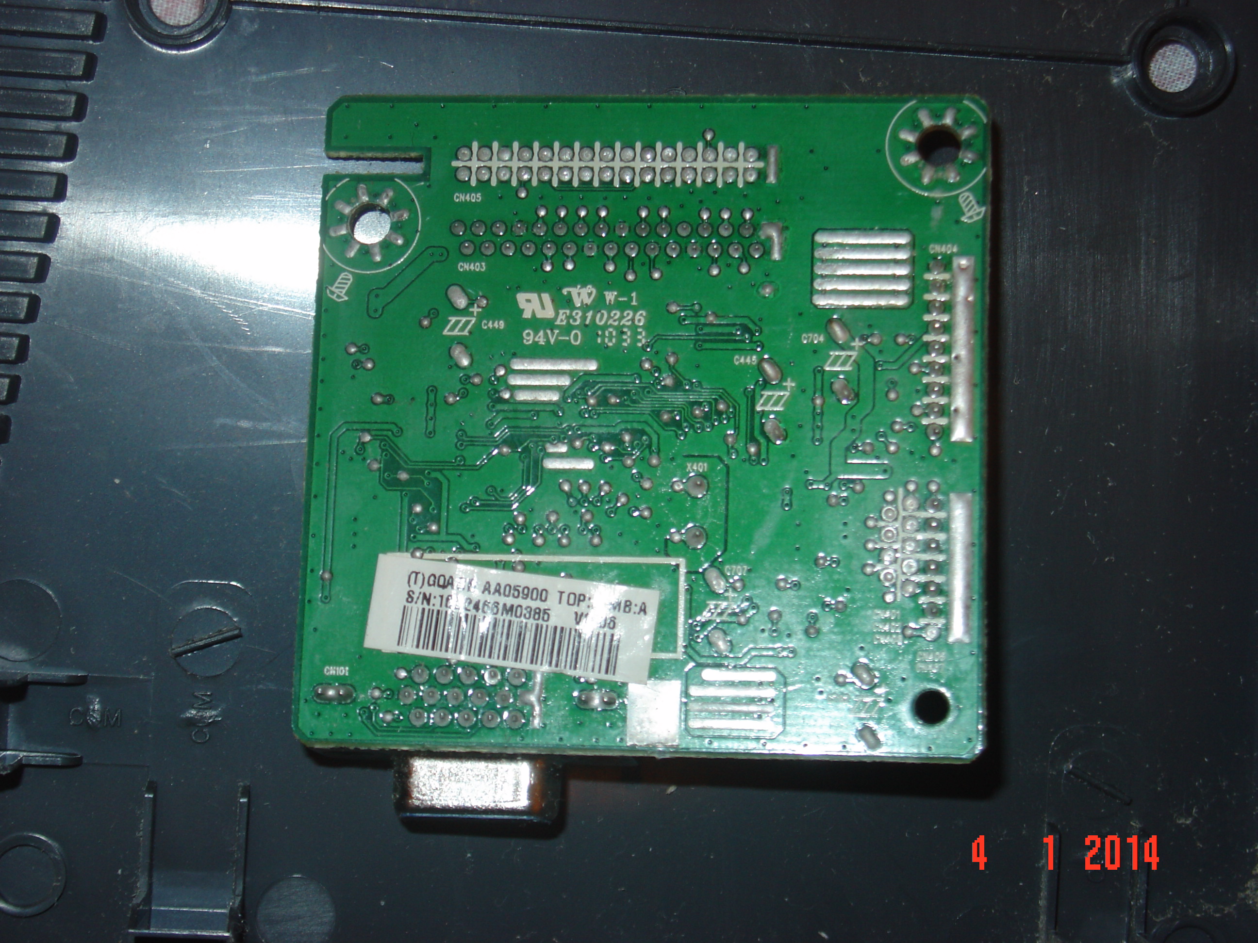

        Hope this is any better, sorry for the images

          Well 5v is good start - can I assume you had a working pc plugged in when it said no image.

              If the monitor keeps the message for more than a few seconds it suggests , as you say, main board problem, test the VRs and any big diodes - a better picture of it might help

                  Think this is a schematic - only snag is, its in chinese?
                  Anyway I think it says there is another fuse on the power supply.
                  In your picture bottom left corner near the connector there is a black rectangular box - is that a fuse? if so can you test it.

                    I just tested the whole thing again, PC pluged into logic board (showing picture on other monitors)... VRs checked fine.
                    It shows "no input signal" after a big AOC logo and then shuts down, turning green LED indicator into a yellow.
                      yup.... that is a fuse, and it´s not blown

                            Really need a good clear pic of the main board - not that we have much success
                            with repair if the VRs are good- could be any one of those little switching transistors

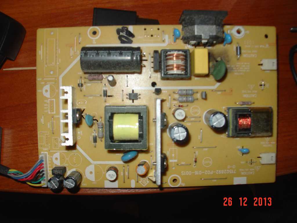

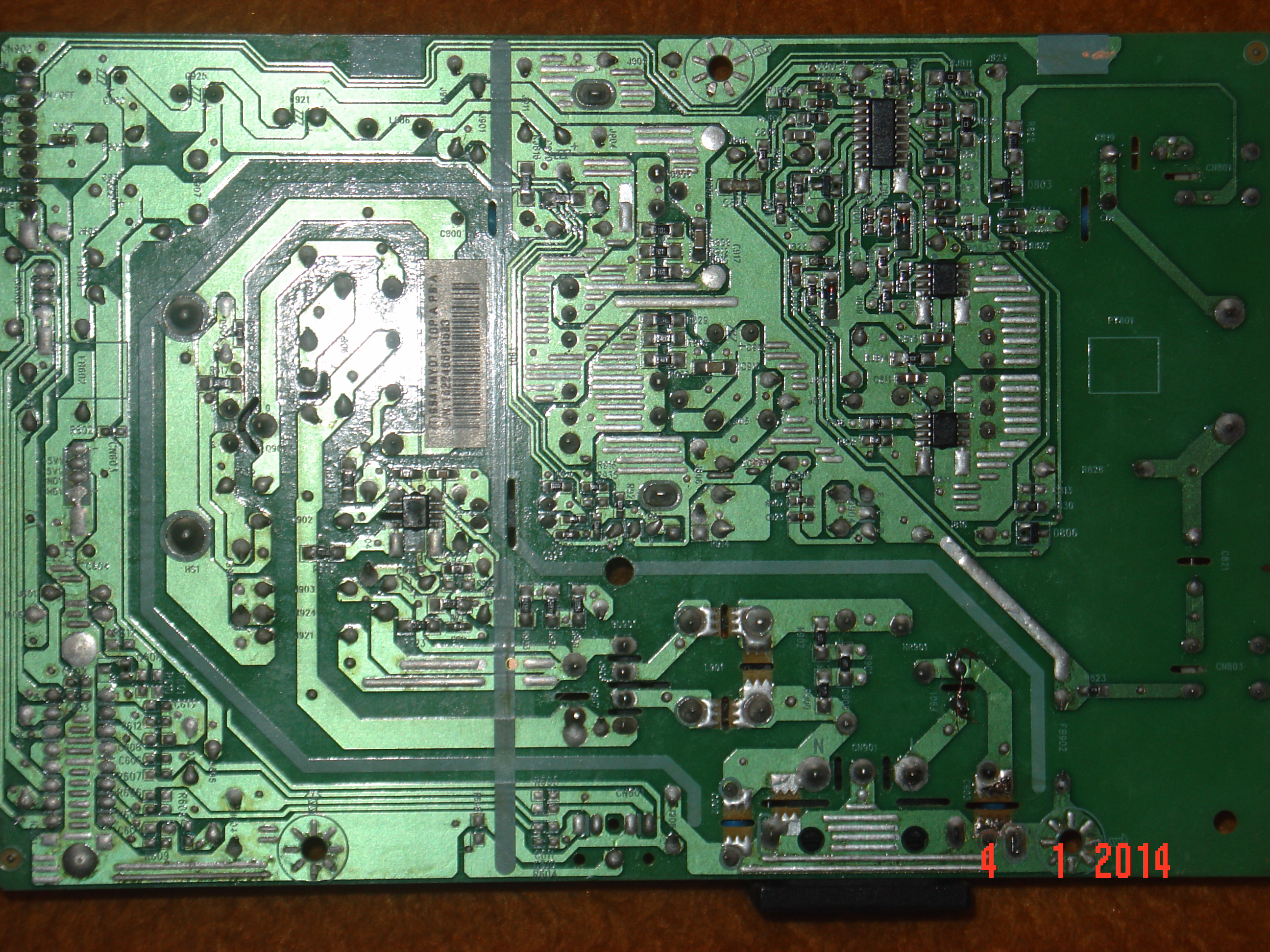

                              The best I could get with my old SONY DSC V1
                                That is power board, main board has video input on it.
                                  Ok - That is the power supply it was main board (logic) pictures I asked for.
                                    Sorry I can´t do any better. If I take photos closer than it becomes blury
                                    even if I turn macro ON.
                                    And back to square one, put the parts back together and now the monitor
                                    won´t turn on at all it´s like the power is cut off completly.
