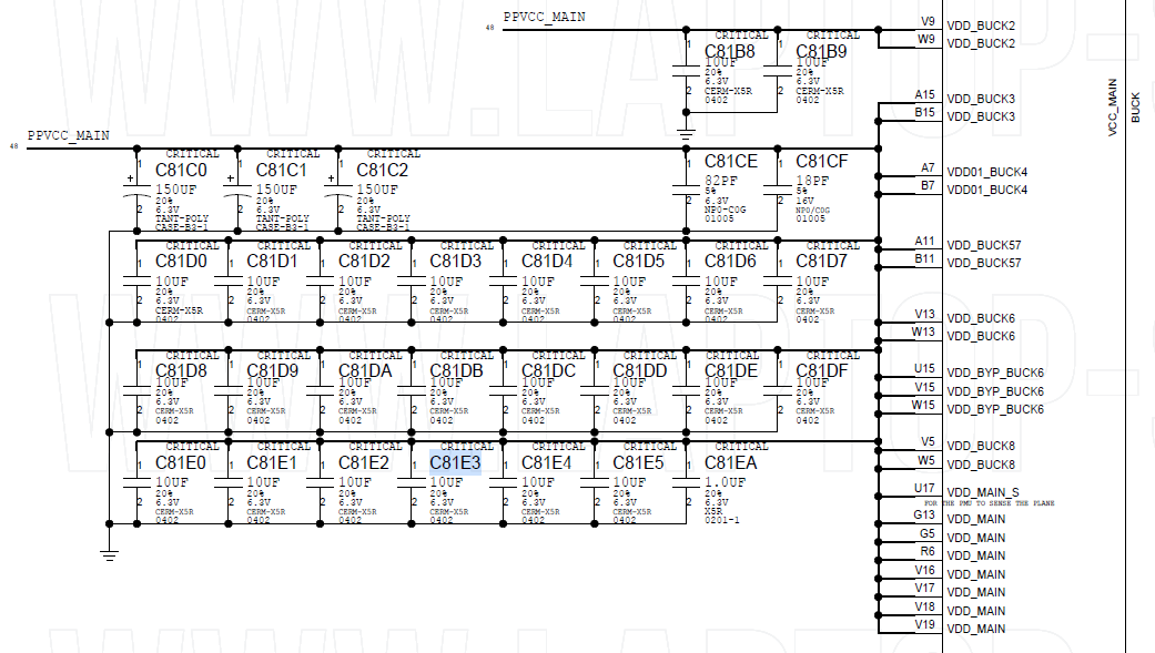

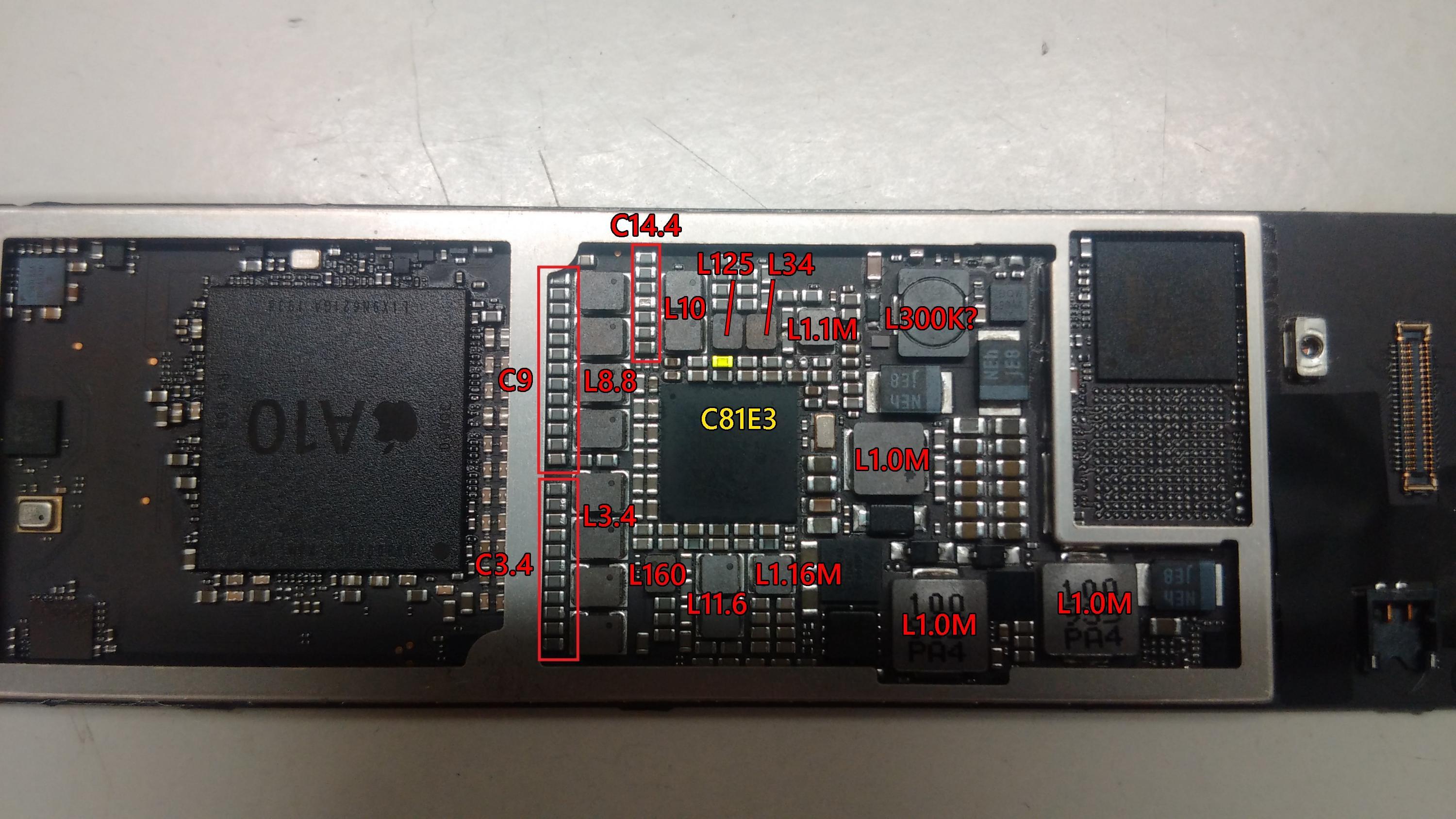

                  I finally was able to take some time to look at this board again. A week ago, I used the "flux smoke" test for finding overheating components, as I don't have a thermal camera. I could not find anything though. Cleaned up afterwards with IPA.
                  Today I checked all inductors marked L. I also checked if their solderjoints may have come loose, which wasn't the case. I've found a similar post, in which measuring the caps was recommended (this topic). I borrowed martyjelen 's image, hope you don't mind, where I added values of both caps and inductors. See attached image. L prefix is inductor, C prefix is caps, the subsequent values are resistance in Ohm to ground (with indicated with M and K). Some inductors were not really reliable when measured, by that I mean that the resistance kept creeping up or down and wouldn't stabilise. Could be my meter though.
                  I was going along the board for the caps and inductors, but at some point I noticed that one cap was askew. I touched it gently and it came loose from its pads. Now, AFAIK, they can handle a bit of force. I was able to dislodge it with a gentle push with a needle, so I assume it wasn't attached properly / came loose / COULD be the culprit of the short-like behaviour?? I lost the tiny prick, so can't measure it...
                  It is cap C81E3. See attached board schematic snapshot. I assume its in parallel with 6 other similar caps, if I'm reading the schematic right (I'm not good at reading schematics yet).
                  Would it be safe to use the device without this one?
                  Thank you in advance.
                  Kind regards.

                    This capacitor @ C81E3 is a bulk capacitor and it will not be missed if you remove it off the PCB. The other caps are ample to filter this voltage rail. There is a concern if the slanted angle of this capacitor has shorted or was shorting to the left side leg of the inductor that is just above this capacitor.
                    If U8100 is heating up, then remove all power -> meter in resistance mode -> measure the resistance to ground of each power rail that is created by this component.
                    The reference to the ~480 mA peak current and a shorted cap was by Alex in one of his YT videos. He found a shorted cap onboard.

                      Thank you for the information. Unfortunately, after removing the croocked cap, there is no change in boot behaviour. No Apple logo etc. But all ICs do heat up, like before. The A10 chip get very warm within seconds, the U8100 gets warm.
                      How can I indentify what the power rails to the U8100 are? I do not have access to boardview schematics (can't find any), only block diagrams. If I can manage using those, what and how would I have to look for? Again, this is my first repair attempt at this level, so I'll need some introductory guidance.
