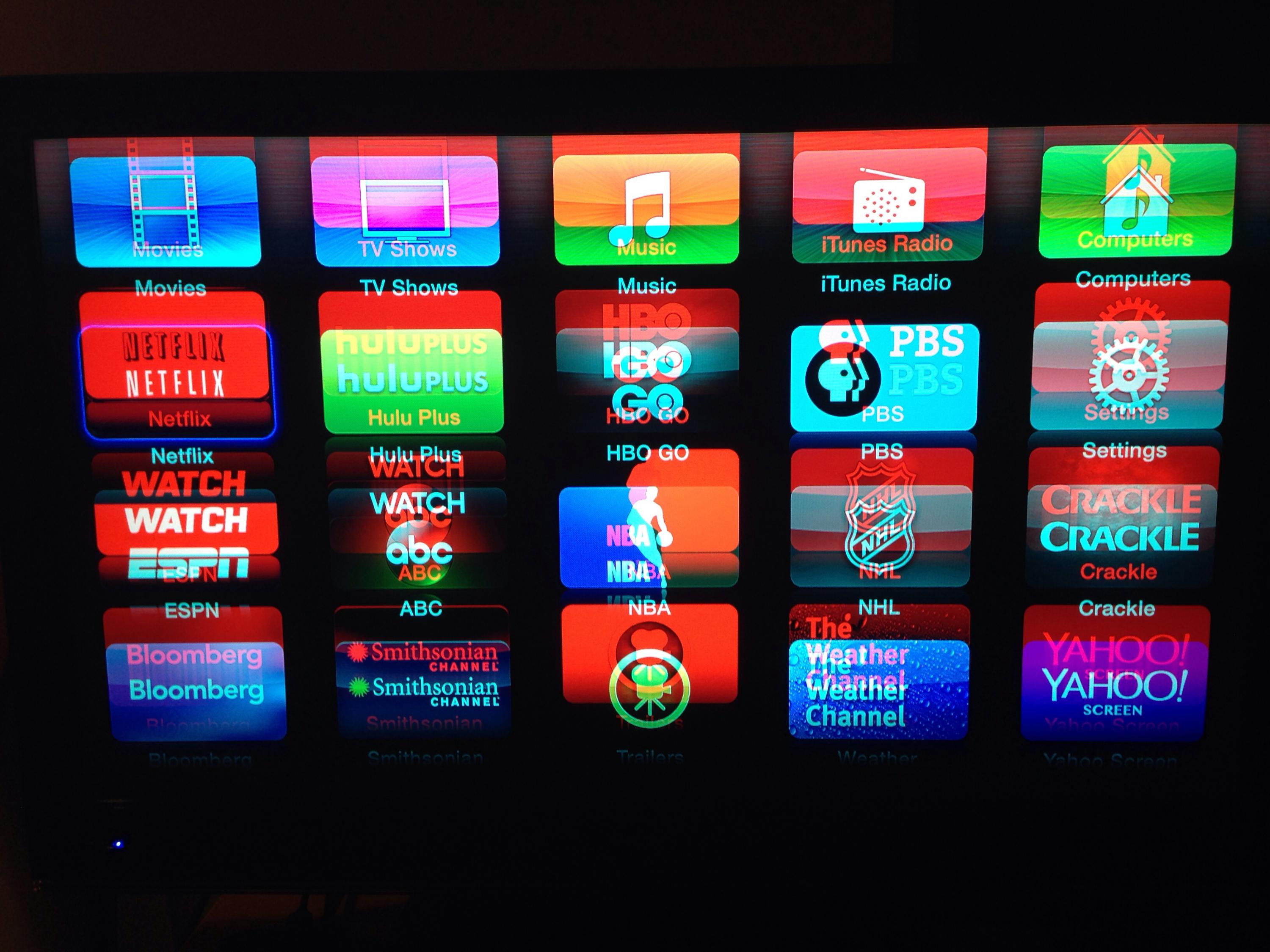

    I've attached a photo of what my screen looks like. I've pulled it apart and don't see anything obvious like blown caps or loose connections. It's a Hitachi 40" LCD model number, L40C205. Basically shows a red and blue tint like a 3D TV that's not. Any help would be greatly appreciated!

      Can you flex the screen to see if it will change? Already try re-seating the cable on the T-CON board and cable between T-CON and the panel.
      You may have bad panel problem. What is the make and model of the LCD panel?

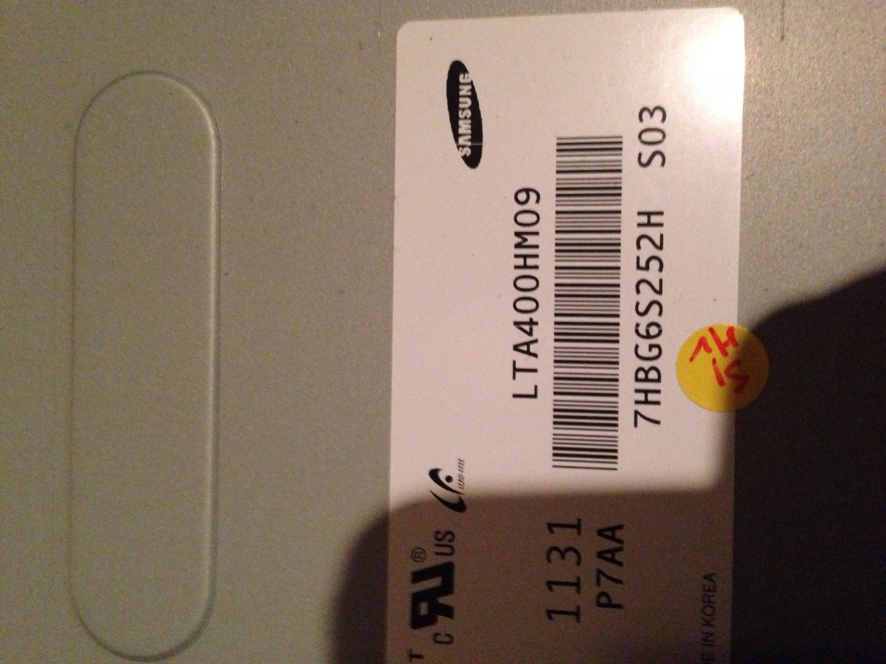

            Picture of what I believe is the panal type. TCON looks like if you wanted to replace it you'd have to replace the panal.
              Re: Hitachi 40" LCD L40C205
              Panal dead?

                Did the fault occur suddenly or slowly get worse? Is it always present or only there after warming up?
                  Picture stays the same from start up, and happened in scene change in a movie. Looks like 3D image.

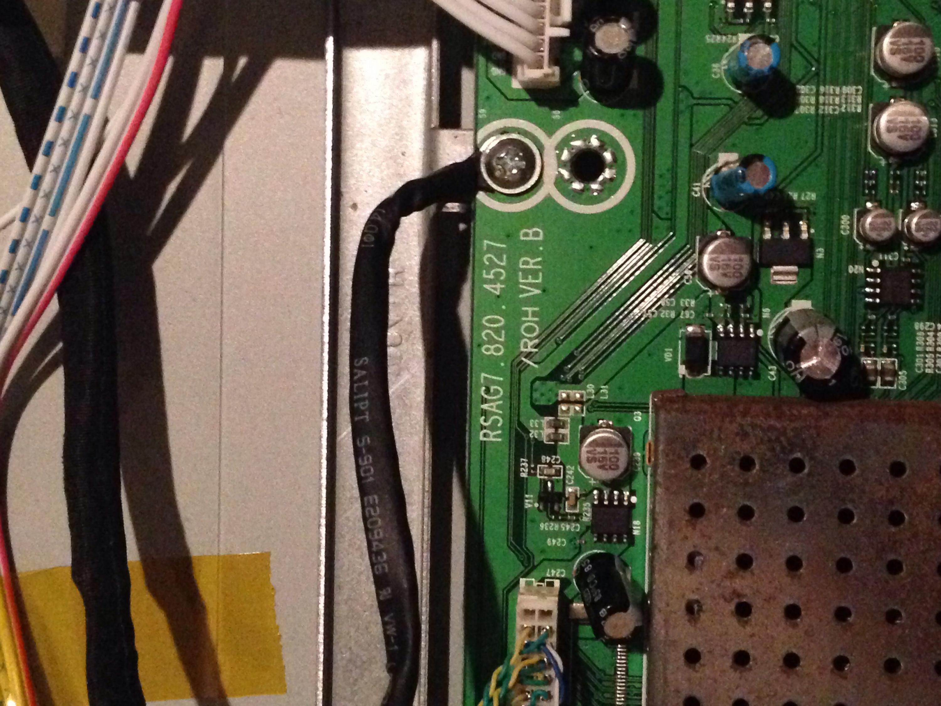

                    Well if it happened suddenly, it could be a corrupted EEPROM setting.
                    As this isn't a real Hitachi inside (just a rebadge) it is necessary to determine the service menu procedure.
                    I would try the following, on the remote
                    SOURCE/INPUT 2850
                    SOURCE/INPUT 2580
                    and any others here
                    https://www.badcaps.net/forum/showthread.php?t=24809
                    to see if you can locate a reset option.
                    I notice main board is made by AoH(?) which may give clue to the service access code.
