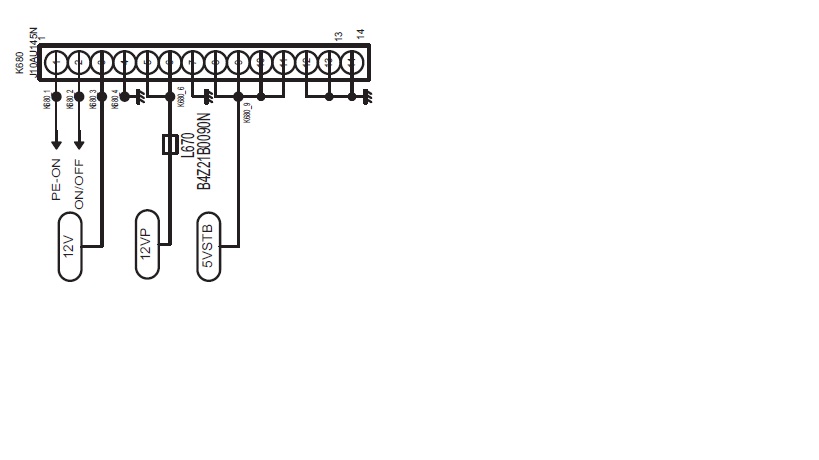

    I understand from the forum that the first thing is to check 5VSTB but not sure where the red and black probes need to be paced

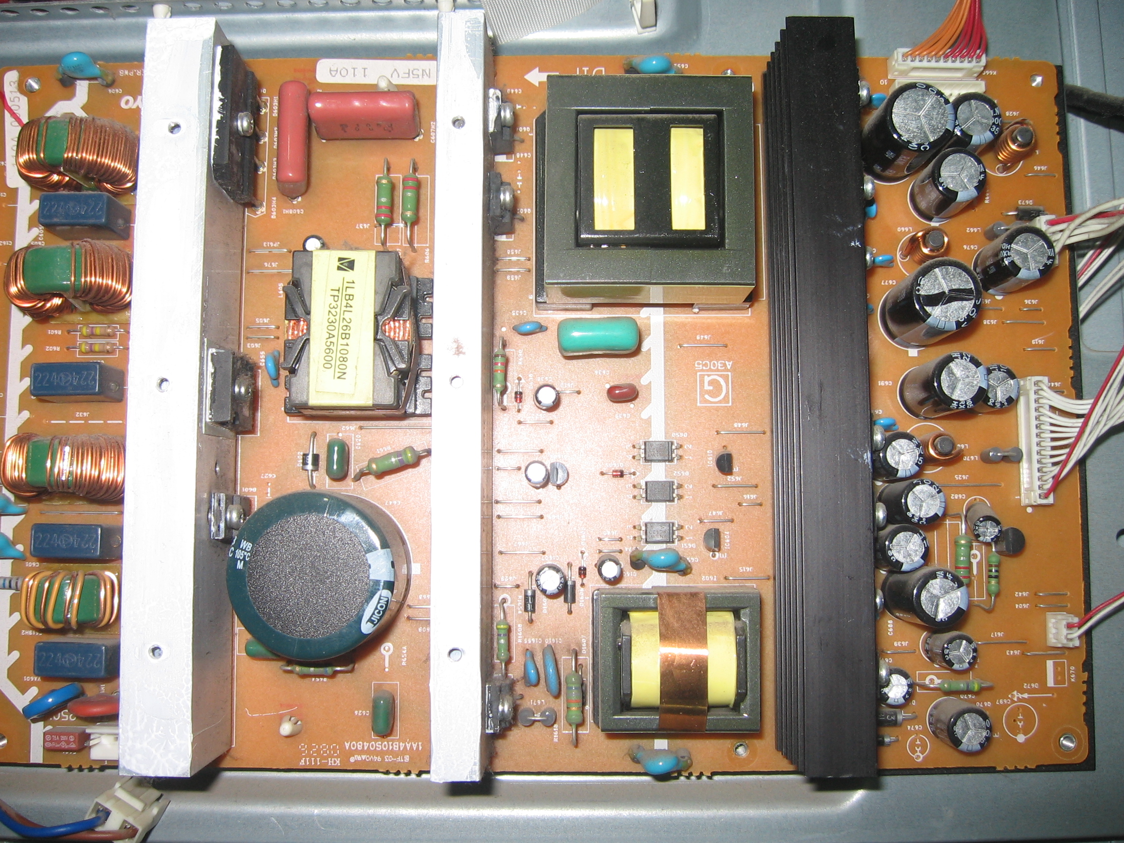

    All the electrolytic capacitor look good without bulges. (Power supply snapshot attached) and i do not see/smell any burnt components

      For now leave connectors in -- later can try without them. Check 5VSTB by touching against the outer sheaf of a 5VSTB pin with the red probe, and the black probe against the chassis. Set meter to 20V DC or volts DC autorange, whichever is available, and observe result.

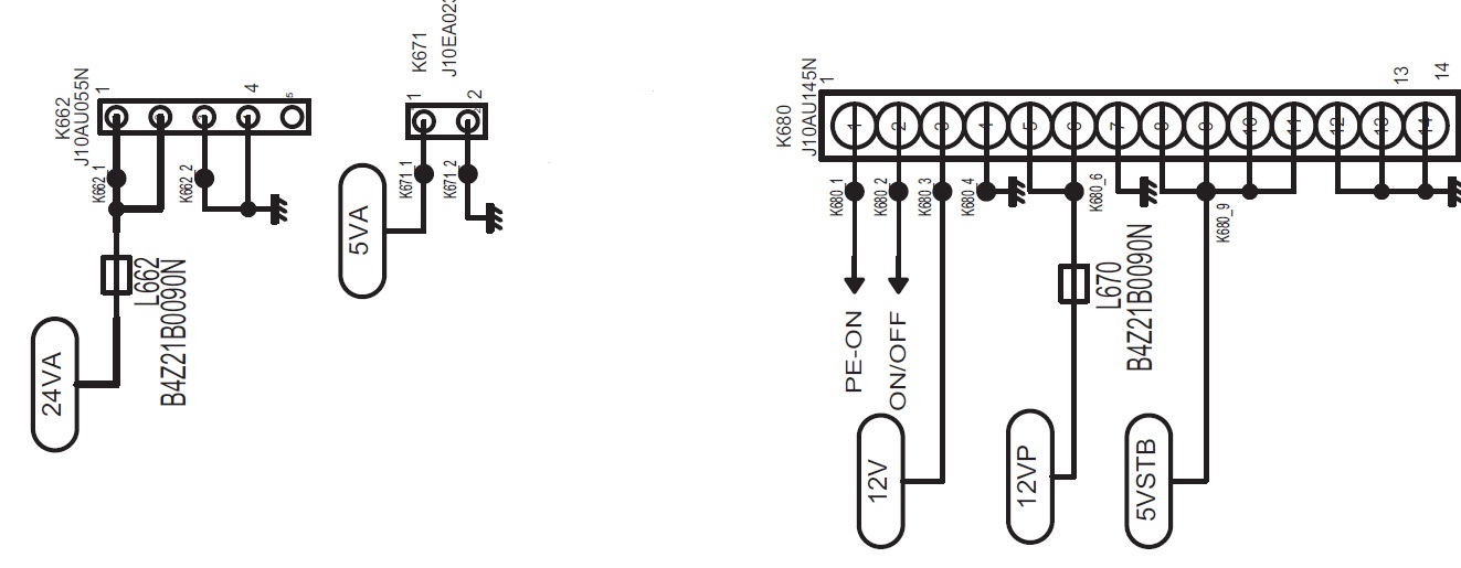

        I should connect red probe to pin 9 (From attachment 2) and iam not clear on the chassis part Could you suggest any point on the power supply attachment? like the area where the screw fits
        Other thoughts, in attachment2 are pin numbers 4,7,14 not ground? if so can i connect the black probe here?
          Re: Sanyo LCD 42CA9S No Lights(R,B,G) & No Standby Power
          Chassis: the metal frame of the TV, back of LCD panel, the wall mount bracket mount points, etc. Yes you can also use a grounding point but that is a lot more difficult to do.

              Up load good clear pictures of the bottom side of the board, we should work on getting the 5VSTBY circuit working first. There are 2 electrolytic caps by the T602 that should be checked, you can try heating it with hairdryer first to see if the 5VSTBY will start up.

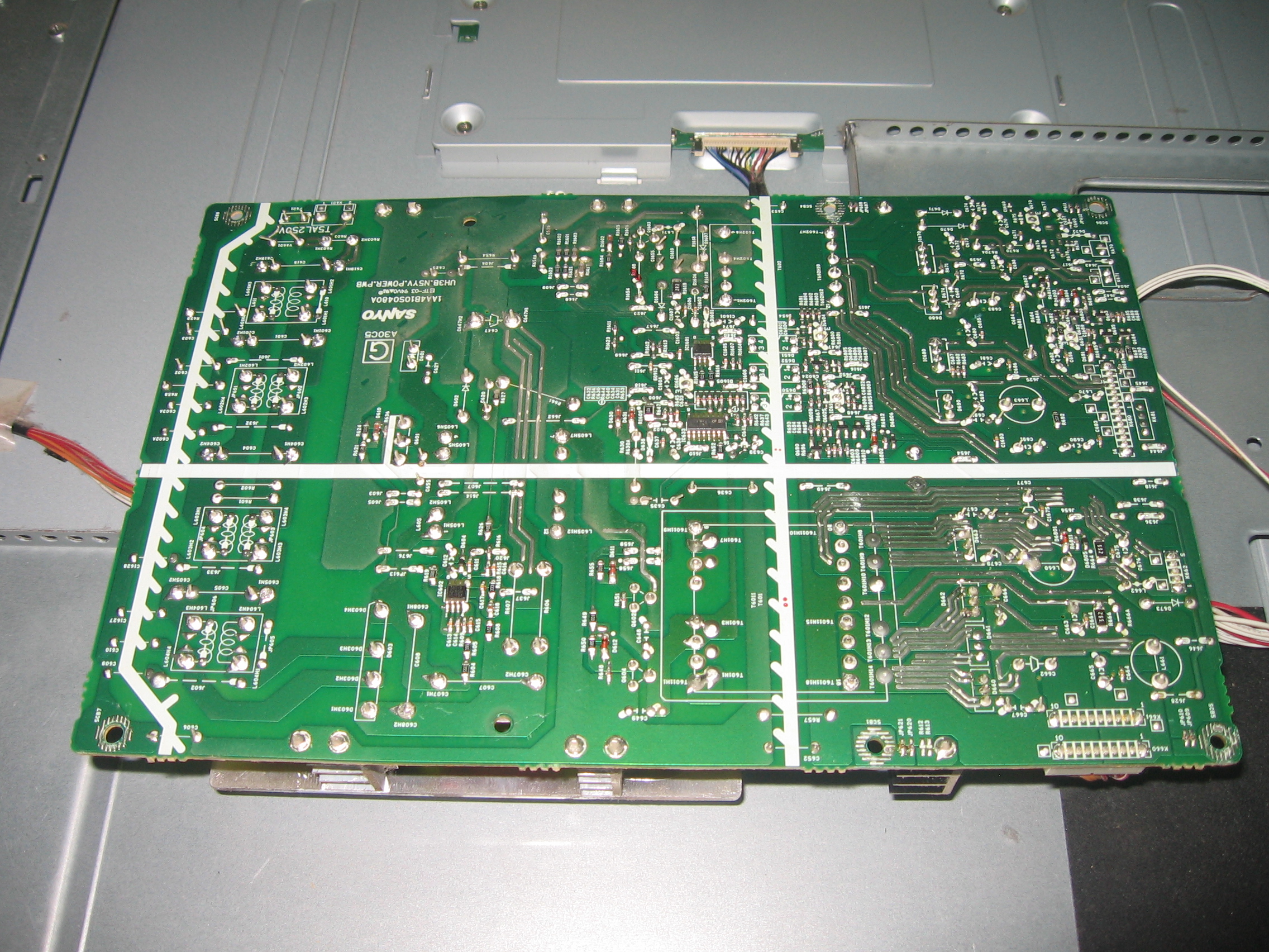

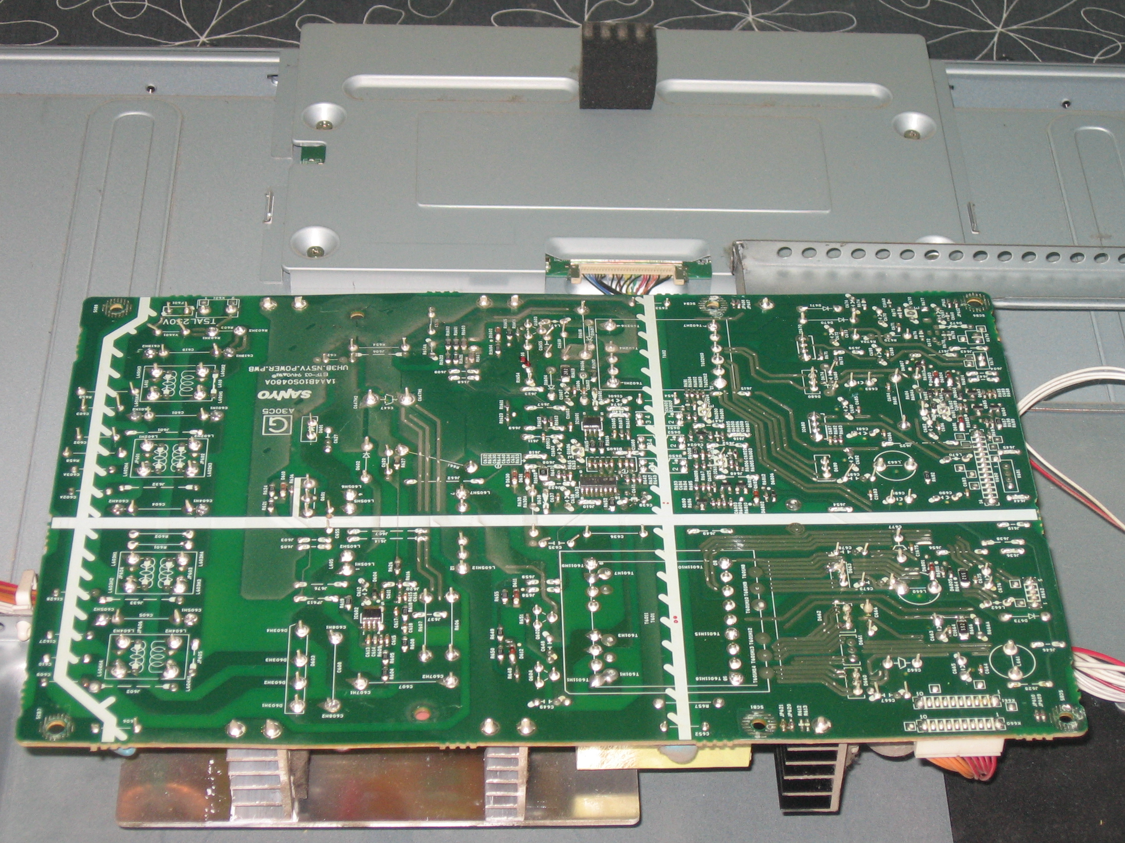

                Uploaded pictures of the bottom side of the board which are not very clear.The schematic is available at
                http://elektrotanya.com/sanyo_lcd-32.../download.html
                on page 64
                I do not have a hairdryer nor a capacitance meter to measure capacitance
                However i did the following voltage checks (across the 2 electrolytic caps by T602)
                1) power terminal - 240 v AC
                2) input AC Voltage to the bridge rectifier - 240 v AC
                3) output DC Voltage at bridge rectifier - 340 v DC (steady)
                4) Voltage at filter capacitor - 340 v DC (steady)
                5) capacitor c1601 47mf/35v - 7.8 V DC
                6) capacitor c1607 47mf/50v - 0.1 V DC (or might be zero too)

                  Maybe just me or the picture but is Q602 ok - looks cracked?
                  EDIT Moving down the heatsink the component at the other end doesnt look great either but hard to tell for the dust.
                    Q602 is good no cracks
                    This is also good no cracks
                    Do the 2 voltage readings of the startup capacitors @ T602 mentioned by budm give any clue?
                    1) capacitor c1601 47mf/35v - 7.8 V DC
                    2) capacitor c1607 47mf/50v - 0.1 V DC (or might be zero too)
                    With No Lights(R,B,G) & No Standby Power, is the steady 340 V DC at bridge rectifier and filter capacitor the right voltage?
