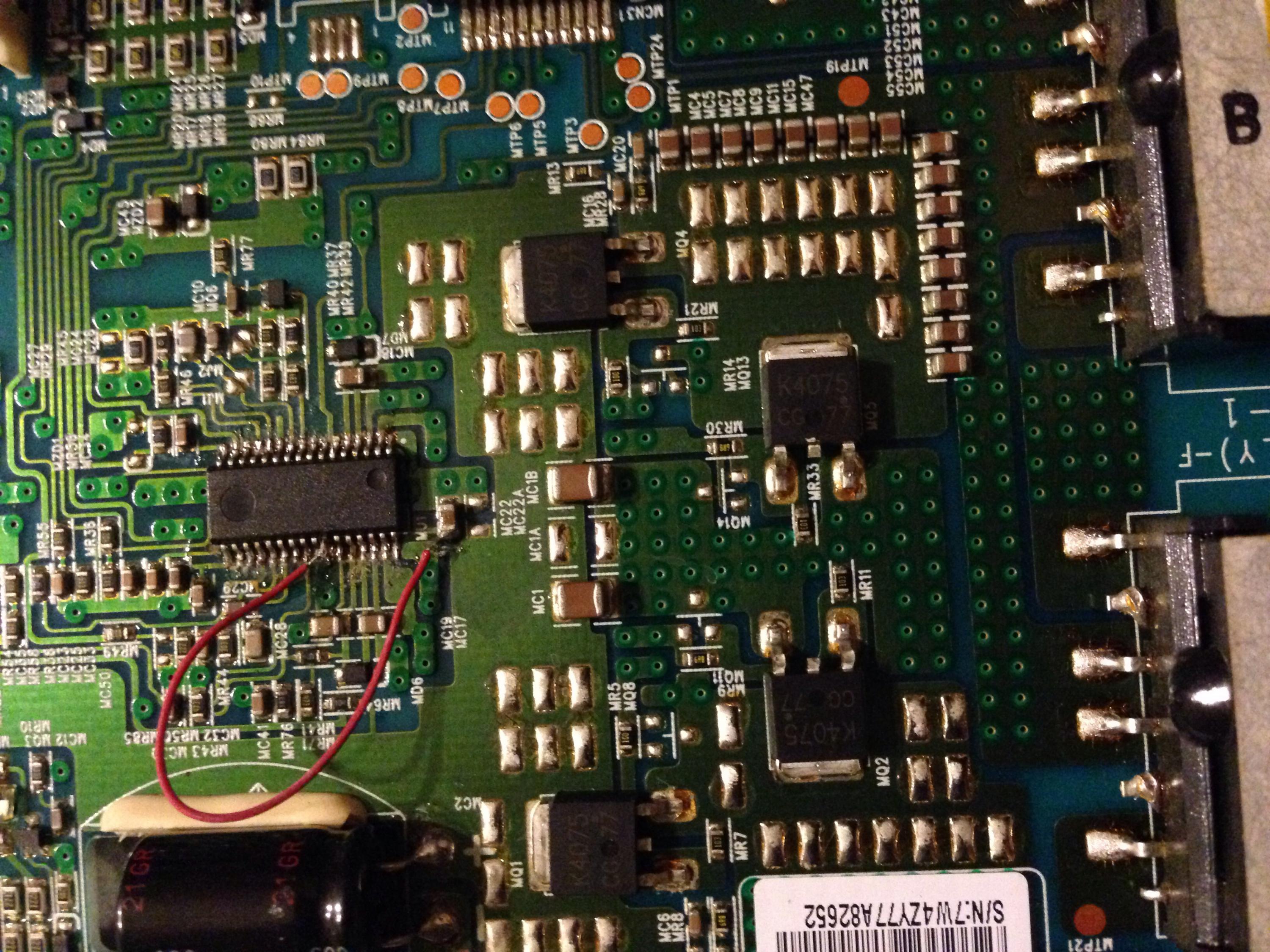

    I replaced chip that was burned had a hole in it the pin where it mounts gone so I jumpered it to capacitor.when I test voltage on to transistors k4075 in middle pin I get 24 volts the side pins I get 1.4 volts.are these bad.

    Here is a pic

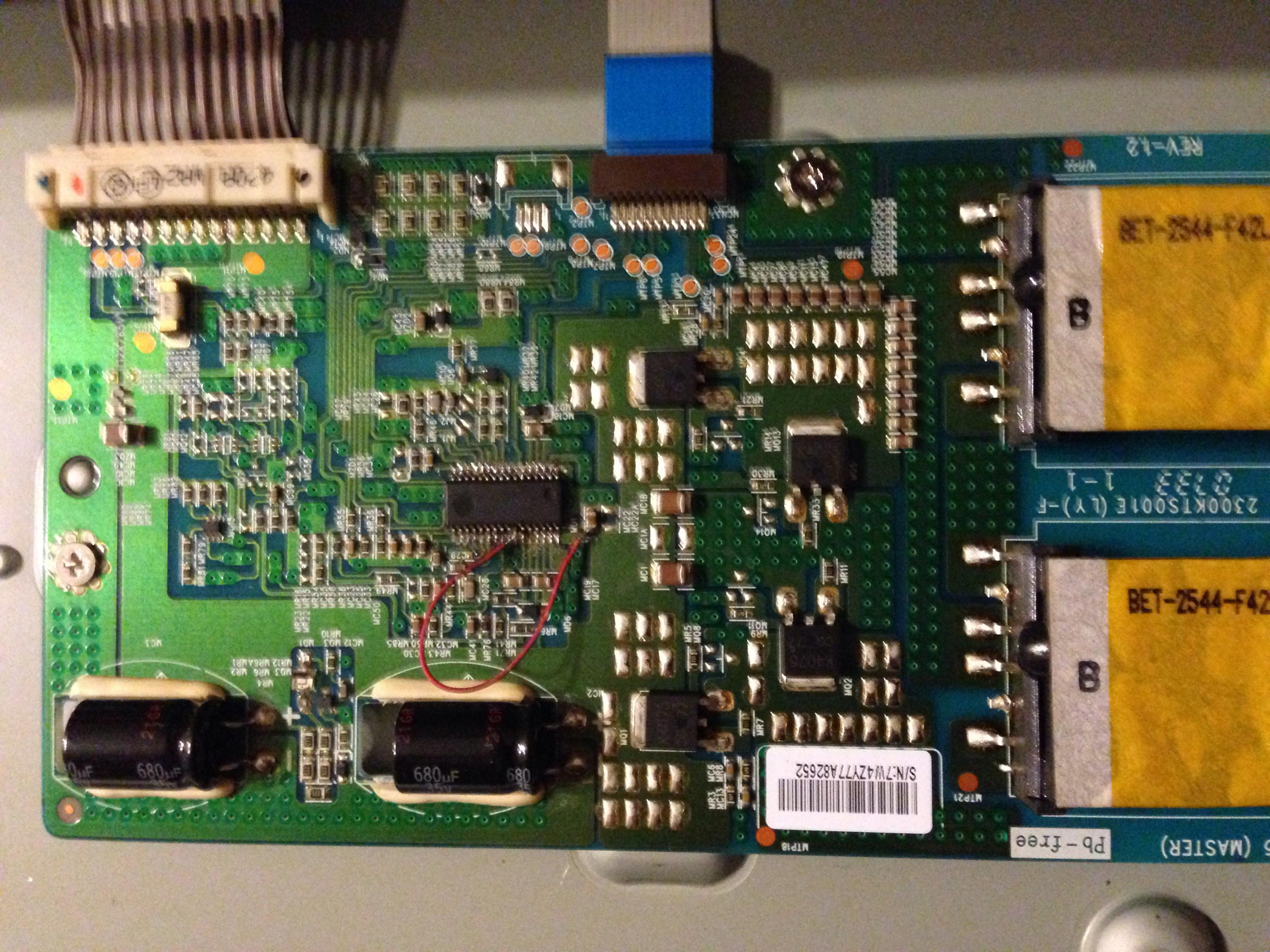

      Here another pic

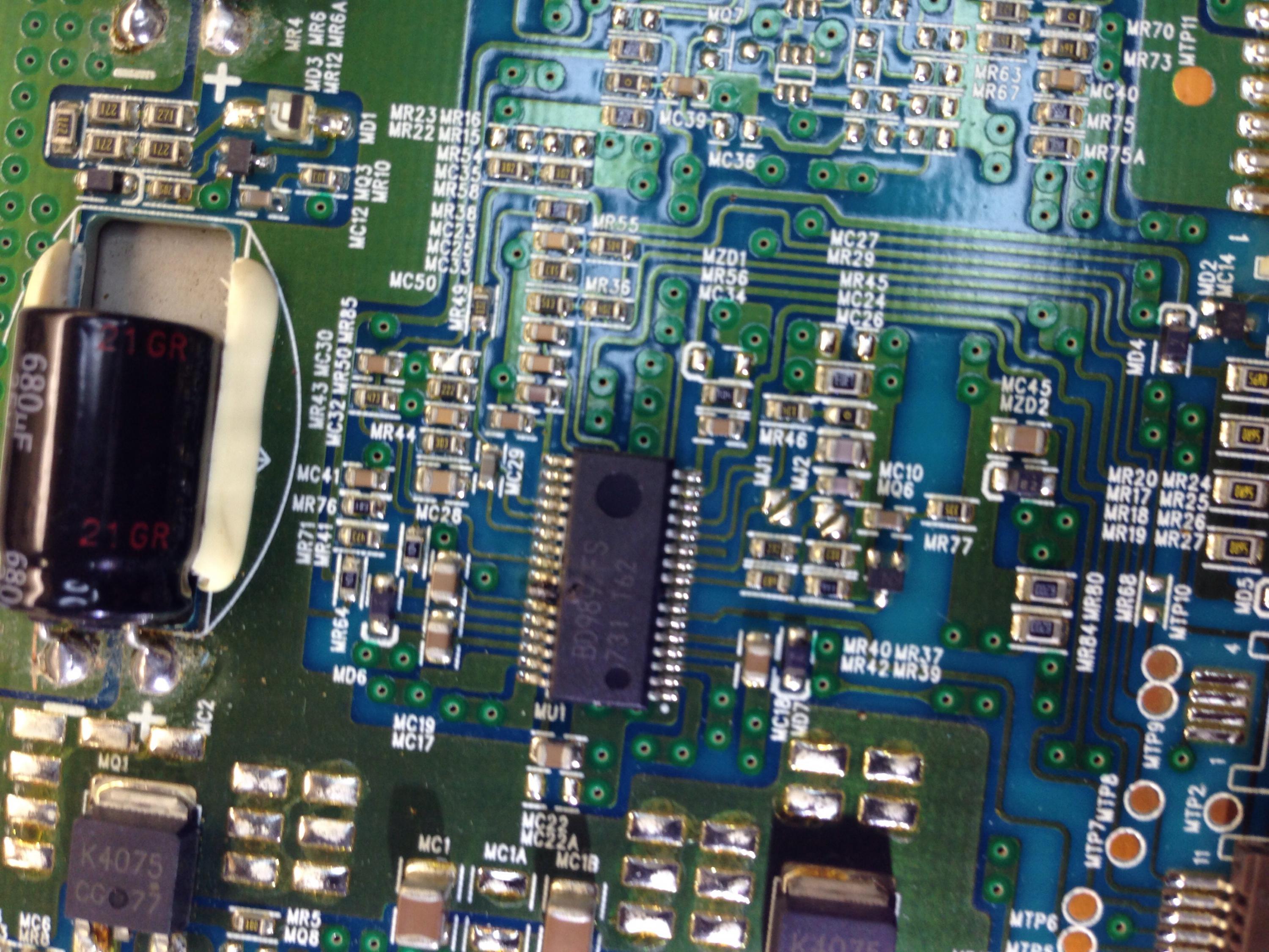

        Here is a pic of the chip before I replaced it

          this is the typical failure with these LG inverters. Did You do the modifications recommended by Philips? Just had this issue and could it solve it with the repair kit containing the BD9897, the TVS diodes, SMD resistors and MosFets.

                You have to do Both of them.

                  I replaced the transistors and chip. Still back light did not work. I tested the transistors on master on top I get 24v on legs I get 1.4v on the slave transistors I get 24v on top and on legs I get 5.8 v.any ideas on what is causing my voltage to be low on transistor legs 1.4v. Also on master I see the blue light come on then dim out and turn off.

                    Does any one know the value of cap mc45 and diodes mzd2 and md5 on master inverter.any help would be appreciated I believe the diodes are shorted. Thanks

                      Well I replaced the Zener diode mzd2 which was bad I replaced it with a 5.6 Zener diode which had the e2 marking and the tv is up and running.
