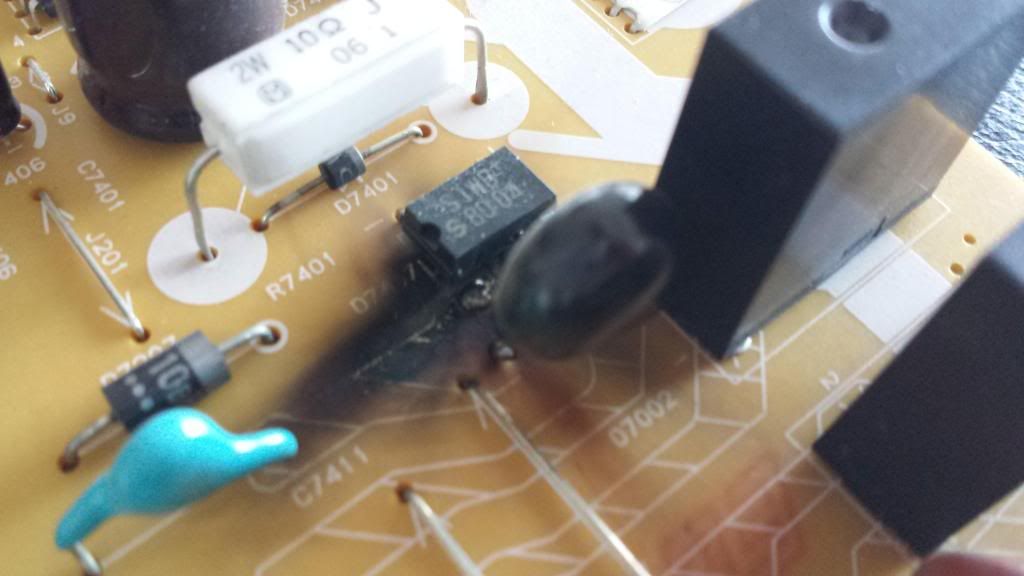

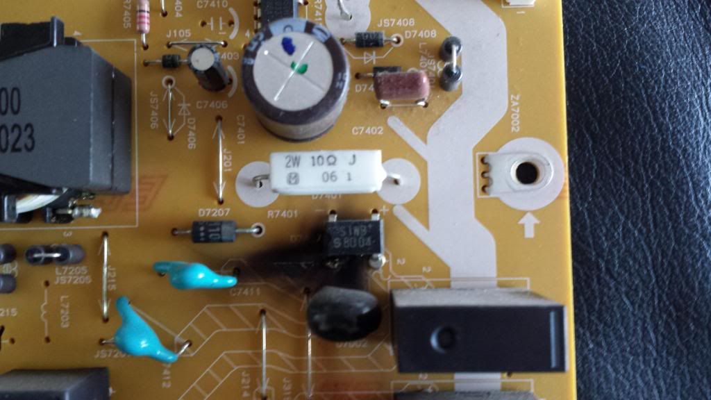

    I've got a Panasonic TH-L37U20A which I've taken apart from found a blown rectifier, seen here:
    http://i1208.photobucket.com/albums/...psae37723c.jpg
    http://i1208.photobucket.com/albums/...ps8109d2fe.jpg
    It's also blown the main fuse with it but thats no problem the issue is I don't know where to find a replacement that's exactly the same.
    To save you looking at the pictures the chip reads S1WB (1st Line), S80 04 (2nd Line), the closest thing I could find is this one on eBay:
    http://www.ebay.com/itm/S1WB60-Manu-...:X:RTQ:US:1123
    But the second line doesn't match. Where can I find a replacement?

      Re: Panasonic TH-L37U20A Blown Rectifier?
      Its a 800 volt 1 amp bridge rectifier, Should be able to get one anywhere.
      http://www.digikey.ca/product-search...=0&pageSize=25
      That large bridge you have would work but would be a pain in the ... to mount it.
