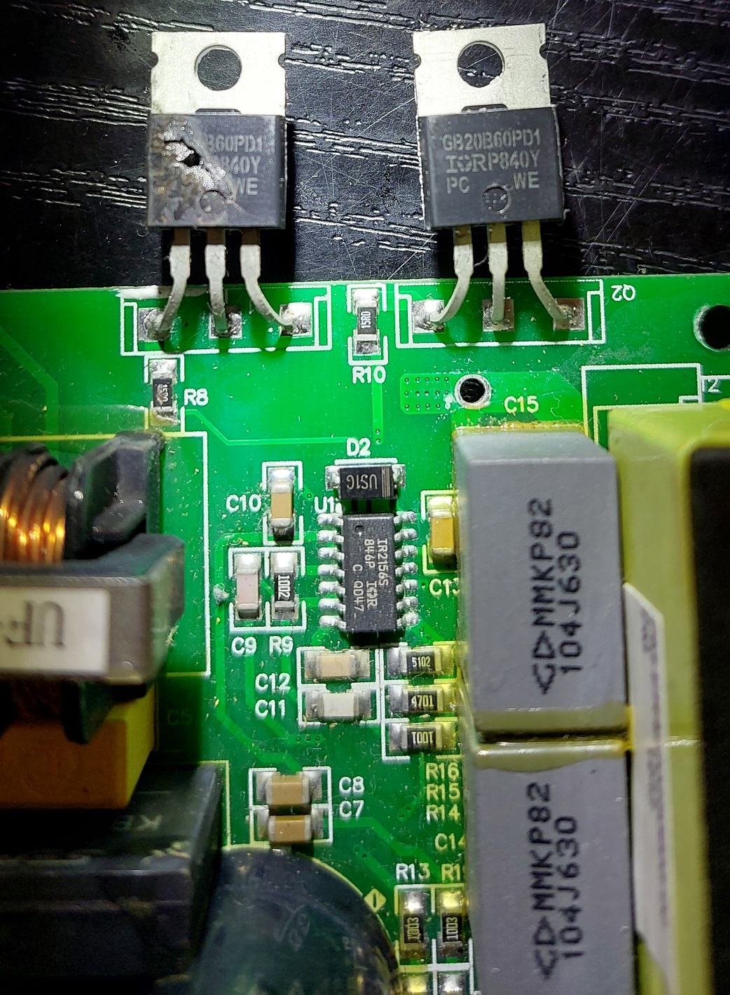

    hello.
    I have two power amplifiers, both having their IGBT blown on the PSU.
    The original mounted IGBT where marked with IRGB20B60PD1PbF and the gate driver is a IR2156STRPBF.
    I looked at mouser and digikey and could not find any available IRGB20B60PD1PbF and somehow ended up using a Bourns BIDW20N60T.

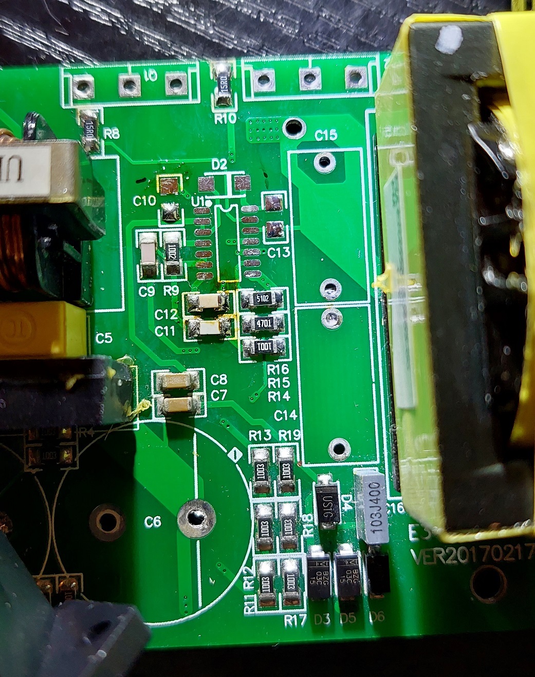

    I replaced the gate driver, the gate resistor and both IGBT. But as soon power is turned on, both IGBT shorts out completely (gate, emitter, collector) and the fuse on the AC line gets killed.
    So I though i missed a capacitor or diode. I removed allmost every component between the bridge rectifier and trafo. compared them to a new component, didnt find anything of interest..
    anyways i decided to replace the gate driver (again) , snubber, diodes and some SMD caps.
    installed a new set of BIDW20N60T and the same thing happend again, both IGBT dead instant.
    I removed the IGBT and measured the DC voltage coming from the bridge rect. 323v stable.
    So im wondering if the BIDW20N60T was a bad choice ? maybe I should have used a IKP20N65H5 instead ?
    Tips to what to look for or check is appreciated
    I have attached my homemade schematic and some pictures.

    Original IGBT and parts.
    Click image for larger version  Name:	20231021_153645.jpg Views:	9 Size:	560.4 KB ID:	3173891

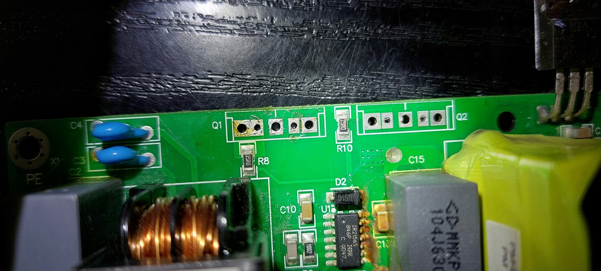

    Parts removed and SMD caps checked.
    Click image for larger version  Name:	20231123_184341.jpg Views:	10 Size:	517.2 KB ID:	3173892

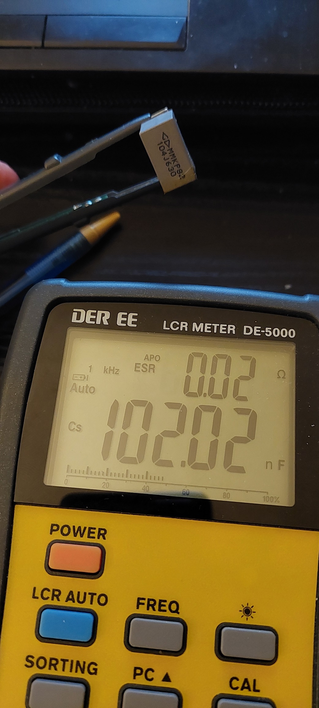

    Rectifier and Caps checked.
    Click image for larger version  Name:	20231125_194955.jpg Views:	10 Size:	736.0 KB ID:	3173888

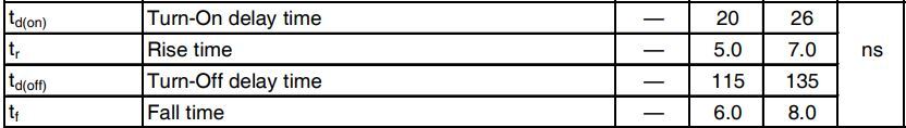

            I don't think your Bourns IGBT is a good replacement. The gate emitter threshold voltage is off, the rise and fall times are off. It's like the Bourns is too slow and it needs more gate emitter voltage than the original one.
            Compare IRGB20B60PD1 to IKP20N65H5​ and that to your BIDW20N60T.

                Thanks for pointing that out CapsLeaker.
                there is a huge difference in rise and fall times.
                IRBG20B60PD
Name:	IRBG20B60PD rise fall time.jpg
                Bournes
Name:	Bournes rise fall time.jpg
                IKP20N65H5
Name:	IKP20N65H5 rise fall time.jpg

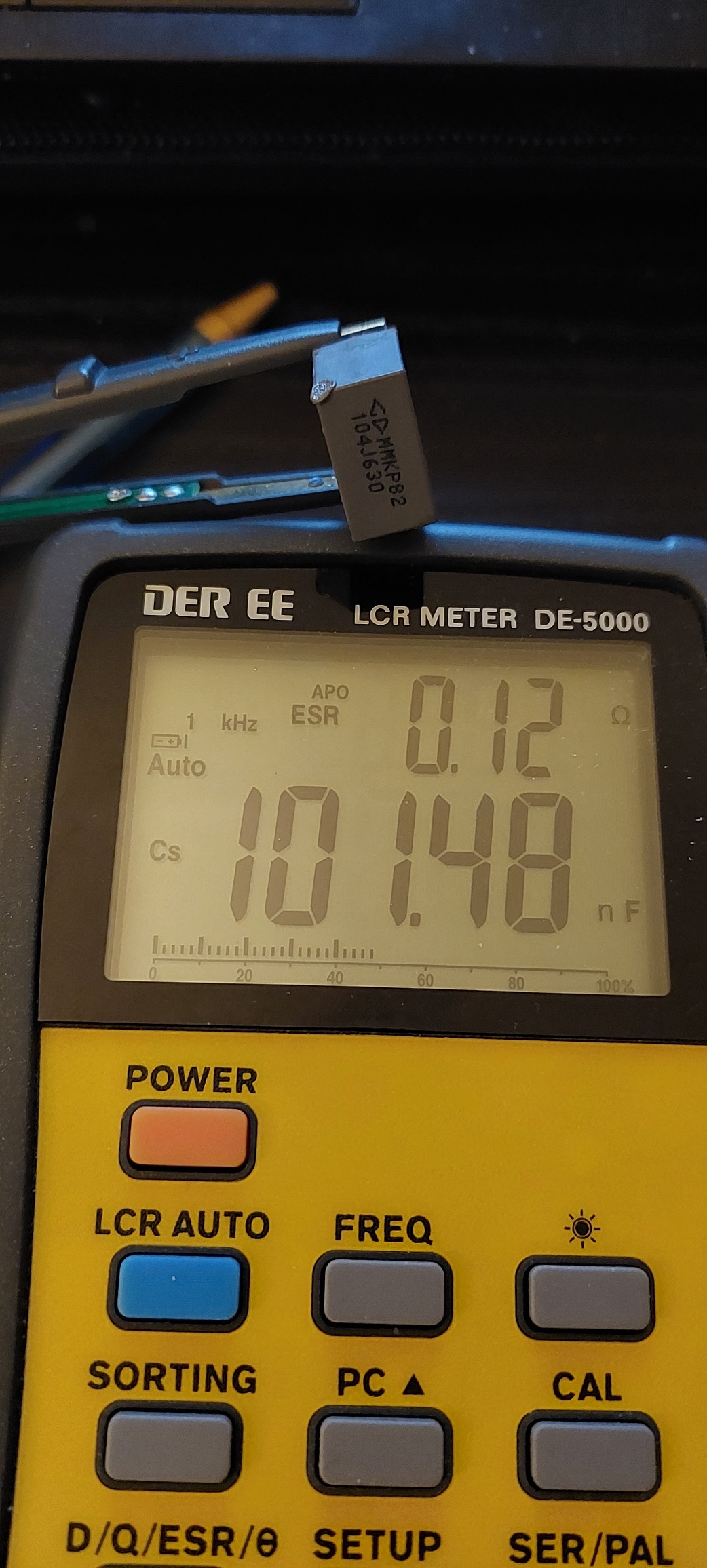

                Some measurement on C14 and C15 cap.
                Looks good to me.

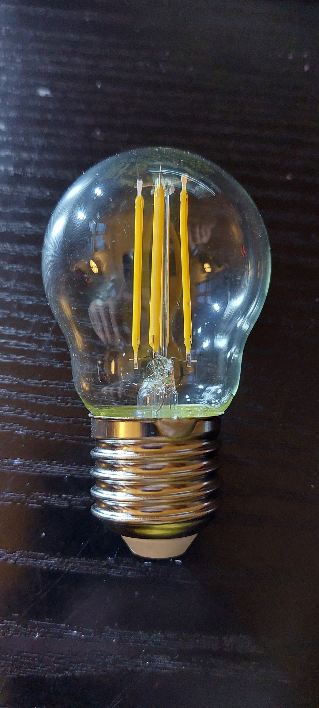

                  I thought about these 2 film caps as well. I would build a incandescent lamp in series trick to limit the current going to the PSU, so you don't blow up parts all the time. Then I'd assemble this PSU but leave the IGBT's out and check the gate drive. Install the right IGBT's and see what happens.
                  See how close the original IRBG20B60PD​ is to the IKP20N65H5? The BIDW20N60T has similar values in most categories, but is much slower that the original. While the IGBT turns on all right, it may be too slow turning off (so it kind of behaves like a stuck on gate drive). The gate voltage is off too...

                    will try a incandescent lamp in series.
                    I got a 40W, will it do the trick ?

                      that is LED
                      • mikkele86
                        mikkele86 commented
                        Editing a comment
                        dang it. your right. need to go shopping then

                      No. It has to be an old style incandescent light bulb, not a CFL or LED strings like this one you pictured. I use 60w, 100w and 150w bulbs, depending on how much I want to limit the current. Start with 100w.

                        got it. just made ordre online, couldnt find any local retailer which had old style incandescent light bulb.

                            i have been waiting for almost a year for somebody to post that!
                            it's not 40w anyway - it's gonna be 2w or 4w with that number of led-strips

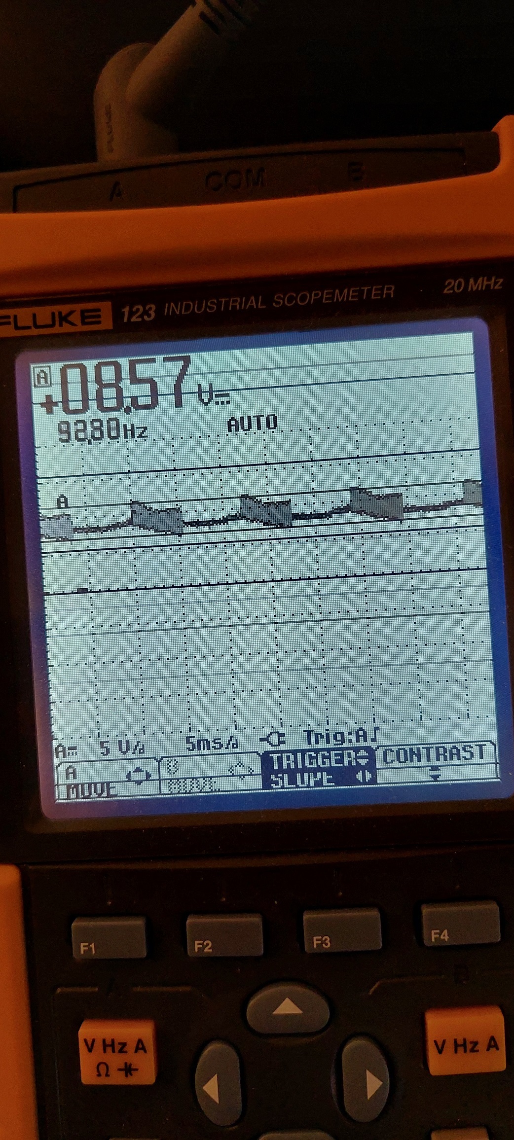

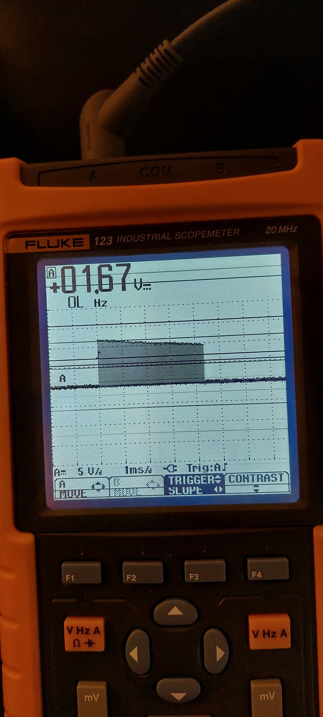

                              Got the bulbs. used the 100watt, lights up for split sec.
                              Everything seems to be running without the IGBTs
                              I have taken some measurements, with COM/negativ from the oscilloscope to the COM on the PCB (pin 8 on gate driver)
                              hope its done right 😅
                              HO and LO gate at the same time.
                              HO - pin 13 channel A (upper)
                              LO - pin 11 channel B (lower)
Name:	HO + LO gate.jpg
                              CPH - pin 7 on gate driver
                              RT - pin 4 on gate driver
                              CT - pin 6 on gate driver

                                The first pic that shows HO and LO, I only see one channel B and nothing much on channel A. That's not right. Also check the gate drive resistors.

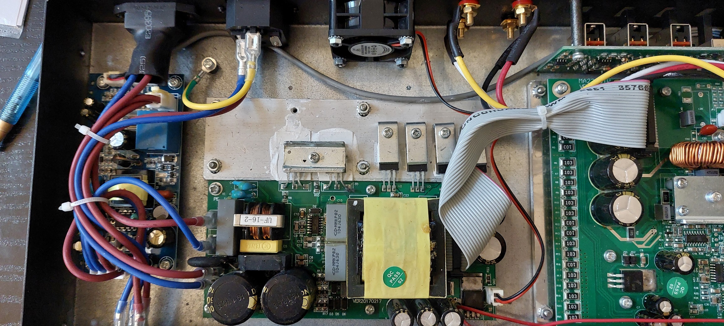

                                      its alive 🤩
                                      thanks for the inputs
