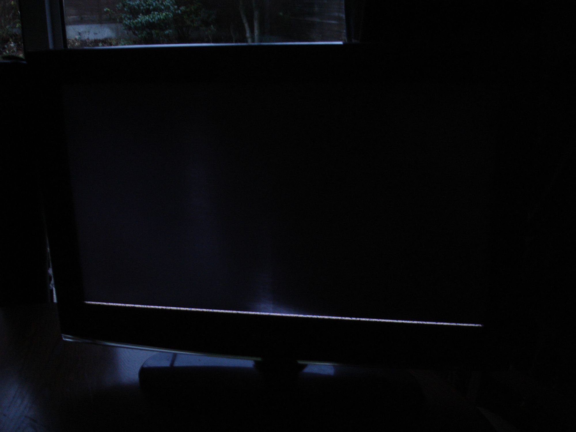

    Hi chaps,
    My uncle has handed me this little TV for a pet project. The failure happened (as my uncle described it) as a white square in the top right corner which then spread to the rest of the screen, then the screen died.
    When you turn the screen on now, no matter which source you select, the screen displays a very thin multicoloured static line along the bottom of the screen and there is some vertical "ghosting" on the left hand side on the screen. It does still play its "splash" sound.
    I've popped the back off to have a quick look for any obvious over heating/burning or bad caps. The power supply has got a couple of suspect bulging caps, but the TV doesn't seem to have a problem at the moment with getting power.
    Would you guys think this would be a terminal panel failure or maybe a T-Con failure - or even something else.
    I would really appreciate the help!

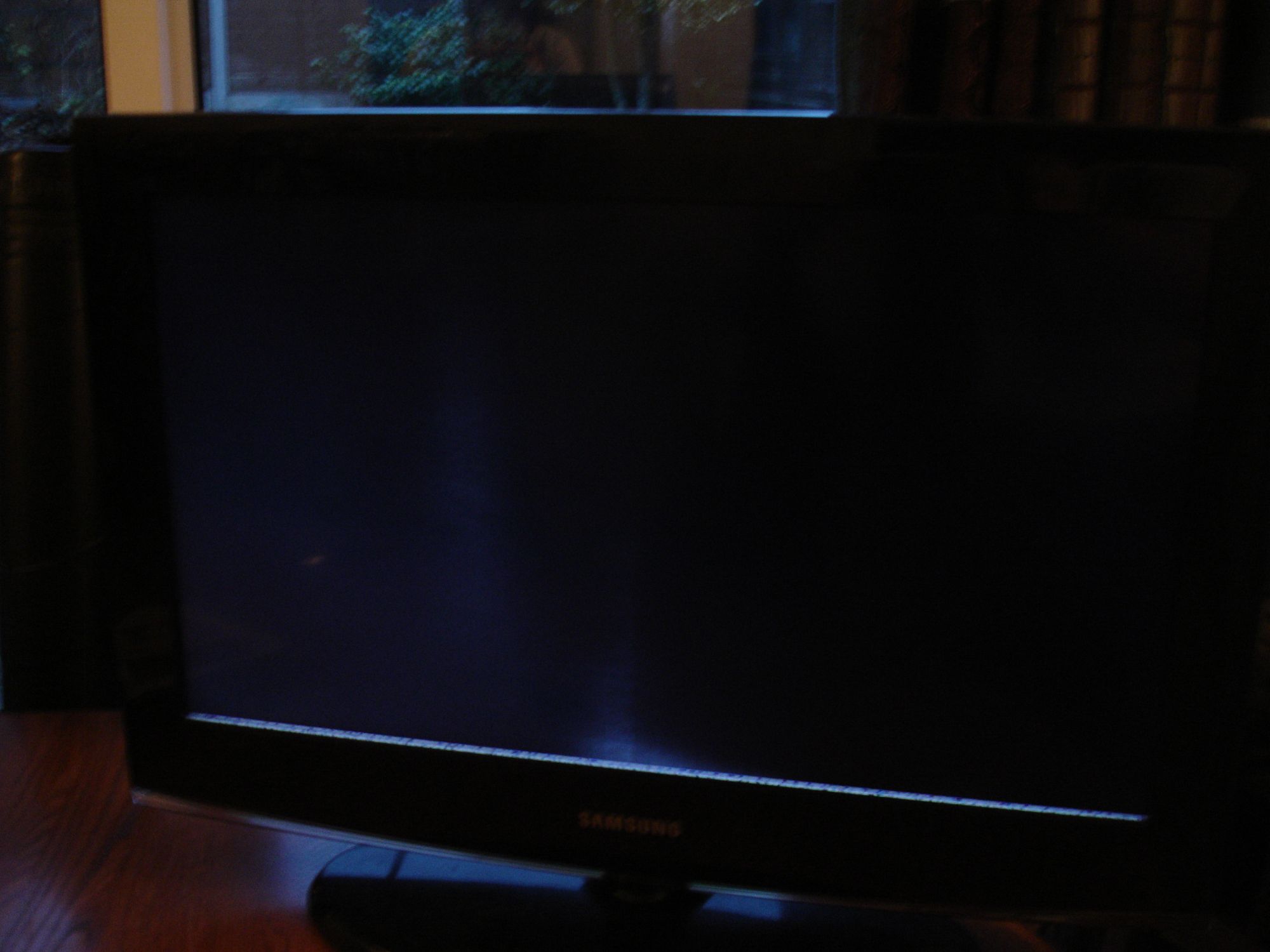

          Here are some pictures of the screen running. They aren't great my camera can't get decent light with the rubbish weather at the moment and if I used the flash it masks the problem with the screen, but I think you get the idea.
          The screen has the white ghosting after a couple of minutes turned on. It's much more noticeable in person than in the photo. Its is mostly on the left side of the screen, there is some that protrudes into the right half of the screen. The line I was talking about, at the bottom of the screen seems to only come from one source (pressing the source button on the side removes the line until the tv has cycled back round).
          I will try to get some pictures of the boards when the light is better

            Chances are high that you are dealing with a similar problem.
            https://www.badcaps.net/forum/showthread.php?t=33833

              Re: Samsung LE26A456C2D issues.
              Hi johnboy1313. Is it possible for tab bonds to cause a completely blank screen?
              • newtothis
                • Mar 2013
                • 1556
                • england
                Yes it is, Can you just disconnect the tcon and see what shows on screen
                • NeiltheDruid
                  • Sep 2010
                  • 42
                  hi newtothis,
                  I disconnected what I believe to be the T-Con from the main board (the one with the I/O ports). The screen goes completely black, no white, no line along the bottom, but I'm pretty sure that's because the signal has been totally broken to the panel.
                  I looked this board up on ebay where it is reffered to as a "display driver" The chain the boards run in are power supply -> main board -> "Display driver"(?) -> Panel. Unless there is another board that is buried under the shielding that I am missing.
