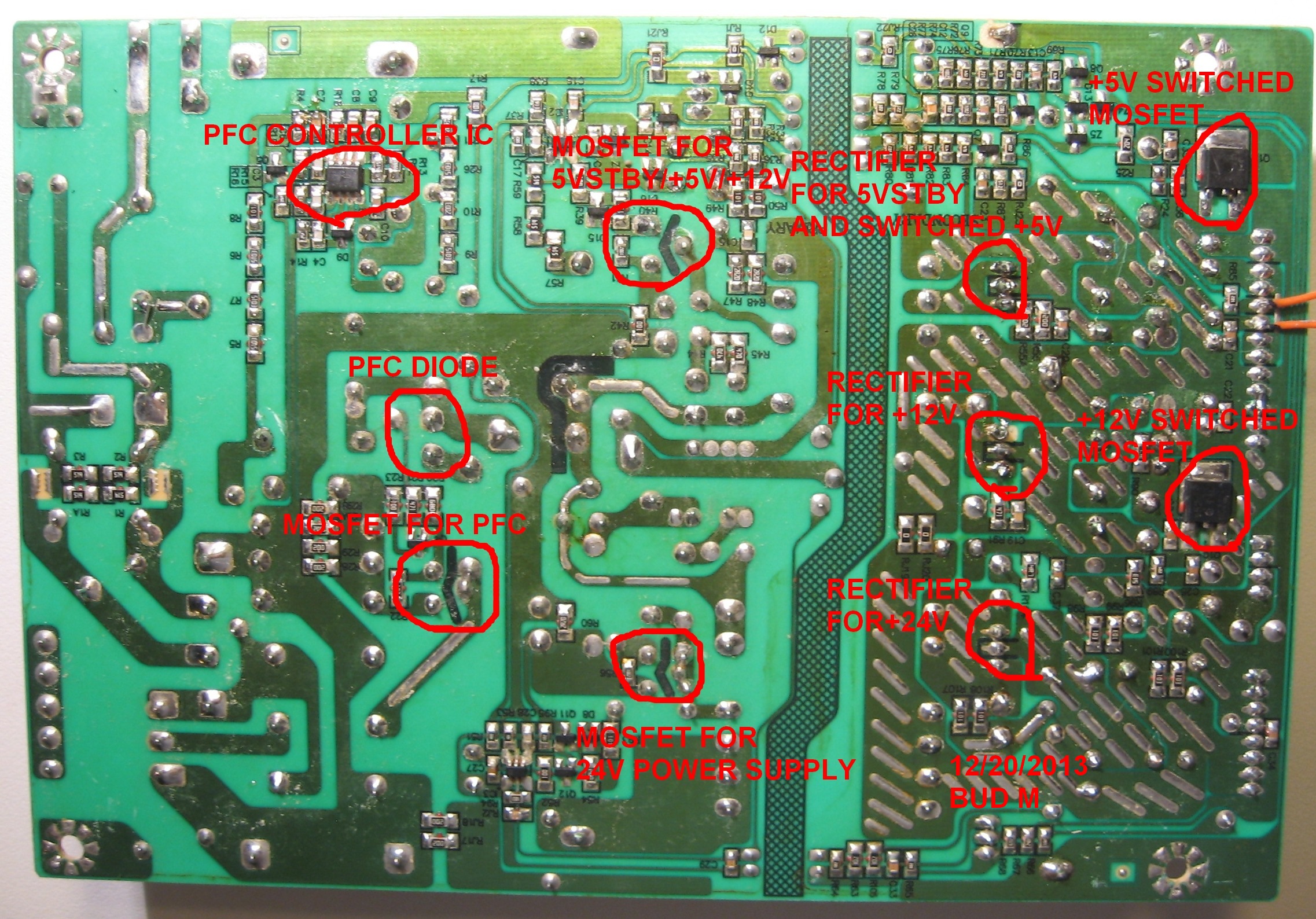

                OK, since you are getting the PS_ON OK but the 24v power supply did not turn on, you need to find out first if the PFC voltage booter is working or not since the 24v require 380~400VDC to run.
                Carefully check the dc voltage RIGHT AT THE TWO LEGS of the big blue cap (with RohS label) to see what the DC voltage is when TV is turn on, it should be about 160~170VDC when TV is OFF and about 380~400DVC when it is on.
                The switched 12v is generated by the same transformer that is generating the 5V.
                This SCH may be close to what you have on your board.
                Never mind, the SCH does not match your board.

                    #49
                    Re: VIORE 32" - Power board problem?
                    OK, I'll try this too, I need solder that rectifier back first.

                      OK, this is what you have on your board.
                        Should I do it with red multimeter probe on positive leg of capacitor and black probe grounded to metal part on TV? I just tried that and it reads about 30-50 when multimeter is set to 200m DCV. It have no readings when set to high voltage.
                          #52
                          "Carefully check the dc voltage RIGHT AT THE TWO LEGS of the big blue cap"
                            #53
                            Ok, it reads about 366V if I put probes on both legs.
                              #54
                              OK, the PS_ON is good, the PFC voltage booster is good. Need to trace out the 24V, switched +5v and the switched +12V power supply circuits next.

                                #55
                                How can I do it?

                                          #60
                                          Just got replacement board - it works now. Still wonder what was wrong with old one, but I guess I'll never know. I just want to thank everyone that helped me here!
