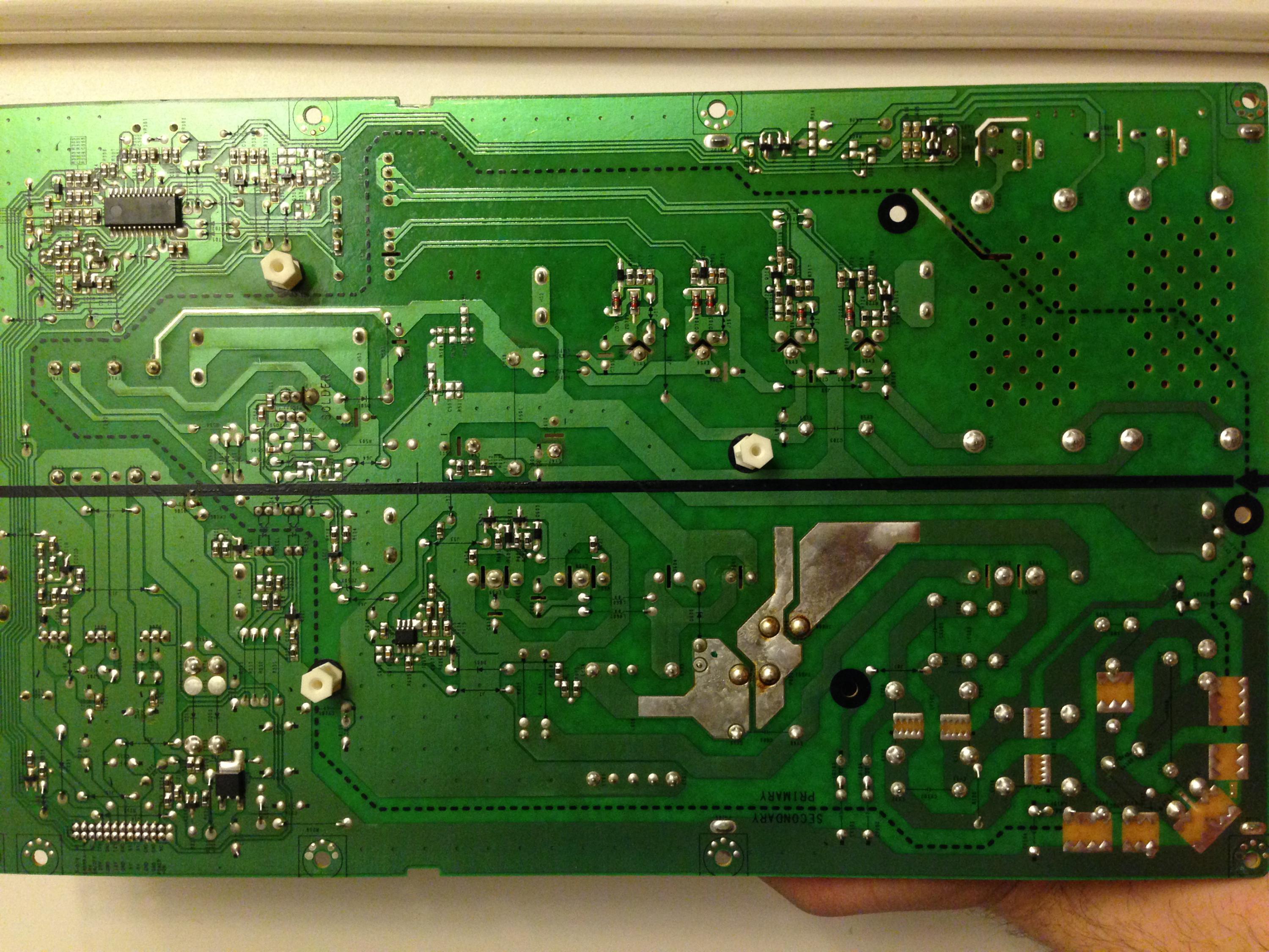

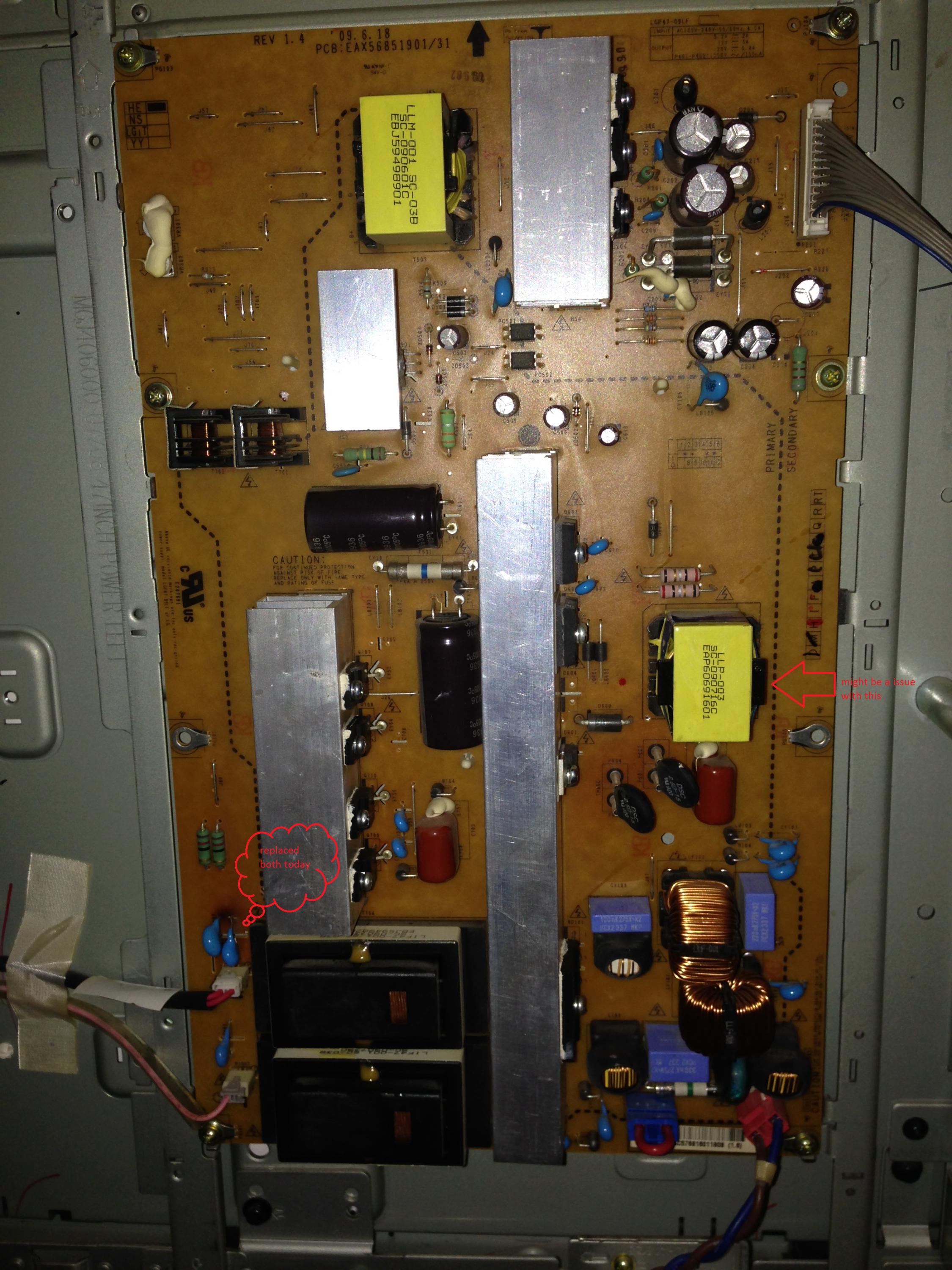

              here is a pic of my board same as the others but rev 1.4 anyway my issue is i am getting 64.0 v from the yellow box and the 2 black disc caps get hot i was going to chance those as well but wanted to wait to order more parts so im just wanting to know if anyone has had issues with the box or not and where can i find one from
                #47
                Re: Lg 47LH40-UA
                What GND point did you use to get the reading of 64V from the YELLOW BOX which by the way is the PFC INDUCTOR for producing boosted Voltage to run the main power supply and inverter circuits.
                You should see >360VDC between the two legs of the main filter caps when TV is turned on.
                Did you replace those two blue ballast caps?

                  Ok I re tested the PFC INDUCTOR I'm getting 170dc v in standby when I power the tv on it goes down to 111 dc v also the 2 black temperature thermistor (Dsc 2.5d-15) are getting realy hot there is a faint buzzing sound when the power goes on I think it is from the PFC INDUCTOR
                    #49
                    Re: Lg 47LH40-UA

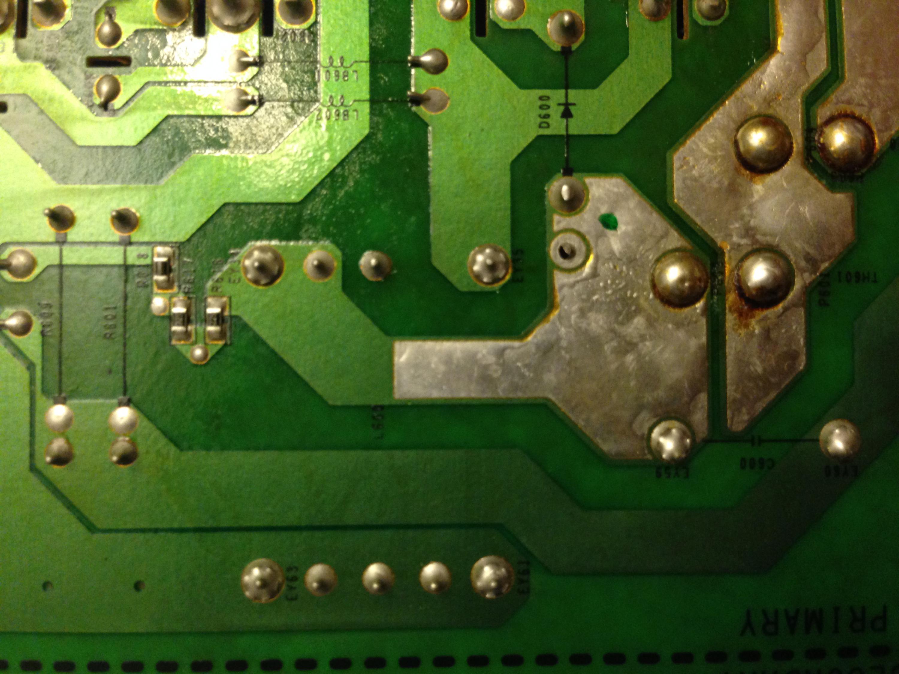

                    Are you measuring the DCV on the inductor? You need to test the DCV between the two legs of the main filter cap.
                    http://assets.shopjimmy.com/media/ca...ay57681601.jpg
                    Shopjimmy does not have picture of bottom side so you nee to provide us one with really well focused so we can easily see the traces.

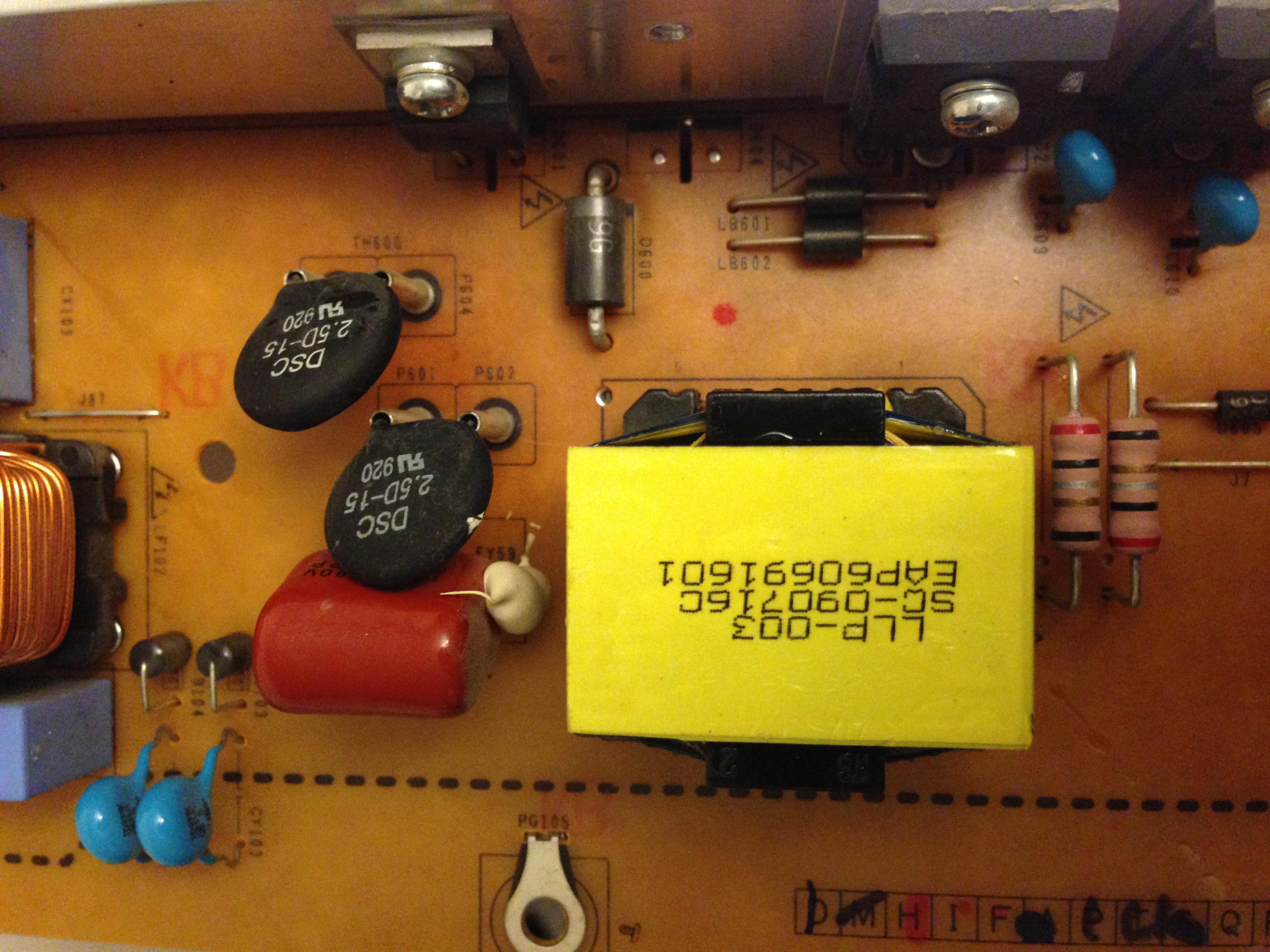

                      pics
                        #51
                        Re: Lg 47LH40-UA
                        OK, those 2 thermistors are connected in series to feed the PFC Voltage booster circuit and there is no bypass relay and as they get warm the resistance should go down to reduce the power dissipation.
                        So we need to find out if the PFC Voltage is working or not first.
                        Also you circled those two blue ballast caps, did you replace them?
