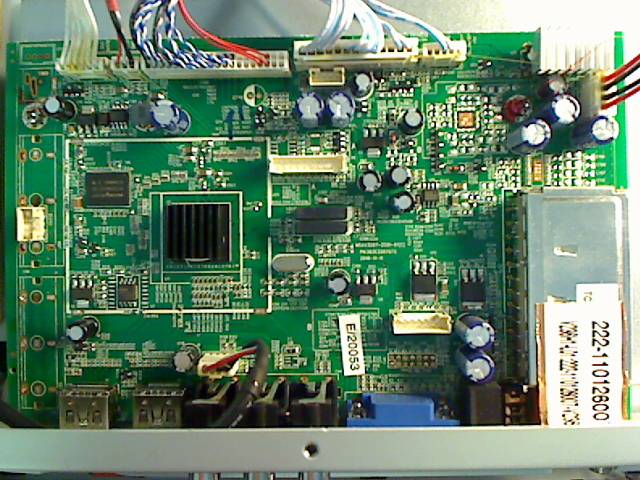

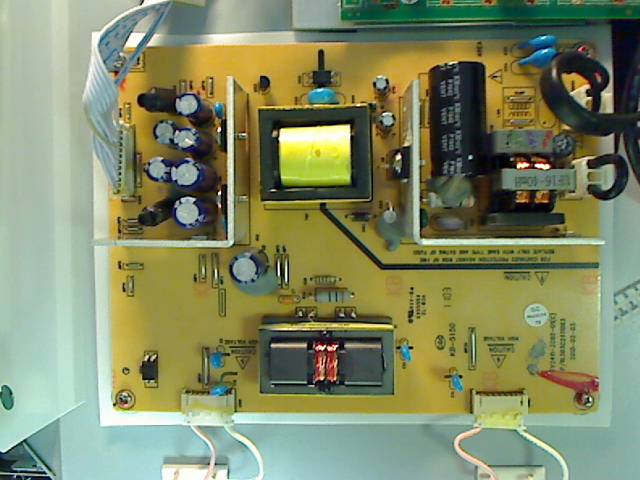

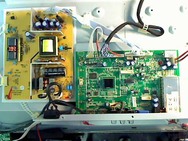

    Start by posting good clear pictures of the back of the TV and the boards so we know what we are dealing with first.

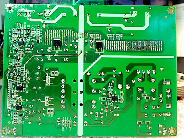

      Ok I hope these help
        Re: Haier L24B1180

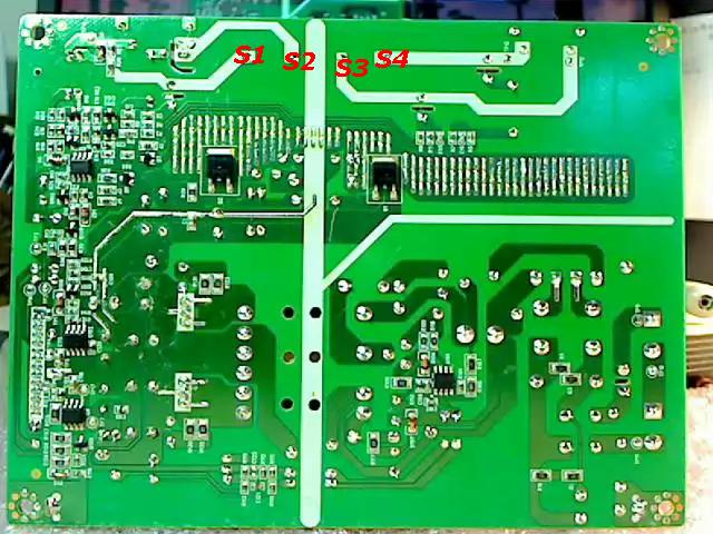

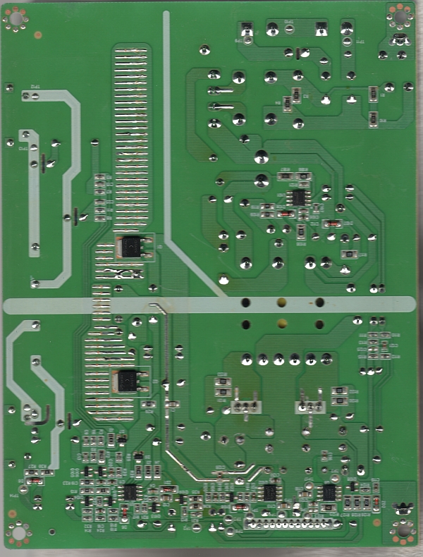

        Pictures of the bottom side of the power supply-inverter board so I can give you the test points for checking the inverter transformer high voltage winding resistance test.

            When it goes off I mean the picture and sound. Here it the underside.

              No power to the board for 5 mins meter on ohms 2000
              test S1 to S2 and S3 to S4 and post results
              Pictures could do with being bigger - as close to 2mb as you can get

                I read S1>S2 870 and S3>S4 850

                  Looks like that is ok then -they are within 3%
                  Next- on the back of the board there are two components
                  with 2 and half legs and a tab what is the part number cant quite make it out and its pointless me guessing.

                    There is D454A and under that is BA951D
