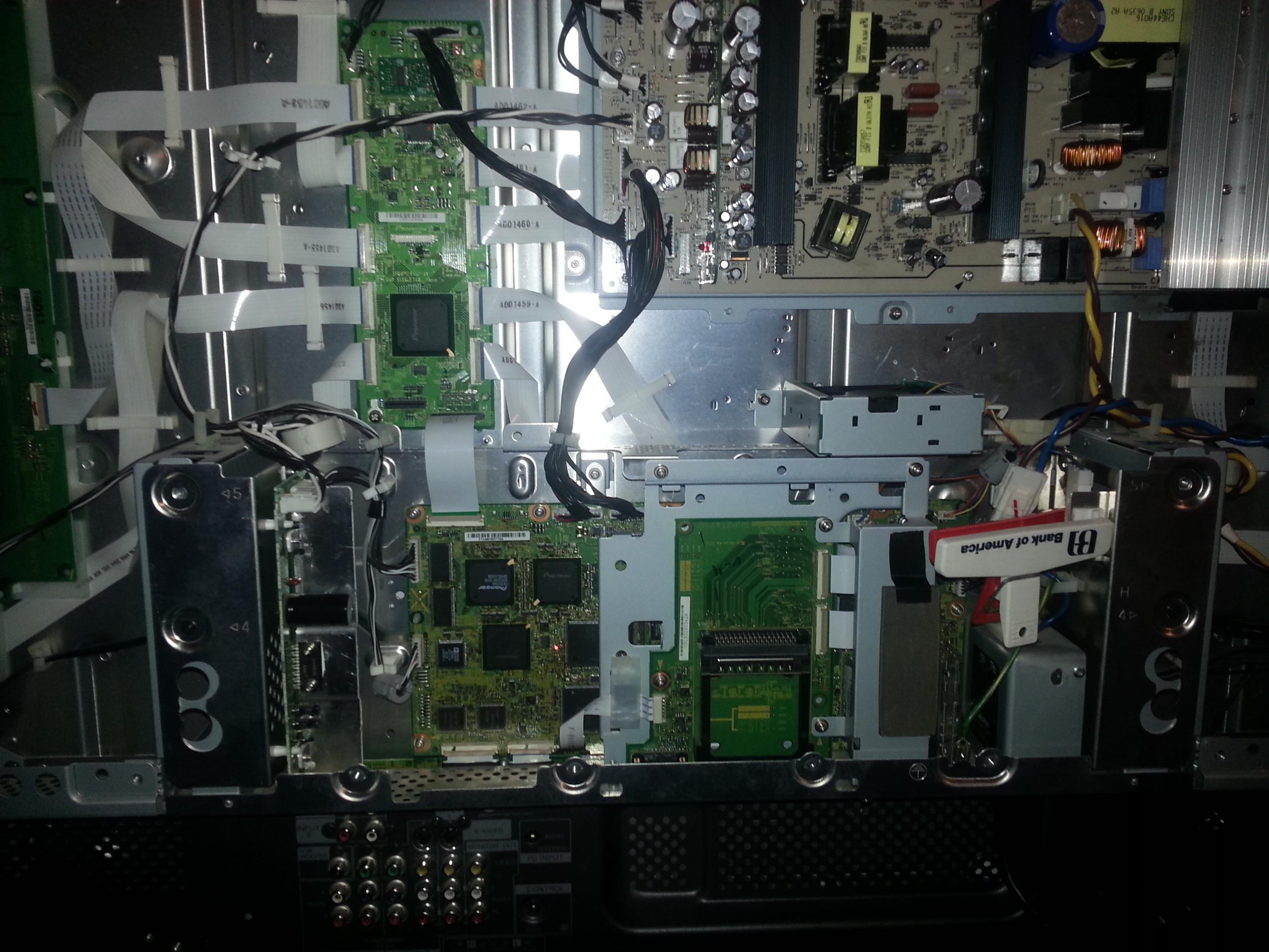

            heres some pics, lol kind of self explanatory, but i think something else is wrong now.

              Oh my that can't be good. Where did you get the PSU from ?

                ebay. . but before it didnt do anything and now its kind of powering on so thats a good sign. right? lol

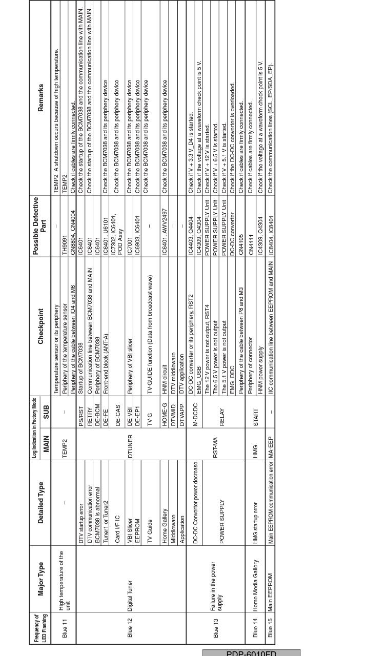

                      13 blinks IS power supply failure. You may have changed one bad psu for another.

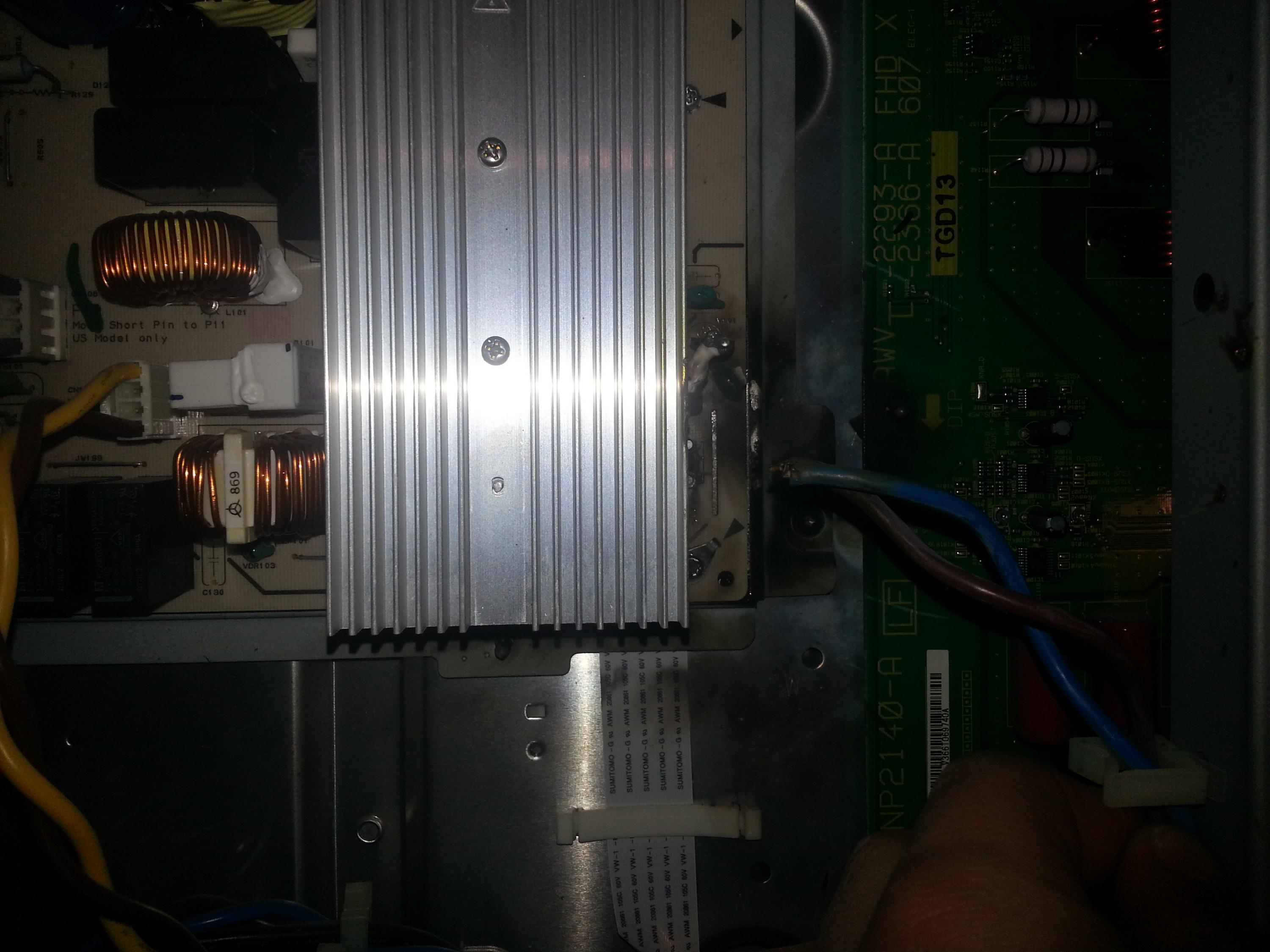

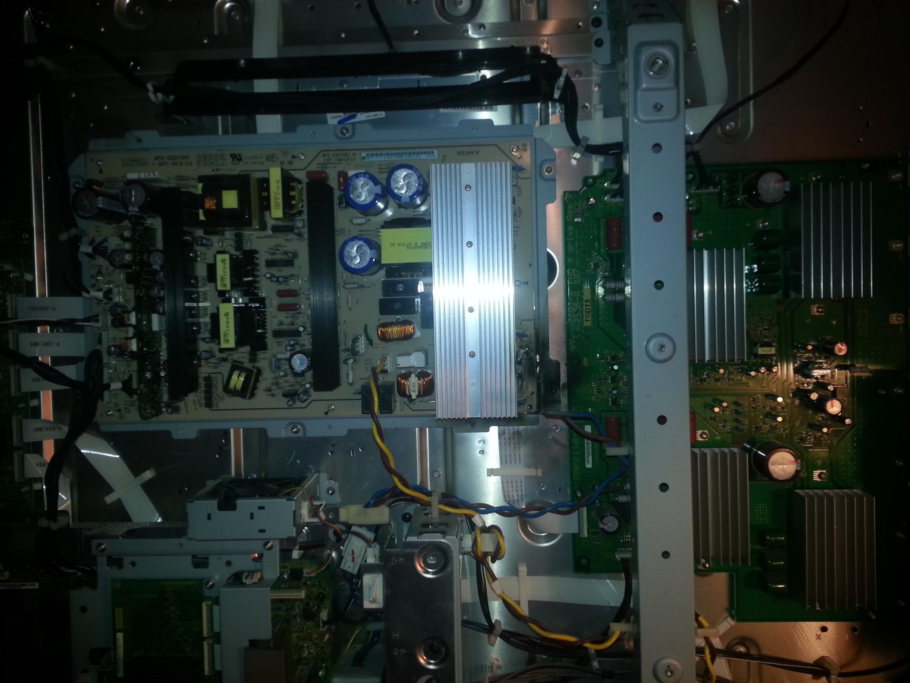

                        i took the back off again and realized that this little red light is on, its located on the main board i believe. any clue?

                          from what ive read its the main assy or the psu. any clue what "MTB-RST2/RST4" is? thats straight from the manual.

                            Its missing voltages in the reset lines.

                                Check your output voltages at power supply first.
                                This is from the 6010 SM

                                      Solid red and blue are Trap Switch.
                                      The 3.4v is low not sure how that would impact the relevant circuits.
