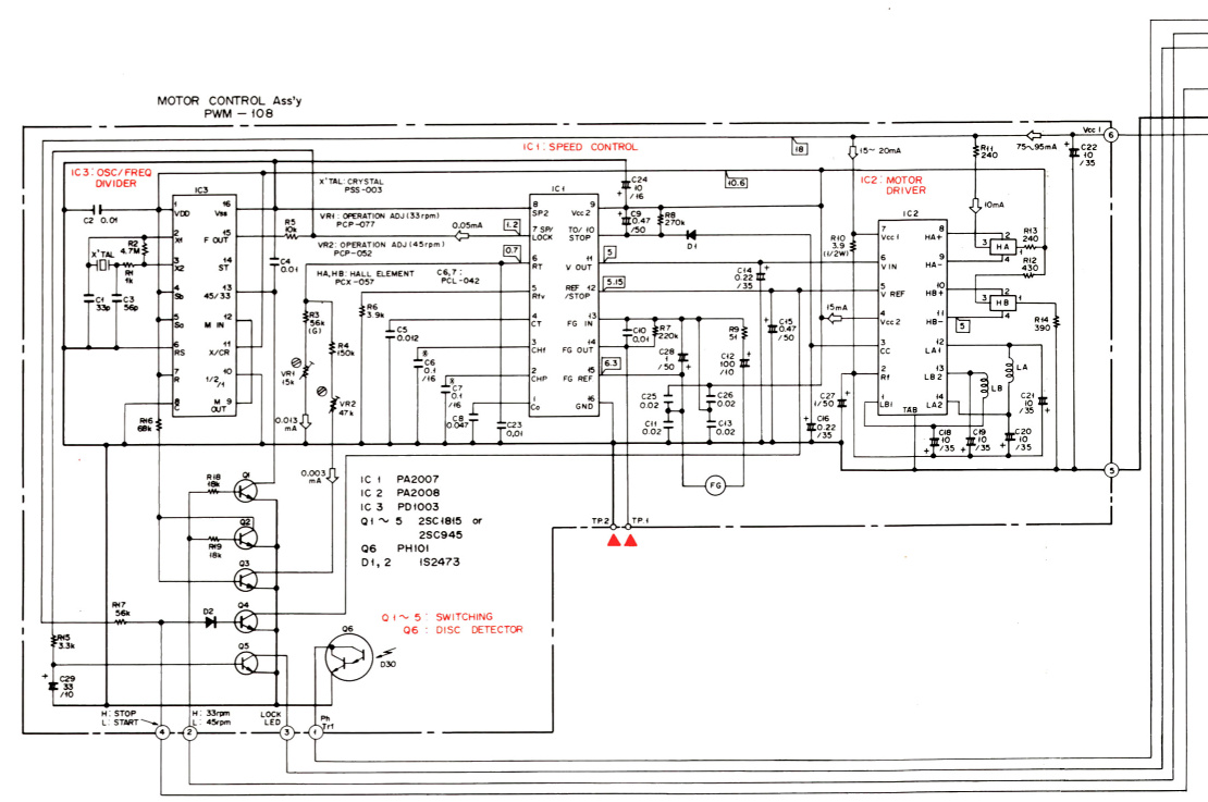

    I'm starting to re-cap a Pioneer PL-X9 turntable, specifically the motor control board, because although everything tests out OK according to the service manual, the speed wavers slightly despite the quartz lock light remaining on. So, I've decided to re-cap that board since it's the cheapest next step...
    Pioneer's passive component naming convention is clear to me. For example, CSZA R22M 35 is tantalum, radial leads, 0.22uF, 20%, 35V.
    BUT there are two capacitors on the board which have actual Pioneer part numbers: PCL-042. I can tell they are 0.1uF, 16V but don't know why Pioneer would do this, unless the capacitors are special somehow. Any ideas?
    There's a second oddity: CCDCH 330J 50 means ceramic disc, disc-type radial leads, thermal compensation with a thermal coefficient of 0 and tolerance of 60 PPM, 33 pF, 5%, 50V. So that's a generic passive component naming scheme, for an apparently special capacitor. I have no idea how to find a modern equivalent. Again, any ideas?

    very stable accurate caps makes sense for such a circuit,
    you will find ceramic and plastic film caps in 5% or even 2%
    i wouldnt be surprised if the 33pF caps are connected to a crystal.
    you probably wont find a .22uf tantalum, i would use a .22uf 63v plastic film cap

      The 33pF cap is indeed connected to the xtal. So this would be a Class 1. It seems CH is interchangeable with C0G and I've seen datasheets for Murata, Kyocera and TDK.

        Is it stable in variable-speed RC mode (not quartz)?
        The 33pF parts are likely fine and not the problem I think. The electrolytic capacitors are old though, and I would replace them all.
        Looking at the motor control board, 13 electrolytic caps to change. The values 0.22uF, 0.47uF or 1uF I would use film caps instead like Kemet R82 or Epcos/TDK B32529 or Panasonic ECQ 63V series.
        Check the +18VDC power is stable from C20/IC12.
        Service manual I found here: https://www.vinylengine.com/library/pioneer/pl-x9.shtml There is ARP-234 and ARP-382 version.
        There is a special Pioneer Tuning Fork repair guide https://www.hifiengine.com/manual_li...ing-fork.shtml which can explain the circuit.
        One person found the Pitch pot and wiring was bad, and cleaning the switches, and another person had a bad IC3 PD1003.

          Reading the spec on IC3, it seems like the RC mode is actually disabled. I'll check the 18VDC.
          Thanks for suggesting alternative caps. I used to be pretty OK at audio repairs decades ago, and have started to revisit my youth, buying the audio gear I couldn't afford then. The sheer range of capacitors now is kind of daunting, so I'll go for your suggestions :-)
          TP1/TP2 are important enough to label clearly, and they're spaced on the PCB to take some kind of test connector, so I assume at the factory something could be plugged in there while the speeds are adjusted: there are only two VRs on the board.

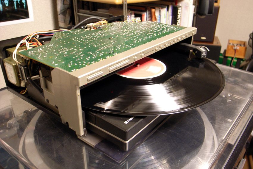

              I finally got all the replacement electrolytics to replace the existing ones. And... they're too tall. All the existing electrolytics are 7 mm tall, for every value from 0.47 uF 50V through 100 uF 10V. My replacements are 9-11 mm tall. The headroom above the board is 9 mm. So the replacements don't actually fit. For the life of me, I can't source 7mm tall electrolytics from brands I actually recognise. In general, could I use conductive polymer such as the Panasonic OS-CON?
                • 31181
                Re: Pioneer PL-X9 motor speed control wobble
                you cant get polymer below 100uf afaik.
                rubycon does some ranges of short caps
                or can you put what you have on their side?

                  I only seem to be able to get Rubycon PK series here, which start at 11 mm. I could lay a couple of the capacitors flat, but in general it's a tight fit in there in all directiones :-(

                    Are you sure the height is that low for all of them? Or just a few?

                        All of them. The board is upside down, underneath the turntable, inside the black plastic tray in that pic. It's actually slightly less in one corner, and the cap there is bent over. I'm not talking about the main PCB visible in that pic.
