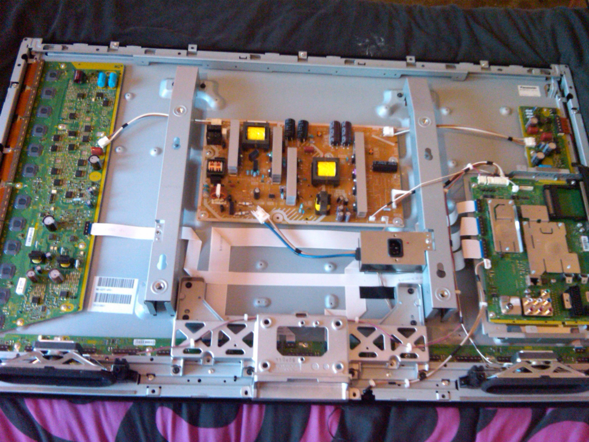

    Hi I have a Panasonic viera tx-p42s30b TV where the power light flashes green about 6 times. I turn it on and you hear 2 clicks, it flashes about 6-7 times then another click and then nothing! I have checked capacitors and they seem fine so I was wondering if any one knew the problem?

          Re: Flashing green light on Panasonic Viera TX-P42S30B
          Can you provide pictures of the parts in the set?
          Most likely you are dealing with an A board fault.

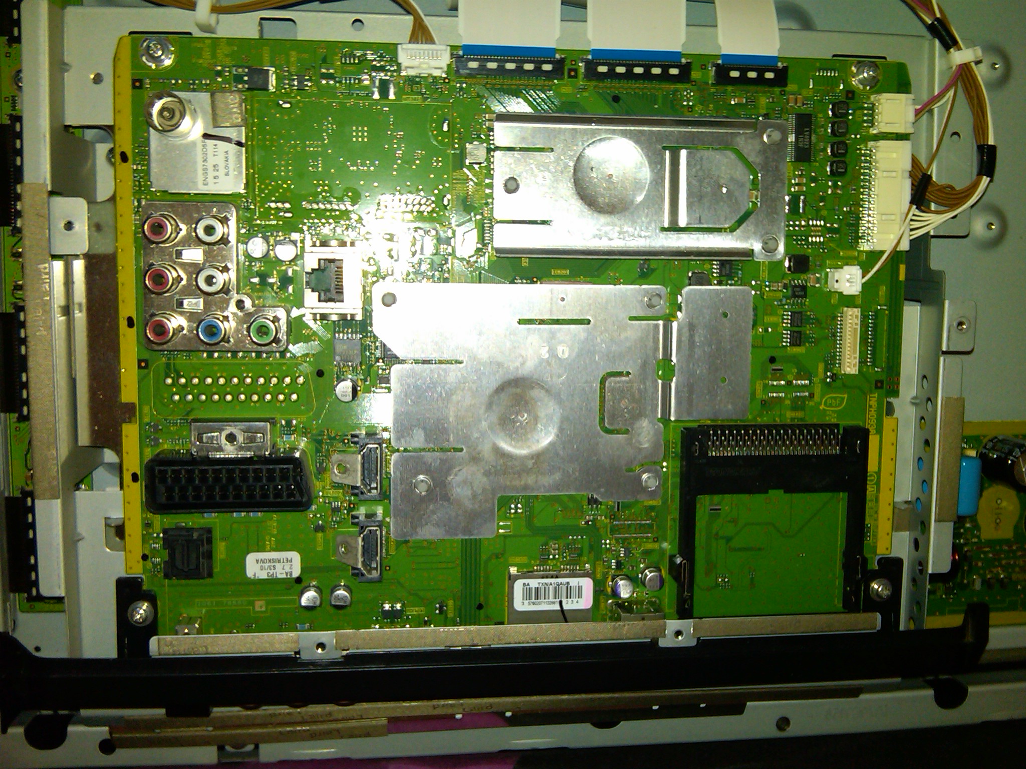

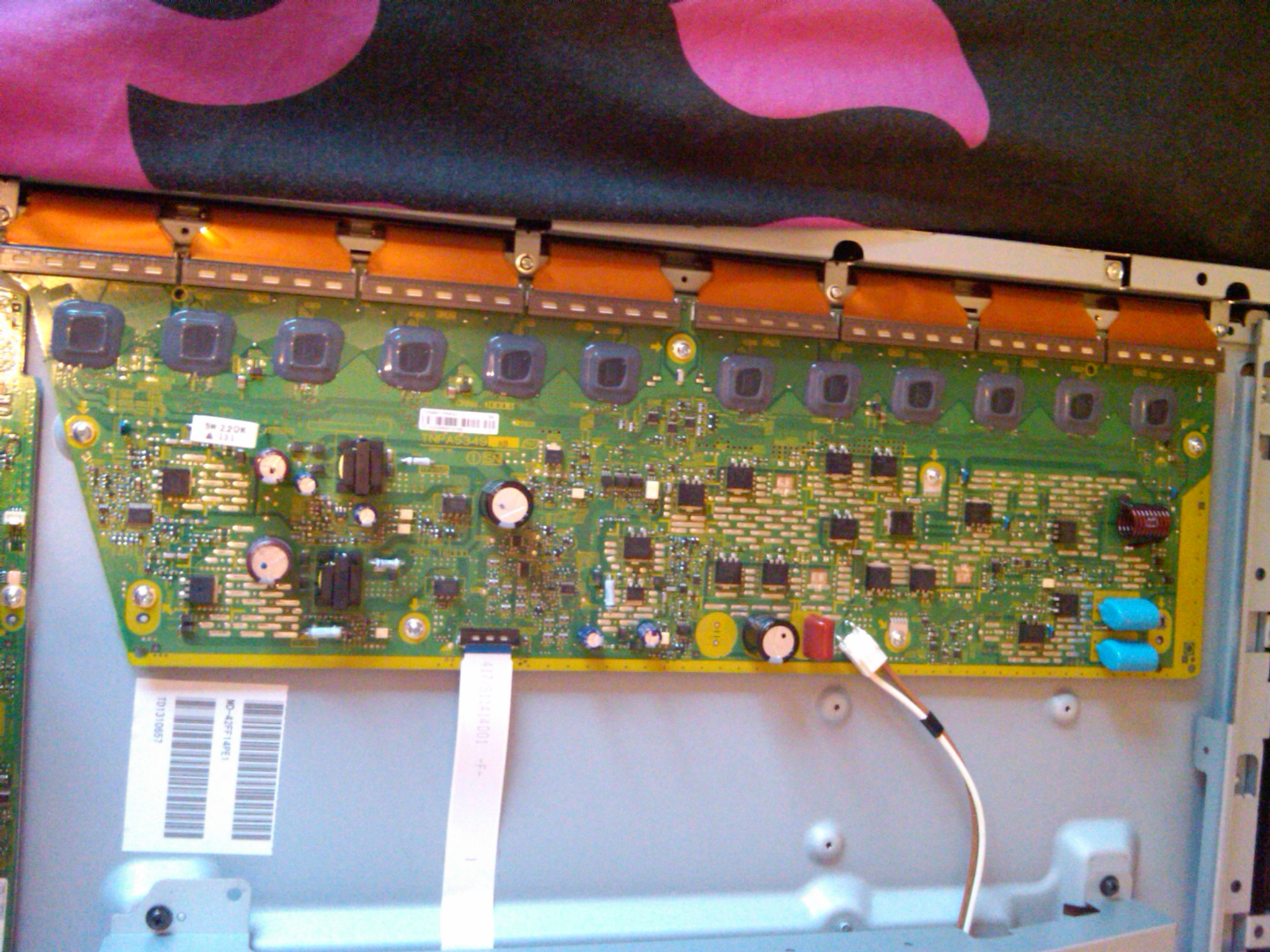

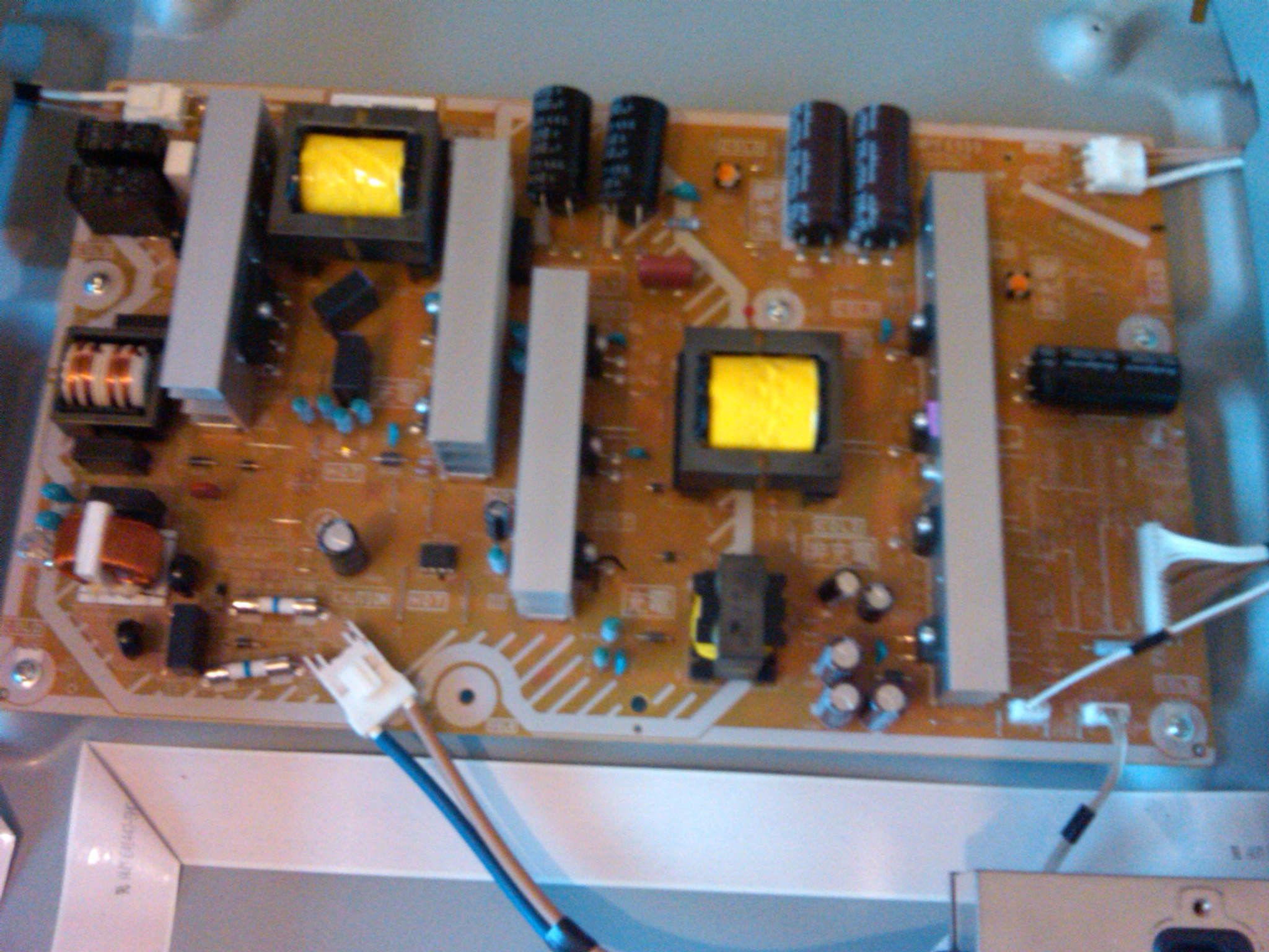

                Hope this is enough detail for you in these pictures.
                  I think these later models behave differently if they detect a short on the PSU on start up e.g. the Vsus line.
                  The U30 looks like it's similar to the S30, pages 25, 29-30
                          Your symptoms are correlated with A board, just hoped I could see any obvious other faults.
